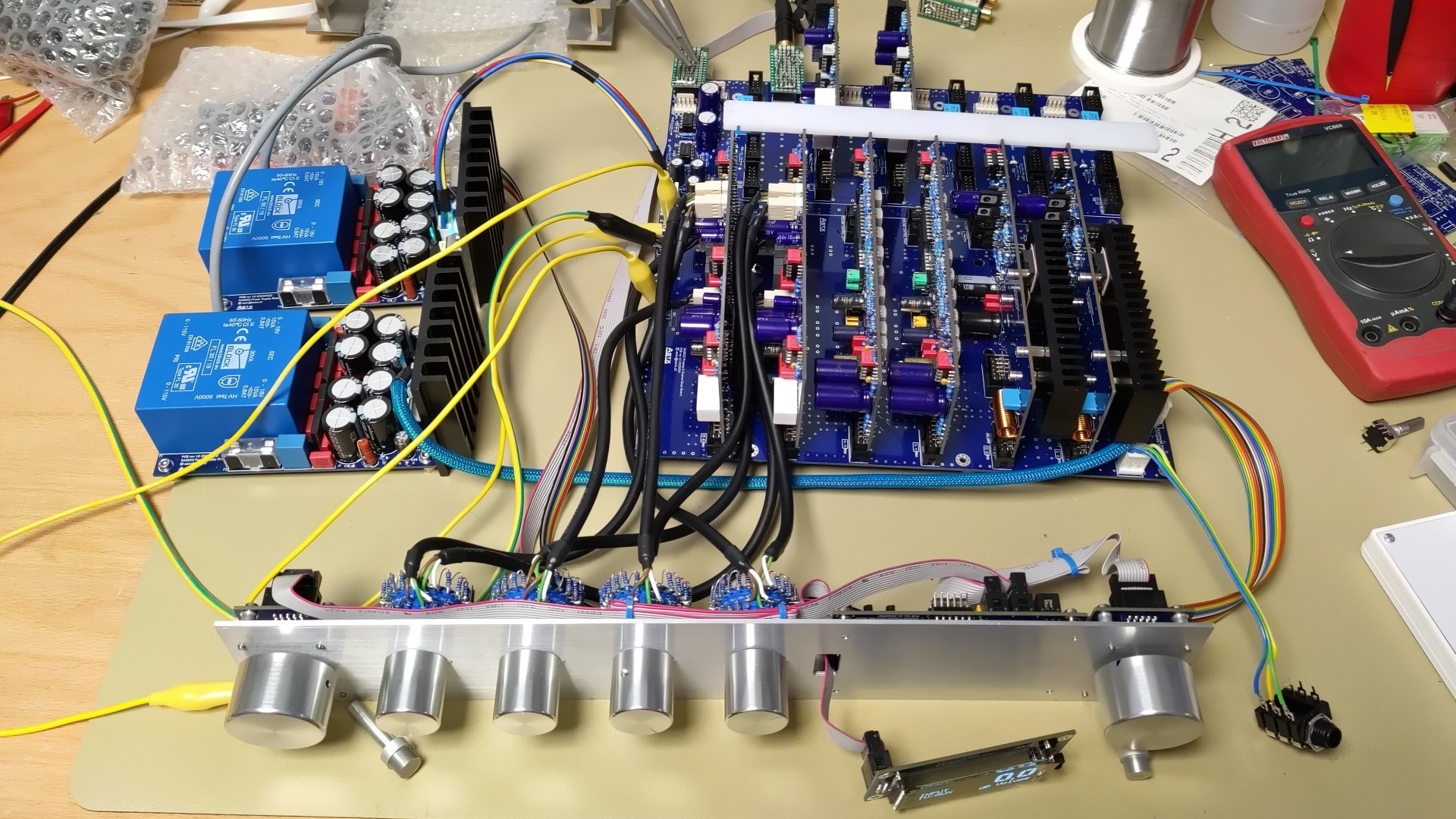

Superbal input 5k impedance. There is a tone control board (with switchable bypass) in front of the volume control input. The pcb interconnects (on the huge baseboard carrier) are always balanced.What input impedance did you choose? BTW: Nice connector concept.
Looks good
Now that’s what I call a prototype

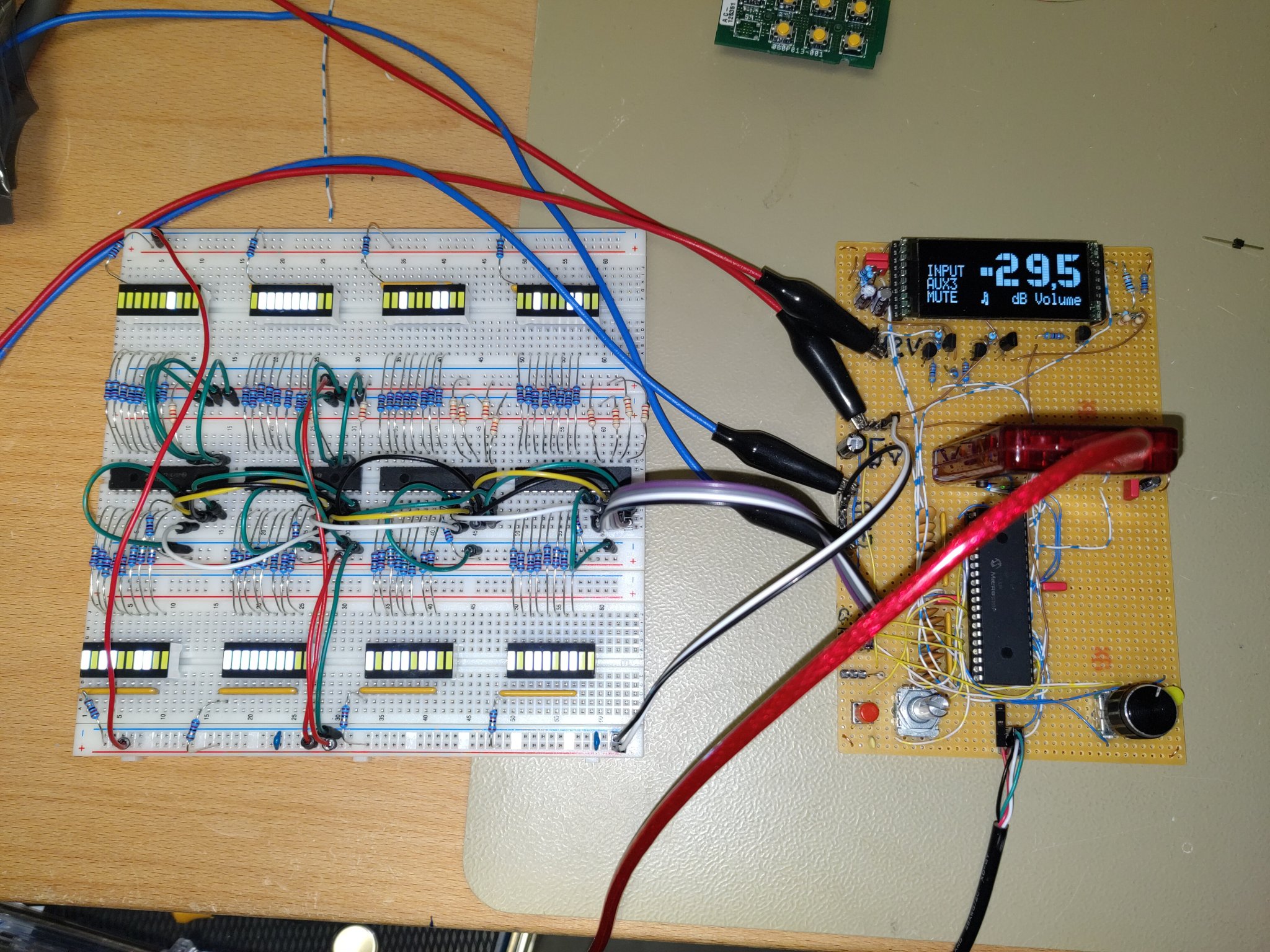

Fair bit of led current I, for those bar graph LEDs, non- multiplexed I assume
You are using a 24 position dual/stereo switch for tone control. Is it a make before break type? What type do you use? Another question: tone control in front of volume control or after volume control?
The LEDs show the port state. If low, led is on, because I'm using resistor arrays.
The many resistors I have used are 12R instead of wires...
Tone control be4 volume control with bypass relay.
Switches: make be4 break. The ccw last 2 positions are short circuit to get a correct center value. haven't found 23 position switches...

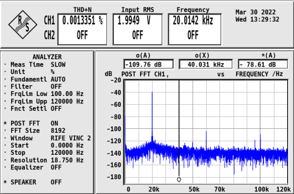

Yesterday I have got a used Rohde & Schwarz UPL - unfortunately without the B1 and digital option, but the Analyzer itself is far better as the Levear VP-7723D
Quickchecked the VP-7723D generators qualtity and here you can see the THD+N limits. During development I often had such values measured with the VP-7723D.
I often said to my THD+N 20kHz measurements "as good as or better than" ...
BR, Toni
BR, Toni

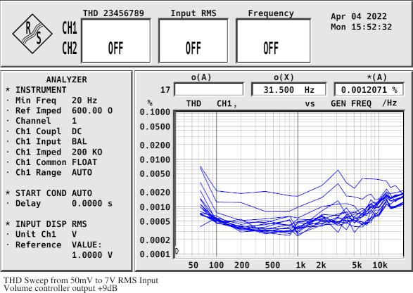

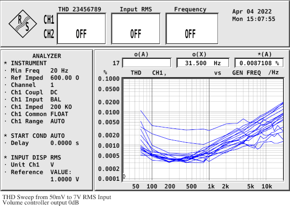

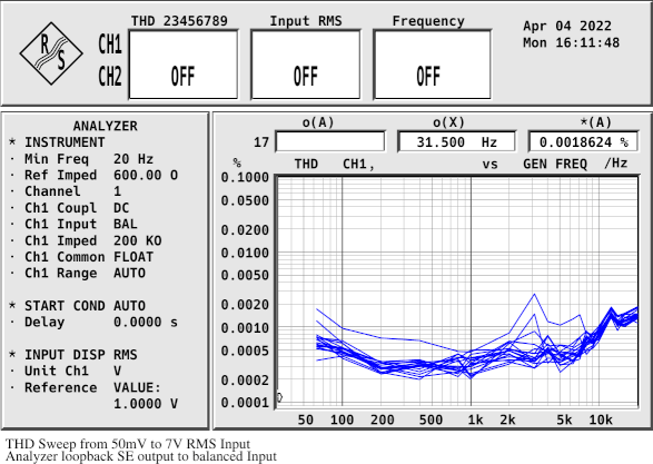

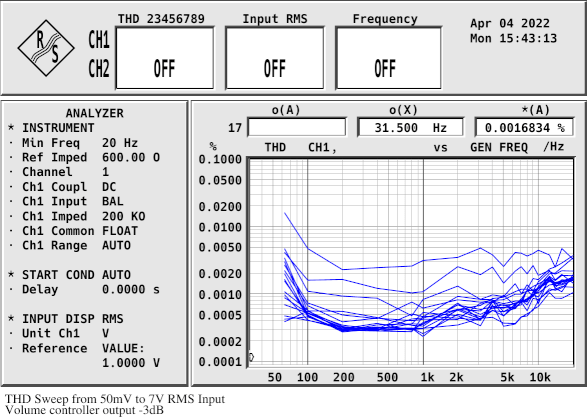

Test setup of new optoMOS volume control...
Input frequencies sweep from 21.5 kHz to below 100Hz
Input voltages SE from 50mV sweep to 7V RMS
This analog volume controller can be stepped digitally from -63.5dB to +12dB in 0.5dB steps ...

Looks not so bad - a PGA2320 performs similarily. The Analyzer loopback shows my measurement limits especially at freqencies above 10kHz and below 100Hz.

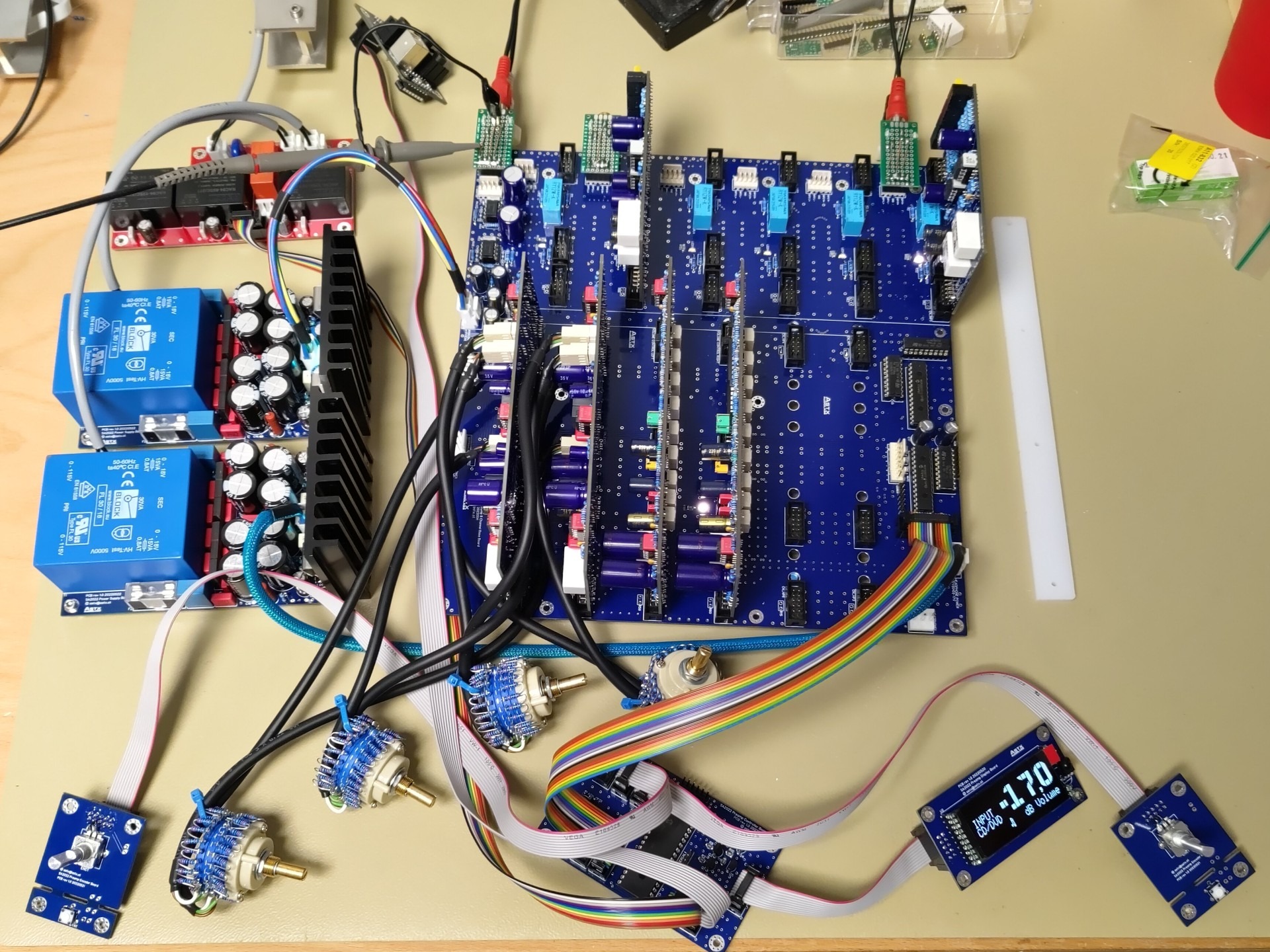

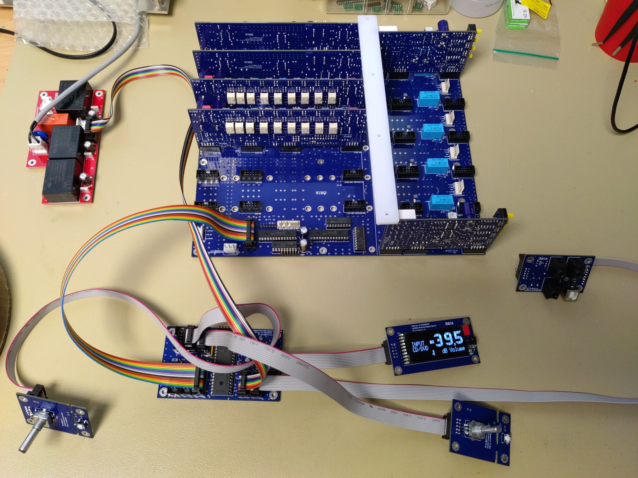

more progress... most pcb's developed, produced and tested.
First picture:
Base board left side: two slots are free for headphone amp.
Baseboard right side: only 2 of 6 input slots are inserted.
The white acryl locks the inserted cards.
The red pcb is carrying the digital supplies.

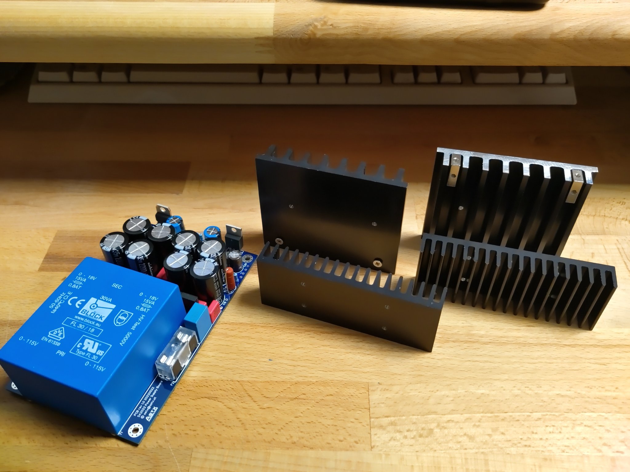

Second image:
+/- 17V supply for analog circuits. A second one for the headphone only.

First powering - success! No noise, no hum, just pure sound.
D. Self Tone control with selectable bass/mid frequency and +/-10dB works absolutely clean, no clicks between selections. No click and pop switching from tone control to direct. No clicks and pops selecting volume or switching inputs.
Input gain selection can be selected during music without clicks and pops (range from -15 to +10dB) using the 16 position hex switches on backside.
