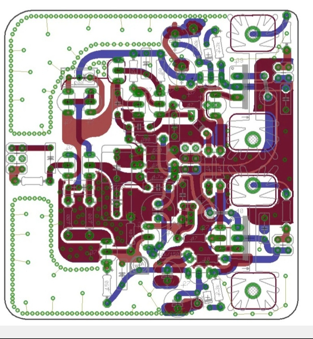

I did my own board for mydoa 3.1 and it doesnt work properly. I lowered r8 and r6 values for lower voltage rails (15v) and r5 is 700ohm for mje243 253 output transistors. All other transistors bc327 337
The ccs led doesnt turn on and i get 13v offset (unadjustable)
If i substitute 47k resistor for the input stage ccs i can get 100mv offset and it plays music, but with very distorted bass. The ccs led still doesnt turn on.
Since it plays music can i assume the pcb design is correct and that the component value/choices are the issue?
How should i troubleshoot this?
Attached is a pic of my board.

Dear Donovas,
to which schematic do you refer? Changing the TMC compensation capacitors and at the same time changing all transistor types from the recommended ones needs more or less a redesign of the schematic and part values.
Distorted bass can also be a problem of too low output impedance and/or of course also oscillation.
The GREEN led should be a Lite-on LTL1CHKGKNN or another LED with similar specs. This LED type should show a weak glow. If you use a very old standard green LED the CCS my not even work correctly.
MyDOA with original parts works with +/-10V up to +/-24V without any problems.
BR, Toni

Thank you for the detailed answer Toni.
Unfortunately i will have to abandon this board since my goal was to find a project to use up my generic components.
Could i ask you why only the specific led could work with your ccs? I never heard of needing a specific brand of led for its parameters

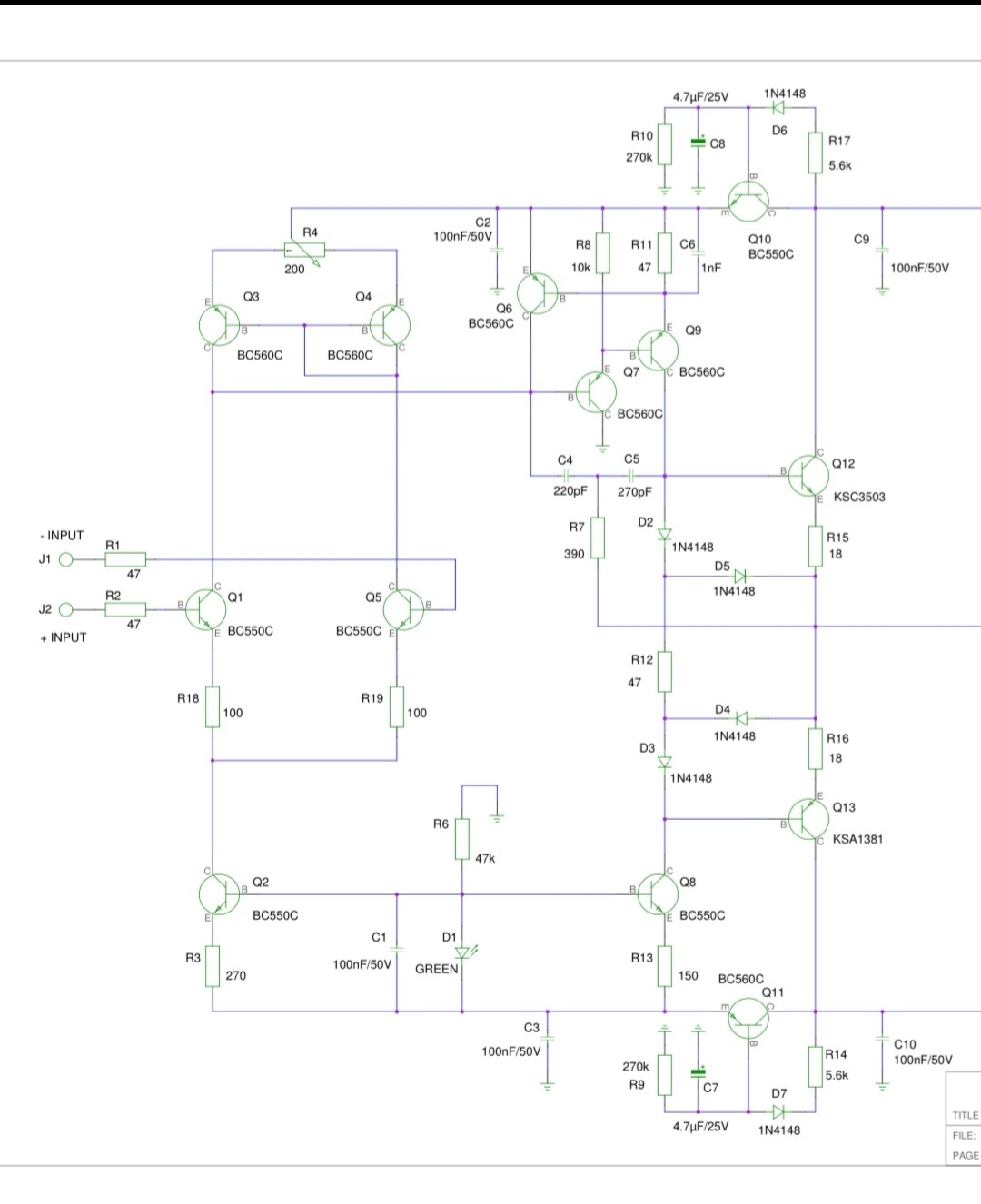

Dear Donovas,
I ask again: to which schematic do you refer?
LED type x' forward voltage isn't the same as LED type y.
To reuse your parts using my schematic is possible, but you have to recalculate many part values. Show your usage szenario including external components.
BR, Toni
Hi Toni, its this schematic. I have tried halving the values of r6 r8 and also the ccs mod i wrote of. And instead of 270pf i used 220pf. No other changes. All the small transistors are bc327 337c. Output mje243 253.
Regards, Eric

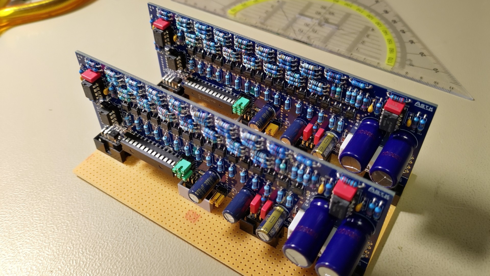

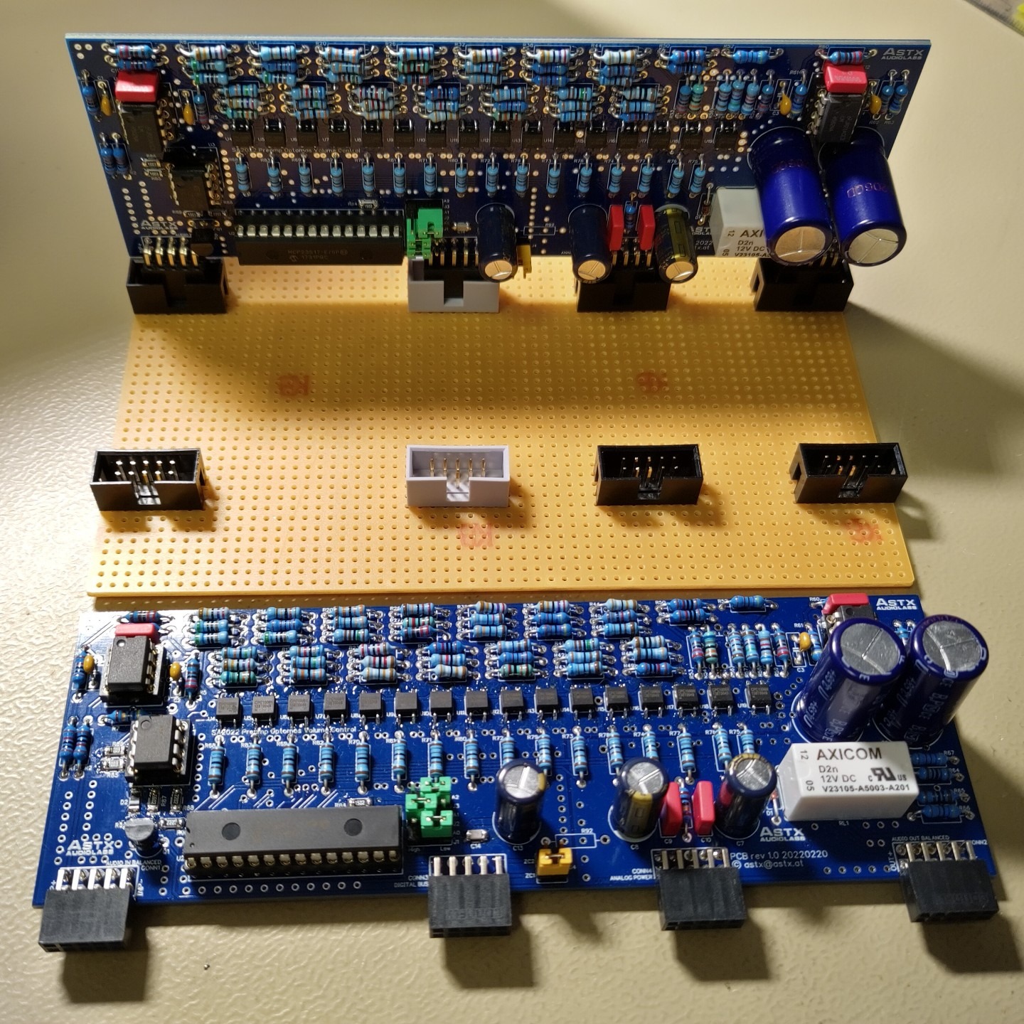

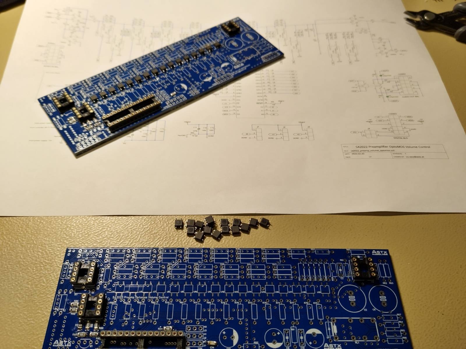

A little bit off topic: I'm focused on developing an analog preamplifier digitally controlled for SA20XX amplifier series.
Currently I'm soldering a first prototype using optoMOS switches.
Volume can be controlled from -63.5 dB to + 12dB in 0.5 dB steps.
If this project fails due to bad THD values the next step is to use a discrete JFET volume control or a PGA2320 based volume controller.
Have fun, Toni

o PIC18F46K22
o several MCP23S17
o sdcc compiler
o Home brew software
o Inputs have manually adjustable gain -15/+14dB using hex encoders reachable from back panel
o balanced interconnects
o d.self tone control bass/treble with adjustable base frequency and "direct/bypass switch". using 24 position dual/stereo switches with 5k total linear resistor value for low noise
o self developed remote control using nec protocol
o 8 inputs.
o 4*20 oled white display with configurable brightness
o 2 rotary encoders for inputs/monitor mix selection and volume control and setup.
