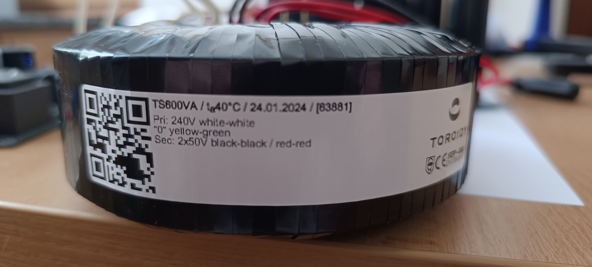

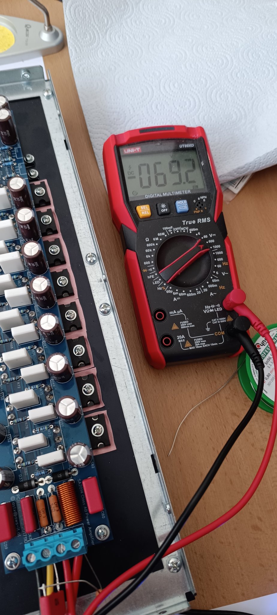

The first 600W transformer from toroidy.pl at home (240V, 2x50V). First channel finally done, bias set to 21.3 mV, supply voltage at idle 69.2V, DC offset 4mV. Hopefully in March I'll get to finish the second channel. I'd like to have SA2014 in the box finished by the end of the year!

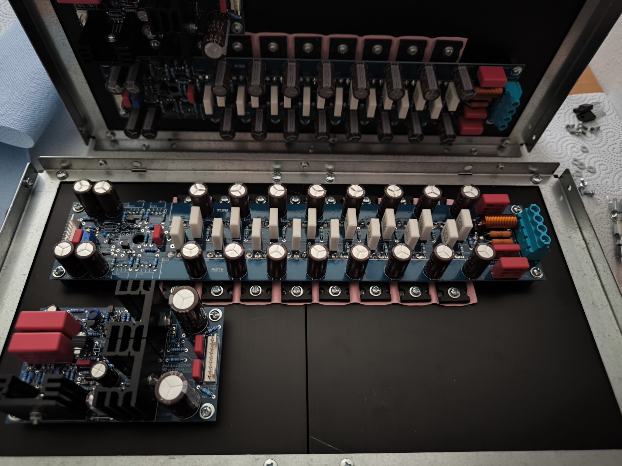

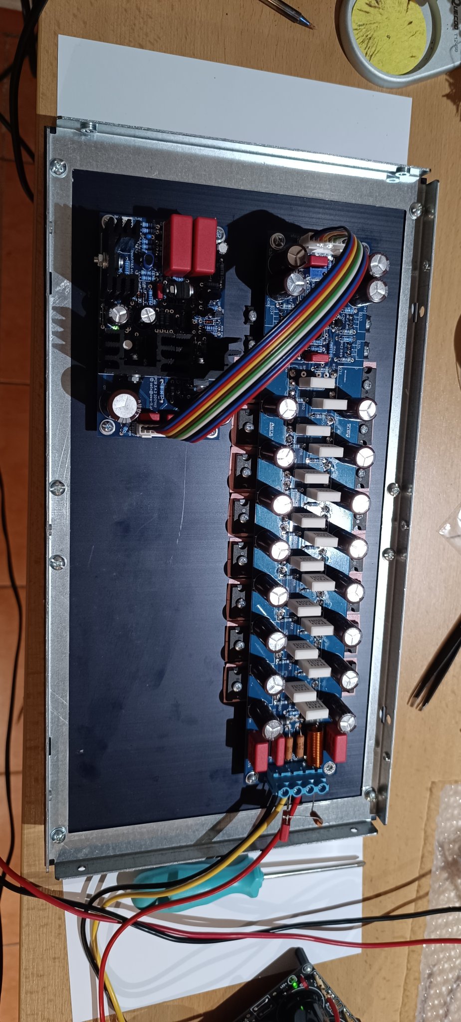

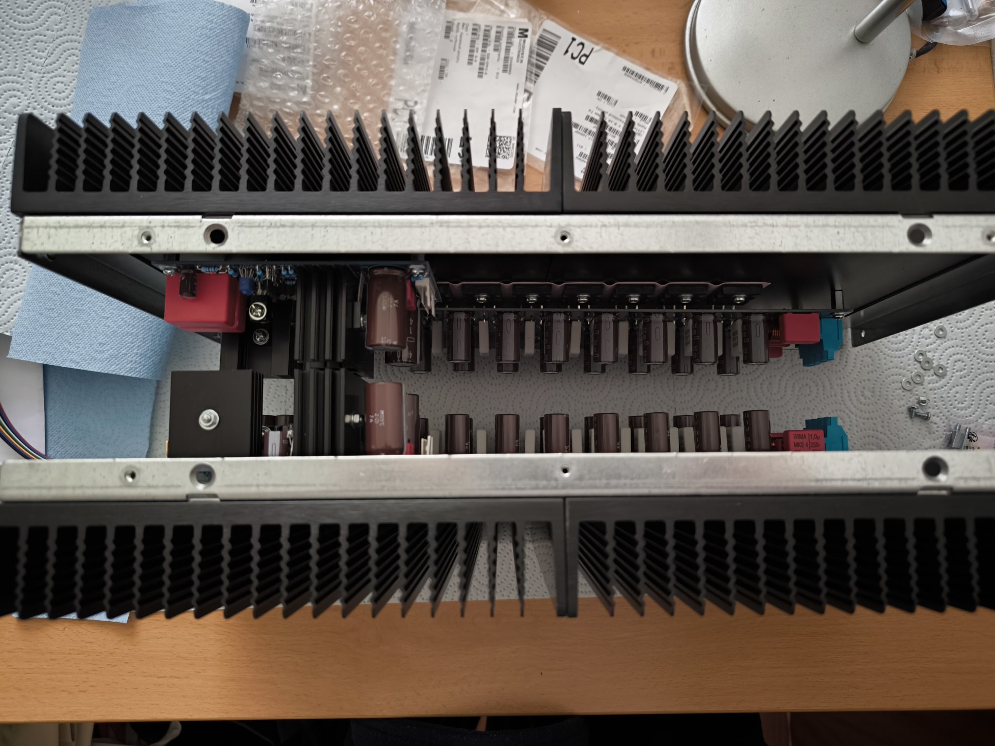

Friends, as time went by I finally managed to complete all the blocks for SA2014. I have everything set up and ready to put in the modushop 5U box. I'm going on vacation in August so I won't be able to do much, but I still need to save up for FURUTECH cinches and massive terminals.

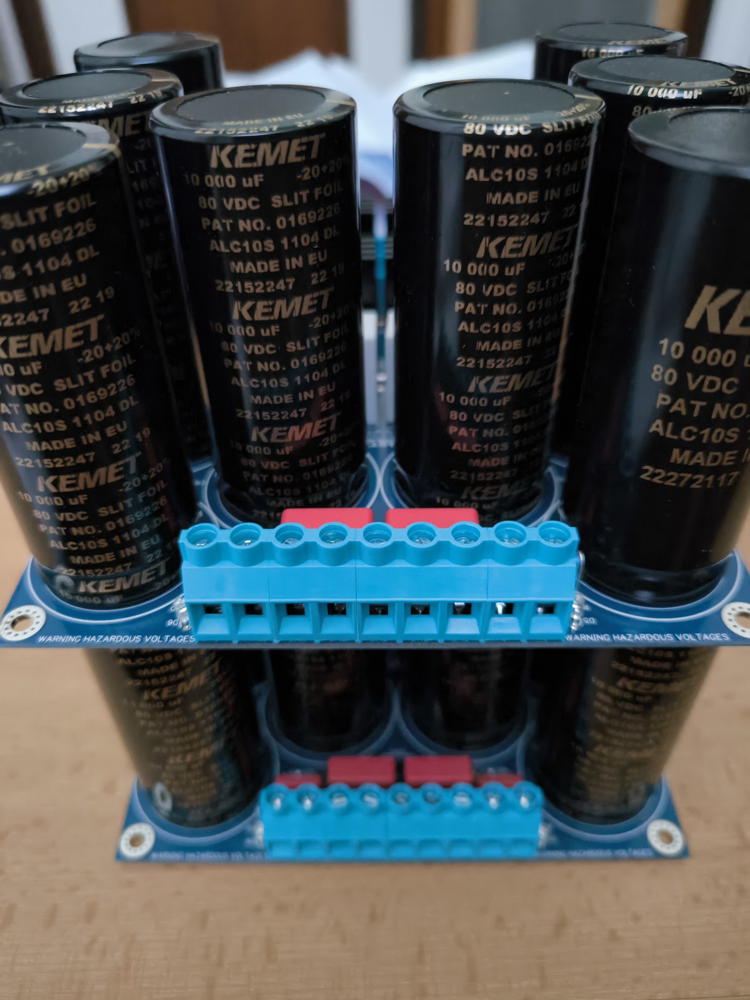

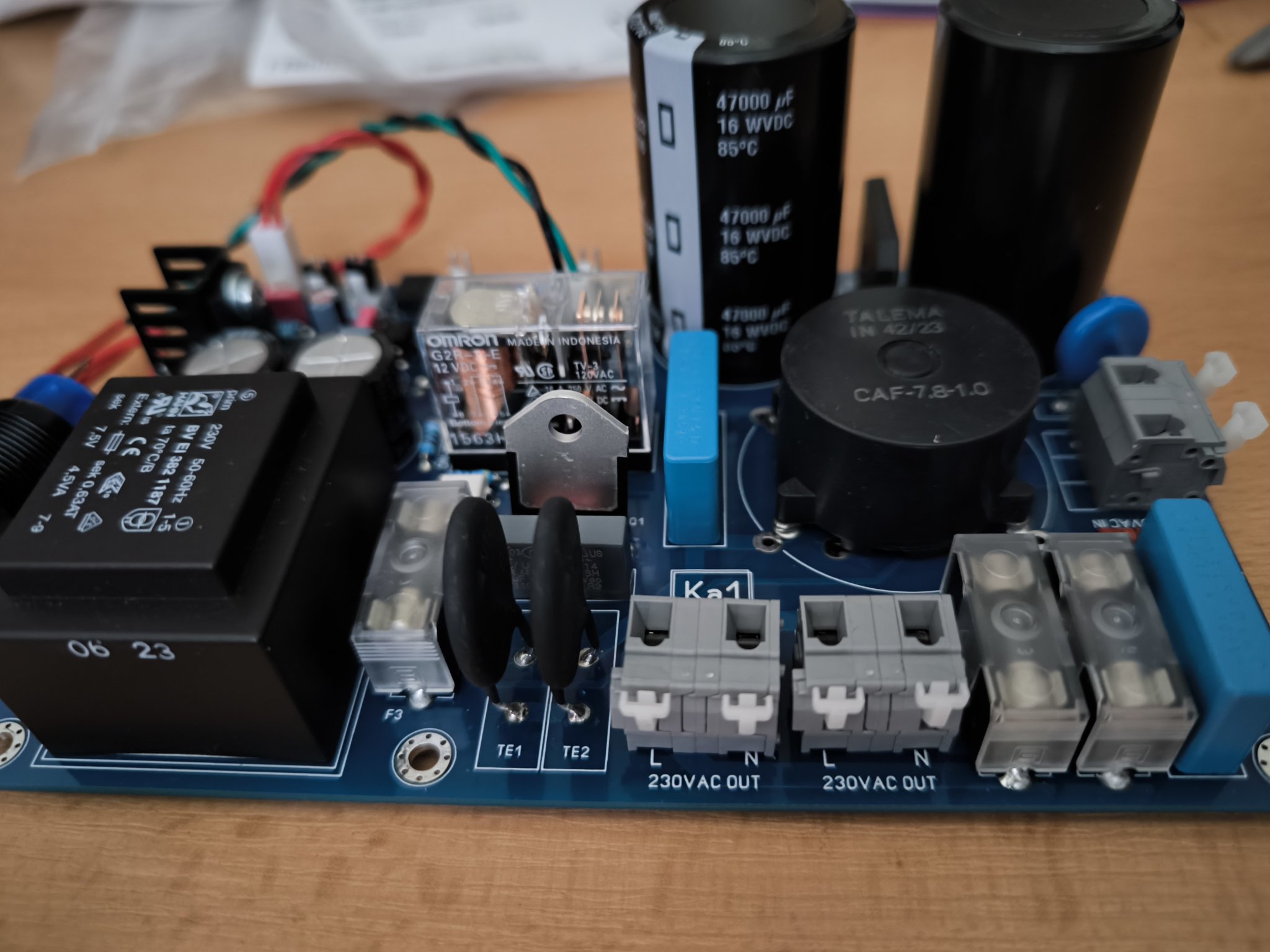

- SA2014
- PSU
- 2x 600W toroids
- inteligent softstart (inc. DC protect)

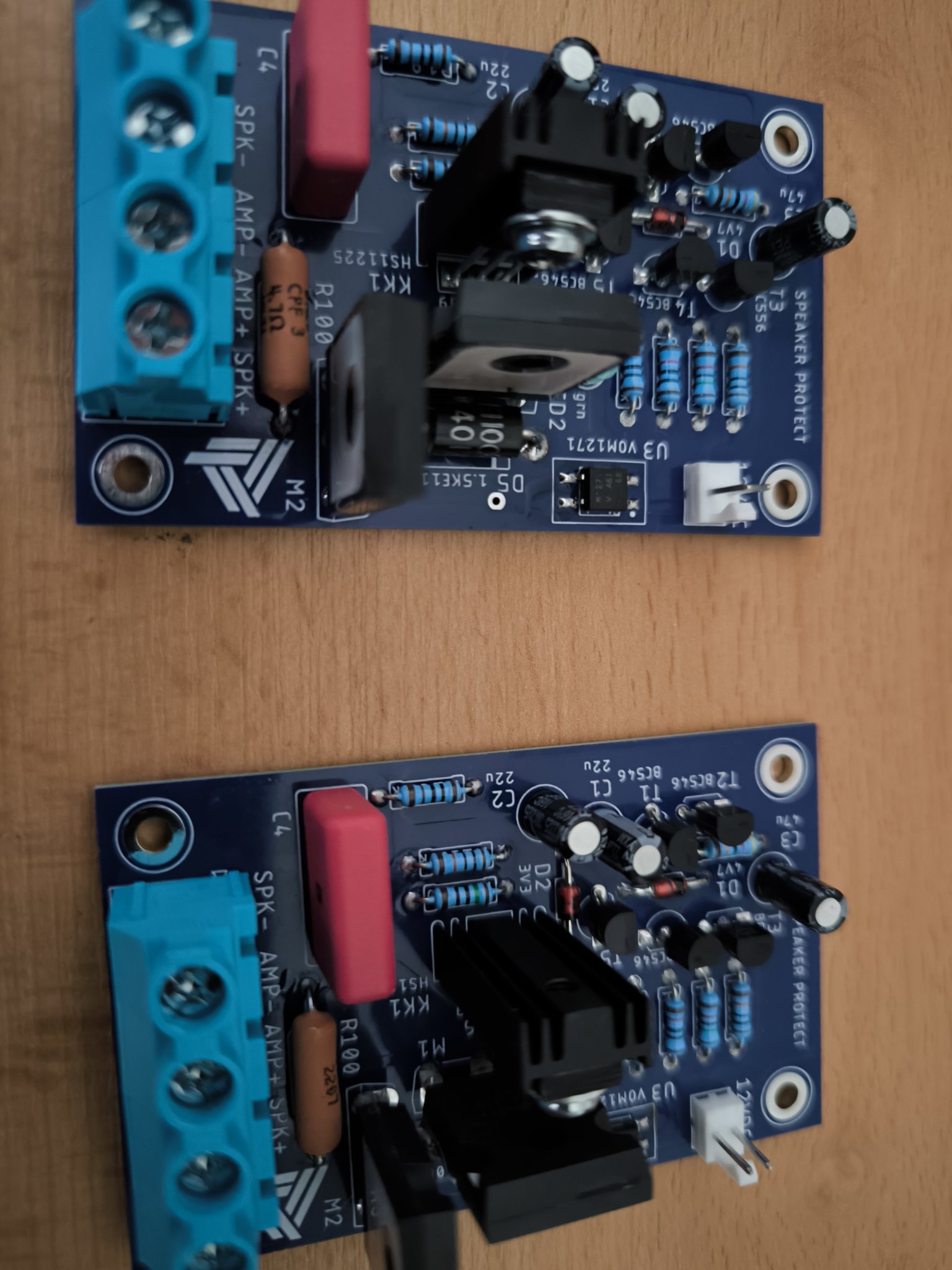

- SSR speaker protect

Looks fantastic! Could you direct me towards the softstart boards if possible?

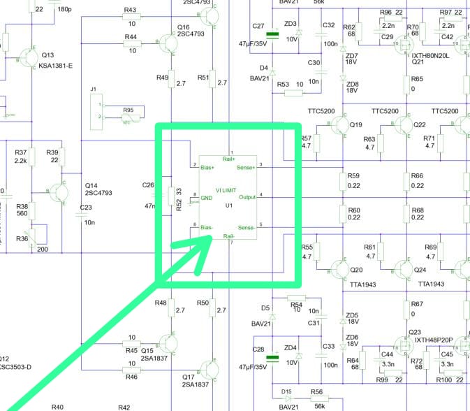

IXTH80N20L is Littelfuse & IXTH48P20P IXYS
Available any issue in use SA2021-NCH - New Class H.

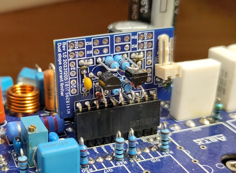

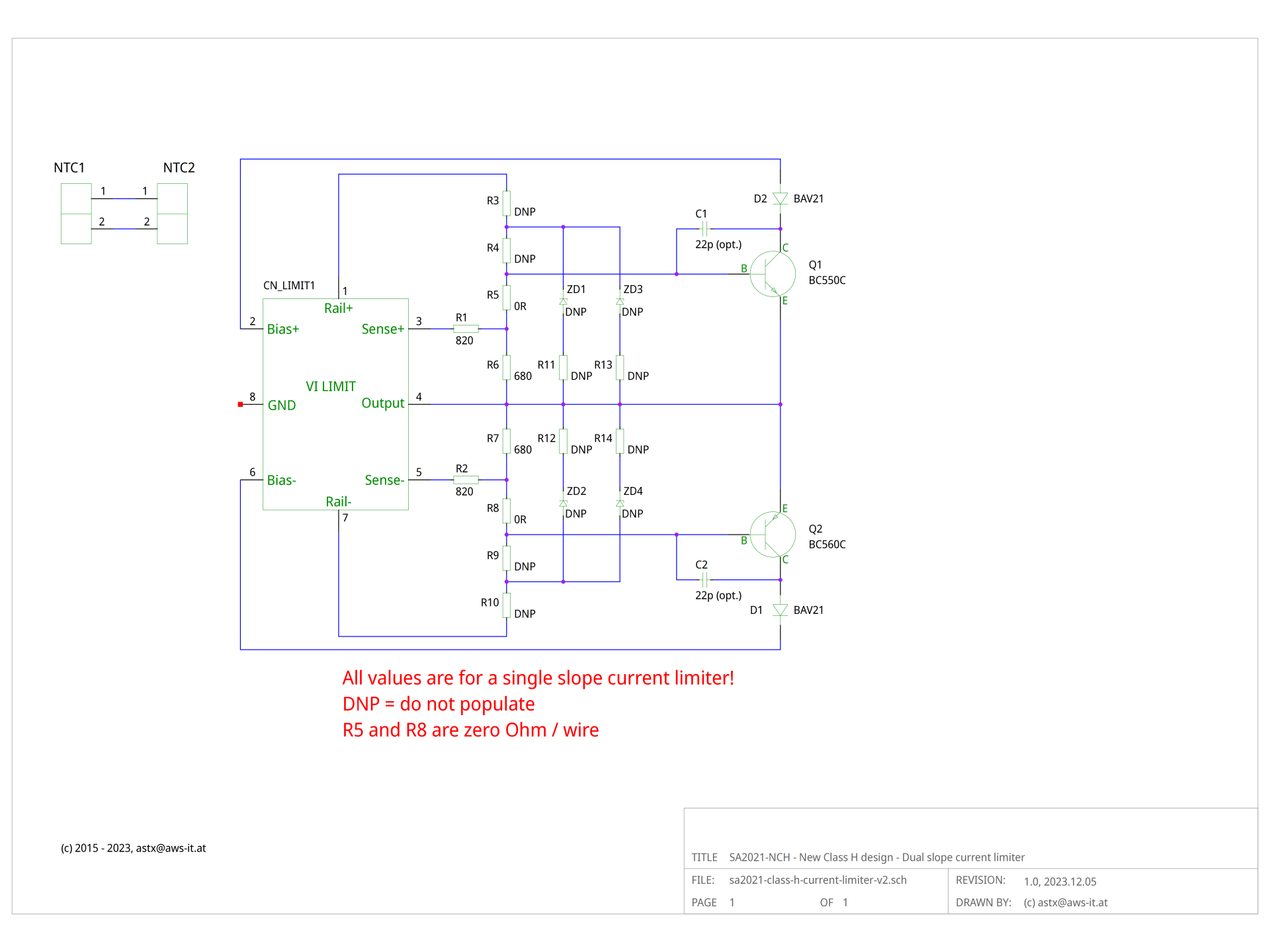

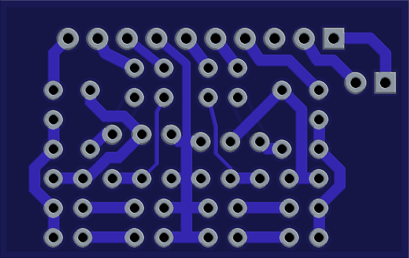

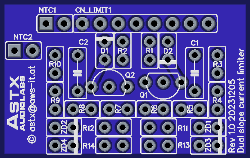

Single slope current limiter for SA2021-NCH - New Class H
sa2021-class-h-current-limiter-single-slope-on-dualslope-pcb_schematic.png54.5 KB · Views: 308

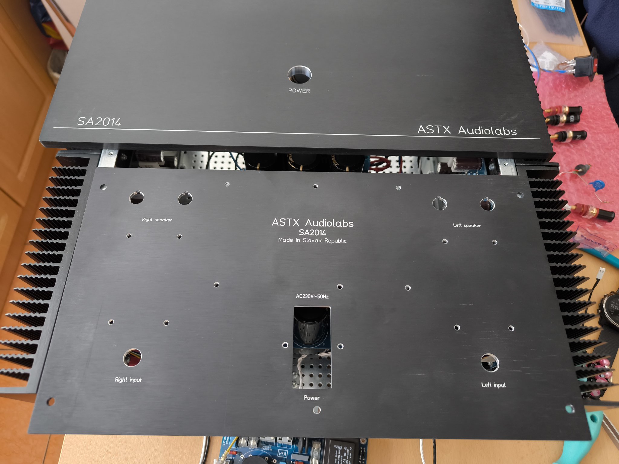

I'm about to finish SA2014, I'm working on the front and back panel design. Tomorrow I send it to production.
