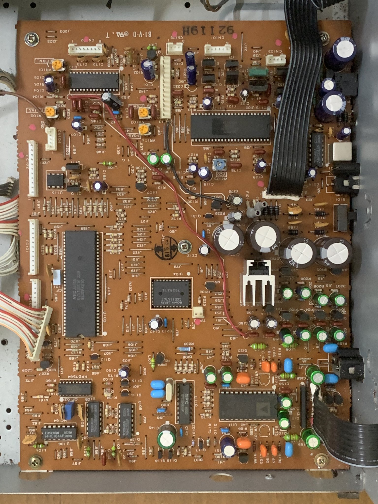

Music Hall A15.3 Blinking front panel LEDs
Evening,
Hoping someone on this forum has some experience with Music Hall a15.3. Bought it non-working, knowing it had one channel blown. But after removing and replacing the outputs (I replaced original 2SA1186/2SC2837 with 2SA1386/2SC3519 - which seemed like an exact match but with higher voltage and amperage ratings, albeit slightly slower at 30MHz vs 60MHz). I also tested all other transistors with the DMM and they checked out good. Compared resistors, capacitors and diodes to each channel and those also checked out good.
Symptom(s) ---
Powering on the unit you can hear the two relays "click" but about 5 seconds later, you hear a third relay "click" on the input section and the front panel LEDs start blinking (tried to show in pictures below)
1) first pic is on power-up, volume control and selected input LEDs light up
2) after about 5 seconds from relays clicking in, all the front panel LEDs light up
3) all the front panel LEDs continue to flash every second until you turn the power off (powering up again, starts this process over again)
I cannot find anything wrong with either power amplifier section - both have about 15mV of bias, pre-drivers get warm (maybe 90-degree F) but nothing too hot to touch comfortably. I also get 12mV and 9mV DC on the outputs - so it doesn't appear to be amplifier related due to protection kicking in.
I get all the low voltages as listed on the board +/-45V, +/-15V, +5V and +9V. Gone through the entire board checking resistors, diodes and capacitors and I have not found anything out of spec. (anything suspect, has been removed and tested out of circuit - with all testing good and soldered back in)
Anything you could suggest I try, or might know as a problem on these integrated amplifiers? I have had this sitting around for 2-3 months, working on it off and on - generally getting frustrated because I can't seem to find a faulty part.
Could it be one of the input "chips" or maybe the front panel "chip"? Not the best at reading a datasheet and circuit design and knowing how to confirm if it's working. I did check all the resistors and capacitors on the front panel and they seem in good working order and all measurements seem logical.
Could not find a schematic, so if someone has one would appreciate you sharing it with me.

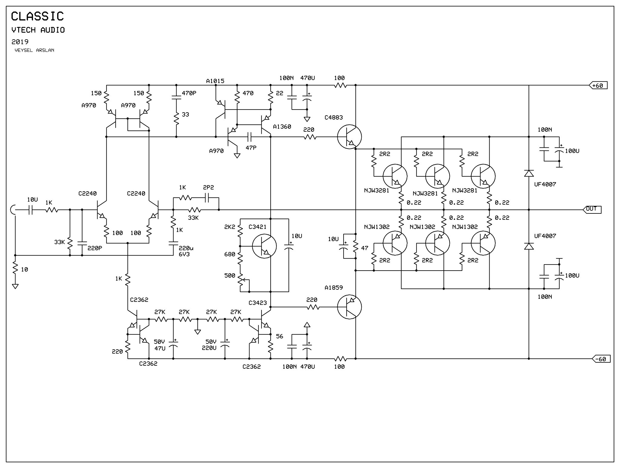

QUAD 405 Clone wiring / ground loop
Hi everyone, I have 2 Quad 405 Clone boards which I would like to install in an aluminum housing.
I have wired the whole thing as shown in the picture,
but I can hear a quiet hum on one channel. It is not loud and you have to get very close to the woofer to hear it, but it is audible.
I use the following switching power supply, it is a +- 40V (I know it is not 50, I will upgrade it later).
I have also tried to remove the ground loop breaker and connect PE directly to the GND of the SMPS, same behavior.
I am quite a novice when it comes to amplifier construction, so please point out the mistake.
