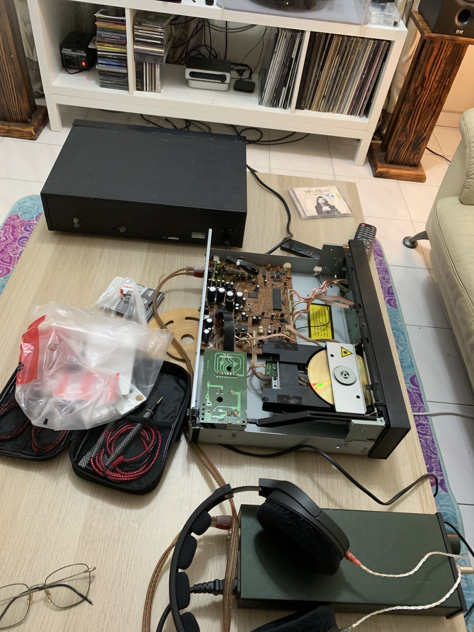

Finally both units works. The 230v unit was littered with cold joints especially on voltage regs. Some capacitors for the loading tray motor and spindle motor were replaced and it runs well.
Both still has the original lenses and they aren’t showing signs of failing yet.

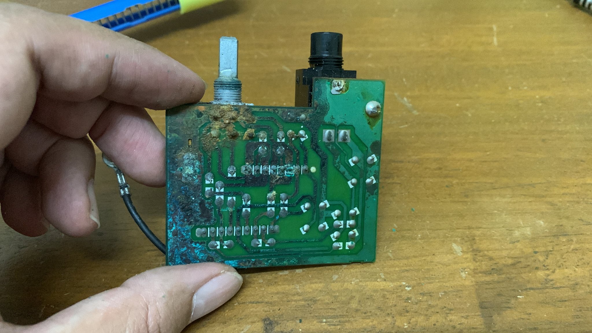

The only thing I couldn’t save is the extremely corroded headphone output.
Either way I installed the bare headphone socket and volume knob to the front faceplate so it still looks stock.
All in all, I would recommend the Nakamichi CD4 if you can find them for cheap. Sounds great.
