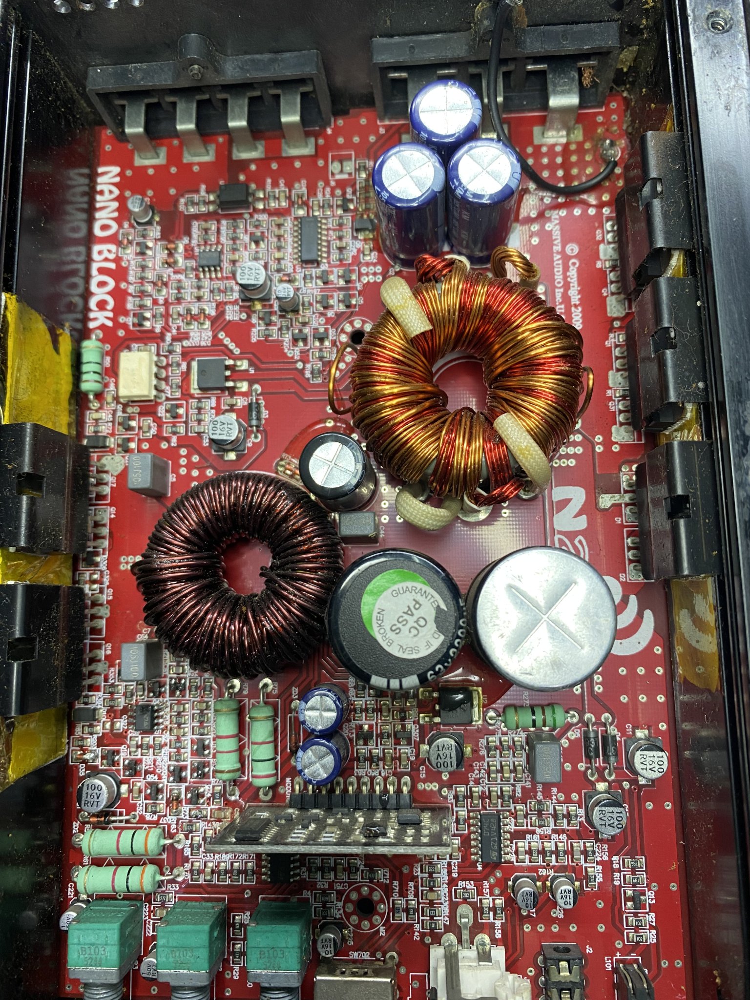

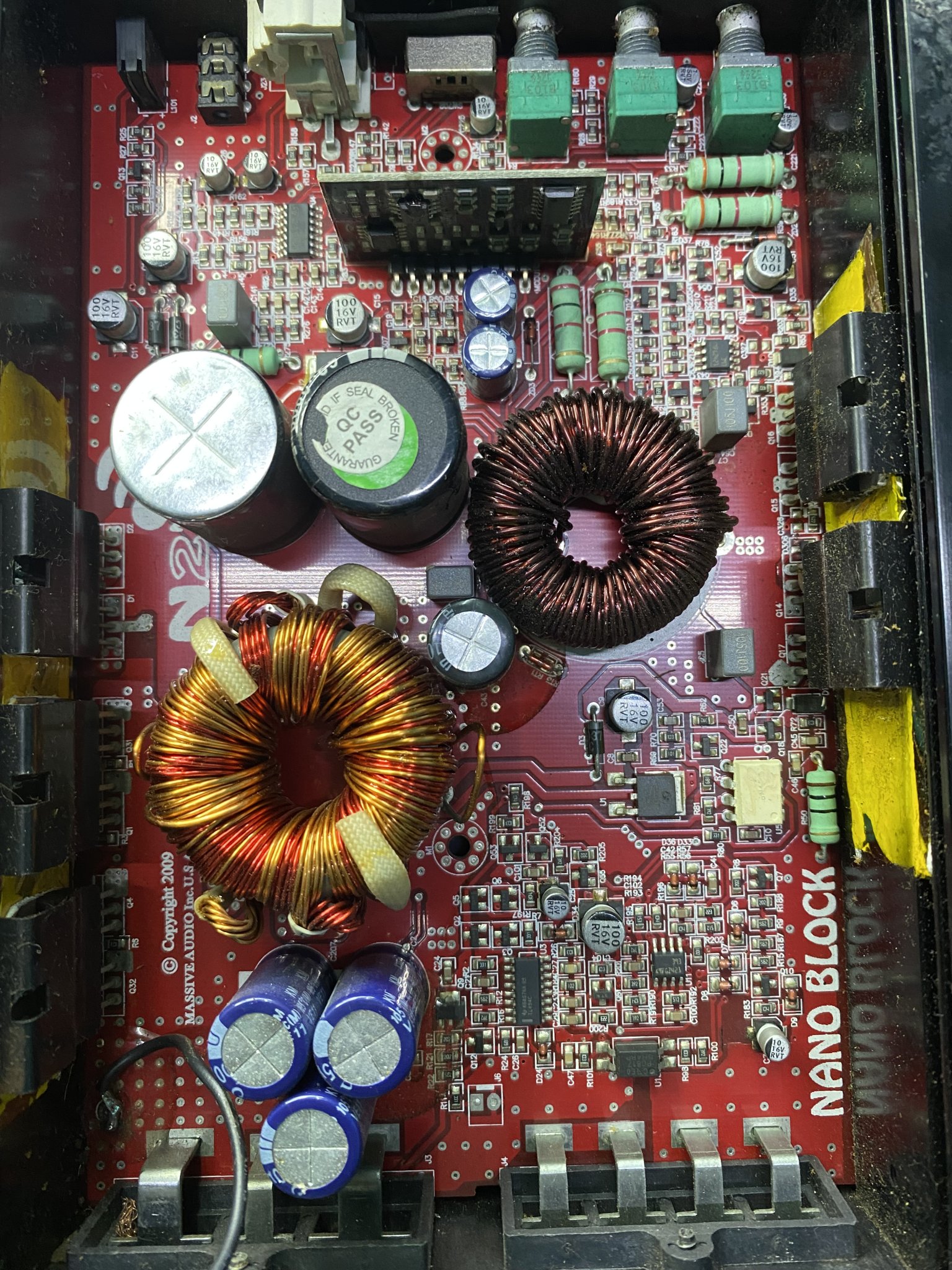

This amp has no output.When I power it up the first time I saw oscillation on the high side but nothing on the low side.Now am not seeing no oscillation on the outputs.Rail and low voltages look ok.I didn’t spot any bad part yet.
Any suggestions?

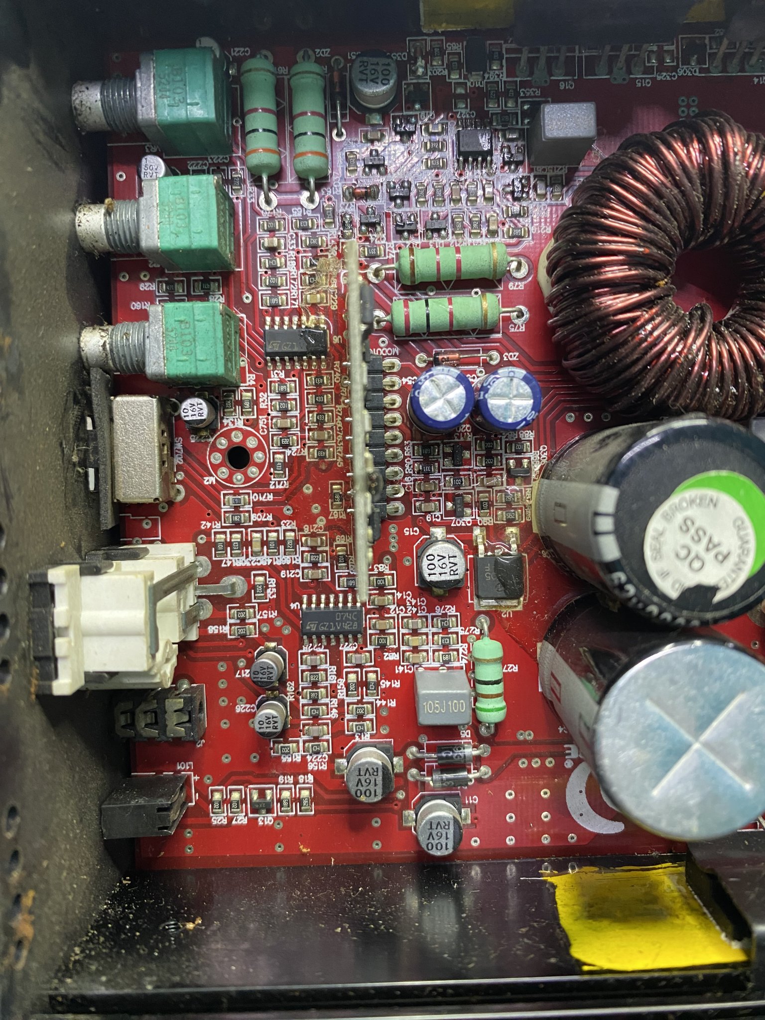

I get audio on some pins of the driver board.
I don’t know which is the mute pin.
Pin one being the first on the left with components facing you.
Pin1: -1.543
Pin2: 0.000
Pin3: 0.000
Pin4: -12.03
Pin5: 12.25
Pin6: 4.94
Pin7: 0.000
Pin8: 4.66
Pin9: 0.220
