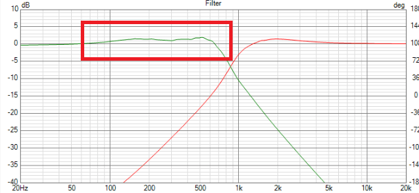

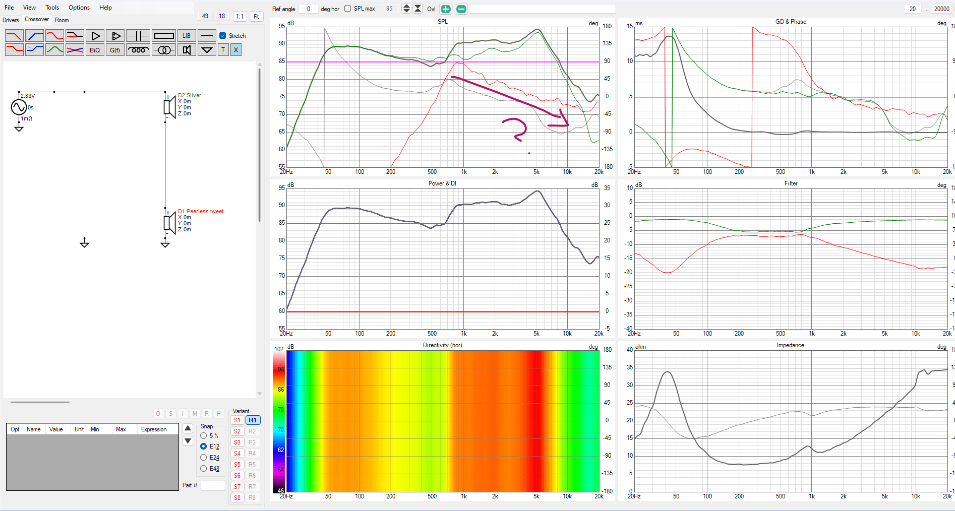

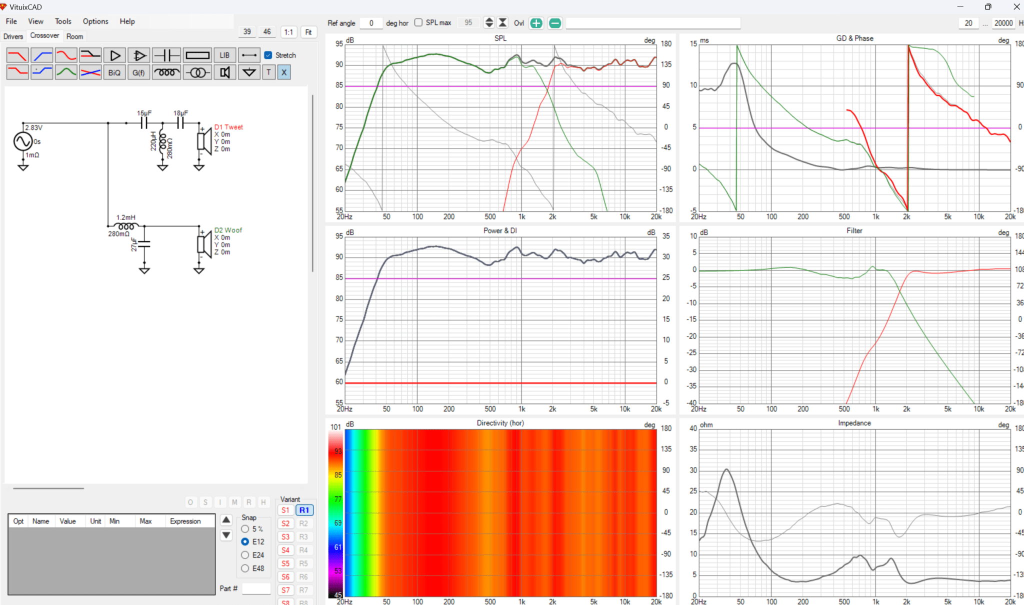

So this will be for an amplifier that work on 2Ω ?!?
You will need something like this, or redesign the crossover.
... and a 3/4 inch tweeter cut under 1Khz ?!? You plan to listen at under 1W total power?
If I have to yes. I will get a 2 ohm Taramps amplifier. This is a very cheap build.
That crossover is just me messing around. I will probably move the XO higher. We will see when I measure everything what the actual distortion of the drivers comes in as.

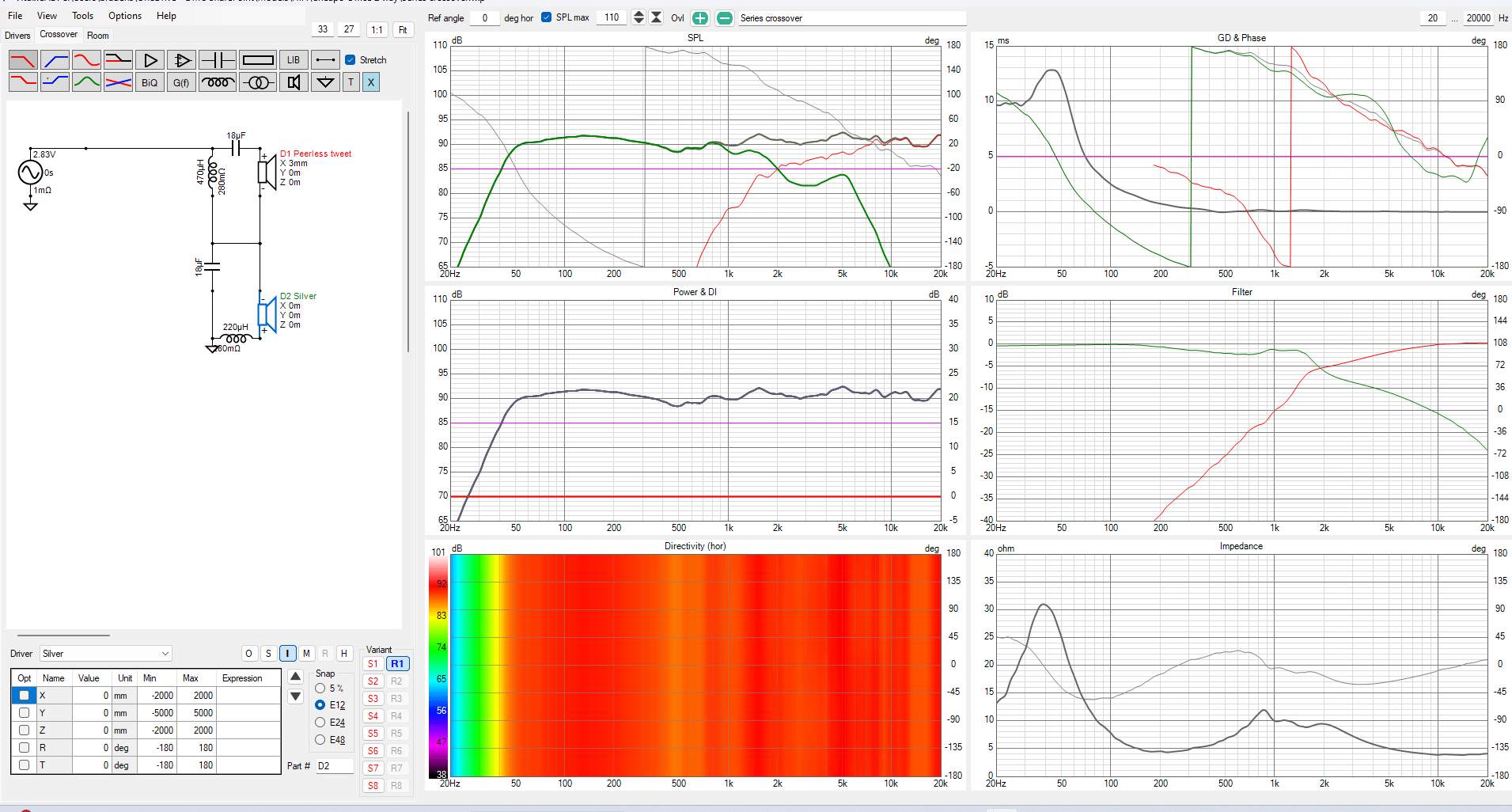

I suppose I could run a series x over..... I have not tried that before.... interesting. Now its gotten a little more interesting.....
A series crossover is more complicated than a standard xo. It is not just wiring the driver's in series. (I have never attempted one.)
However, a standard xo should be fine, you probably just need to refine your initial attempt. Using two 4-ohm drivers should allow you to create a 4-ohm 2-way speaker. The rule of thumb is to not go below 80% of the nominal impedance, so just keep your system impedance above 3.2 ohms.
I am by no means an expert. I merely thought series would help with impedance. The actual crossover details would take a lot of experimentation. I am by sheer luck and trial and error currently using a series crossover in my OB 3-ways. However, I started with concepts from very capable designers and played with Xsim until I found something encroaching on the universe of reasonable. Your attempt looks promising, though the parallel one has much less overlap.

The built in waveguide lets me cross it quite low. Under 2k. This should, in theory, sound better that crossing it over inbetween 2-5k which, I am told, is not the best place to cross drivers since hearing is sensitive there.
You were told wrong. Scrap the design and start over. 100 uF in the woofer LP is a bad idea.

Here's a paralell and I'm right at 4 ohm. Just had to go 3rd order on the tweeter. Probably best since I'm crossing it so low.A series crossover is more complicated than a standard xo. It is not just wiring the driver's in series. (I have never attempted one.)
Looks like a good start.Here's a paralell and I'm right at 4 ohm. Just had to go 3rd order on the tweeter. Probably best since I'm crossing it so low.
Depending on your answer to AllenB's question...may need to add y-offset.
If you use an air core inductor on the woofer that will add some DCR and i think raise the impedance a bit.
If you need to add a padding resistor to the tweeter, that raise the impedance a bit.
Overall, I doubt a low impedance will be a problem.
