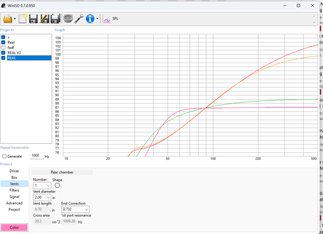

I didn't enter the Cms into Winisd. It generated it using other parameters so I think I'm ok. Madisounds example boxes does line up with the sims.On the 3rd picture the Cms can't be right?! Not on the PC to check the TSP right now.

I'll see if I can find posted specs elsewhere, however, when I enter the posted specs on madisound and run the simulations of their suggested boxes I get back exactly what they say.I suspected that. But that very likely suggests even more that the parameters are not correct. It's so far off it's probably one value in which the decimal point is ignored (comma vs point) or it's a wrong unit (m/ft or m instead of mm etc).
If it's this bad it might very well be a bad batch of drivers.

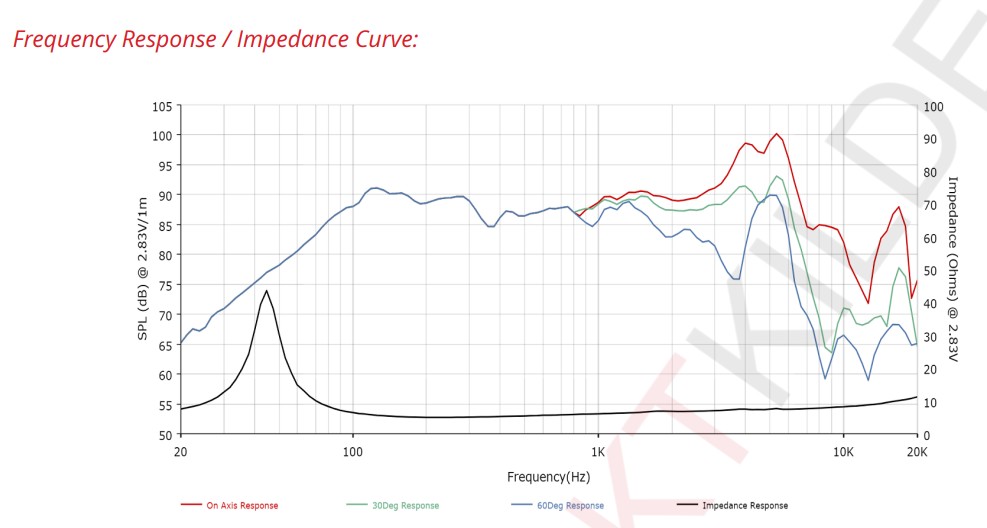

Might it be possible, when you've traced the impedance you've used the left y-axis values instead of the right?

No, when I traced it I used vituixcad which has different bars for the impendence in the trace tool.
This has no bearing on the Theile Small parameter nor the WINISD simulations of which there is, currently, a huge descrepency between marketing and real life.

After burn in everything changed. Pink line is off of thiele parameters after a 10 hour burn in track. Green line is simulated off of specs posted on Madisound. The rest of the lines are taken off of new woofers that have never been played.

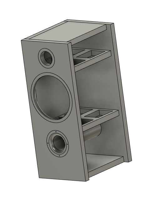

Now to build the most boring box ever..... actually not, I might do something fancy with the edges to reduce the diffraction but haven't totally decided yet.
- A boring 2 way build
