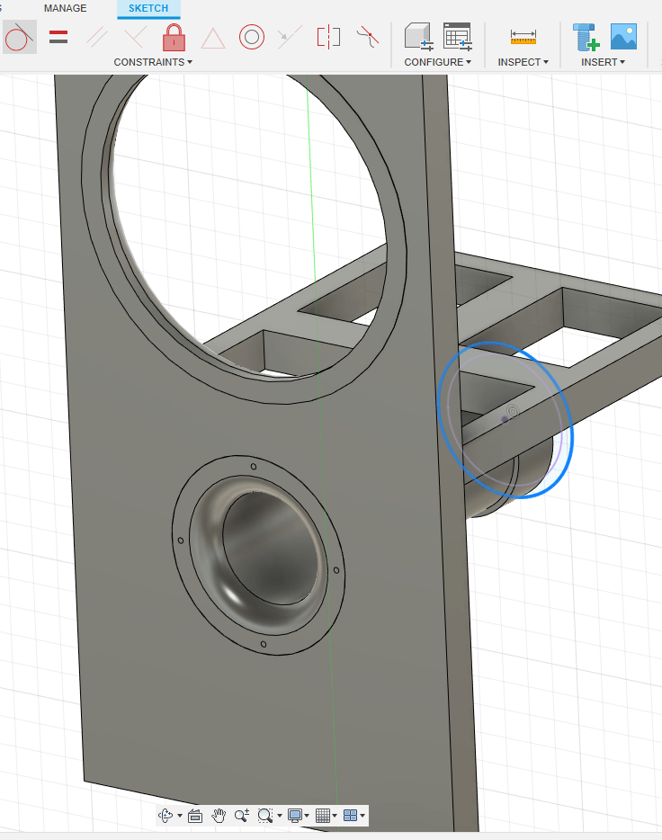

Yes.Is this enough space behind the port?
It might result in a very slighty reduced tuning frequency (but you don't need to worry about that, your room influence will be huge compared to a tiny tuning variation).
But you definitely should add a flange with roundover at the inside port end, if you can.

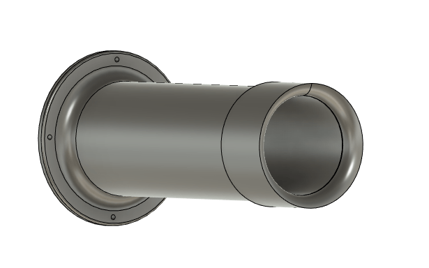

I need your opinions. I can flare in the inside of the port but if I do I will have to move the port away from the woofer.
So do I keep it close to woofer or do I move it another half inch and flare the port out?
Alternatively I can flare it a tiny bit, like 1/4 inch, and not hit the brace, leaving the port as close to the woofer as I can get it.
That's not important, considering the wavelengths of the useful port output.leaving the port as close to the woofer as I can
It does however make a difference for the "bad" midrange output of the port with a peak at port length resonance, thus I would even try to move the port away from the driver, but not too close to the bottom panel (will cause enclosure heigth resonance to exit the port).

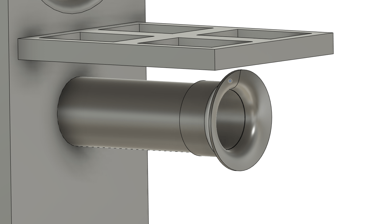

I added this. A little bit of a flare.
I can also move it down and make giant flare.
Now with the port moved down the flare can be bigger. I'll probably just do this.
If that cross brace is where the back wall starts then you are wasting time, effort and performance. Why? Because that close to the back wall it effectively extends the port length and poses a 90° turn in the port. That means your tuning will drop a lot lower, equally to a probably 3-4" longer port and the 90° turn introduces losses. If you reduce the length then the virtual extension suddenly drops and you're too short. If you don't want a bend in your port then put it at the top or bottom or - even better - use a passive radiator which will not have the problem of the mid garbage or port noises at all.

If you get that close as he is here, then it is a lot. You did good experiments but if you repeat that with the back wall instead of a dispersion cone, you'll notice the effect is a lot stronger, none of your examples and measurements come even close to this build.
I haven't found such drastic changes (3" - 4" longer port?). Especially when moving the port slightly in relation to a brace.If that cross brace is where the back wall starts then you are wasting time, effort and performance. Why? Because that close to the back wall it effectively extends the port length and poses a 90° turn in the port. That means your tuning will drop a lot lower, equally to a probably 3-4" longer port and the 90° turn introduces losses. If you reduce the length then the virtual extension suddenly drops and you're too short. If you don't want a bend in your port then put it at the top or bottom or - even better - use a passive radiator which will not have the problem of the mid garbage or port noises at all.
Whilst bends in a port are not desirable, they can be accounted for in the tuning. I don't have hard data that relates "each bend adds X% additional resistance, which results in a tuning change of Y and port length adjustment of Z" data.
If the OP wants to avoid contamination from a shelf brace, dowel (or MDF bracing - say 30mm x 18mm pieces) can be just as effective IMHO
It looks like the distance to the back wall is well below the diameter of the port, in which case you're reducing the effective diameter of the port - which does lower the fb significantly, I'm sure you are aware of.
That's why I mentioned "minimum port diameter away from walls / edges". I thought your comment was the port "Entrace" in the box being in close proximity to the shelf brace.

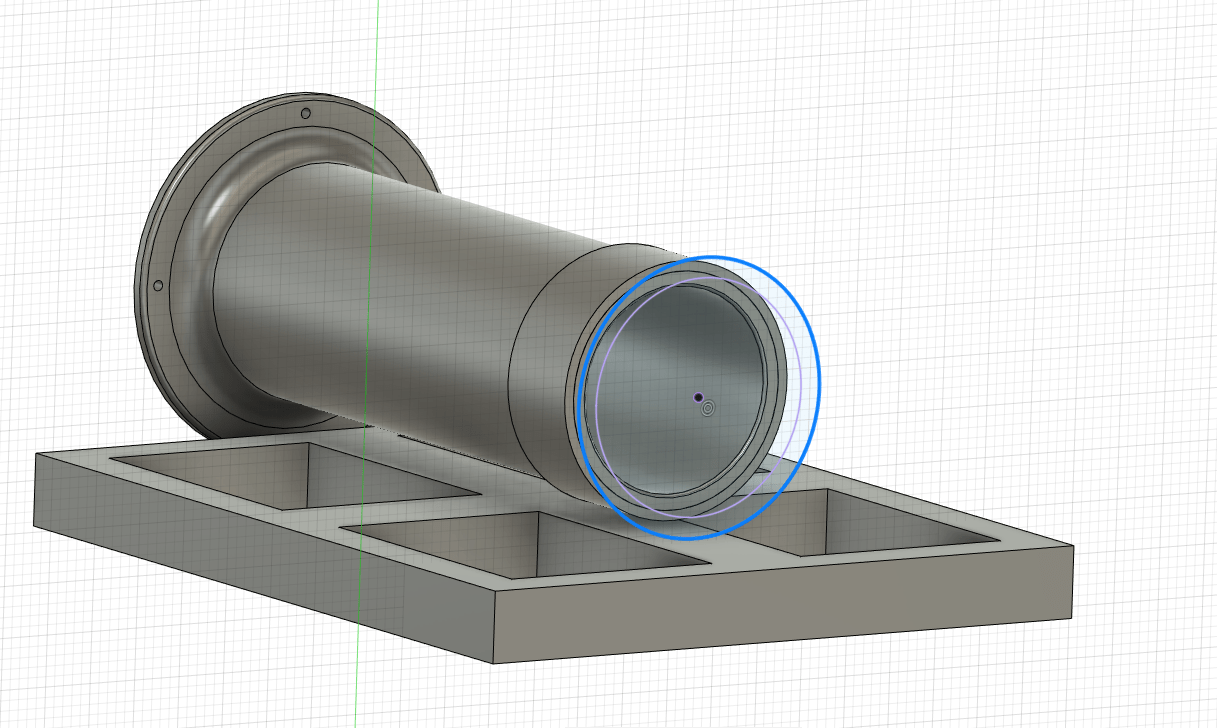

Yes, I can push 40 watts before I cross xmax. I won't chuff with a 2" port as long as I flare both endsHave you modelled the port velocity at the expected max power? and also checked cone excursion? i.e. for your desired tuning, this is telling you whether the port has a large enough diameter to avoid chuffing. Being under 17 m/s port velocity is conservative / pretty safe.
This thing will likely never get played at full power. At 1W its at 92 DB.
I think I have it far enough away now. Its lower down and the braces are not actually window braces. I cut them out differently.If that cross brace is where the back wall starts then you are wasting time, effort and performance. Why? Because that close to the back wall it effectively extends the port length and poses a 90° turn in the port. That means your tuning will drop a lot lower, equally to a probably 3-4" longer port and the 90° turn introduces losses. If you reduce the length then the virtual extension suddenly drops and you're too short. If you don't want a bend in your port then put it at the top or bottom or - even better - use a passive radiator which will not have the problem of the mid garbage or port noises at all.

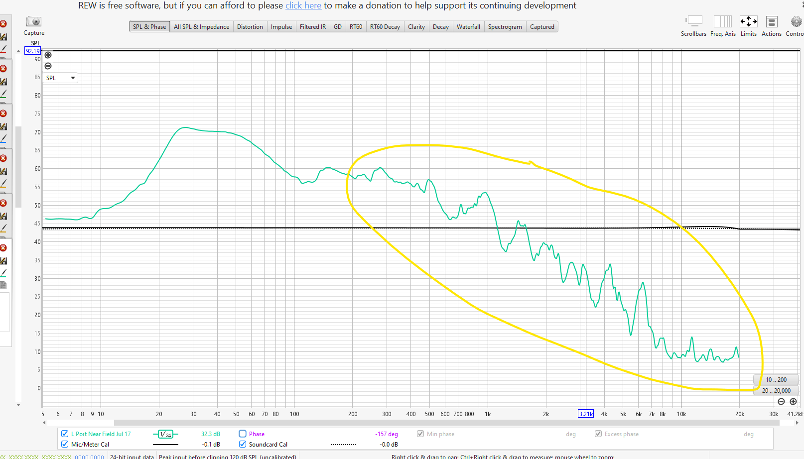

Is this the mid range (yellow) you are trying eliminate from the port? So you put it on the back so all these frequencies die off since they are much more directional than the lower frequency range?
This is a measurement of my port from my last build.
