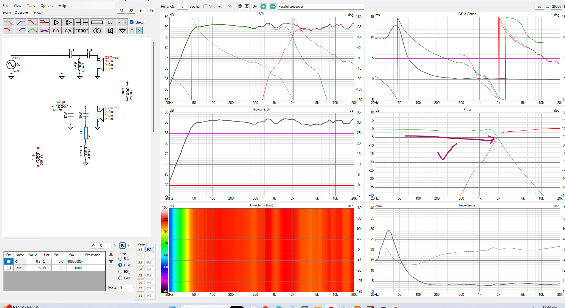

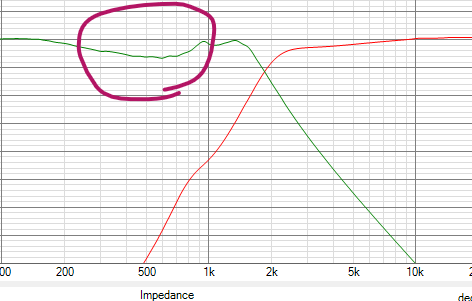

I don't really understand this impendence dip that is causing my XO to go all funky. I'll pull the theile small parameters as I don't think the traced impendence is correct
How does your crossover look like?
It does not appear to be impedance, at all.
Yes, that's not the impedance but the frequency response.
I think he meant that the impedance is low in that range and causes the dip in the FR.
It is the filter (transfer function?) and labeled impedance in the VituixCAD pane, which is why he is saying "impedance".
Try increasing the coil and reducing the capacitors from woofer filter. Adding a small capacitor (eventually series with a small resistor) in parallel with woofer coil to create a notch at ~5Khz will attenuate the peak in woofer response.I don't really understand this impendence dip that is causing my XO to go all funky. I'll pull the theile small parameters as I don't think the traced impendence is correct
That's not an impedance dip. That graph is the transfer function. Essentially what your crossover components are doing to attenuate the response. and therefore shape the final acoustic response (top left) of the drivers which sum to the overall system response.I don't really understand this impendence dip that is causing my XO to go all funky. I'll pull the theile small parameters as I don't think the traced impendence is correct
The bottom right is your impedance by frequency. If you are using a solid state amplifier, then a "rule of thumb" I've seen from others is to keep the impedance phase to <= 45 degrees. A flat impedance does this, but having peaks in your impedance isn't a problem for many sold state amps, as long as the impedance phase isn't swinging wildly to extremes (e.g. >= 60 degrees)

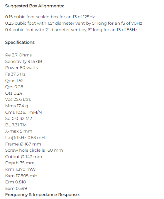

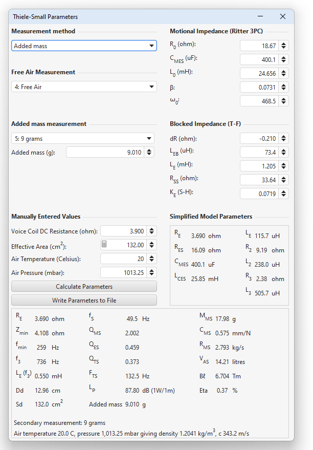

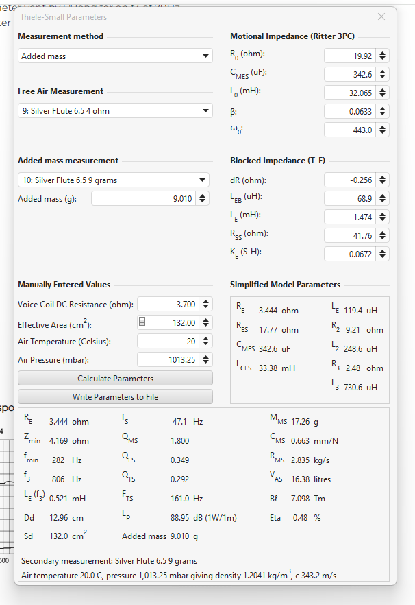

Has anyone EVER seen a driver's stated Thiele small parameters off this far? Green line is with stated specs. The rest of them are what I actually measured. I added 9 grams to the cone.
I am attaching the impendence measurement so you all can see for yourself.
This is so far off I feel like I did something wrong. But I know I didn't...

Did you break in the driver? If so how? You need to wait briefly depending on how long / hard you break it in to let the voice coil cool and reduce resistance due to heat.
Some driver manufacturers use a higher level drive voltage (power) for TSP measurement (even though they are small signal parameters!). For example, I can never get my SB Acoustics drivers to measure as per factory via DATSv3.
Also - I believe delta compliance (known sealed box volume) is more accurate than added mass for TSP measurement, but whether it can make up for that discrepancy, I'm not sure.
