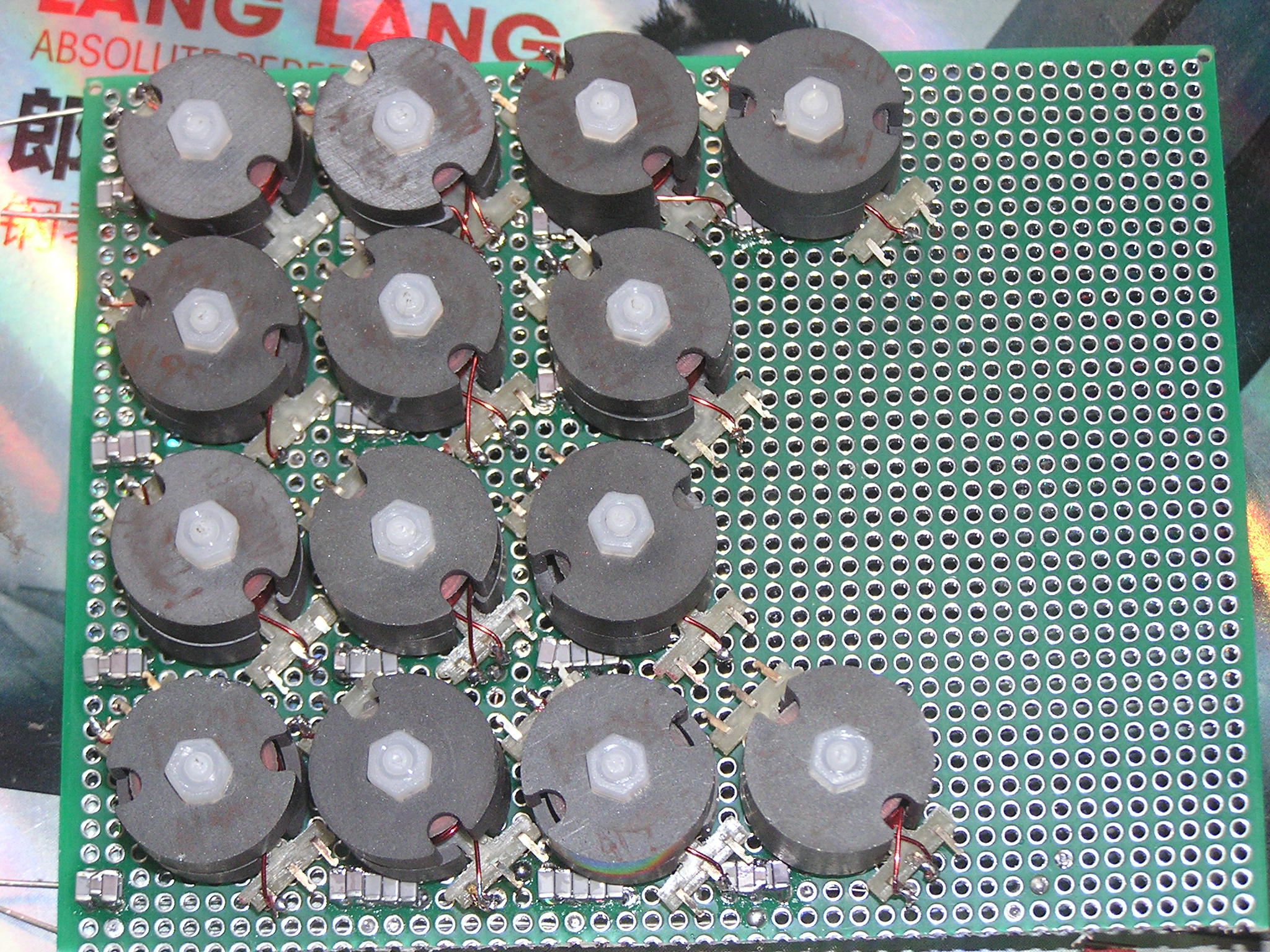

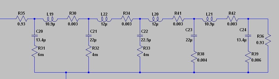

Just for fun - an ultra-low impedance AIF
Posted 18th June 2014 at 11:40 PM by abraxalito

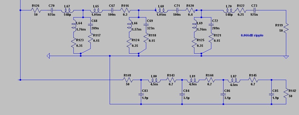

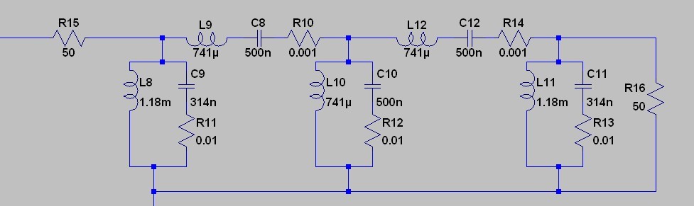

DIYing high enough Q inductors for anti-imaging filters is a bit of a challenge so here's another way to approach this. I found its possible to build very high Q inductors by simply slipping ferrite beads over a fairly thick copper wire. The limitation though is that the beads I have offer about 1.2uH per bead. So making a ferrite bead version of a 660uH inductor will call for over 500 beads - rather impractical.
To make such a ferrite bead inductor filter a practical possibility its necessary to work at a much lower impedance. I've taken a 1ohm working impedance inititally to develop this filter. Now the largest inductor just needs 10 beads. Given this very low impedance the post-amplifier's noise performance becomes rather a challenge - but a transformer will probably do the trick nicely. I plan to try this with a 1:7 step up trafo and see how it goes.
This kind of filter is probably very suitable for DACs with higher output current - the communications type...

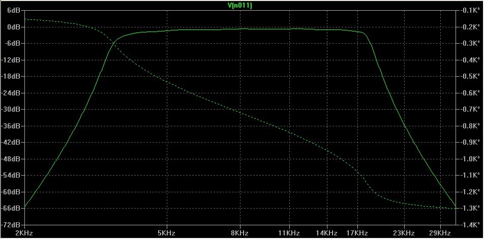

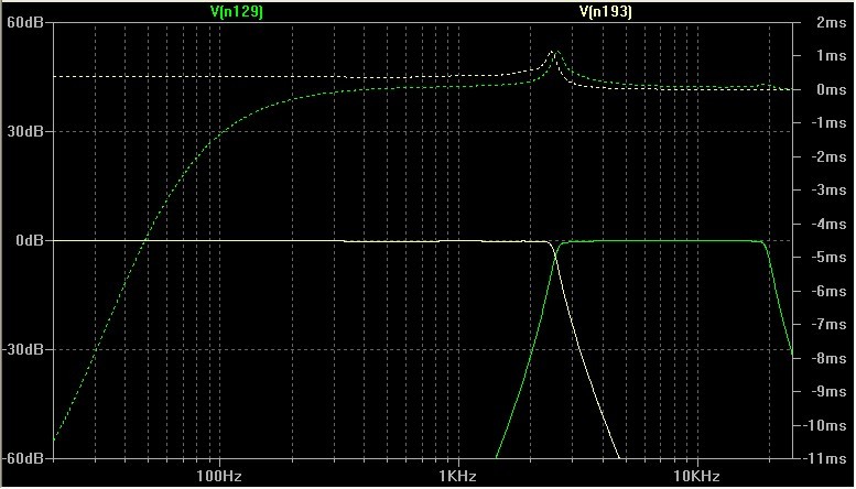

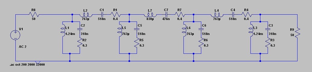

Tweeter line level passive XO
Posted 13th June 2014 at 04:47 AM by abraxalito
Updated 16th June 2014 at 04:51 AM by abraxalito
I'm really impressed with the bang for the buck with my 228rmb speakers, but have a theory they're rather being limited by their crossover. Especially the first order tweeter crossover which hasn't enough LF rejection.
In search of a steeper XO for the tweeter I've decided to go the whole hog and design a kick-*** filter that'll allow me to fully activate these puppies and see just how much they're limited by their electronics. kinku just pointed me to a filter design program called AADE which I've just finished using to design my first LC bandpass filter.
Its bandpass because I want to stick it straight after the DAC and it needs the anti-imaging function, meaning a steep low pass around 18kHz. The tweeter doesn't need this as they're fairly low on IMD, but the tweeter amp sure benefits from having no ultrasonics. Hence here is my first attempt at a tweeter bandpass filter, to go between the DAC and a dedicated tweeter amp.
For now I'll use the TDA1521...

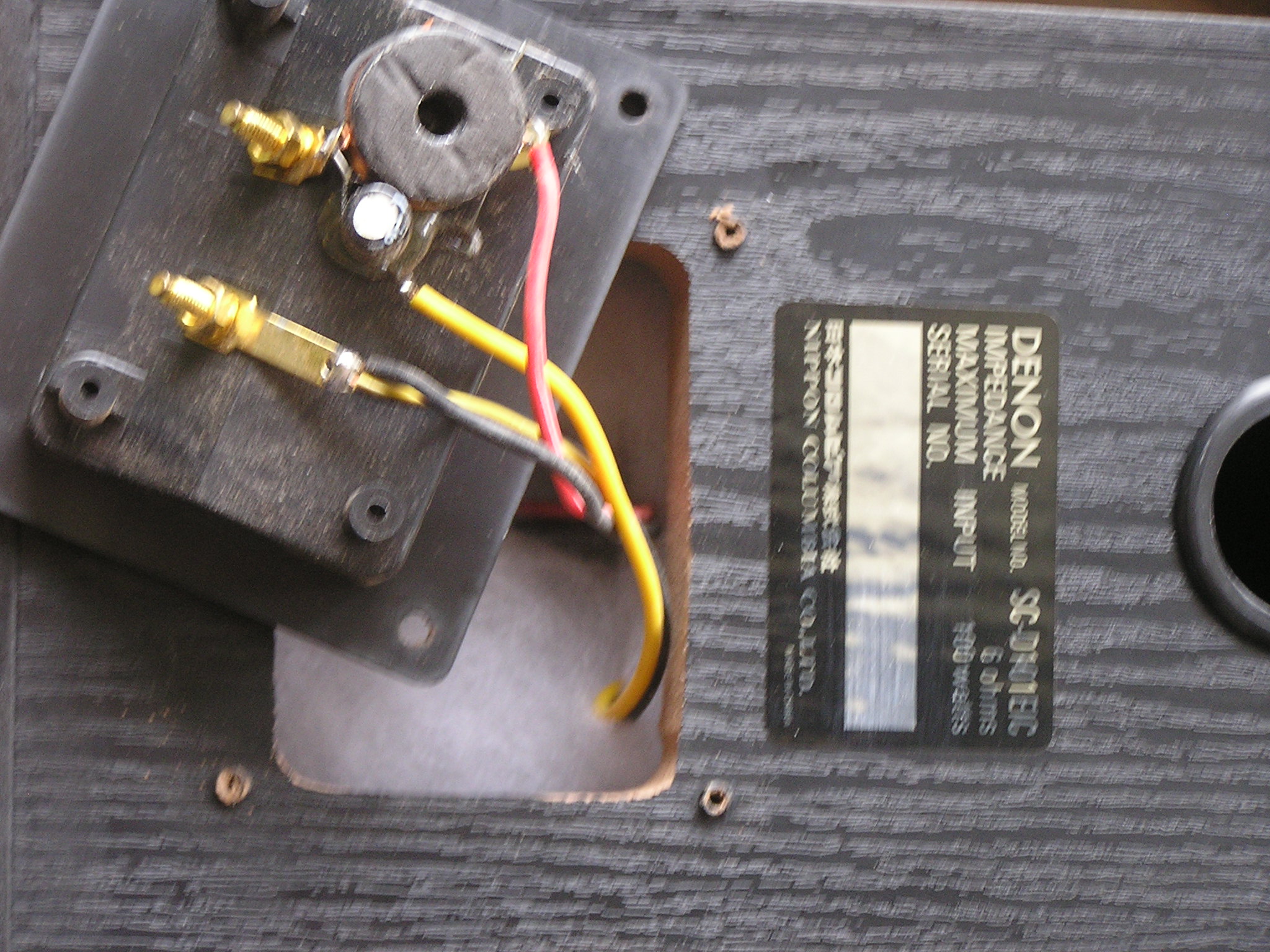

Cheapo passive speakers breaking in
Posted 1st June 2014 at 06:02 AM by abraxalito
Updated 2nd June 2014 at 03:54 AM by abraxalito
A pair of these were delivered yesterday. At first I thought their bass sucked and the top end was too 'phasy' - it was only after a while I realized I'd connected them out of phase
Now they're wired up correctly on my TDA1521 amps, they're starting to come on-stream. I rate them as a bargain at the asking price of 228rmb (around $35).
After they've fully broken in I plan to explore what the lowest hanging fruit is by way of tweaks to the crossover....
Update1 - here's the XO, very simple 1st order. 250uH inductor on the bass (0.1ohm DCR, 6ohm bass/mid) and 1.5uF cap for the tweeter (8ohm). The NP cap for the tweeter has a rather high ESR (3ohms at 1kHz) so there might be some mileage in substituting this for a foil cap.
Plotting this arrangement on LTSpice gives a crossover frequency (if -6dB) around 7kHz which seems a little high. If we were to assume a -3dB crossover (because they're in quadrature for a 1st order) then it would...

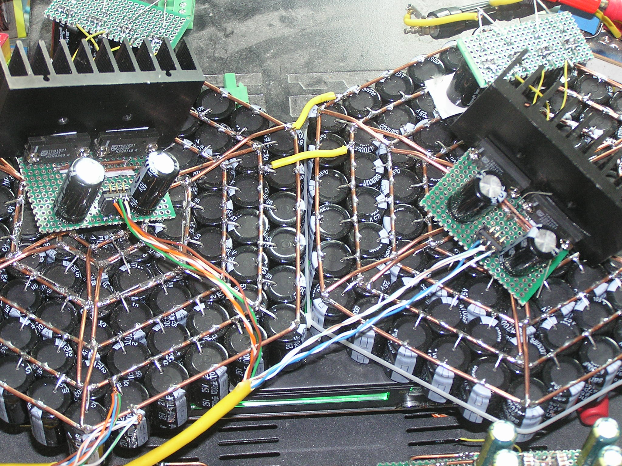

Posted 23rd May 2014 at 03:13 AM by abraxalito
Here's my prototype TDA1521 dual mono arrangement - two chips per channel in bridged/parallel, sat atop 400,000uF hexacaps. The neutrality has taken a while to get used to but I'm lovin' em....

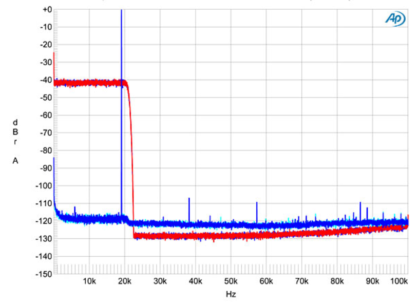

Posted 9th January 2014 at 03:59 PM by abraxalito
John Atkinson's 'WOW!' (more than once) to his measurement results from the Vivaldi DAC prompted me to have a closer look at how it does for noise modulation.
The AP's FFTs shown don't come with details about the number of points in the FFTs, so noise estimates are a tiny bit tricky. However there is enough detail to make some reasonable estimates.
I've attached the plot from which I'm making my estimates - if anyone notices I've made a slip-up, please do comment and correct me.
The red line shows white noise at peak level of -4dBfs. I generated white noise in Audacity at this level to compare - with the maximum 16k point FFT and BH windowing, I got the same level of noise as on this plot - -42dBfs in 22kHz bandwidth. That suggests to me that the FFT shown has 64k points.
Another way to estimate the noise is by looking at the difference between the blue plot (19.1kHz, 0dBfs) grass and the red. To my eye, the difference in level is 76dBr...
