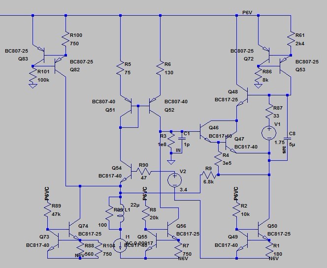

Discrete transistor based CFB I/V stage
Posted 25th September 2015 at 01:56 PM by abraxalito
Updated 26th September 2015 at 01:35 AM by abraxalito
Since I figured out the reason for needing all those caps in my earlier DAC designs was all brought on by using passive I/V, I'm now a total convert of active I/V in order to do away with the sheer bulk.
Having tried single transistor I/V and loved it, I found there was still some improvement to be gained by biassing the common-base transistor with additional current sources to reduce its input impedance. Since getting down to the region of 1ohm would require some 25mA of bias which isn't well suited to portable applications I decided to have a go at using feedback to obtain the impedance I'm seeking.
I'm not using an off-the-peg CFB amp because they still turn out to be fairly power supply quality susceptible (subjectively speaking) so here's a design I hope that greatly reduces the supply impedance requirements so that it can be used in a portable player.
The picture shows the second prototype I/V stage, coupled to a 6th order Chebyshev anti-imaging...

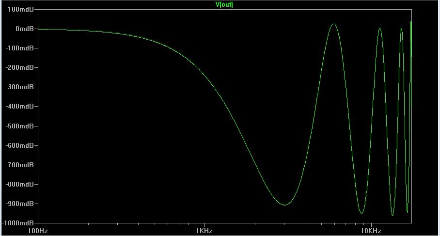

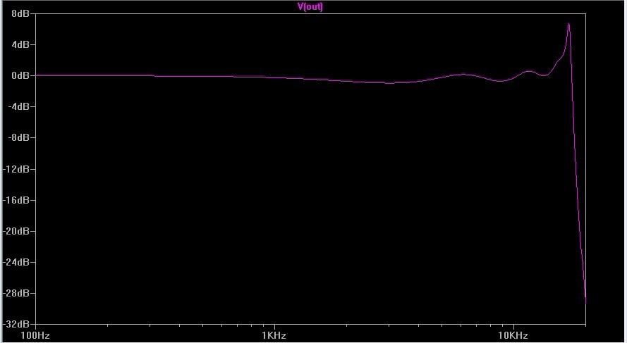

I've been getting a lot of use out of Simon Bramble's webpage for designing active filters recently - https://www.simonbramble.co.uk/techar...ter_design.htm. Its a great resource.
Right down at the bottom of the page the last filter he shows the schematic of is a 9th order Chebyshev, 1dB ripple, with a corner frequency of 1kHz. A textbook frequency response plot is obtained using LTC6241s. I latched on to this and tried changing the corner frequency to 18kHz, wondering if I could use such a design for an anti-imaging filter for my DACs. So I divided all the capacitor values by 18 and ran the sim. Disaster! The frequency response I obtained is below - a 7dB spike at 17kHz.
The problem seems to be inadequate Q - high order filters are composed of sections which increase in Q (more positive feedback) and the chosen opamps aren't fast enough (18MHz GBW). I went to a faster opamp for the highest Q stage which brought about some improvement...

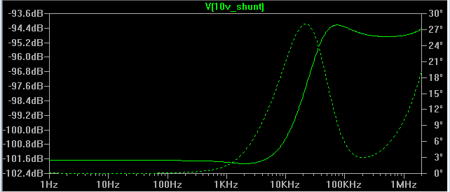

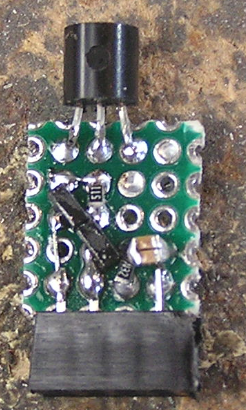

Force/sense shunt
Posted 24th April 2013 at 08:35 AM by abraxalito
Updated 24th May 2013 at 03:59 AM by abraxalito (Added pics of prototype fs-shunt. Added noise update.)
I'm a recent convert of the lowest possible impedance of power supply based on my experience of adding caps to my chipamp. So I figure the signal stages can't be harmed by reducing their supply impedance either, particularly at LF.
I note there are a few aftermarket regulators around - I had a look at Paul Hynes and Belleson in the past few days. They're a bit pricey for my tastes, given the cost of the components they're using can't be over single digit $ so I've had a look at "doing it at home, only cheaper".
First off, a simple TL431 is about the best bang for the buck achievable, as the part here is 0.2rmb. But the dynamic impedance is typically 0.2ohms and I was hoping and aiming to go a bit lower than this - perhaps an order of magnitude lower, to around 10mohms. Lower than this and the resistance of the PCB tracks come into play and its also very hard to maintain such a low impedance beyond the audio band as cap ESRs (for the best ones) are of...

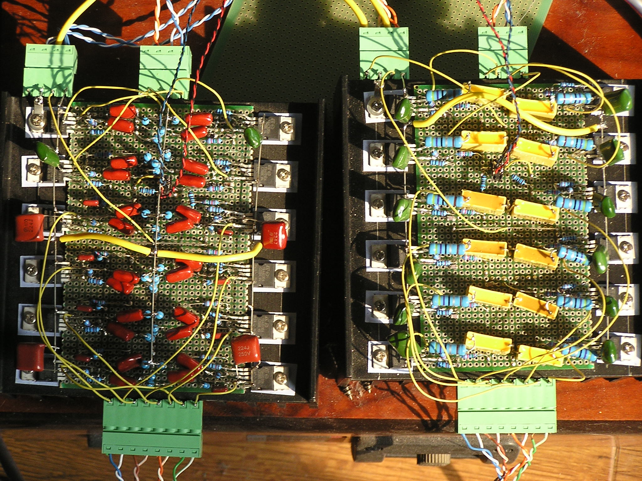

Its not something I claim originality for, this use of Cat6 cable for running to speakers. What though I believe is original is combining the function of speaker cable with the sharing resistors - I've seen that nowhere else. Remember guys, you saw it here first
Not only does this save on having low value fairly high power resistors but it comes with another benefit which suits diyers. That's the fact that the amps can be easily tested separately - they're not going to be in parallel until the drive unit is connected to the output, since the cables join together only at the far end, at the terminals of the driver. I've certainly found this an advantage in development - the individual gains I've checked with a multimeter between the outputs when playing a 400Hz sinewave. This frequency was chosen because I'm too lazy to check the frequency response of my multimeter and I wanted a mid-range test.
The gains of the individual chip amps do need matching very...
