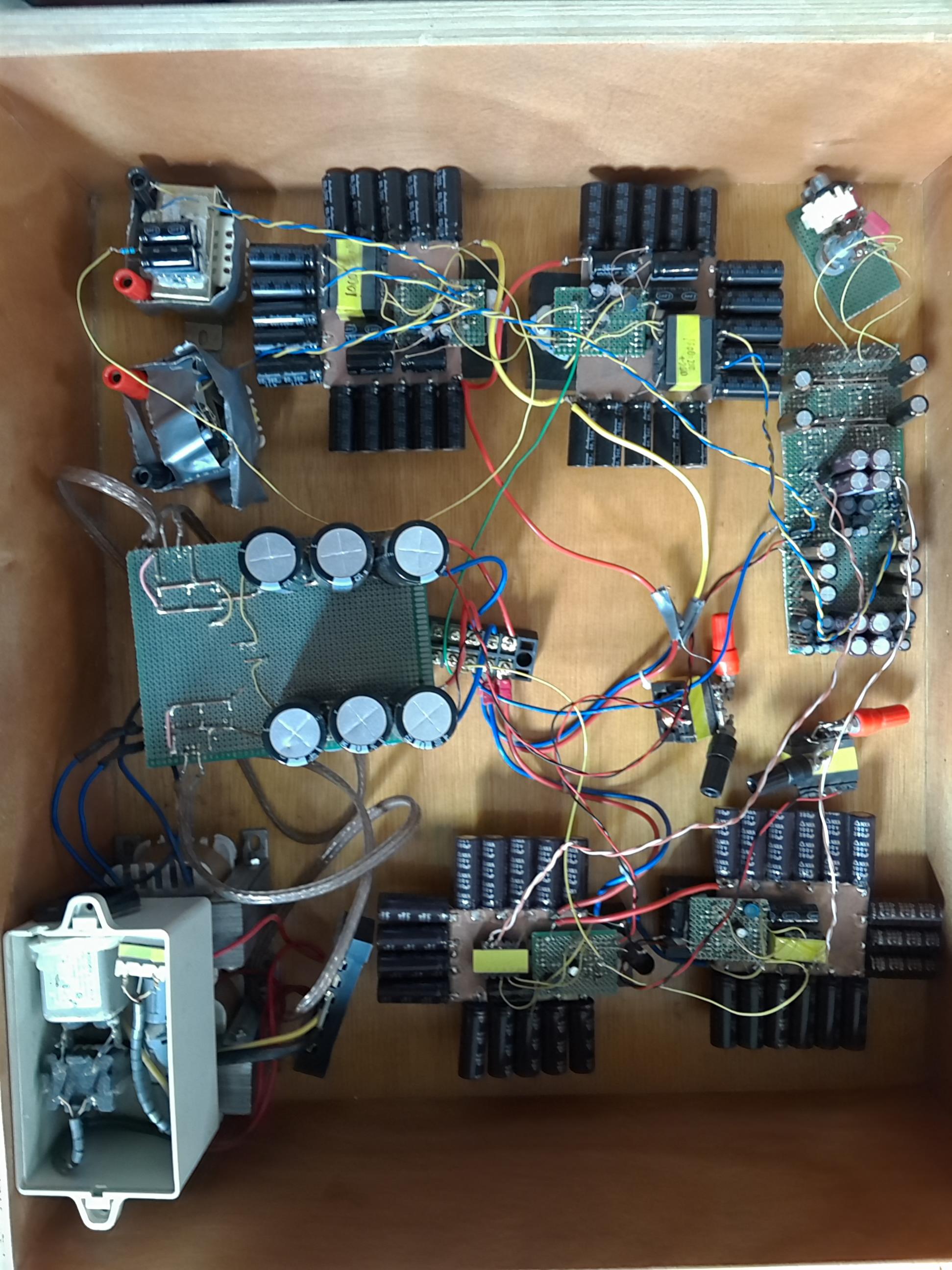

I've not posted for a few months here as I've been involved in moving apartment which was quite a major project given the quantities of parts and assemblies I've accumulated. Even though I've been in my new place for over two weeks now, very little has been unpacked so far, but I have just yesterday rebooted my desktop active XO/amp system which had been quite literally assembled on my desktop with no casework whatsoever Its still without casework and survived the move with only a few wires falling off but now 'installed' in a drawer (pic attached). Its being fed from my 'Domino' balanced TDA1387 DAC and Taobao TFcard player and delivering bags of emotional satisfaction through stand mounted '3Nod' two-ways.
The amps are all LM4766 bridged running from 60V total but with heroic measures to keep supply noise under control, the central PSU has a CLC configuration and ferrite input transformers are used for coupling between AXO and amps. Output transformers (ferrite for...
