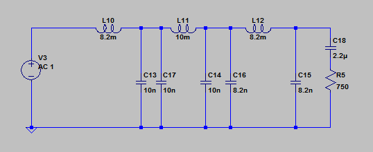

Goosebumping headphone DAC-amp
Posted 31st October 2016 at 08:42 AM by abraxalito
Updated 1st December 2016 at 04:23 AM by abraxalito
The Intersil D2 chipset based amp arrived and while it sucked pretty badly on speakers I had a hunch that like the STA333BW boards I've been playing with recently, it would acquit itself admirably on headphones, given the much lower demands on the supply.
The mods I've done to this are fairly straightforward - changing the output filter to work more optimally with headphones (via a 7:1 step-down transformer) and tweaking up the power supply a bit.
To run with cans I went for an output load impedance of 1100ohms. This was determined primarily by the choice of inductor (MSS1210 8.2mH from Coilcraft) which in turn was chosen so that the carrier frequency would be below the SRF of the coil. This choice is fairly arbitrary in that the inductor would still work fine above its SRF just it's starting to look like a capacitor. However it turned out that with 8.2mH the cap value required was fairly simple, 5nF so I stuck two 10nF NP0s in series.

Using a digital amp as a DAC
Posted 28th October 2016 at 03:19 AM by abraxalito
Updated 4th November 2016 at 03:03 AM by abraxalito
I've been mighty impressed with the STA333BW board (just 62rmb on Taobao, see an earlier post for the link) driving headphones via a transformer (ferrite cored step down 7:1, I've tried various sizes). So much so that I don't much feel the need to upgrade my headphones beyond my Superluxes (HD668B). The sound I'm getting is immensely satisfying - rich (which I got from my TDA1387-based DACs, but not from my phone with its ES9018K2M, that doesn't qualify as rich in tonality) and dynamic beyond anything I've so far heard. I noticed in a recent thread post by TNT (here - https://www.diyaudio.com/forums/vendors-bazaar/283672-new-audio-op-amp-opa1622-6.html#post4868193) he says he doesn't much like listening on headphones due to the 'in-head' quality of the sound. Yeah I used to get that, transformers pretty much get rid of it giving an out-of-the-head-all-around-holographic kind of experience, along with stupendous dynamics. I like listening to classical piano and that's very demanding...

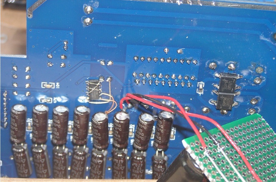

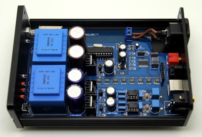

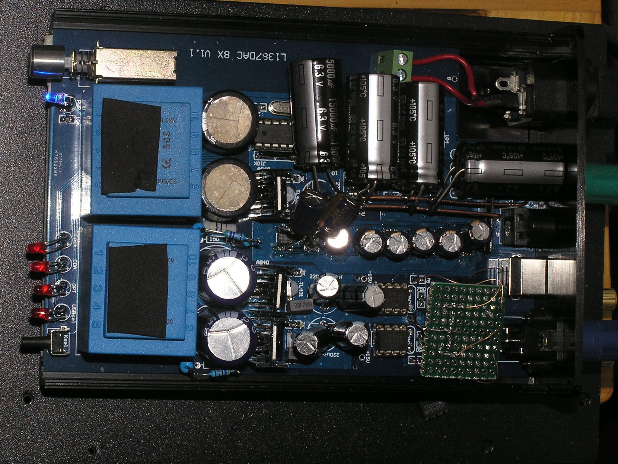

TDA1387 octal DAC looks like a good modding base
Posted 16th January 2015 at 12:55 AM by abraxalito
Updated 28th August 2015 at 01:16 AM by abraxalito
Thanks to Matthieu (Malefoda) for the heads up on this. It looks distinctly like a DAC inspired by the DAC-AH - note not only the 8 DAC chips but also the PCB layout closely follows that design's. The price on Taobao is about half the AH (368rmb) so I shall be ordering up one or more to have a play. Matthieu found it on another website with prices in USD, here - https://www.cart100.com/Product/42124644877/.
Note there are two options here (blue, black) - the cheaper one is a kit of parts I believe, the more expensive ($84) the finished unit. Going on the translation of the Taobao page, the kit does not include the transformers, mains switch or the case.
Update : here's the summary of the mods so far, for details go to Malefoda's thread linked in the comments.
1) Re-route the output ground so the opamp filtering caps aren't subject to injected CM noise from the destination component (amp or pre).
2) Reduce the supply voltage to the output opamps...

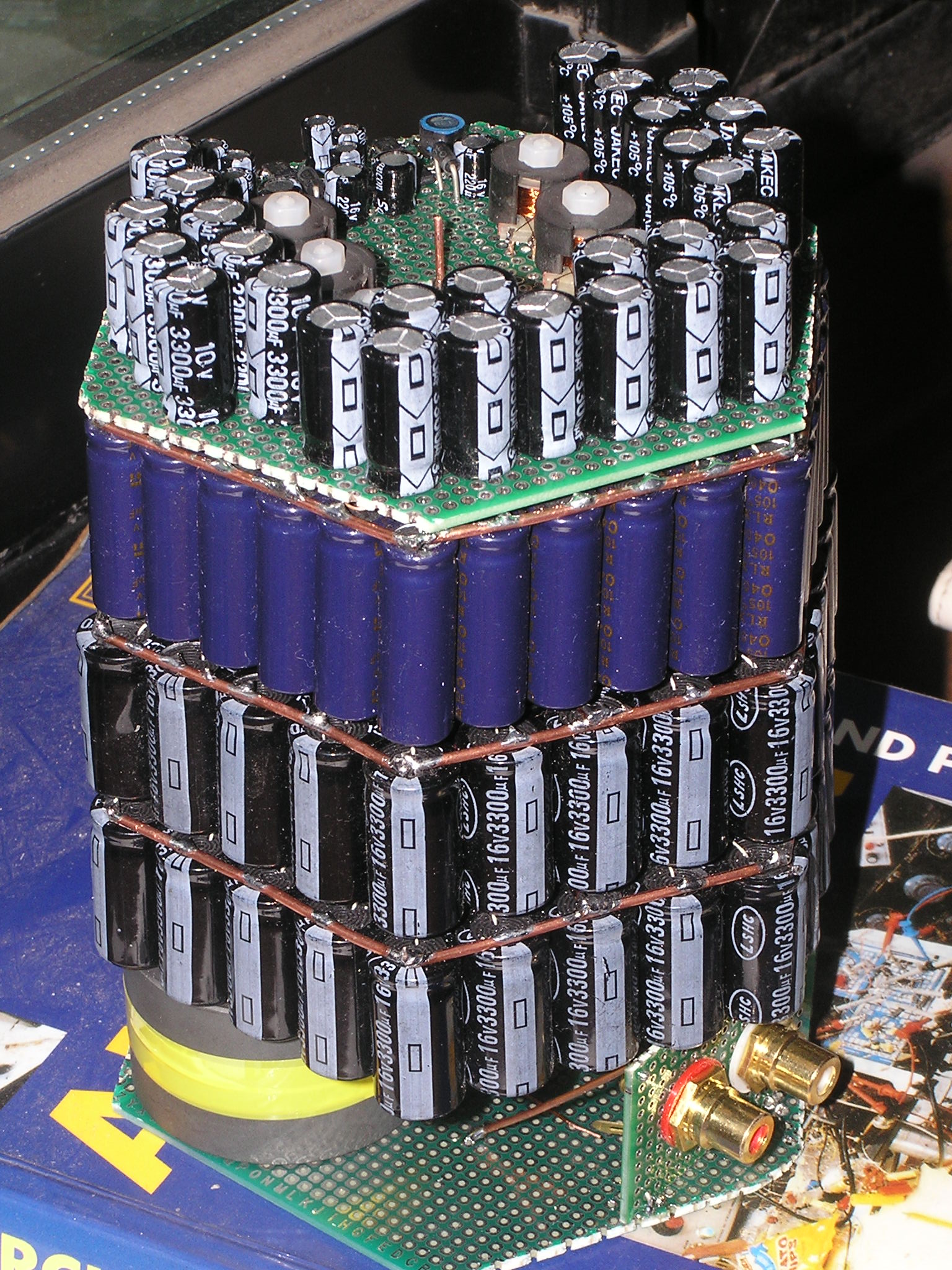

New year, new DAC
Posted 31st December 2014 at 08:36 AM by abraxalito
Updated 3rd August 2015 at 12:50 AM by abraxalito
Here's the 'Ozone desktop pagoda' DAC for 2015.
A single TDA1387 feeds a 3 inductor quasi-elliptic filter followed by AD8017s as buffer-amps. The large ferrite cores in the base do the bal-SE conversion. The power supply is 4 * AA NiMH cells which should in theory last for a whole day's music.
The design is really a 'MkII' version of the Ozone portable where the AD815 buffers have been replaced to allow a more compact construction and lower power draw without the constraint of being able to drive IEMs directly. Whereas the portable used a stack of 1387s due to the choice of 7mm TDK inductors, this one's using pot-core chokes giving a much higher working impedance and hence higher output levels from just the one DAC chip. The desktop footprint is about that of a CD.
Update : I found some bargain Jamicon caps on Taobao which give the tower more elegant proportions, as well as improving the supply impedance to the buffer-amps and giving more breathing...

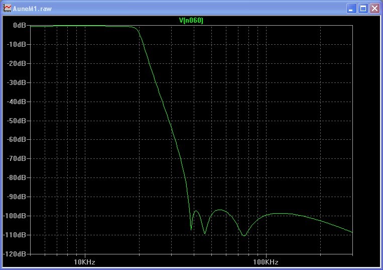

Design ideas for Aune M1 DAC card
Posted 15th November 2014 at 03:51 AM by abraxalito
Updated 19th November 2014 at 06:43 AM by abraxalito
I'll outline here some thinking in choosing the major building blocks (aka ICs) for this card - any comments welcome as this progresses.
First up the DAC chip will be the TDA1387 initially. I don't know for sure that the output from the ARM/Xilinx card is I2S but I'm going to verify that fairly soon. There's nowhere near enough room for the passive shunt I've adopted previously so the bass performance probably is going to have to suffer. I shall pay considerable attention to the power supply arrangements though in an attempt to make up for the LF lack.
After the DAC, passive I/V will follow and then a filter using the TDK 7mm inductors I've used previously. I've slotted them into the gap between the PCB and the case and there's just enough height available. Since space is at a premium I'll experiment with a 3 inductor design - the stop band attenuation will suffer but probably I'll add a secondary LC filter at the output to make up for that somewhat. The secondary...
