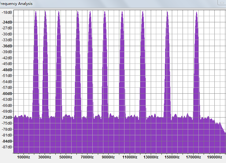

First measurement of NOS droop correction
Posted 27th April 2012 at 06:13 AM by abraxalito
Here's a ten discrete tone test waveform played back into my Sony PCM-M10 then FFT'd in Audacity with 512point FFT.
Audacity reports lower freq tones at -18.6dB and the highest (17.3kHz) at -18.9dB - a droop of 0.3dB. This might be in part my passive (LC) reconstruction filter which I have yet to characterize separately. So it appears to work

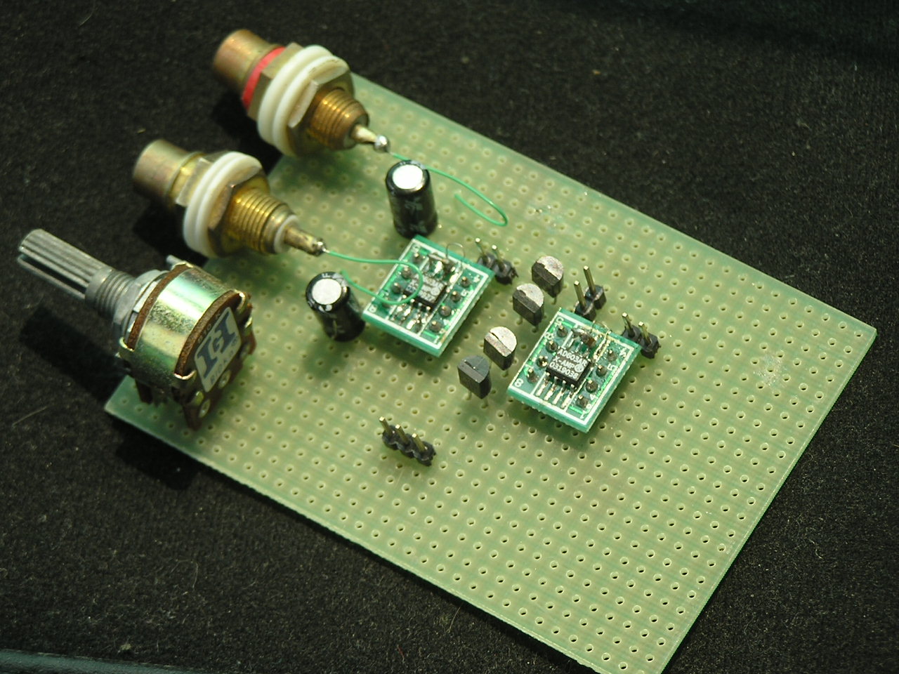

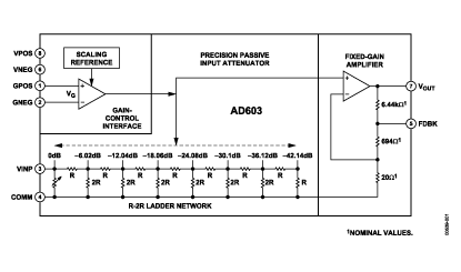

Highly evolved converters - the next generation
Posted 8th September 2011 at 03:47 AM by abraxalito
Its been over a year since I blogged about DACs, so, long overdue, here's an update. I've abandoned my considerable development on the AD1955 because I found something that's more interesting - multibit. In the first instance - NOS.
A while back I bought a TDA1543 NOS DAC to play with, just to see what all the fuss was about with NOS. Plenty of people have waxed lyrical about the sound. At first listen, I wasn't impressed although it had a certain tonal richness in portraying orchestral instruments that was alluring. Bottom line - its soundstage was compressed front to back. This made it sound a little 'forward' - foreground instruments and voices were more highlighted compared to acoustic spaces ('background').
A second aspect which plagues pretty much all NOS DACs is their frequency response can hardly be termed 'accurate' - owing to the sinc function of first-order hold, they exhibit a significant HF roll-off which begins around 5kHz and reaches 3.2dB...

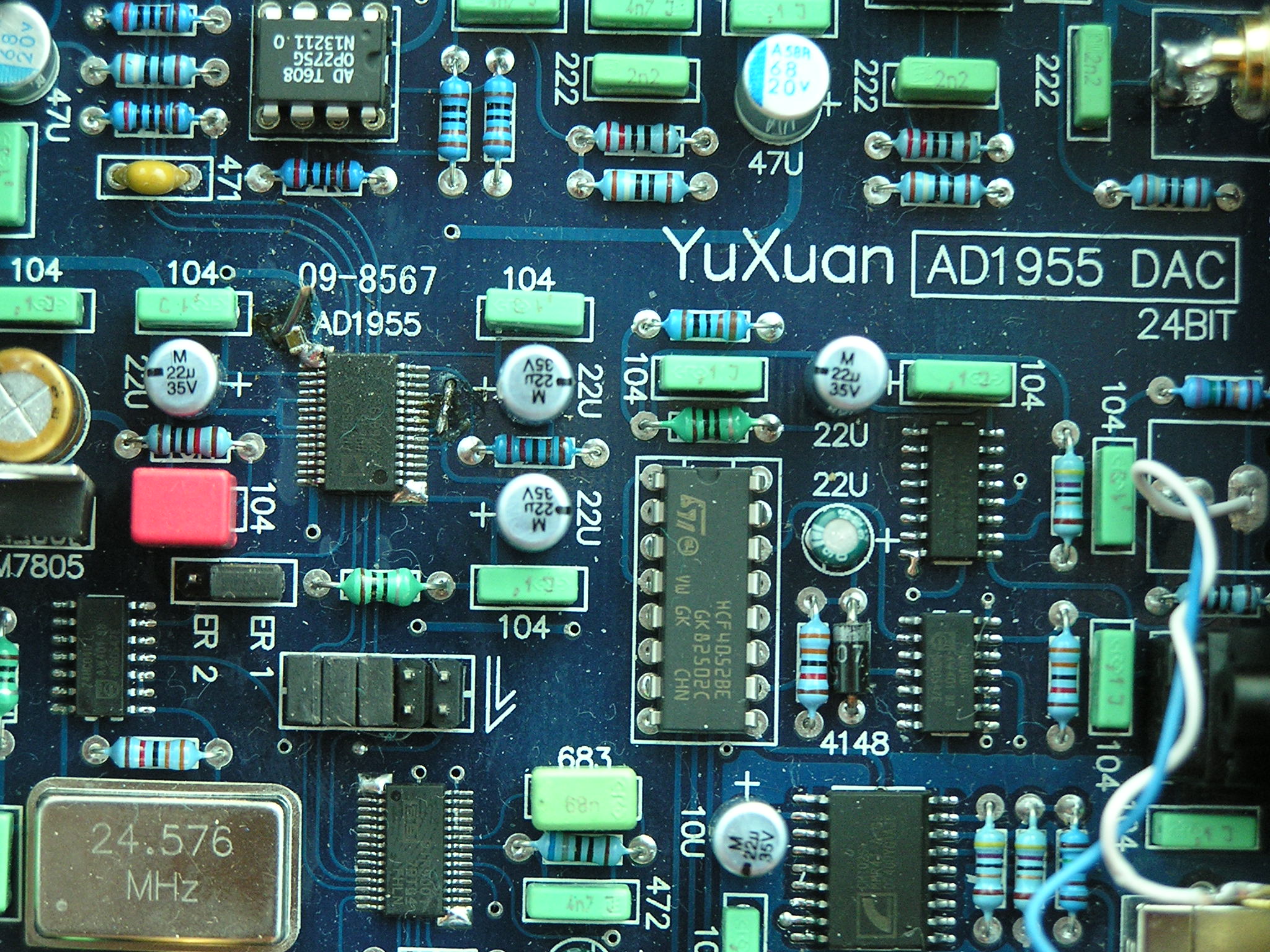

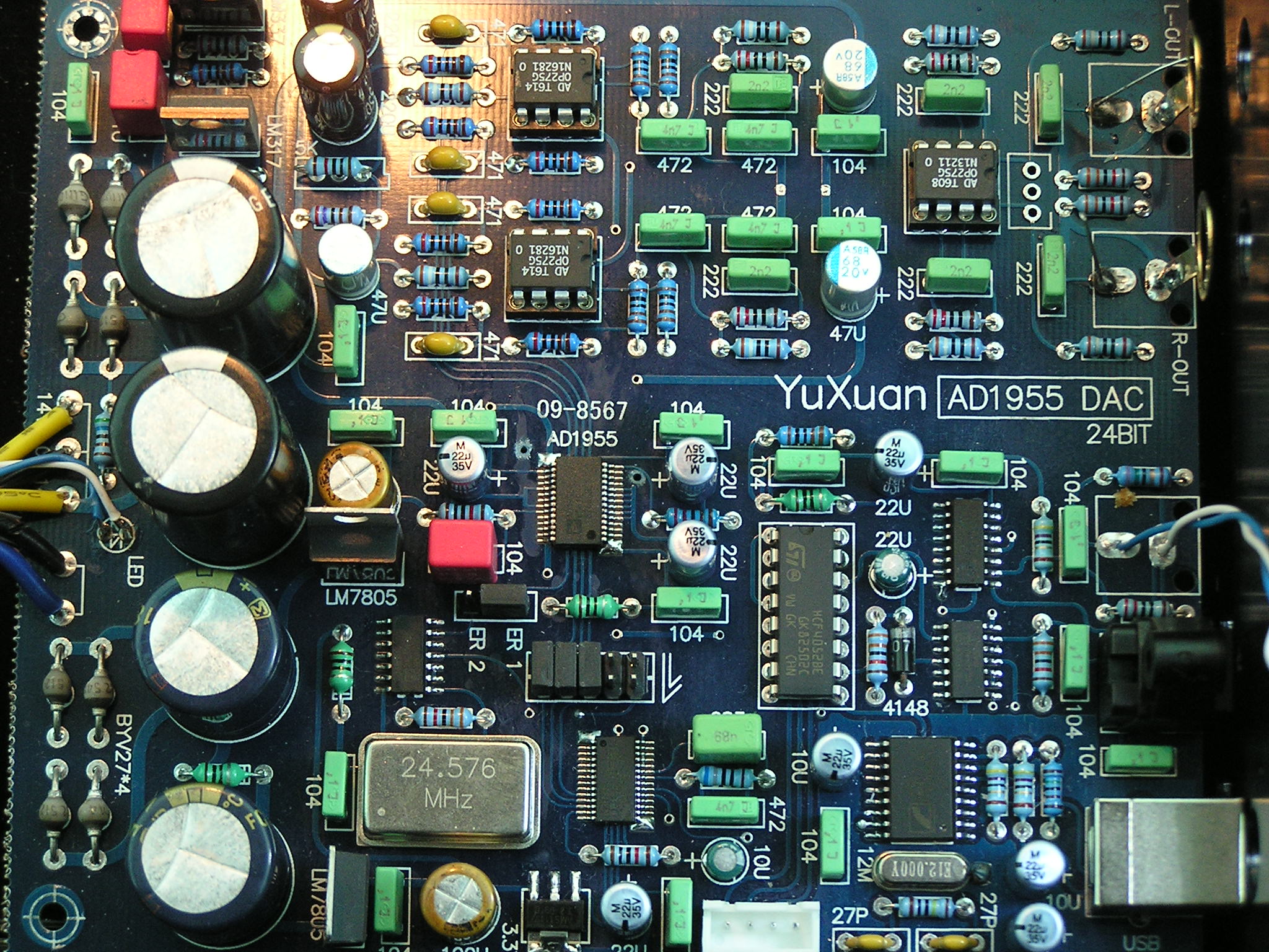

HEC part II
Posted 17th June 2010 at 05:07 AM by abraxalito
Updated 8th September 2011 at 03:04 AM by abraxalito
Here's a pic of the underside of the DAC before I started hacking tracks. Bottom left area is where the digital circuits are, with ground plane. Top left are the analogue output filters. Right is the caps, rectifiers and regs of the power supplies - digital at the bottom and analogue at the top.
The AD1955 sits about the centre of this pic, and if you look closely you'll notice two small holes I drilled in the groundplane either side of it where I will later install the 10uF decouplers.
The second pic shows the component side, prior to any hacks - the 'virgin board' if you like, although sullied by the two small holes near the DAC chip. The analog supply is pin15, that's at top left.
Third, here's the meat of the digital circuitry and I've already added one decoupler to the AVDD (analogue positive supply). To the right of the 24.576 XTAL (not required) is the DIR9001 SPDIF receiver. The DIL chip is a multiplexer allowing both USB and SPDIF input...

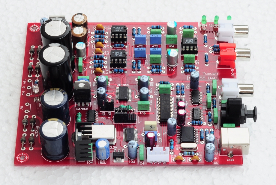

Towards a better DAC - introducing the HEC
Posted 14th June 2010 at 04:16 AM by abraxalito
Updated 8th September 2011 at 03:05 AM by abraxalito
Doug Self's comprehensive work on power amplifiers has been an inspiration to me over a number of years. In it, he coined the notion of the 'blameless amp' as one which was beyond reproach, measurements-wise. So I pondered over running with the notion of 'blameless DAC' along the same lines. Initially this sounded attractive, even though not entirely original. Google found a reference to it already here on diyaudio but could not show me the actual posting.
I decided on reflection that the 'blameless DAC' would be not such a good idea. That's partly because for me, measurements are not the goal of audio design. Enjoyable sound is what does it for me, not vanishingly low THD figures. So a 'blameless DAC' could only be blameless if measurements are God, so to speak. For someone like me for whom auditory experience is all, I decided I'd need another term for my DAC project.
I've settled instead on the term 'highly evolved converter' or HEC for short. This recognises...
