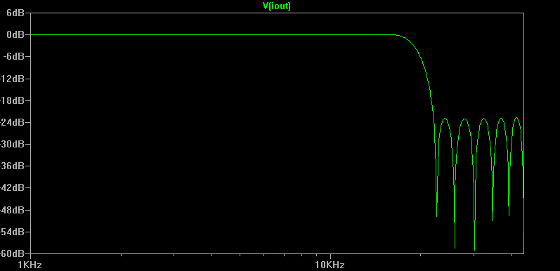

Simple anti-imaging filter
Posted 28th May 2013 at 04:57 AM by abraxalito
Updated 4th June 2013 at 07:34 AM by abraxalito
If you're curious to see how an anti-imaging filter affects the SQ of your NOS DAC but have been hitherto put off by all the coil winding involved, then this circuit might be just the ticket.
I was curious to see how well just two inductors could do and it turns out not at all badly - there's about 23dB stop-band rejection here and the 10mH inductors are off-the-shelf Fastrons. The capacitors can be all 1nF 0805 C0Gs - just buy a strip of 40 and use parallel and one series combination.
I intended to build one and listen to how it fares against my more complex efforts...
Update - a quick listen and its clear on switching back to the original filter that this new filter's noise floor isn't as low. That's not directly perceived as a rise in hiss mind - this is the subconsciously perceived noise floor which translates to more attention given to the music. So I'll put the two inductor filter aside and work on slightly more complex filters next.

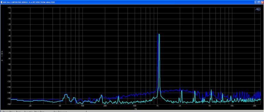

Noise modulation and subjective performance of DACs
Posted 25th December 2012 at 05:22 AM by abraxalito
Updated 20th September 2014 at 03:41 PM by abraxalito
I've recently come to the view that the best metric of SQ in DACs is noise modulation, however as yet I'm unclear how best to go about making the measurement. Stereophile tried, and here's what they did - Noise, Modulation, & Digital/Analog Conversion | Stereophile.com
Robert Harley reports no correlation with listening so I deduce from this that the test method isn't looking for the right thing. My own gut feel is we need a multitone test waveform rather than a single sinewave as a sinewave has a crest factor quite unlike music and if a sine provoked the condition we'd see it on the 'N' part of a THD+N vs level test.
Having said that, of course we do indeed see something weird going on - on Weiss Medea's implementation of the ESS Sabre. The THD+N plot versus level shows kinks which most certainly are not increased THD at various levels, so can only be noise floor modulation. See a critique I made on WBF here - https://www.whatsbestforum.com/showth...l=1#post133677...

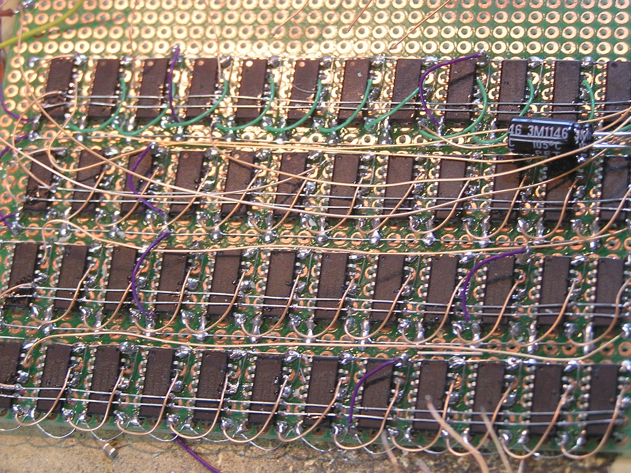

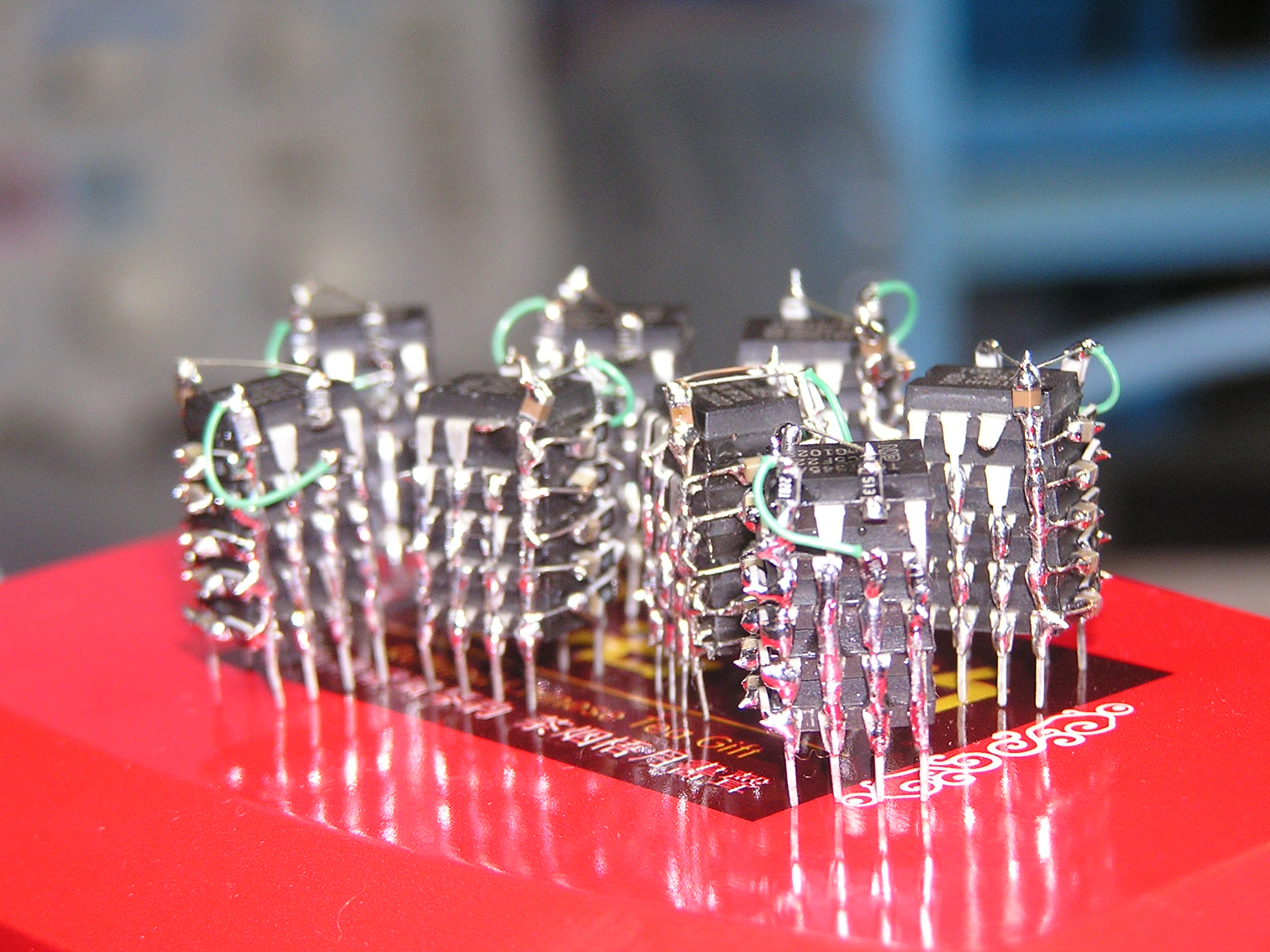

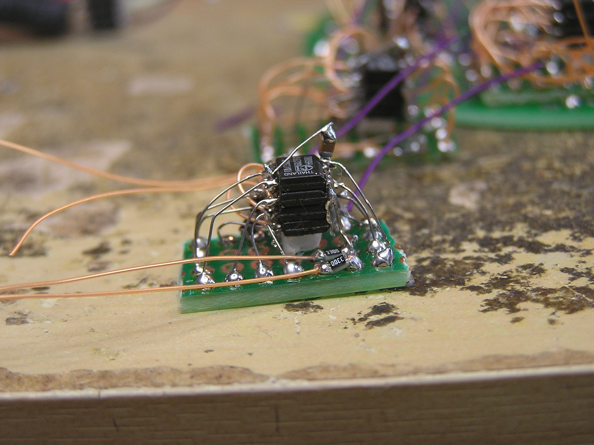

Prototype MOS DAC
Posted 23rd June 2012 at 08:22 AM by abraxalito
The prototype is listenable now, but a bit too much background noise/hum pickup to do serious listening. It needs an on-board post filter and amp, which I'm working on now. In the meantime, here's the pics - the DAC itself is built of 5 'dac-sleds' each with a stack of 4 chips. The 'sleds' are then arranged around the central tower holding the resistor ladder. A separate board handles the timing logic and 18 tap delay line.

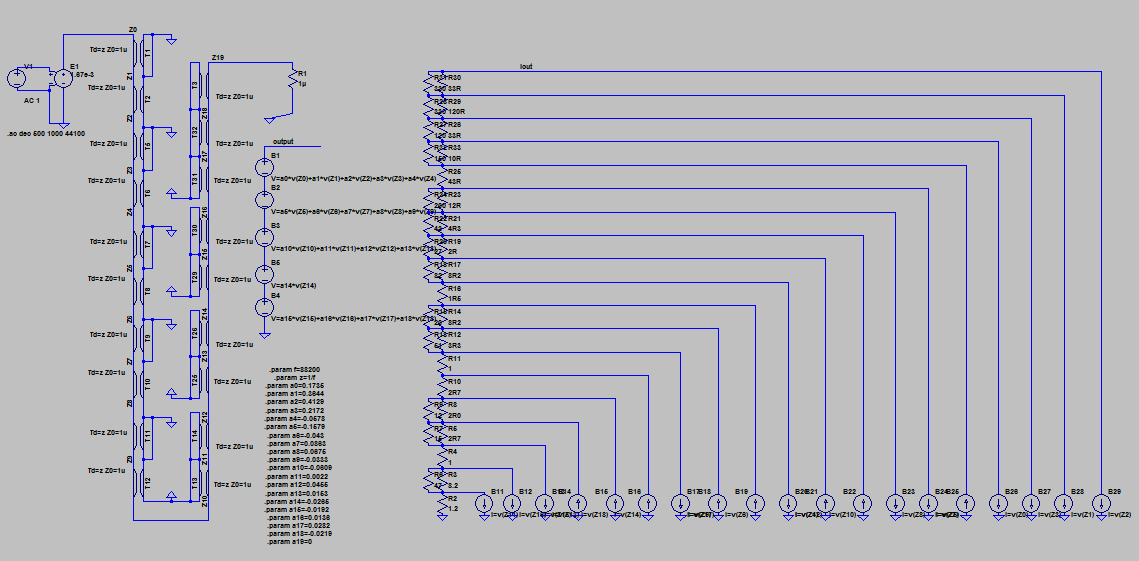

Evolving NOS -> MOS
Posted 9th June 2012 at 07:13 AM by abraxalito
Fixing the NOS droop has the undesirable side-effect of making the imaging components worse - HF gain can't be increased up to 20kHz and then suddenly taken away above 22kHz
In the spirit of taming the near-ultrasonic emissons of a NOS DAC, I'm currently playing with an MOS design - where 'M' stands for 'minimal'. I've been wondering if the attractiveness of the NOS sound will still be preserved if I go to 2X OS in order to fix up the ultrasonics. No practical analog filter can have a sharp enough band edge so a digital one it does have to be...
A DSP implemented digital filter comes at a price - that of throwing away some bits (I'm still using only 16bit DAC chips - TDA1387) so I'm now exploring using a transversal filter (no DSP) to carry out 2X OS. The LTSpice screen grab shows the architecture I'm playing with - a 19 tap delay line feeding 19 separate DACs. The DACs are shown on the right as current sources and their individual weightings are...

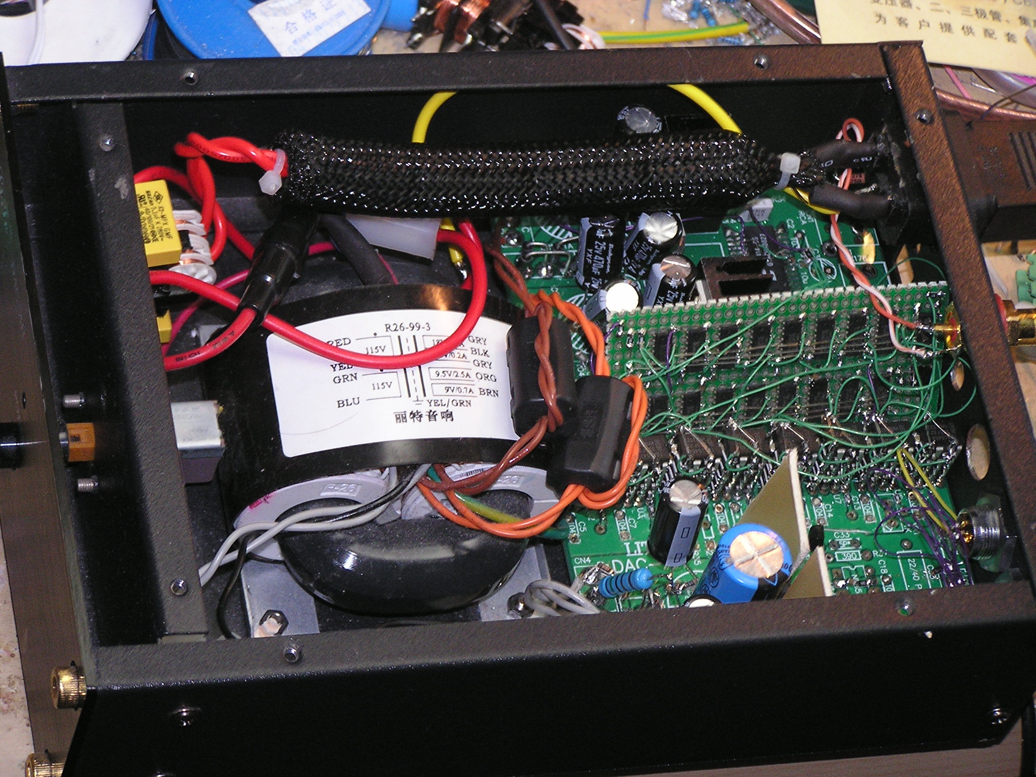

Posted 30th April 2012 at 06:46 AM by abraxalito
Plenty of audio DIYers have discovered what an excellent modding base the DAC-AH Lite is. I'm a latecomer to the party, but better late than never here's my contribution to the art of DAC-AH-alikes.
Most of the mods I've seen focus on the output stage, some upgrade the PSUs. Here's yet another variant - change the DACs. The TDA1545 is pin compatible with the TDA1543 so I swapped out 8 TDA1543s and replaced them with 8 DAC-stacks made up of 5 TDA1545s each. 32 DACs in parallel produce the normal NOS output, the additional 8 DACs are fed from a two-stage delay line (16 74HC595s) to correct for the zero-order hold. I/V conversion is done passively and differential - 1.3ohms in each polarity. The post I/V stage is a pair of AD605s giving a true differential output. In between the two is a passive filter made up of TDK ferrite beads and NP0 capacitors.
How does it all sound? - well of course one is always biassed when describing one's own offspring, but in a word...
