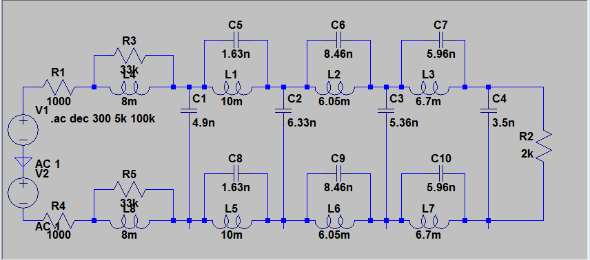

I didn't much care for the sound of my active elliptic filter - great dynamics in the bass for sure but the upper-end colourations were a bit unnatural sounding. So I've shelved tthat one for now and instead I'm playing with a simplified (by which I mean fewer inductors) passive elliptic.
There are two topologies for building elliptics where the zeroes are realized either by shunt series-LC networks or series paralleled-LC networks. The series created zeroes means fewer inductors are called for. In its most basic, unbalanced form there would be just three inductors for a 7th order filter. This filter though is balanced and designed to feed my Nitro desktop amp directly, without any I/V amplifier stage.

  1. Old Comment
    Interesting. Could you be more specific about precisely what those "upper-end colourations" were? This is the area where one is more and more balancing on the knife edge of "correct" sound, and the slightest weakness anywhere in the whole chain can be severely emphasised ..
    From personal experience, the best sound is often directly adjacent to some of the worst sound: 1' of an arc to the left, unlistenable; 1' of an arc to the right, tediously dull; inbetween, just right ...
