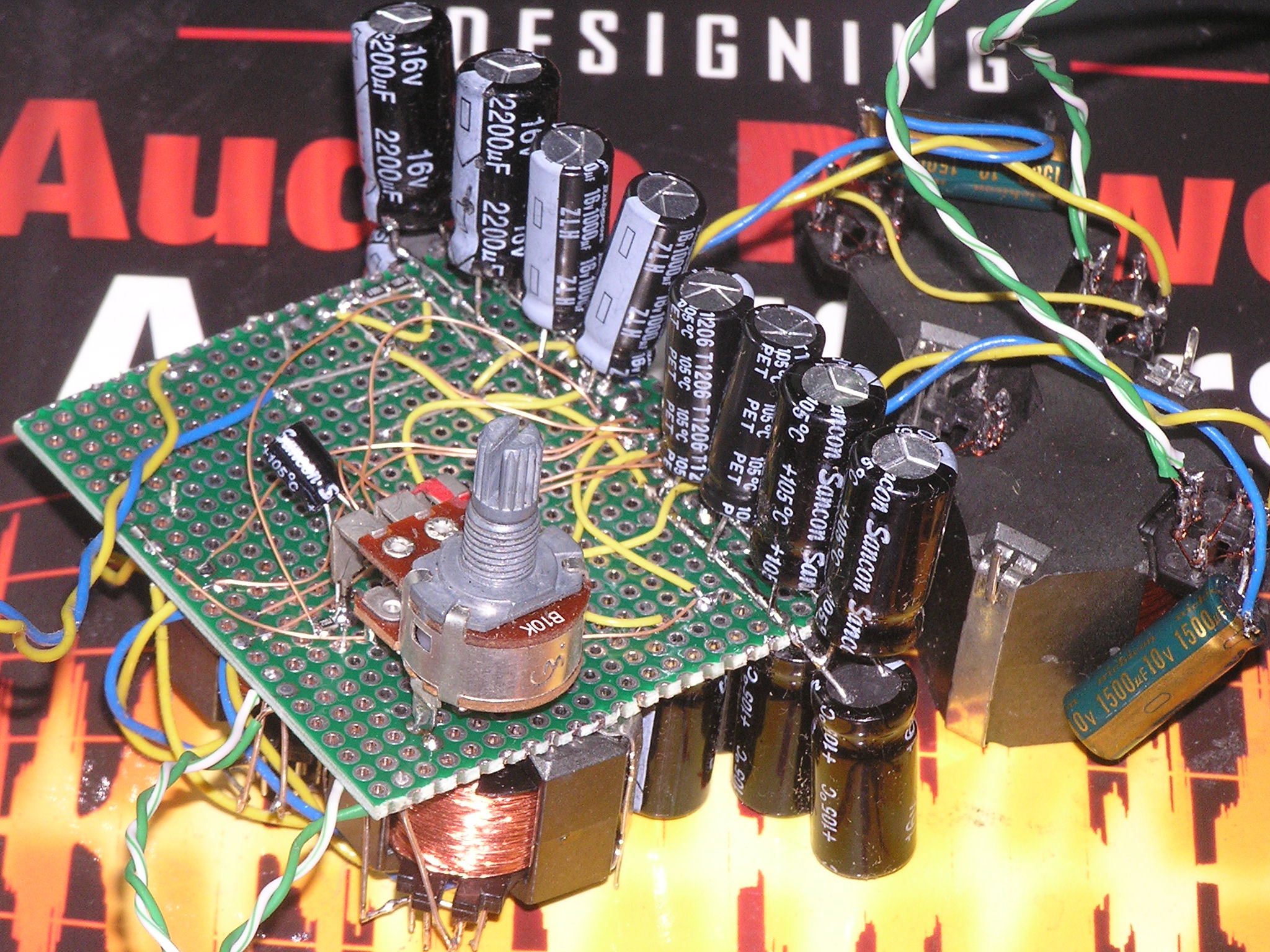

I built this up to see how the TDA8946AJ DC-controlled volume element sounds. According to the datasheet and comparing the figures with those for the same amp minus the volume control (TDA8946J) there's some additional THD so I was curious to hear how transparent it is.
There are transformers both on the input and the output of this. On the input to match levels (4:1 step down) and to do unbal-bal conversion. On the output again for the same reasons, except bal-unbal to drive my phones which I've not modified for 4 wire operation. The trafos are ferrite (=very cheap) RM10 for the input (under the board) and RM12 for output (behind the board). In order to be able to match a variety of phones, I've wound 4 identical secondaries so they can be combined in series or parallel.
From the pic you'll see the customary array of caps - I need to order up some lowESR (preferably NCC) 1800uF caps to do better justice to the rails. Last night I experimented with some ceramics...

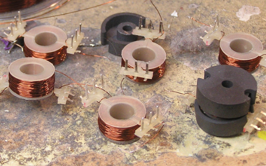

I've found that some of the el-cheapo trafos (18rmb each) at a shop at the local electronics market are of split bobbin construction. This makes bodging up an audio OPT from two mains trafos a fairly straightforward matter.
I bought some with 9-0-9V and others with 0-12V secondaries. Then I disassembled them (fortunately they're not varnish dipped) and swapped out the 220V primary bobbin for the secondary of the other one. This gives me a trafo with 18V on the primary and 12V on the secondary, a step down of 1.5:1, impedance ratio of 2.25:1. So it makes a 4R drive unit appear as 9ohms to the chipamp.
And when I applied this to the output of the bass/mid of my chipamp (residing in the Phenix active speakers, its a TDA7265), apart from it sounding quieter I suddenly realized how much power supply noise I was still listening to. Incredible
So if you want to know if your chipamp PSU decoupling is really up to snuff, see how much difference a 1.5:1...

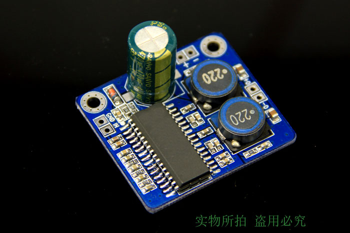

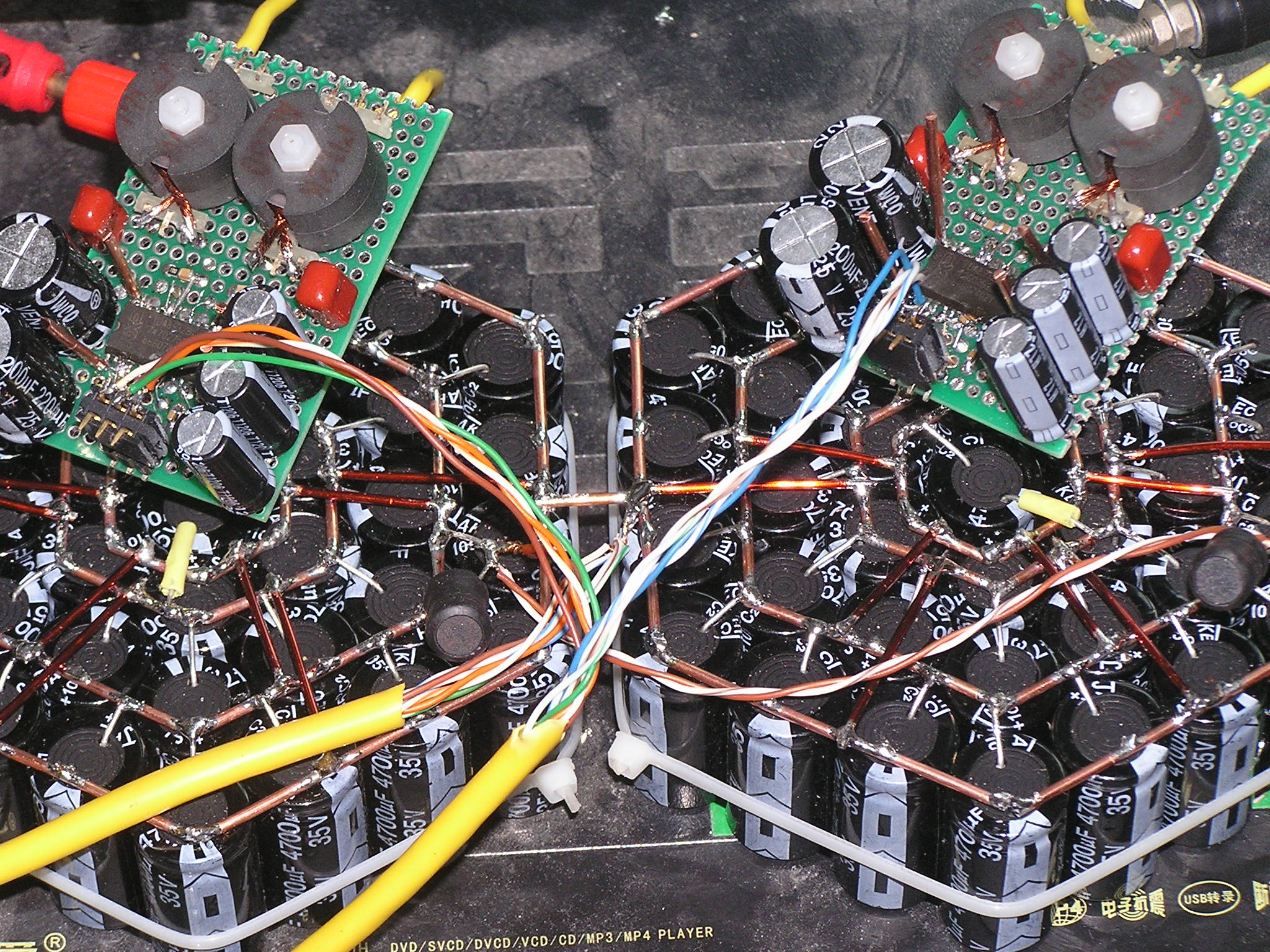

One channel is completed - barring the off-board hexacap shunt - second channel under construction. Then for a comparison with the TDA1521s
Update1 - both channels running now, 160,000uF on each. Bass is tuneful but LF colourations noticeable on piano (Ashkenazy Diabelli Variations). Solution to this is simple - more caps
Update2 - an extra ring of caps around the original hexacaps now, so we're around 250,000uF. Bass is so much better than from the TPA3116 but the HF is more ragged, less transparency overall than the TPA3116. So I'll next try an outrageously decoupled implementation just to check I'm not limiting the chip with poor PSU hygiene....

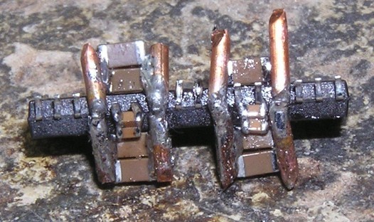

Update3 - I have over 30 1206 10uF caps per side now as local decoupling - HF problems are slight. Makes me wonder if I use it only on the bass/mid and a TDA1521 for the tweeter duty we might reach audio nirvana.... Looking at the DS its easy to see why the HF's a bit of a mess - the PSRR is about...

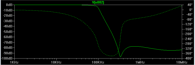

I've only simmed this so far, no listening tests. The aim here is to have a passive filter which works into a line level impedance (i.e. 10k or greater) and which gives a decent amount of RF rejection without compromising SQ. I plan to incorporate it behind the RCA input jacks of my chipamp.
Design-wise, it started life as a simple 2nd order filter with single series L and shunt C. But when it came to wind the inductor I didn't have a wire diameter small enough to make the required value (44mH). So I split up the inductor into 2 * 22mH and then couldn't resist hanging a cap off the centre tap. The result has turned more into an over-damped elliptic with a higher corner frequency than the original, but with an impeccable phase response to 20kHz. The elliptic-type plot comes about because of the SRF of the two inductors (around 350kHz).
Since fas42 remarked on the phase performance, I've added the group delay plot for the passband. Almost pure time delay of...
