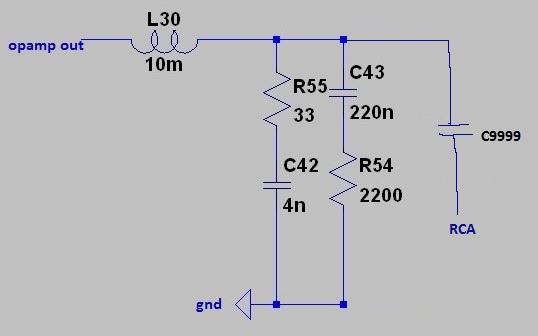

    went ahead and tried what was posted on the tda1387 x8 thread
    Click the image to open in full size.
    i never paused to think if it were applicable to my 4 stack implementation.
    what are the factors that effects the values?

    The input (where it says opamp out) is supposed to be driven by a low impedance. If you connect it to an I/V resistor it won't give the desired response because an I/V resistor isn't low enough impedance (>= 50ohm). Likewise the output (RCA) should not be loaded less than 22k.
    L30./C42 define a resonant peak in the region 20-30k. R54 provides damping so that the peak isn't too sharp, we want something less than 5dB, C43 reduces the damping where its not required, at LF.

    so fixing the nos droop with this method isn't a runner with an i/v resistor?
    is there a method of measuring impedance of a buffer or opamp?

    You'd want a buffer first - Matt Garman sketched up a schematic of I/V followed by buffer and filter on the 8 * TDA1387 thread.
    Output impedance can be measured yeah - you need a test source i.e. signal gen or for DAC, test waveform. You can create test waveforms in Audacity. Say you want to measure at 440Hz, create a sine at this frequency then with an AC voltmeter (should be sensitive, 4 digit DMM should work) measure the output voltage. Then put a load on say 1k, measure again. Math on those two voltages gives the output impedance.
