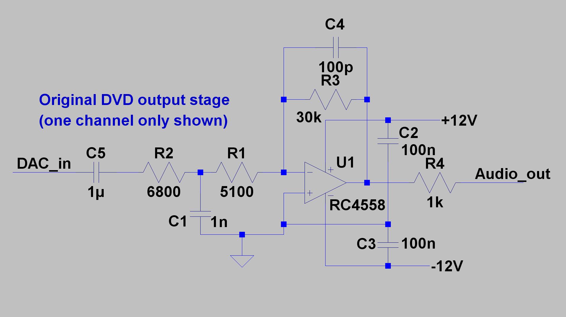

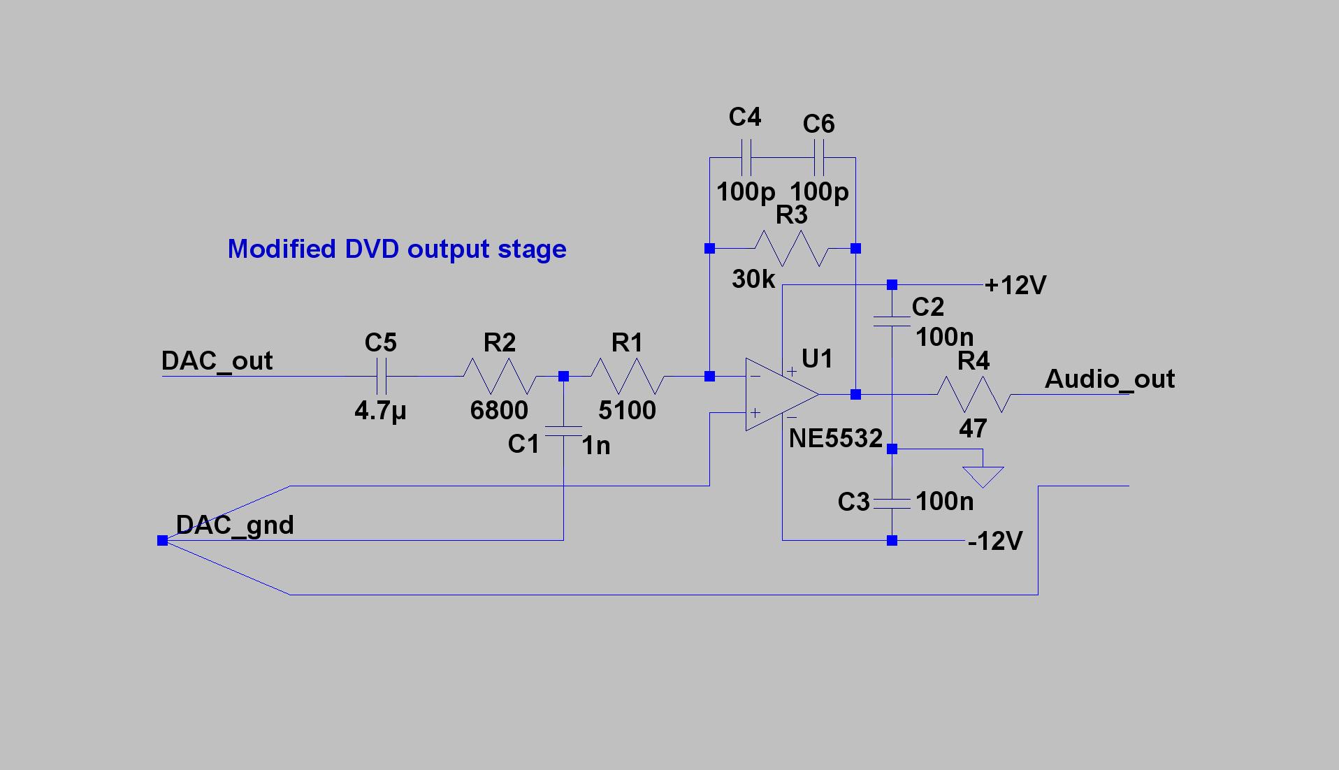

Here are the schematics - the original output stage and the modified one.

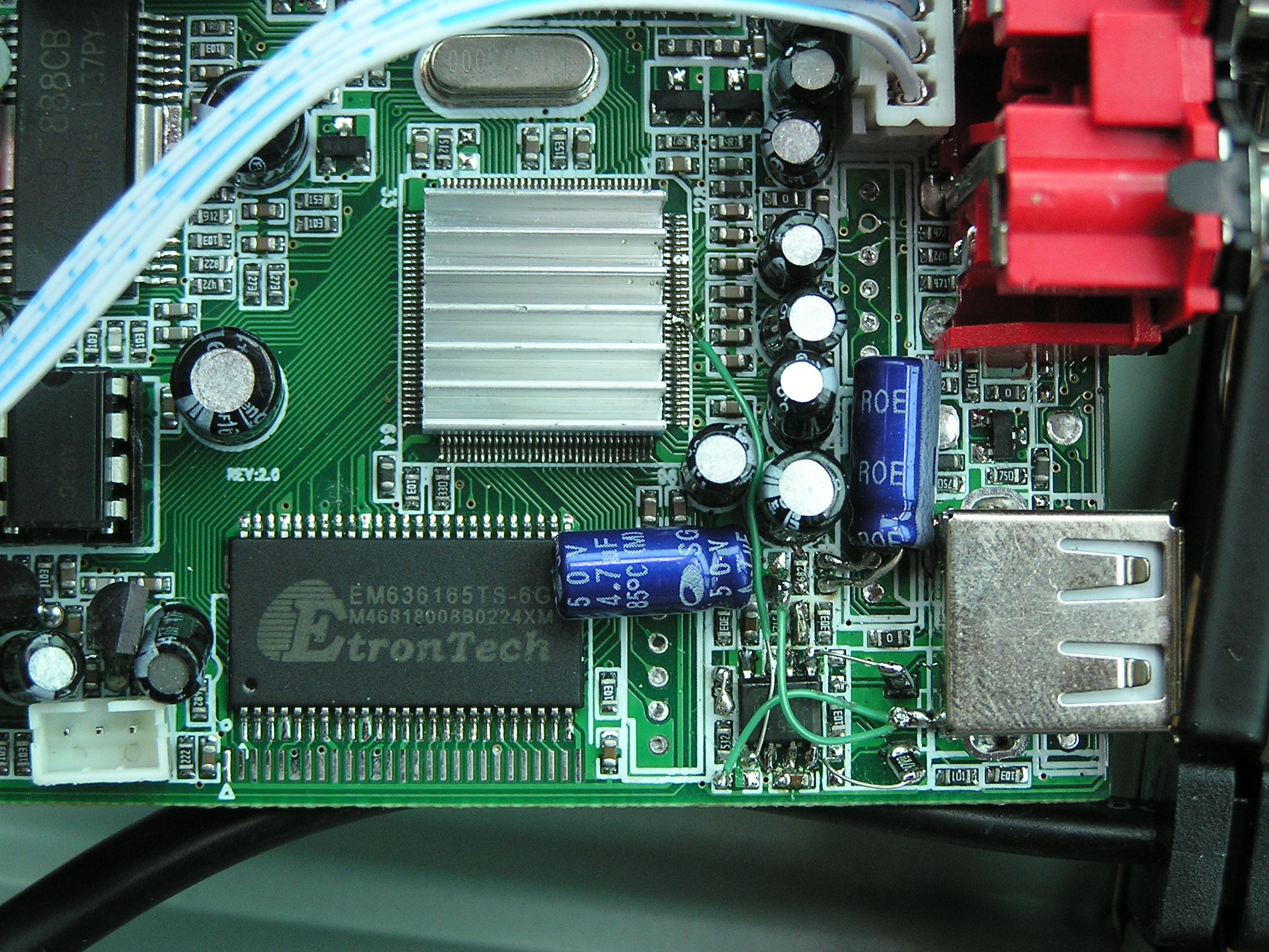

On the first player I bought, I did all those mods in one hit. The third pic shows what they looked like - I took out some of the redundant connectors (guessing the same board is used in players which have more features like component video outputs) to make space for the electrolytics. Having replaced the board (just two screws, one on the rear and another in the base), then I listened. The improvement in bass performance brought about by increasing the value of the coupling caps was noticeable in listening - the cello became more full-bodied - and also on a frequency response plot I made using Audacity. I felt (but can't quite describe) that the soundstaging has improved - music feels more interesting to listen to somehow. I week or so later, I went out and bought a second one (at 99RMB, who's counting?) to remind myself of the original sound. On listening for the first time to a CD I'd just bought...
