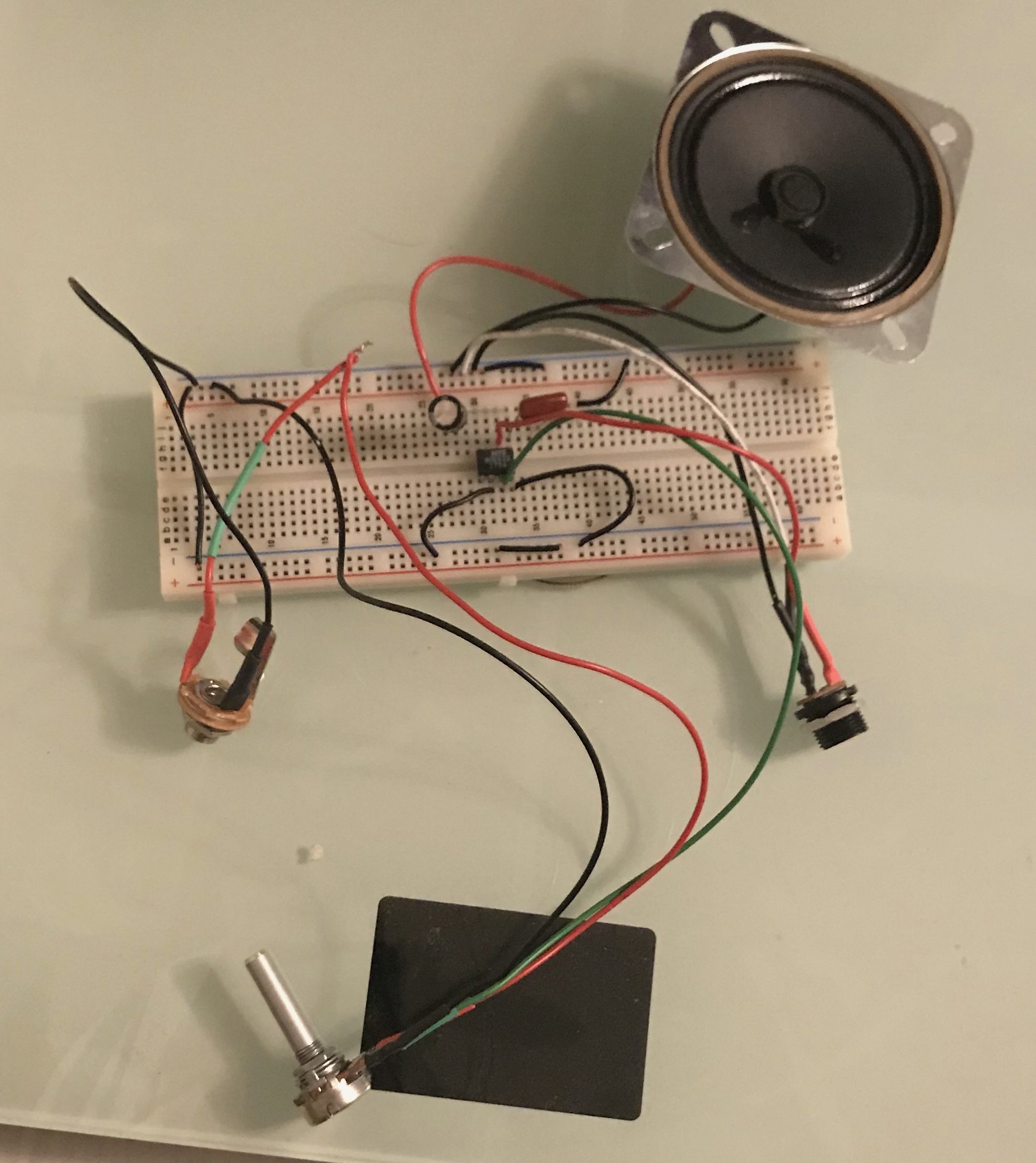

I followed Fahey's advice and breadboarded the most basic illustration in the LM386 datasheet, Figure 10, "LM386 with Gain = 20." It took about 15 mins, including searching for parts. A 12V wall wart is used for power.
I had this post open and typed additional info as I tried various things.
I have sound. Up to about wiper position 2-3, I hear notes and no hum or buzz from the cheapo speaker. However, when I turn the volume pot up, a lot of noise and hum is added to the speaker output. That is with both guitar gain knobs at 0 and the stompbox gain setting as low as it goes. The noise appears almost immediately when I turn up gain on the guitar or stomp box.
Right now, I suspect this problem is due to the input source being a guitar (electric) going thru a stomp box powered by a 9V wall wart.
When I put a 0.1uF, 1uF, and then 10uF cap (one at a time) in series between the middle 10k pot prong and pin 3, no difference. With any of those caps in place and the volume pot at 0/10, I hear a short noise when I plug the wall wart into the DC jack. When I eliminate the cap in series and instead run a line "off the side" of the going-to-pin3 wire with a 10uF cap and 10ohm resistor to ground, that noise of plugging the wall wart into the DC jack is constant, even when the volume pot is at 0/10.
Just now, after eliminating the cap & resistor, the noise was constant after plugging the wall wart into the DC jack, even with the volume pot at 0/10 and the stomp box powered off.
With the guitar plug removed from the jack and the volume pot at 0/10, the noise is now constant after I plug the wall wart into the DC jack. When I touched the pot several times just now, the noise would go away while my fingers were in contact, come back when I removed my fingers, and after the 3rd or 4th time the noise did not return after I removed my fingers.
I just noticed that notes and noise are coming from the speaker even when the volume pot is at 0/10. Turning it up to 10/10 does not silence the notes or noise. The +/tip prong of the 2-prong guitar jack is connected to the left pot lug (viewed from rear), the center prong is connected to pin 3, and the right prong goes to ground. I removed and reinserted the wall wart and this time I hear noise only when the volume pot is > 0/10. A little later, the noise is constant again even when the volume pot is 0/10.
When I tried swapping the wires connected to pot lugs 2 and 3, no difference - same constant noise when wall wart is plugged.
This is driving me nuts. I am getting inconsistent results with the same setups, sometimes changing when I touch the volume pot. My guess is some kind of short or grounding problem, but I have followed Figure 10 exactly - with the exception of changes made to see if they make a difference, e.g. the experiments between the pot and pin 3, since eliminated.

I an think of two hypothesis to explain all these intermittent problems you're experiencing:When I touched the pot several times just now, the noise would go away while my fingers were in contact, come back when I removed my fingers, and after the 3rd or 4th time the noise did not return after I removed my fingers.
1) You have loose connections. This is quite common with a solderless breadboard, particularly if it's not a new one, and the internal spring clips have lost their tension.
2) Your chip amp is oscillating like crazy at a frequency too high to hear, and when you touch part of the circuit, the oscillation momentarily stops or changes.

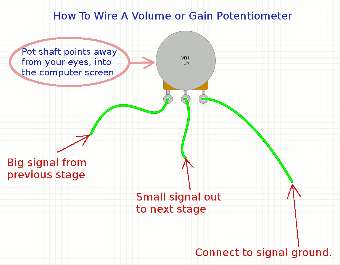

Then it's still wired incorrectly (or there is no ground connection.) Did you follow the picture I posted for you in post #31, and updated for additional clarity in post #47?I just noticed that notes and noise are coming from the speaker even when the volume pot is at 0/10.
10/10 is maximum volume. That certainly won't silence the amp.Turning it up to 10/10 does not silence the notes or noise.
This does not tell me what you've done. Are the pot lugs pointing down, or up? "Left" changes depending on which way the lugs point!The +/tip prong of the 2-prong guitar jack is connected to the left pot lug (viewed from rear)
Refer to the diagram, attached once more to this post. I can't think of any way to make it any simpler than that.
Once again, what was the reasoning behind this wire swapping? Was it just random? Making random changes is almost never going to be helpful in solving a problem like this.When I tried swapping the wires connected to pot lugs 2 and 3, no difference - same constant noise when wall wart is plugged.

I moved everything - the attached schematic with no changes - to a new, virgin breadboard. No sound whatsoever. With both guitar (and stomp box) and iPhone as audio sources. I have very carefully double-, triple-, and quadruple-checked and it's all as shown on the attached schematic. Dead silence from the speaker.
I wired the pot exactly as shown on your diagram. I have checked and re-checked multiple times. I tried swapping the 2 leads just in case I had them backwards, or just in case the pot may be non-standard. The ground lug goes to ground; I have checked and rechecked that multiple times.
I tried both 0/10 and 10/10, and in-between, just in case I had somehow miswired or inverted clockwise and counter-clockwise pot functioning. I also tried removing the pot and connecting the audio jack data line directly to pin 3; no difference.
I have a bunch of these chips and have tried several; no difference.
I have no way to test for, and wouldn't have a clue how to fix, a chip oscillating wildly or otherwise.

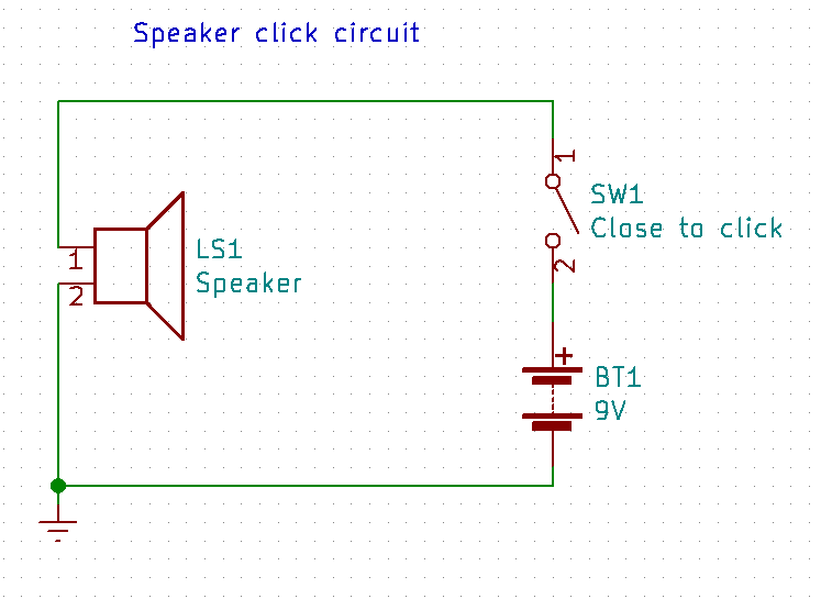

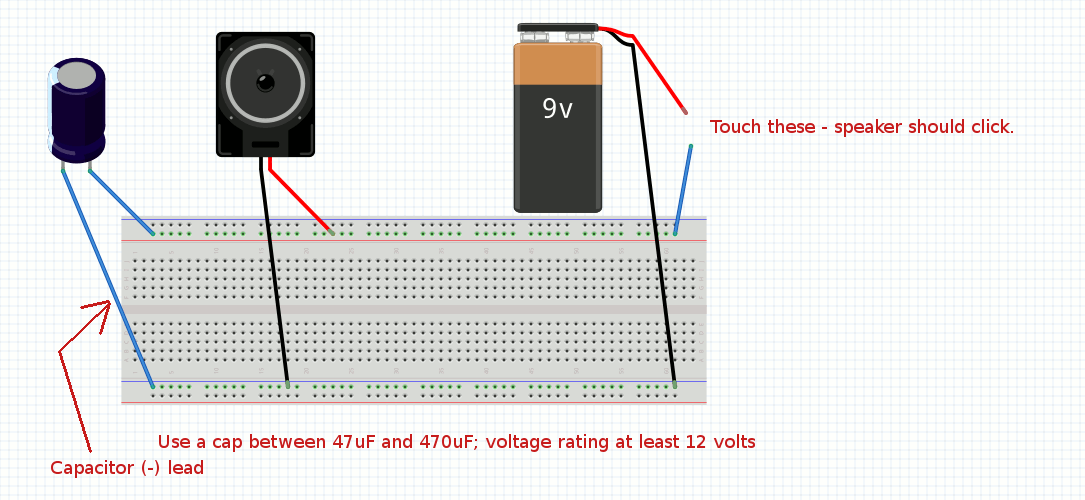

Step 1: Use my image as a guide. Plug your two speaker wires into two different power rails of the breadboard. (If you don't know how the breadboard works internally, read this: How to Use a Breadboard )
Step 2: Add the filter capacitor, wired across the two power rails (you'll need to add additional wire, the cap leads won't be long enough.)
The filter cap is not necessary for this circuit, but it should become force of habit to ALWAYS use a filter cap across the power supply rails with every audio circuit you build. You can leave the cap in place as you start to make this circuit more complex over the next few days.
Step 3: Plug the (-) battery wire into the (-) power rail of the board as shown.
Step 4: Plug a short length of wire into the (+) power rail of the board as shown. You should get a "click" when you touch the two wire ends together. You do? Success!
Step 5: Draw a schematic diagram of the circuit that you've just constructed. Until you can read and draw schematic diagrams, you will never grasp what's going on in a circuit...so it's time to start right now. Pictures won't do the trick.
This is pretty much the simplest circuit that exists...one resistor (loudspeaker), one battery, two wires connecting them.
Get this working, and the next step will be to add a single transistor that will become a simple amplifier. Transistors are cheap, and less fussy than an LM386.
-Gnobuddy

It's alive!

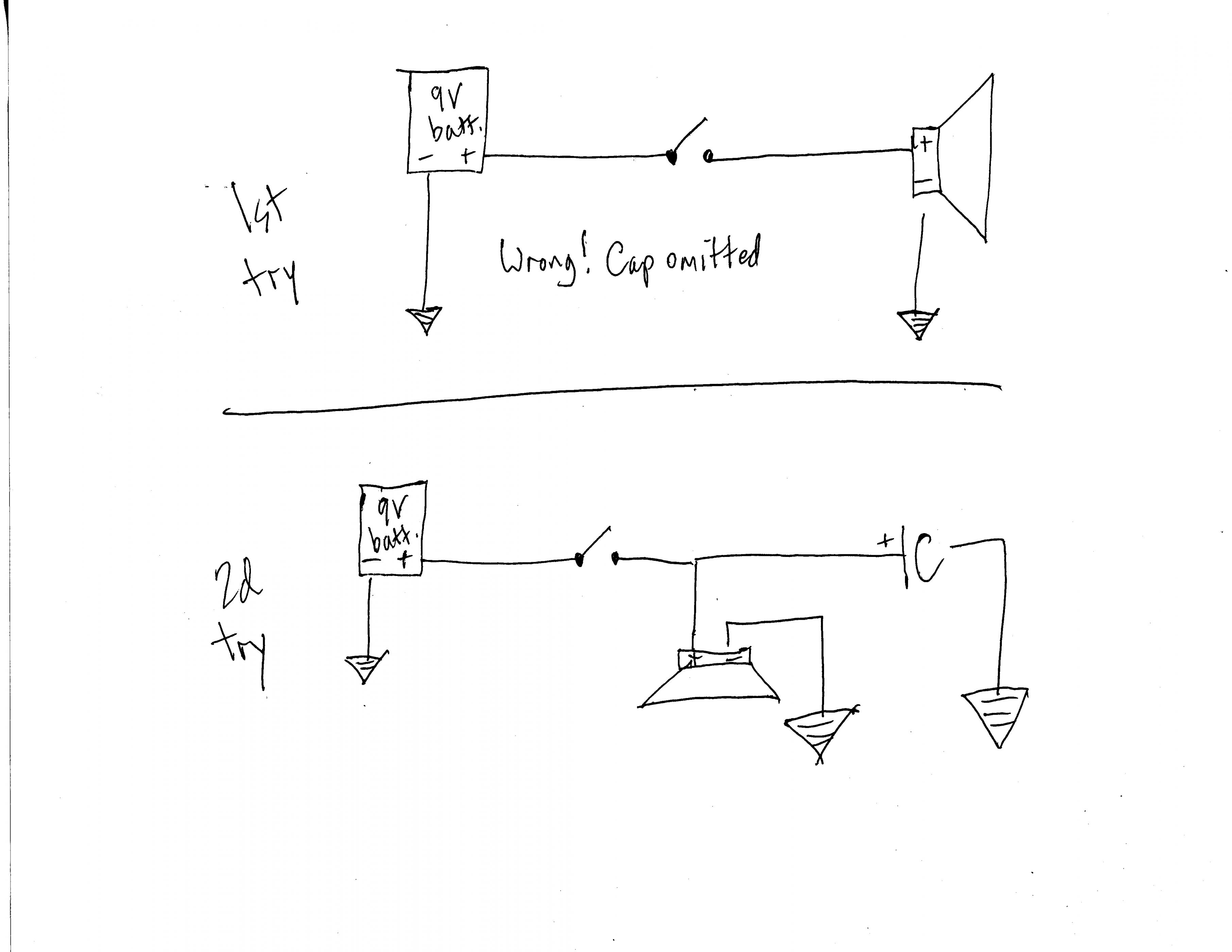

My first attempt was wrong because I omitted the cap. The second schematic includes the cap; this is the kind of config I would describe as "hanging off the side" of the line.
One thing I don't know is whether the circuit would be essentially the same if the physical location of the speaker and the cap were swapped, such that the cap would "hang off the side" (i.e. go to ground) before the speaker.
It seems that the cap to ground after the speaker "bleeds" something to ground and, in so doing, affects the energy available to the speaker. However, I have no idea (a) what is bled off to ground or (b) how the energy available to the speaker is different from what it would be available if the cap were eliminated.
There's no voltage division because there are not 2 resistors before (or at all) the speaker.
I'm inclined to think that DC is not removed from the energy reaching the speaker because the cap is after the speaker. Also, I don't think we would want to - or even can - remove DC because there is no separate signal in this circuit, and because the speaker needs DC.
I can't for the life of me see any useful purpose fulfilled by the cap.

Did you draw the schematic of the "speaker click" circuit? Simply follow each wire in turn, noting what's connected to each end. Draw it out; from the battery, where does the (-) terminal connect to? Where does the (+) terminal? And so on.
You should end up with something like the first of the two attached images below.

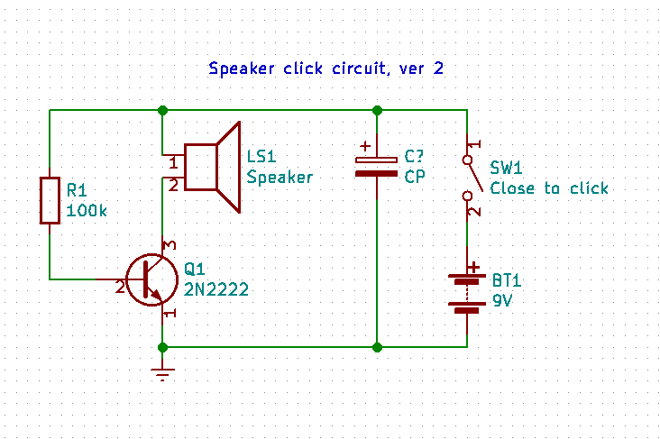

Any small-signal, silicon, NPN transistor. If you're fortunate enough to have a local electronics store, they may carry the ancient (but perfectly usable) 2N2222. Or your EE friend might have something suitable in the parts-bin.I don't have any transistors. What should I get for this purpose?
There are plenty of other possible transistors - what you're looking for is a small-signal NPN transistor with wire leads slim enough to poke into a breadboard. (Bigger transistors will have leads too fat to poke into a breadboard without damaging the metal clips inside.)
For now, let's say you got yourself a few 2N2222s. You'll also need a 100k resistor (learn the resistor colour code while you're at it - how do you know that it's really 100k? What does the "k" mean? What is the unit of resistance?)
For the next step after this one, you'll also need a small electrolytic capacitor; something like 10uF, rated for at least 12 volts. (I think you already have something suitable, based on your previous posts.)
Having obtained your transistor(s), the next step is to Google for the datasheet. For instance, if you get some 2N2222s, Google the term "2N2222 datasheet".
Once you have the datasheet, use it to identify the three leads of the transistor. One will be called the emitter, one the base, and the last, the collector. The datasheet will have a drawing of the transistor case (which invariably has a flat side or other asymmetry so you can identify it's orientation), and the drawing will indicate which lead is which. Often the leads will be numbered (1, 2, 3), and nearby there will be text that reads something like "1 - emitter, 2 - base, 3 - collector".
Once you've figured out which lead is which, you have one more thing to figure out. Somewhere in the datasheet there will be a line (or several lines) specifying the DC current gain of the transistor. For the 2N2222, there are a number of lines, but the nutshell version is that the current gain will be somewhere between 100 and 300 for our purposes.
Once you've got all this figured out, build the circuit in the second image I'm attaching, on your breadboard. This time it's up to you to figure out where to place the transistor, and how to connect the wires to create the schematic I've shown. (How can you tell which transistor lead is the emitter in the schematic, which the base, which the collector? If you don't know, Google is your friend.)
This circuit, built correctly, will do exactly the same thing as the first one - it will produce a click from the speaker when powered on.
But - our transistor is one small step away from greatness now. All will be revealed once you've got this step under your belt, and have successfully built it and got it working. 🙂

Excellent! You did your homework! That makes me happy. 🙂The second schematic includes the cap; this is the kind of config I would describe as "hanging off the side" of the line.
There is simply no good way to describe a schematic to someone else in words, which is why we use schematic diagrams for the purpose!
However, feel free to describe it to yourself in whatever way makes sense to you - always keeping in mind that the same words probably won't make sense to anybody else! 🙂
There are some rules-of-thumb which we can use to make a circuit more readable. For one, we use symbols (rather than pictures) for everything. You can see I've used a symbol for the battery in the schematics I've attached to this post, rather than draw a picture. It actually makes it easier to read, in the same way that a word in English can convey much more than a pictogram (imagine a pictogram that depicts the same thing as the word "frustratingly"? It can't be done, which is why too many emojis makes for infantile and limiting writing.
Another good convention is that we draw wires as straight lines, either vertical, horizontal, or at 45 degrees to the vertical. (You've already done this, good!)
One convention I try to use when possible is to place the power source (battery or power supply) on the right end of my schematic.
Another convention I use almost always is to draw negative voltages near the bottom edge of my schematic, and positive voltages near the top edge.
You can see that these last two guidelines dictated how I oriented and placed the battery symbol in the two diagrams I attached to my previous post.
Good question, and the answer is, yes, the circuit would be the same. For our understanding at this stage of the game, every point connected to the same wire is electrically joined together. There is no difference, electrically, between the "left" or "right" end of the wire.One thing I don't know is whether the circuit would be essentially the same if the physical location of the speaker and the cap were swapped, such that the cap would "hang off the side" (i.e. go to ground) before the speaker.
If you ever get to radio frequency circuits, this simplification has to be re-thought, and we have to start worrying about the two ends of a wire not being exactly the same thing. But for now, for this very simple speaker click circuit, every point on the same wire is electrically identical, and you can swap them at will, particularly in order to make schematic diagrams clearer and easier to read.
Until you learn more about capacitors, I'll give you an analogy. Imagine the battery is an air compressor; it pushes out electric "pressure" (voltage), where the compressor pushes out air under pressure.It seems that the cap to ground after the speaker "bleeds" something to ground...
Every air compressor includes an air-tank, a reservoir for compressed air. This smooths out fluctuations in the flow of air from the compressor, so we have a steady high pressure.
The capacitor you've wired across the battery does the same thing for electricity. It is a reservoir for electrons; it smooths out any fluctuations in the voltage from the battery (or power supply, when that's used instead.)
Correct! We're applying the full battery voltage to the speaker in this case.There's no voltage division because there are not 2 resistors before (or at all) the speaker.
This will change - look at the second image I've attached. The transistor behaves as a resistor of sorts, and it is in series with the loudspeaker - ta da, a voltage divider, and a special kind of one, as we'll see later!
For the first speaker-click circuit, it serves no purpose other than to remind you to ALWAYS include such a filter cap in every single audio circuit you ever build. 🙂I can't for the life of me see any useful purpose fulfilled by the cap.
Hang on, that cap will serve a very useful purpose in the next iteration of the circuit. I promise!

I had a lot of trouble adding the 2N2222A. It helped to find a datasheet from a different manufacturer. I was discombobulated by turning the transistor right side up after reviewing the layout showing the transistor upside down.
The gain numbers are listed under Electrical Characteristics and vary with test conditions. The lowest min is 30 and the highest max is 325.
On your second schematic, 1 (emitter) goes to ground. 2 (base) is connected to one end of the resister; the other end of the resistor is connected to line 1 (+) originating from the battery. 3 (collector) is connected to the neg (-) line out of the speaker; this required that I disconnect the neg (-) speaker wire from ground and connect it instead to the collector. I hear sound but I cannot say it's louder to my 59YO ears.
I really have no idea what, if anything at this point, the transistor and resister are doing, or what it accomplishes to run the neg (-) speaker wire thru the transistor rather than directly to ground.
