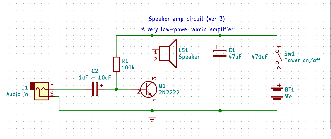

And that brings us to the attached schematic, version #3 of the circuit you've been building. The only change from version 2 (which could only click) is the added capacitor to the base, and the added input jack, so you can plug the signal from your guitar pedal into it.
That tiny change makes a huge difference: the circuit goes from only being able to make a little "click!", to being able to actually make sound, in fact, a copy of the sound from your guitar.
It won't be loud - it will be much quieter than your LM386 amp that never worked right - but it is in fact a working amplifier, and one simple enough that you should be able to wrap your brain around the function of every component.
Try it...add the base coupling cap and input jack, feed it with either your guitar via FX pedal, or from an MP3 player or something. Keep the FX pedal or MP3 player turned down to zero at first, turn it up gradually. You should hear the music through the speaker, though fairly quietly. Turn up too far, and it will distort. Turn up some more, and you might fry the wee little 2N2222. Your call if you want to try that or not...

Congratulations! You've just built your first properly working amplifier!With the 2nd resistor and audio-in jack. I can hear my guitar faintly thru the speaker. I also can play music from my iPhone up to full phone volume.
And it's not doing strange and annoying things - no hum, no intermittent silence. It's a crude, simple, and flawed amp for a variety of reasons - but you built it, from a schematic diagram no less (not from pictures), and it WORKS! How cool is that?
Yes, that can definitely happen. The reason is that the 2N2222 is a small-signal transistor, and it was never really designed to do the heavy lifting needed to make loud noises from a loudspeaker.The 2N2222 got very hot with my phone all the way up. The circuit still worked after I gave the 2N2222 time to cool down, so I guess I didn't fry it.
But - its cheap, its slim leads fit in a breadboard, it's slow enough to remain stable even on a breadboard, and so you got a taste of success, finally.

Sorry, I missed this the first time.If I understand correctly, the audio signal travels as (or on) AC, but DC also is used in this circuit. Does the transistor simultaneously process both DC and AC?
You're perfectly correct. Transistors can't work on AC (which reverses direction, i.e. swaps (+) and (-), frequently). They really can only work on DC.
But we can make that DC vary. Never actually reversing, but instead fluctuating between a small and a big value. This means there is some sort of average one-way (DC) current, but there are fluctuations riding on it (AC). A simultaneous mix of AC and DC.
And that's what we've done here. The 9V battery supplies DC. The 100k resistor supplies a small DC current to the base of the transistor, which responds by supplying a larger DC current to the loudspeaker.
Next, the input coupling capacitor feeds AC from your MP3 player to the transistor base. This small AC signal "wiggles" the DC current coming from the 100k base resistor up and down - it never actually reverses, it only fluctuates in strength while always flowing in the same direction.
Finally, the transistor amplifies that fluctuating base current and feeds it to the speaker. So the former steady (DC) current through the speaker now fluctuates according to the signal from your MP3 player, and the speaker cone moves accordingly. And you hear sound.
