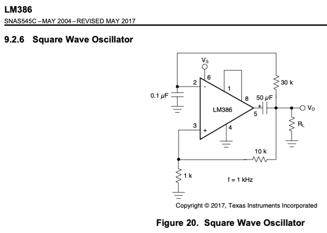

Somewhat ironically, a little battery-powered LM386 chip amp connected to a small speaker makes a good audio signal detector. 😀
The LM386 datasheet includes the attached schematic for a Square Wave Oscillator. There is also a more complicated schematic for a "Low Distortion Power Wienbridge Oscillator." Are such oscillations typically audible, or are they useful only with a scope plotting waves?
I'm a little hesitant to try to use an LM386 signal generator - most likely suffering from hum/noise - to test an LM386 amp suffering from hum/noise.
There are two parts to the plan: one, an oscillator (to make a small audio AC signal voltage), and two, an amplifier/speaker acting as an audio detector, so you can hear the test signal from the oscillator at various points in your circuit.The LM386 datasheet includes the attached schematic for a Square Wave Oscillator.
IMO the LM386 amp is most appropriate for the second role, as a detector. However, you certainly can tie its hands behind its back and make it into an oscillator if you want to.
You can also make a test oscillator with - tah dah - two 2N2222s, a few resistors, and a few caps, if you like.
Other easy oscillator options include the old (but still useful) 555 timer IC, as well as any of a variety of op-amps.

That's why I used the word "ironically". 🙂I'm a little hesitant to try to use an LM386 signal generator - most likely suffering from hum/noise - to test an LM386 amp suffering from hum/noise.
One more thing to keep in mind: the LM386 circuit is so simple that there aren't a lot of places to probe for an audio signal. I can only think of three - the two audio input pins, and the audio output pin.
Also, this sort of signal tracing will tell you if the signal is interrupted at some point - but I'm not sure it will help you find out where hum is entering your circuit.
