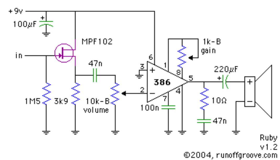

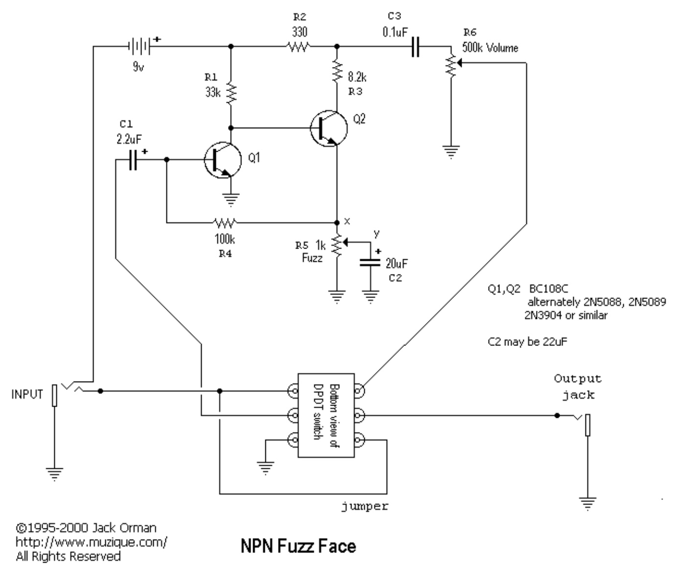

Anyways, as I was preparing to start drilling holes in the enclosure for the Ruby, it occurred to me that I could also fit the innards for a Fuzz Face FX pedal in the same enclosure. Both the Ruby and the classic FF circuits are relatively simple. Indeed, the FF has even fewer parts than the Ruby. Schematics attached.
Apart from the need to actually finish the Ruby (my first electronics project), is there any reason - a hundred? - why I couldn't just build them in series in the same enclosure? For example, attaching the signal line out of the Ruby (at the very end, at the speaker connection) to the signal line into the FF (before C1 in the FF circuit)? I would need to make other changes as a practical matter, of course, such as replacing the Ruby vol pot with a fixed resistor value and using the FF vol pot to control volume, and removing the foot switch from the FF circuit because it would be always-on. And replace the FF jack out with the speaker connector(s). But, "other than things like that," any reason the FF could not be built immediately after the Ruby in the same box? Is this a terrible idea? Absurd because the Ruby would need to follow the FF?

The Fuzz Face can't drive a speaker....replace the FF jack out with the speaker connector(s)...
Correct. 🙂Absurd because the Ruby would need to follow the FF?
It wouldn't be impossible for an experienced electronics constructor to build a Fuzz Face and Ruby amp into the same enclosure, the fuzz being before (not after) the Ruby. But the more stuff you build into one package, the more complications you add, and the more things there are to go wrong.
Also: Based on a clip I heard, I think the Ruby is already designed to fuzz the signal. Does a Fuzz-Face into a Ruby sound good? Darned if I know. Do you? Is it even a sound you'd want, if you manage to build it?
If you did stuff both fuzz and amp in one box, you would have yet more gain in an even smaller space. If the separate external fuzz pedal and LM386 hummed and buzzed, chances are combining two equivalent devices into one shared enclosure using one shared power supply will worsen the hum and buzz.

Yeah, I need to finish the LM386 Ruby before I do anything else. Tomorrow, I plan the physical layout and drill holes!
