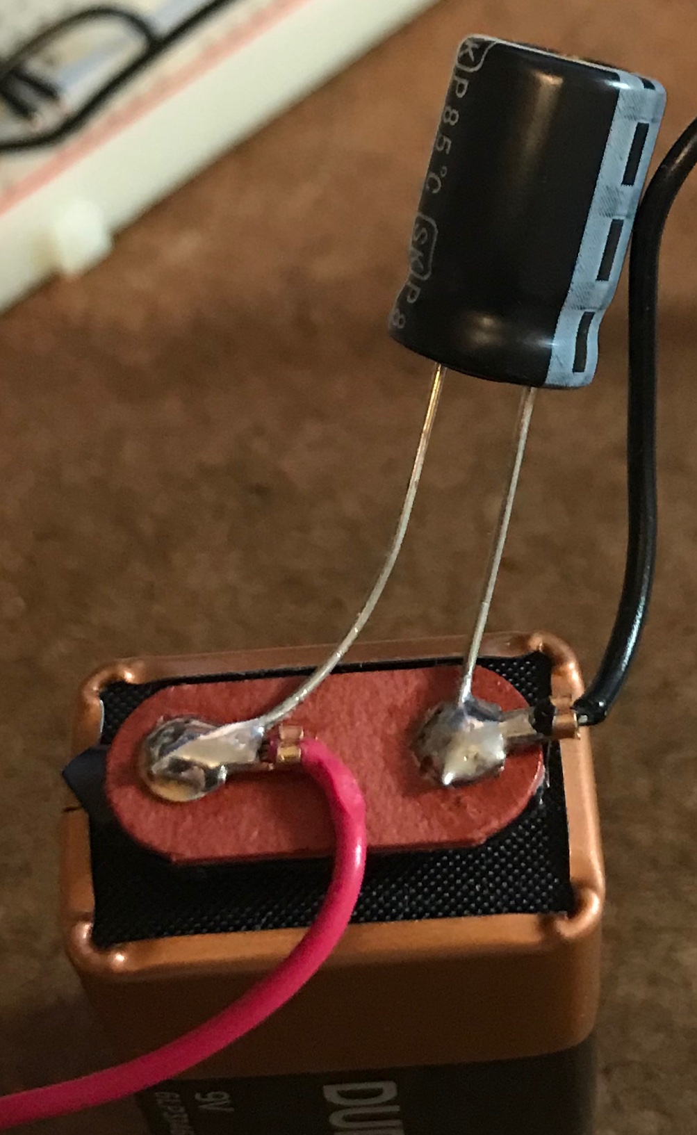

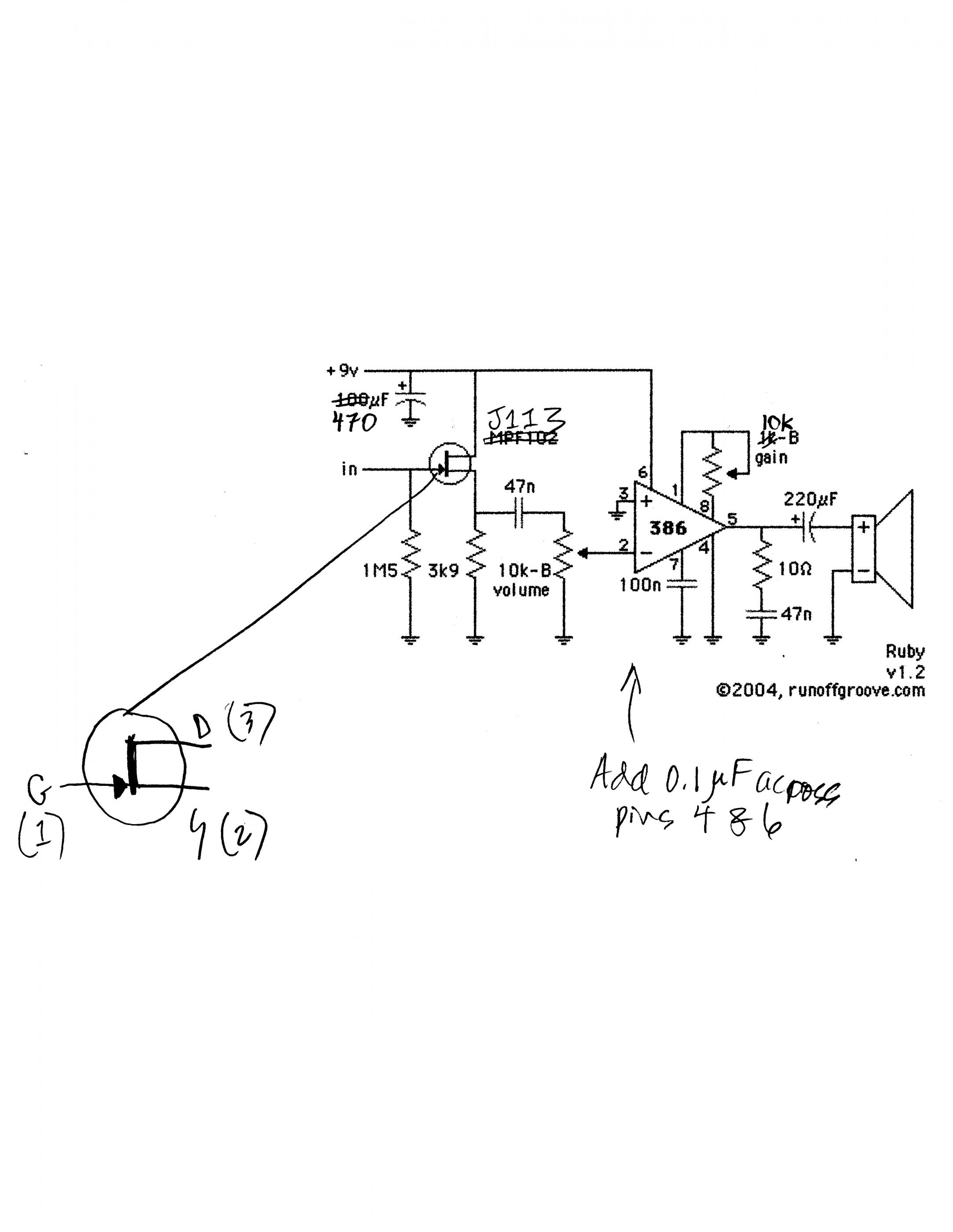

The attached schematic shows my Ruby build. The attached photo shows how I put the 470uF cap across the 9V + and ground. Is this an acceptable way to do it?

Good! In the Ruby amp, the JFET is configured as a "source follower", which has unity voltage gain; it doesn't make the input signal any bigger, unlike your stomp box. So hum from the guitar itself won't be amplified, as it would have been with the stomp-box.The level is much lower now with the J113 JFET replacing the stomp box powered by its own wall wart.
It's generally a good idea to have enough gain to get the sound you want, and not much more than that. So if your Ruby has enough gain to let you get to its full output power (and maybe get some overdrive), that's all you need. (If your tastes run to playing metal, you'll need a whole lot more gain, but that's another story entirely.)

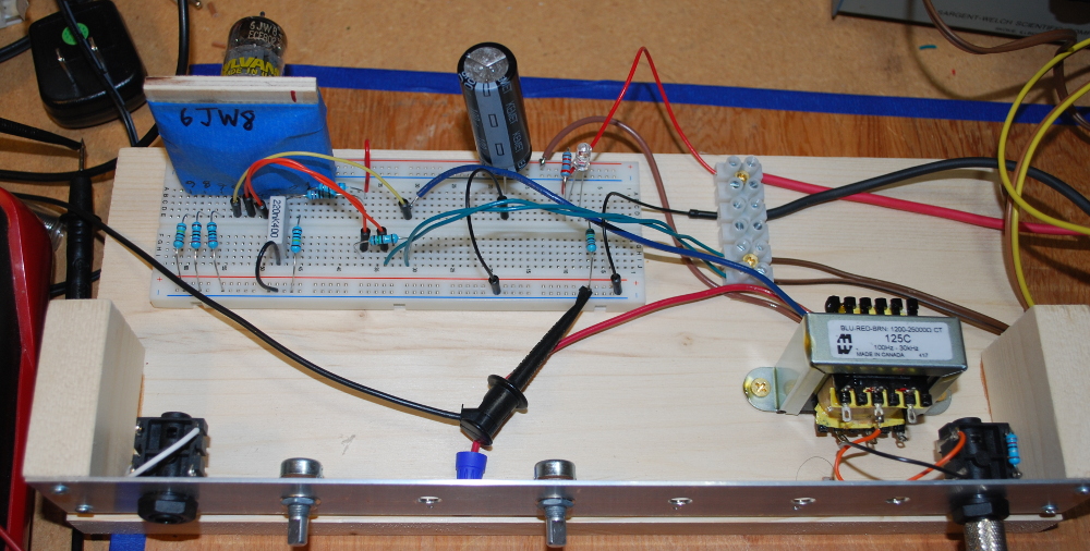

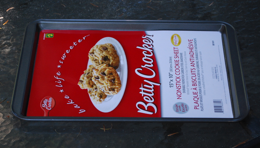

For cheap and convenient testing, ye olde dollar store will typically carry metal "cookie sheets" or baking pans for a couple of bucks. Scrape off a small patch of any Teflon coating, use a clip-lead or solder on a wire, and a tray like this makes a handy temporary grounded enclosure (first pic.)

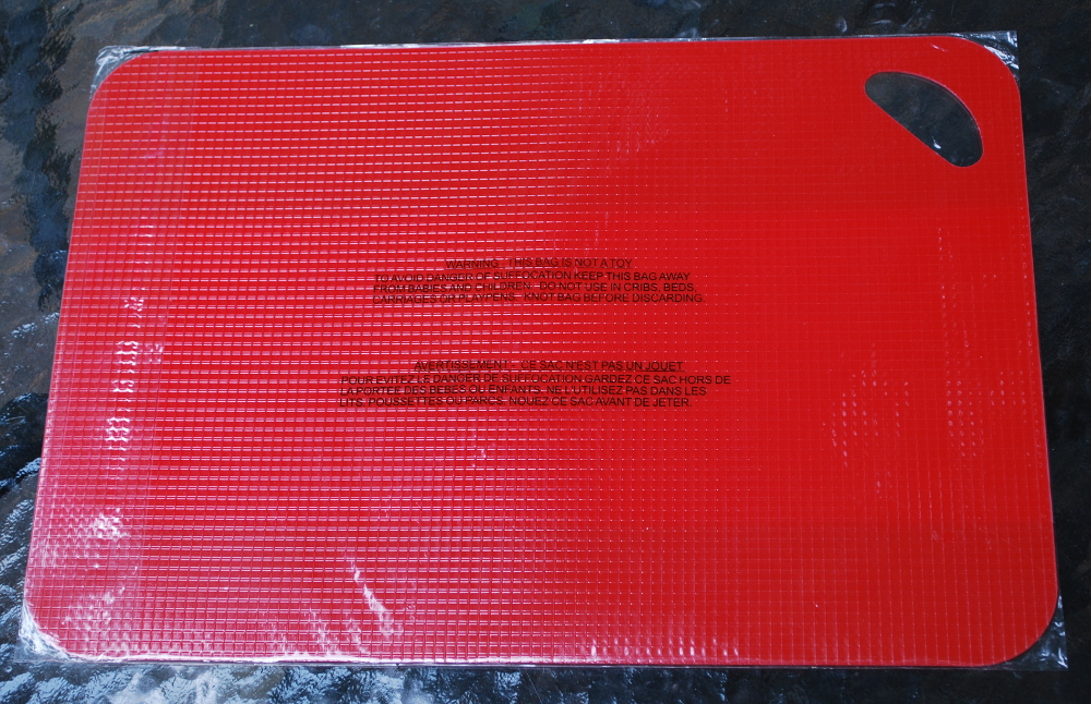

Make sure not to let any other wire ends touch the metal - I usually lay a dollar-store plastic cutting-board or place mat in the bottom of the tray to prevent shorts (second pic.)

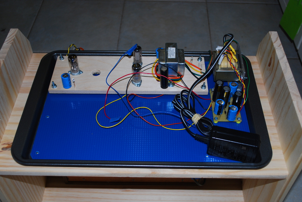

The fourth pic shows a old project (a 2-watt push-pull valve guitar amp) that I built using a dollar store cookie sheet for a chassis, and a dollar store plastic cutting board for an insulating mat. The wooden (pine) structure underneath is an IKEA RAST childrens night-stand, no longer available in Canada. It makes a passable guitar amp cabinet, particularly if you don't have access to a table-saw.
Electrons don't care if you're using a $2 cookie tray, or a $400 polished instrument housing...so I'm happy to use the cookie tray when it fits the project (size, strength, etc.)
-Gnobuddy
Generally, you want this cap close to the LM386, rather than close to the battery. However, if the wiring from battery to LM386 is only a few inches long, your present setup should work okay....how I put the 470uF cap across the 9V + and ground. Is this an acceptable way to do it?
The all-important ceramic or film cap - 0.1 uF typically - should be as close as possible to the chips power and ground pins (as I see you've indicated in your schematic.)
The big fat electrolytic filter cap can generally be up to a few inches away from the chip, but closer is better, within reason. If you can get it within an inch or two, great.
In more complex circuits, it's not unusual to have several of these big electrolytic filter caps across the power rails, at several different locations on the PCB.
The reason we want the ceramic or film cap as close to the chip as possible, is that the chip will typically "want" to oscillate at radio frequencies, typically several millions of hertz. At such high frequencies, an inch of wire actually matters - and so we want that cap as close to the chip as possible, to discourage the chip from oscillating.
Electrolytic capacitors are imperfect, and don't work properly at millions of hertz. That's why we need the little ceramic or film cap (for the high frequencies), and the big electrolytic cap (for the audio frequencies.)
Of course it's the audio frequencies we can hear, but remember, the chip wants to oscillate at radio frequencies, and if it does, it won't amplify our audio properly (and will also overheat, interfere with nearby telecommunications, etc.) So we use the belt-and-suspenders approach, the big electrolytic cap, and the small ceramic or film cap.
-Gnobuddy
Electrons don't care if you're using a $2 cookie tray....
Those are very clever adaptations of ordinary items! I'll have to see if I can bookmark that post for when I try something a little more ambitious ... later.
I'll remember that when I do the final soldering on the final board.
The all-important ceramic or film cap - 0.1 uF typically - should be as close as possible to the chips power and ground pins....
Right now, the leads of that cap are in the breadboard holes closest to pins 4 and 6. I'll keep them close.
Thanks! One more pic, of a slightly later evolution of the same project. Still a temporary (plywood) front panel, and no housing for the electronics.Those are very clever adaptations of ordinary items!
This ended up as a two-channel, two-watt tube guitar amp, which I used for quite a while, but I always felt that it needed a bit more tweaking on the higher-gain channel, and I never got around to actually doing it. I still have the amp, maybe I'll revisit it some day.
