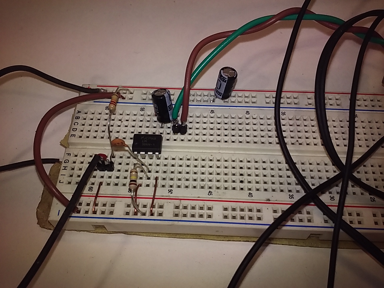

I read 8.26V DC at pin 3 (audio input) of the NTE823 chip and 11.07V DC on pin 5 (audio output to the speaker). So far, for my purposes, so good.
which is certainly caused by:
run the audio in thru a 4.7K 1/2W resistor and a 0.033uF 100V cap to the audio in pin (pin 3)
Nothing will work, nothing else is worth correcting (oscillation, distortion, decoupling, etc.) until you correct this error first.
In a nutshell, I suggest you build the exact datasheet example and try to make it work; mods, experimenting, etc. come later.
Quote: "run the audio in thru a 4.7K 1/2W resistor and a 0.033uF 100V cap to the audio in pin (pin 3)"

I am actually more worried about the input cap, which is NOT in the datasheet example and to boot allows >8 Volts on pin 1 😱
And by extension the >11 Volts on speaker out pin
hence my suggestion to build the exact datasheet circuit, PERIOD, no IFs, BUTs or WHYs.
And to feed it what the datasheet example demands, drive what it suggests, etc.

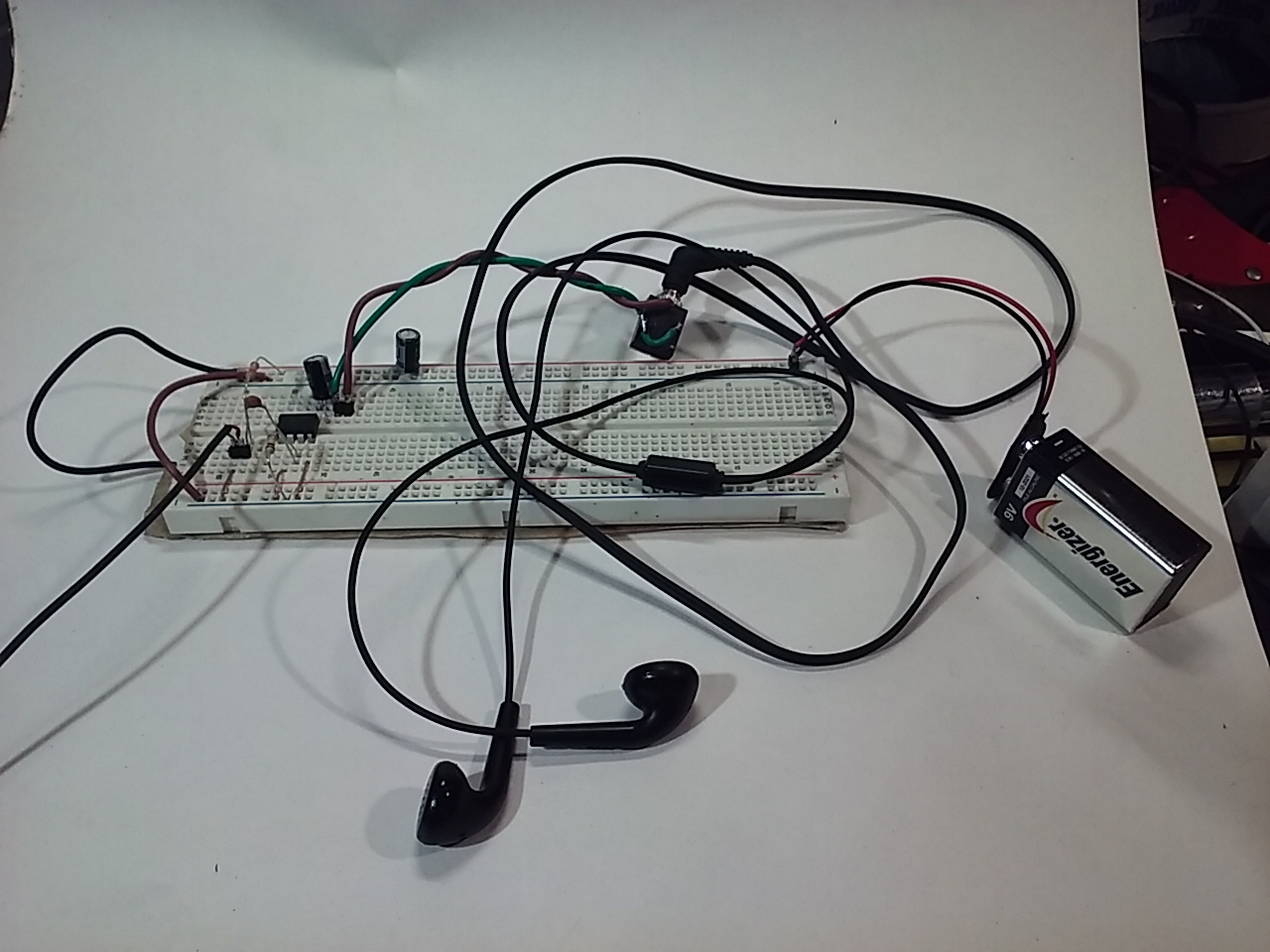

Hey, a PRACTICAL example:
a couple nights ago, late at night, (say 1AM to 3AM) I heard loud voices at my door, my camera showed a couple unsavoury type guys drinking, shouting, sitting on my home doorsteps.
I permanently installed there, long ago and for safety reasons, an Electret microphone, embedded in the wooden door.
Faster than searching my old preamp, I Protoboarded in, what, 5 minutes?, an electret mic driver (a simple 22k resistor connected to +9V) and ... you won´t believe this 🙄 ... an LM386 headphone amp 😱
Fed by a .... 9V battery!!!!!
Of course, it worked on first try, no hum/hiss/oscillation/nothing, just flawless crystal clear reproduction.
And I could listen to whatthey were talking, better than themselves, even though the mic capsule is some 10 meters away and its cable goes through a thick wooden door and then through a thick brick wall, into my workbench.
I used the basic LM386 20X gain and hear anything spoken a few meters around my door, footsteps some 15 meters away (I hear people walking on the street before they appear in my camera field of vision) and if adding the pins1-8 gain boost, I can hear people whispering across the street, go figure.
That´s why I can´t believe your continued "bad luck" building such a simple circuit.
here is the successful "5 minute spy microphone":
Again:
1) build the exact datasheet example
2) once it works, add whatever extras you want to experiment.
3) OF COURSE, feed it 9V to 12V, nothing else.
A fresh 9V battery costs peanuts and always works.
I was in a hurry so decoupling was as basic as can be, just a rail to ground 220uF capacitor, not even a ceramic across the IC, and not even a Zobel at the output, which I would have added if needed, but it worked flawlessly as-is.
A real forgiving little chipamp.
PD: notice I DID refer pin 3 to ground, even if I used a larger than recommended 100k resistor (which I already knew from earlier experiments works flawlessly), did NOT leave it floating as you did, so please correct that mistake before anything else.
No mystery sauce here, my build is as plain vanilla as can be.

Apparently I've been unclear again. I got it working quite a while ago. Then I messed it up when I was moving everything. Then I got it working again. The current, working version is reflected on the last schematic that I posted, from basiccircuits.com Along this journey, I've experienced hum and other noises. It remains to be seen, when everything is moved to a phenolic board and excess wire is removed, whether the hum/noise will still be there. I'm slow to make the move because I want to make sure I do it in a way that facilitates my longer-term goal - more a woodworking project - of building this little amp and a speaker into the cover of a box that will have a pedal board on one side and the amp & speaker in the lid. ... Although as I think about it, I can always just build the same or a similar amp again if I like the way it turns out. Yeah, I just need to finish this one.

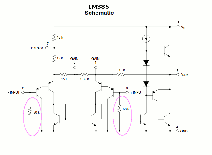

I've never used an LM386 as far as I can remember, but early in this thread I looked up the Texas Instruments datasheet. It includes the internal schematic of the LM386, which is attached here.I am actually more worried about the input cap, which is NOT in the datasheet example and to boot allows >8 Volts on pin 1 😱
Inverting and non-inverting inputs both use a PNP Darlington pair in a slightly unbalanced long-tailed-pair configuration, with a conventional current mirror to combine the outputs and send them on to the voltage amplification stage.
The relevant thing for this particular discussion is that both inputs are biased to ground via internal 50k resistors inside the chip. It looks as though the chip should bias up properly even if coupling capacitors are used to both pin 2 and pin 3.
I assume that the datasheet doesn't show any input coupling cap because this chip was designed for use in low-cost electronics, where the cost of one extra capacitor would be eliminated if at all possible.
I don't know why Jimbo was measuring 8 volts on what he believed to be the input pin - that was clearly a mistake of some sort. My suspicion is that the meter was accidentally measuring the + rail, and not the non-inverting input of the chip.
In fact, looking at the internal schematic of the LM386, even if pin 4 of the LM386 is accidentally NOT grounded, you can't get the full supply voltage at pin 3 - the internal schematic shows you have 30k of resistance plus two Vbe drops between Vcc and pin 3, which is connected to ground via 50k. You cannot get more than maybe 5 volts DC appearing on pin 3 when the chip is powered by 9 V, even with pin 4 accidentally not grounded!
