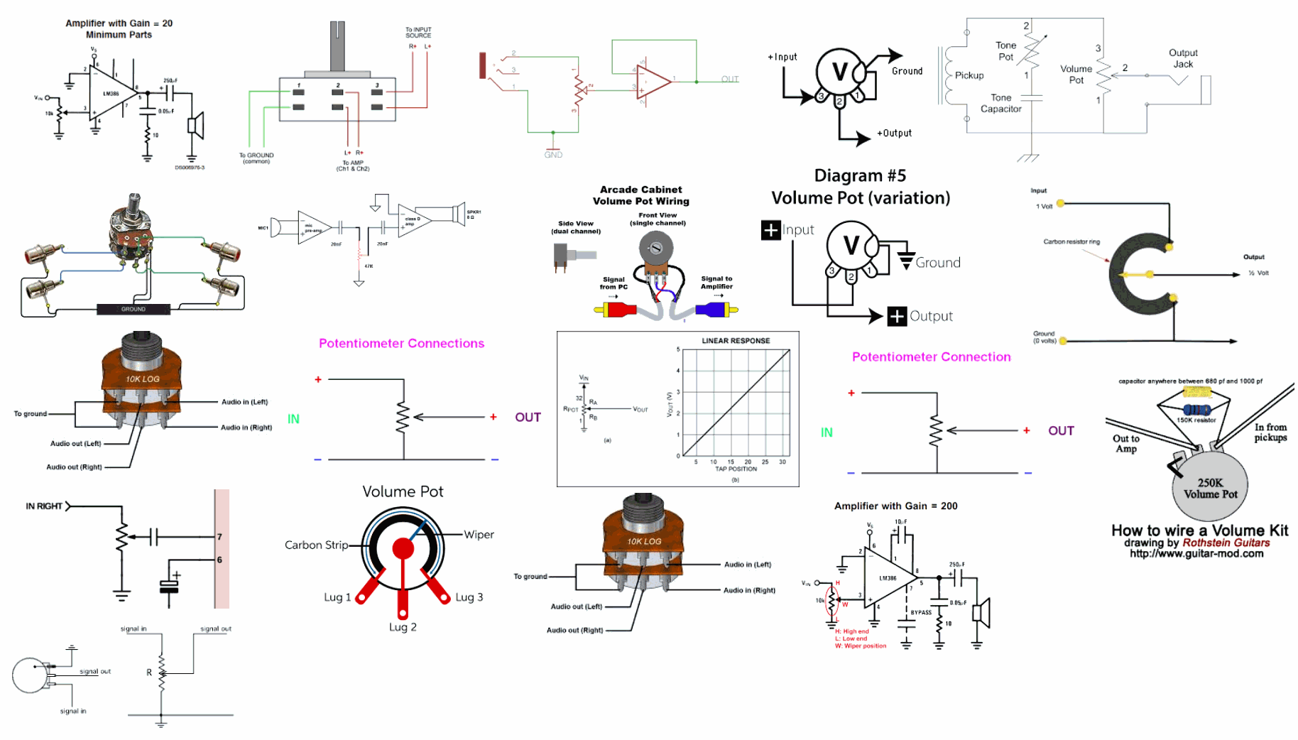

A rough selection of Google images for Volume Control.
Some are Stereo, so only look at half. One has extra stuff, you don't need that here. One is duplicated (oops). There ARE times when your "backward connection" IS better; this is not one of them. Confirmed by the fact I did not find any backward-connected volume pots in hundreds of images.

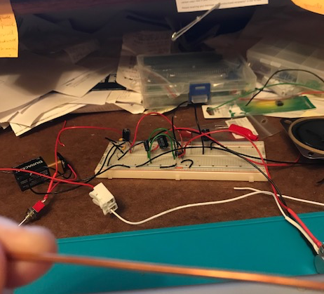

I understand the appeal of a breadboard. But it comes with some limitations, too. If you can get your circuit to work properly on the breadboard (without lots of hum, buzz, or bursting into radio-frequency oscillation), perfect.I'll have to do that after I get all the pieces of the puzzle together in one place first.
But if the amp never works right, because the breadboard prevents it from working properly, then you won't be able to make any progress, and in that case, its time to head for the protoboard instead.
Protoboards and chip amps don't get along all that well, either, by the way...a properly designed PCB is virtually mandatory with more powerful chip amps. Most of the time, the manufacturer includes a reference PCB design in the datasheet, and you make changes to it at your peril. The manufacturer may have had to put in a lot of effort to design a PCB that keeps the chip amp stable and audio distortion low.

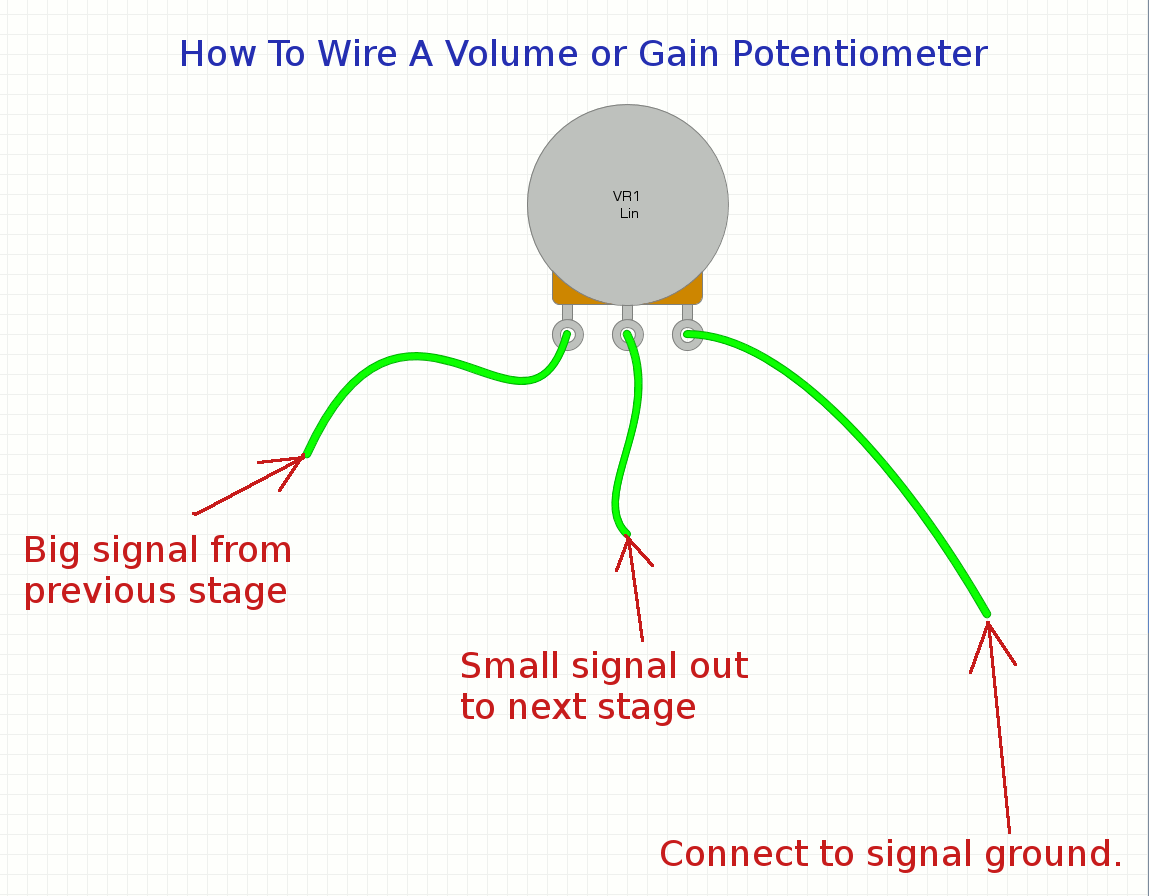

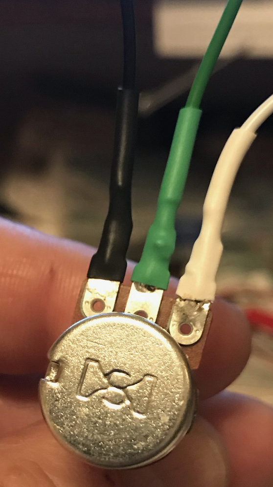

how to wire up a volume control. So I made the attached image to clarify how it's done.
Is that from the bottom, with the wiper shaft on the other side?
Mine is not wired that way now, but the amp is working, albeit noisily. If it's wired incorrectly, shouldn't the pot not work at all?

Did anybody notice the input is NOT referenced to ground but insulated by a capacitor?
Which would explain the >8V DC present there and the stuck-to-+V speaker out, which apparently didn´t bother anybody.
In my book, FIRST get DC voltages right, THEN worry about sound, oscillation or whatever.

As for that pot, I believe I wired it correctly in the attached photo (black is ground, white is signal in, and green is signal out), thanks to the kind advice of others in this thread.
Please provide a link to your book.
If the hum quiets down when you touch the guitar strings, it confirms this.
No change when I touch the strings. Given what you said about breadboards, I'm resigned to a lot of noise until I move the project to an assembly board of some kind. I'm toying with the idea of using something untraditional and well insulated/isolated, as you did when you were a kid. (I seem to be approaching a second childhood of sorts.)
