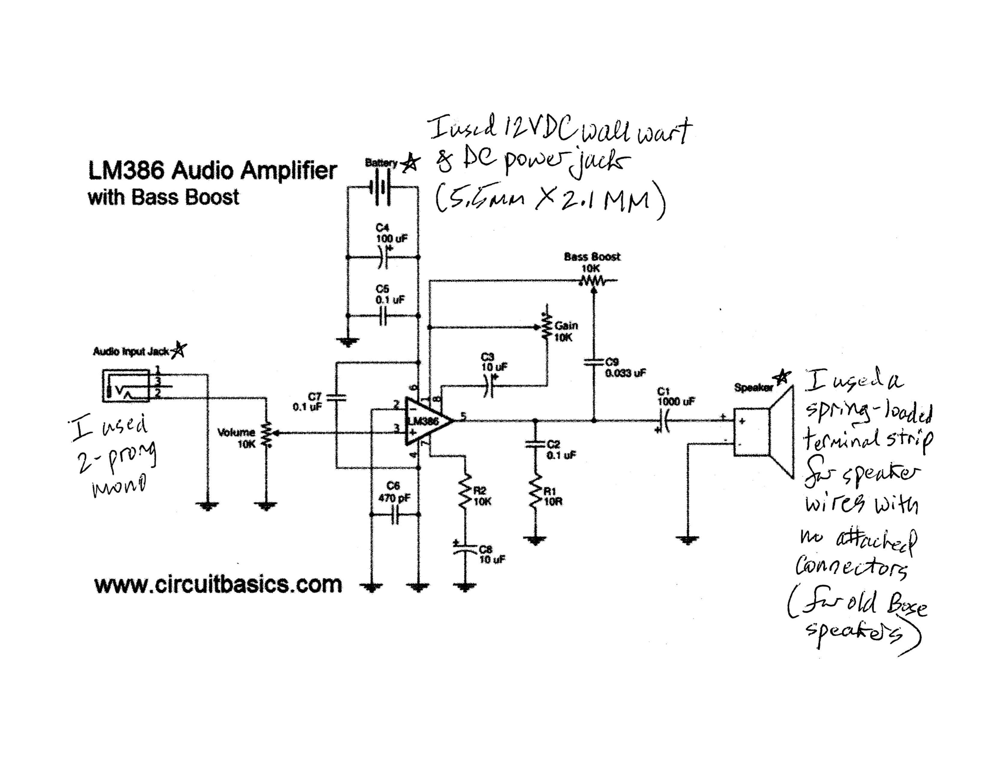

I achieved a no-hum output by putting a 10k linear pot followed by a 10uF/35V cap between pins 1 and 8. The no-hum is present with the pot thru approx. 0-4 of 10; in that range the guitar is amplified. The hum returns and increases from approx. 4 up to 10. I'd say this is progress. It pays to add the gain control with a pot and cap between pins 1 and/to 8.
I got rid of ALL hum by adding the "Bass Boost" between pins 1 and 5 and doing my best to separate physically all the off-board components - battery, mini toggle switch, guitar jack, 3 pots, and speaker. The Bass Boost uses a 10k linear pot and 0.033uF cap. Where these go relative to other components already on pins 1 and 5 is a hard to describe in words, but I'll try: viewing the Bass Boost as a line, it begins on pin 1 AFTER the insertion point for the gain control, and ends on pin 5 AFTER the cap-&-resistor-to-ground and BEFORE the speaker cap.
Another thing that I did - on my own initiative - was to add a cap to every wire-to-ground if the wire did not already go through a cap. It seems to me - a noob - that it might undermine the purpose of caps already placed on wires-to-ground if I left other wires-to-ground uncapped. My thinking is that the uncapped wires-to-ground might feed some DC into the ground network and cause undesirable feedback - although, as I write this, it occurred to me that the caps already specified would block such feedback - although, again, as I write this, I have to wonder if that is true where the caps already specified have polarity and any feedback would reach the negative pole first. I don't know how to address those issues, if they are issues. In any event, I don't see how having a few extra caps on going-to-ground wires would cause any problems, but I would welcome any comments.
The off-breadboard components all have wires that are way too long. I'll need to shorten them as much as possible as soon as I figure out what type of board/box to use. (In the long run, my goal is to build a pedal board/box with a lid, with this little amp and a decent speaker built into the lid. Although, now that I think of it, I can always build another little amp - or a little, more ambitious one - for the lid of the pedal board/box.)
Schematic of current, functioning build with volume control, gain control, Bass Boost, and extra caps on the ground network to follow.

Are there and rules of thumb how best to move a build from a breadboard to the final enclosure? Install the off-breadboard components first, then the chip? Install the chip first? Do a hub (chip) and spokes (pins & off-board components) drawing to get a good sense of an easy potential layout before drilling holes? Any preferred order hear? ... I like the idea of a hub and spokes drawing before I do anything else.
While moving the breadboard, several wires detached and initially I could not figure out where they go. Frustrating. After a night's rest, I tore apart most of the build and reconnected each section carefully. Without all the extra caps on the wires-to-ground. The amp works now as before, except there is hum again. Bummer. Based on gnobuddy's comments, I assume the reason is the long wires shown in the attached photo and the connecting metal in the breadboard itself. The hum varies as I move components with long wires around and touch various metal surfaces. I've been very careful, as best I can be, to wire every pot correctly (yeah, the chaotic wire colors are embarrassing; I need to find something better than alligator clips for temporary connections to pot lugs). Time to move everything over to the final board and an enclosure. Lots of photos in case wires get detached again while moving. Need more wire colors for easier visual tracing of the various sections. Final schematic before anything else.

There is no good point to running a LM386 on 15V. For typical loads it runs out of current with 12V supply. While there is an 18V version (for hi-Z loads), most '386 are rated to blow-up with 18V, and 15V is right on the edge. My experience is that such chips will take a few extra volts today, but die "for no reason" next year or even tomorrow.
You have enough on your plate now without also fooling with excess voltage. Feed it right.

First question to answer: What is the source of the hum?Now that I have a functioning amp, I want to make sure I try everything to eliminate the hum which has returned.
IIRC, you said there was no hum with the volume control turned to zero. This means the power amplifier itself does not hum, when its input is shorted to its ground (by the volume pot set to zero.)
Next step: disconnect the wire from the "preamp" (FX pedal) to the LM386 amp volume control. Turn the volume (of the amp) up from zero, so the input is no longer shorted to (amp) ground. Does the LM386 hum?
If yes, what happens when you put a grounded piece of metal under it? What happens when you invert a grounded metal pan, etc, over it?
If grounded metal around the amp removes the hum, you're dealing with noise pick-up from thin air. Nothing will cure this other than mounting the amp in a proper grounded, conducting housing. It doesn't have to be expensive - an old tin can is as good as an expensive die-cast aluminium box as far as stopping RF interference goes.
Once your power amp is hum-free at all volume control settings, you move back to the preamp (FX pedal), and test it in a similar way. Unplug the guitar. Power the pedal with a 9V battery. Does the amp hum? No?
Power the pedal with the 9V AC wall wart. Does it hum now? Yes? The problem comes from the wall wart, which most likely isn't grounded.
And so on. Use logic, work your way back one step at a time from loudspeaker to guitar pickup. Find out where the hum originates, and once you do, you can find out how to reduce it.
