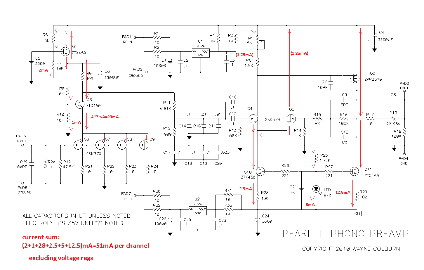

for search engine: Pearl 2 current consumption
ok, see enclosed
actual current consumption is in range of 50mA per channel, taking in account highish Idss specimens of 2SK170BL (correct me if I'm wrong there)
now, I need to know 2 things:
- dual mono regs or one common for both channels?
-which exact schematic of Good Gemini you're counting on?

for mono feed, let's say that programmed current could be 100mA
for both channels, let's say that programmed current could be 160mA, but 200mA even better
now, if you're able to set that, and also change few resistor values to get proper span of output voltage within pot travel, you're probably capable of making decent reg pcb
if you aren't, invest some in more Porridge (good for brain) and some elbow grease ...........
I'm here to help with any dilemma .........

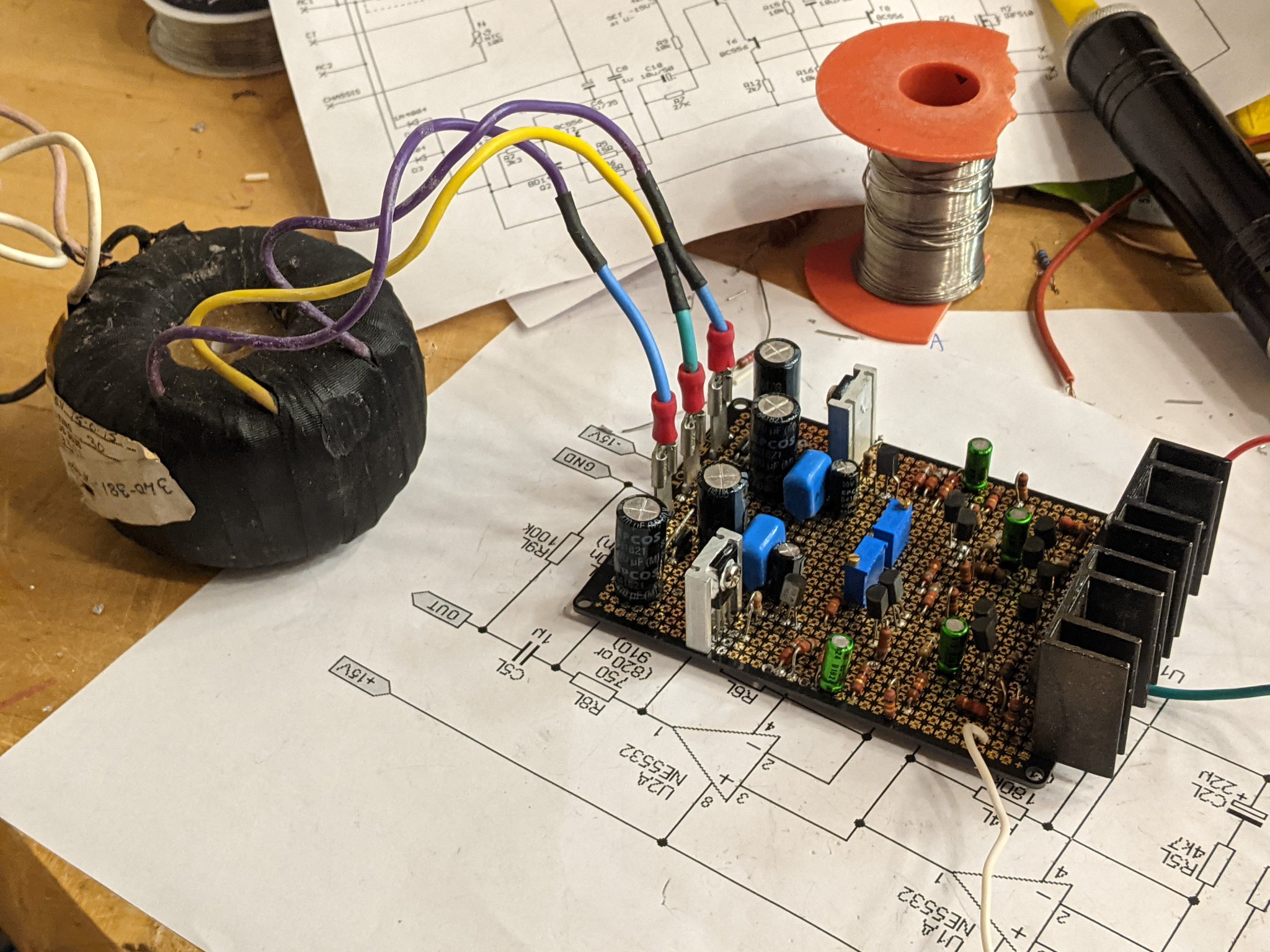

I've been fiddling with the p2p Good Gemini. I tried larger heatsinks on the BD139 and MJE350, which gave enough time to find that the mosfets were getting really hot. (Infrared doodad said around 100 celsius...) So I turned it all off, and looked for the mistake... Turns out I'd misconnected the parallel 15R resistors, which (I think) meant that far too much current was passed by the CCS (? Did I get that right ? ) so I took things apart and rebuilt with things connected correctly. (Always much more difficult than getting it right the first time...)
Things are now working correctly, I think, and the heatsinks I was using before now seem adequate for the big bjts. However I think the mosfets are still getting too hot (although nowhere near as bad as before). Is there any reason to think this is because of the substitution I made of IRF 530/9530 instead of IRF 510/9510? If it's normal for the 530/9530 it isn't a big problem just to put small heatsinks on them, but it might be a sign there's something else wrong, I guess...
Any thoughts?
current through these is simple : programmed current - current through load
dissipation is said current * voltage
so, if you have 0V65 across programming resistors, calculator is giving you confirmation of programmed current
you don't need sinks on mosfets up to 500mW or so ...... in fact even more up to 750mW
so, use your brain and calculator and that's it
if in doubt that they're too hot, put sinks
write here what are you shooting at - output voltage, programmed current, load current
I don't know what you're building and in what arrangement (to be fed with Good Gemini)

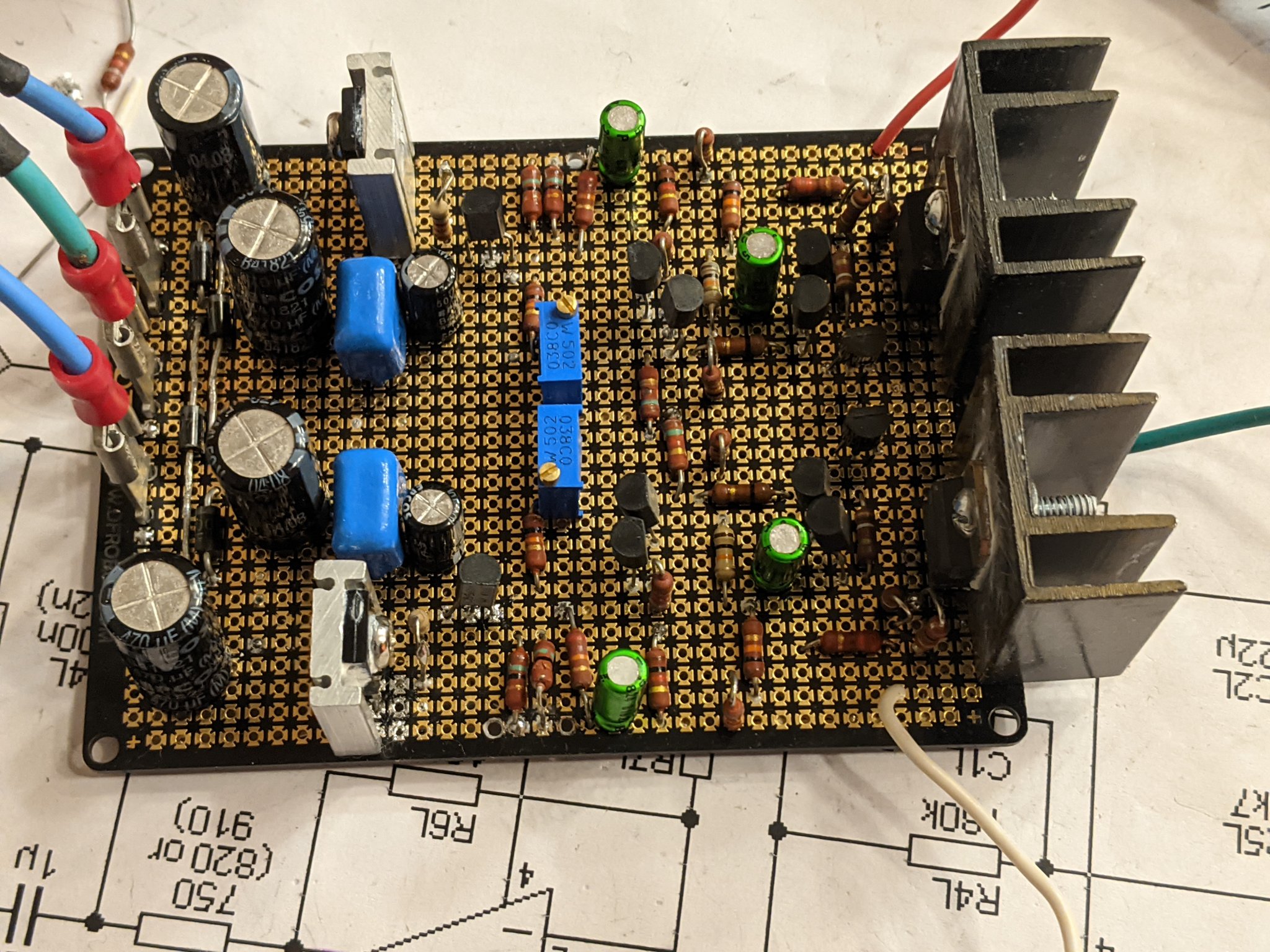

Thanks ZM. Since you asked, my aim here is to build the reg close to as originally designed; transformer with dual 15VAC secondaries, looking for 15VDC output to play with p2p SE Iron Pre and experiment with ebay transformers. (Some already here, some on the way... ) So target currents are the same as the ones you discussed above. The only variations are due to using what I had in my junk box, rather than buying new parts, so there are a fair number of substitutions. Mostly pretty close ones, as I discussed above. In particular, I'm using paralleled 15R to give 7.5R on R3/4 and R5/6, so current should be as previously advertised.
Anyway, I checked everything over again, and I have 0.676 V across R3/4 and R5/6 (these are what you call the prgramming resistors, right? Because they set the current?) which close enough to the 0.65V you mentioned. So all is well there. And as you say, this should leave the heat to be dissipated at about 1/2 W, or a little more. Nonetheless the mosfets still got hot; after a couple of minutes they were already over 60 degrees C, which is just about in the safe zone for the usual discussion of heatsinks and Class A amps, so I guess would be OK here (as you said above) but it left me uncomfortable...
So the junk box came to my aid again; in the photos you can see I turned the mosfets around and put heatsinks on them. Actually I got lazy and sacrificed the old mosfets; the new ones are IRF 630/9630. Now the heatsinks get warm to the touch, but no more than that. Same for the small ones on the BD139/MJE350. All seems to work well; I have +/-15.00V on the rails.
So now on to p2p amp boards! My plan is to build them in such a way that I can easily switch different transformers in and out, perhaps on daughter boards, somehow, and see what sounds good. Should be fun.

rest - looking good
ditch those horror connectors, when you're done with xperimenting
You don't like the spade connectors between the transformer and the board? Or you mean the temporary wires on the output? (They'll certainly be replaced by something better.)
So you would usually solder the secondaries of transformers to the boards? Same with your amp builds?
I used these spade connectors this time since I used them on prasi's M2 boards, and liked them better than the screw connectors I've used in the past. No reason why things can't be soldered when all is done, though, I guess.
