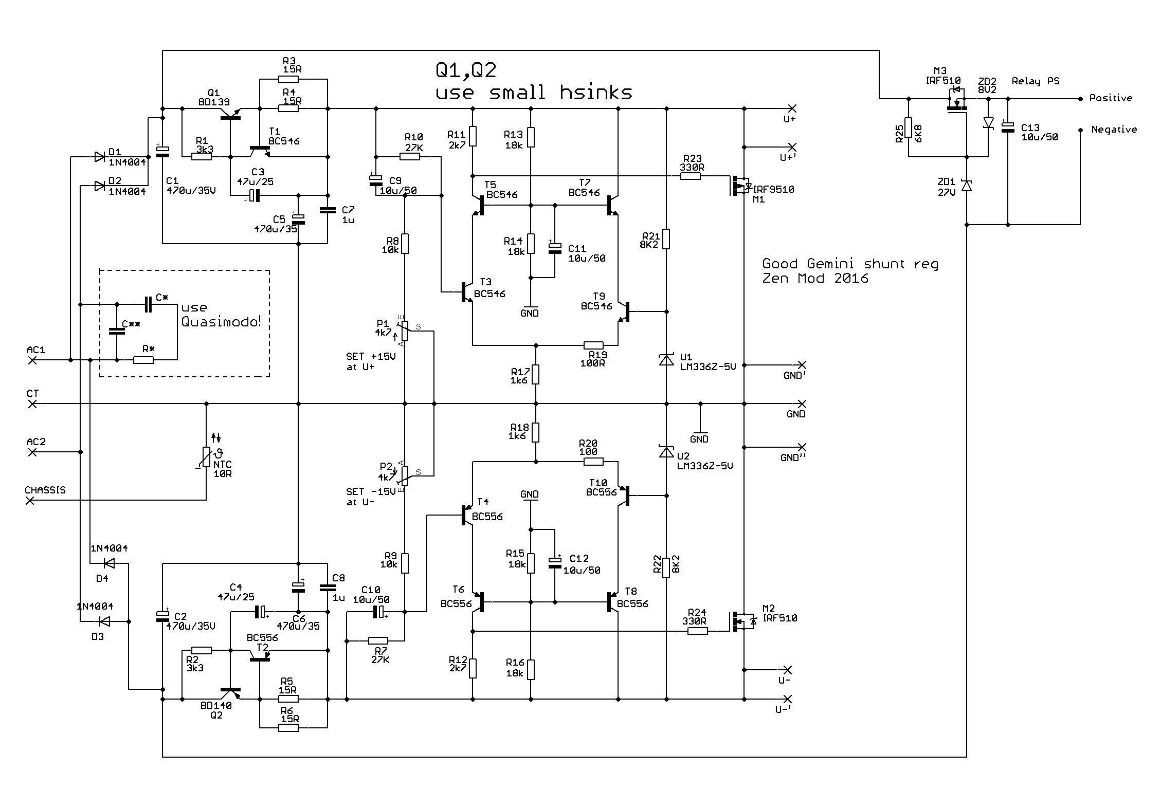

What is the total current drawing (shunt reg and buffer) ?
post #1149
for positive rail I=Ube/(R3//R4)=0V65/7R5=87mA
for negative rail I=Ube/(R5//R6)=0V65/7R5=87mA
CCS up and CCS down are defining sum current draw
buffers are pulling, say, 8mA per channel, sum is 16mA, so rest to 87 is wasted in shunt mosfets on end of reg
programmed current can be lowered to, say, 50mA without penalty
for that said resistors need to be 0V65/50mA = 13R (sum of two, so 27R is nice value for all of them)
yes, input relays, pre-reg feed points, in case of 24Vdc relays, one pulling under 10mA

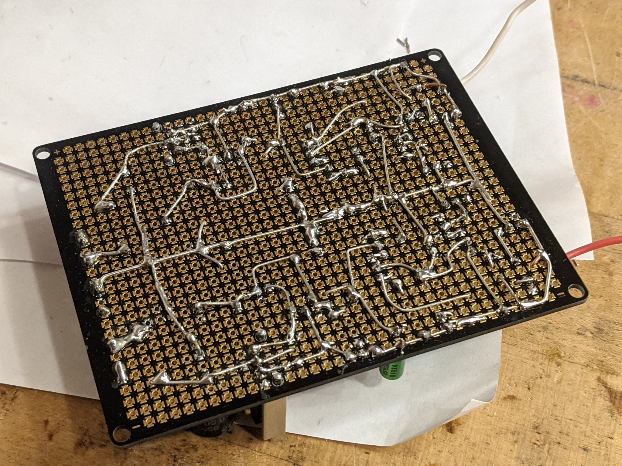

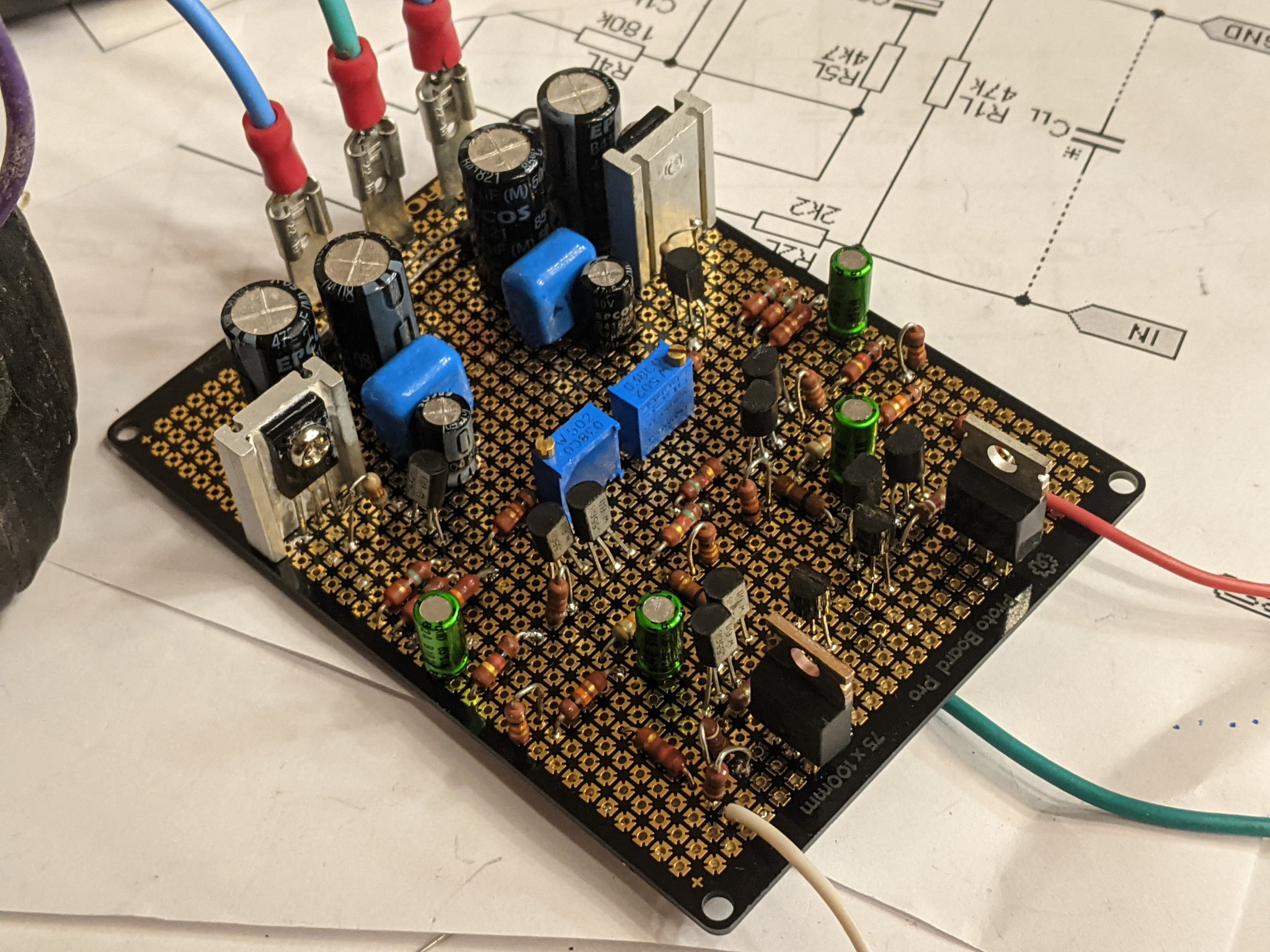

On a related topic, here are some photos of the p2p Gemini shunt reg I finished this evening. I decided to limit myself to only parts I already had lying around, as extras from old projects, or ones I could pull off boards that are no longer in use; the idea being to use up some of the things that I have kept "in case they were ever useful", and not buy anything new. Mostly worked out well. The transformer is a Holden and Fisher 30VA, with dual 15V outputs, which is one of a pair I bought on ebay a while ago, for a project I ended up not building. Some of the resistors are made up from pairs in series (since I lacked the exact values) and in some cases are only approximate. I figured that within 5% or so is probably fine, since if closer tolerances were needed ZM would surely have said so. (Although perhaps he did and I missed it...) Slightly more seriously, I didn't have the right mosfets, so I used IRF 530 and 9530 instead. Does it make any significant difference? My guess is no. And finally, I had several BD139 I could pull off old projects, but no BD140, and several MJE350, but no MJE 340; so I mixed and matched, using one BD139 and one MJE350. Since the schematic looks like two single-rail PSUs, one on top of the other, it seems to me it proably doesn;t make any difference.
Anyway it worked first time - which is always nice - and I'm quite pleased with the p2p wiring, which looks a lot cleaner than mine usually does although I still need to clean the flux off and tidy up a little.
The only concern is that the heatsinks seem too small for the BD139 and MJE350. Before I go any further I think I need to root around in the junk box and find ones slightly larger.

Nigel, you're good on all accounts, and I'm happy to read that you did use your common sense for plenty of positions
heatsinks - just trust in your fingers - if you can keep finger on sinkls for 10sec, critters are happy; if shorter time, increase sinks to keep critters happy
regs - in principle - decent sch is 50%; next 50% is layout of traces - not just GND for all elements, but also differentiating power traces from sense traces etc.
for PtP, you're most likely fine
