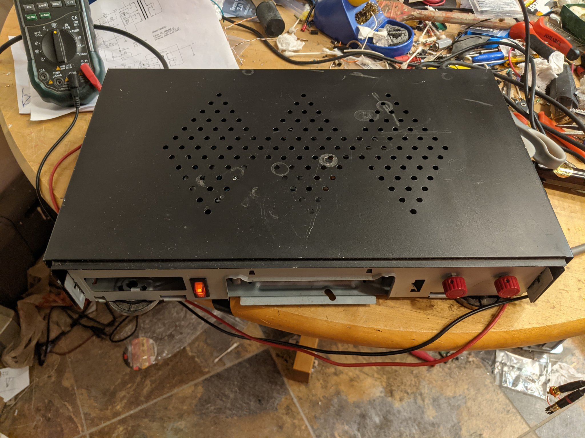

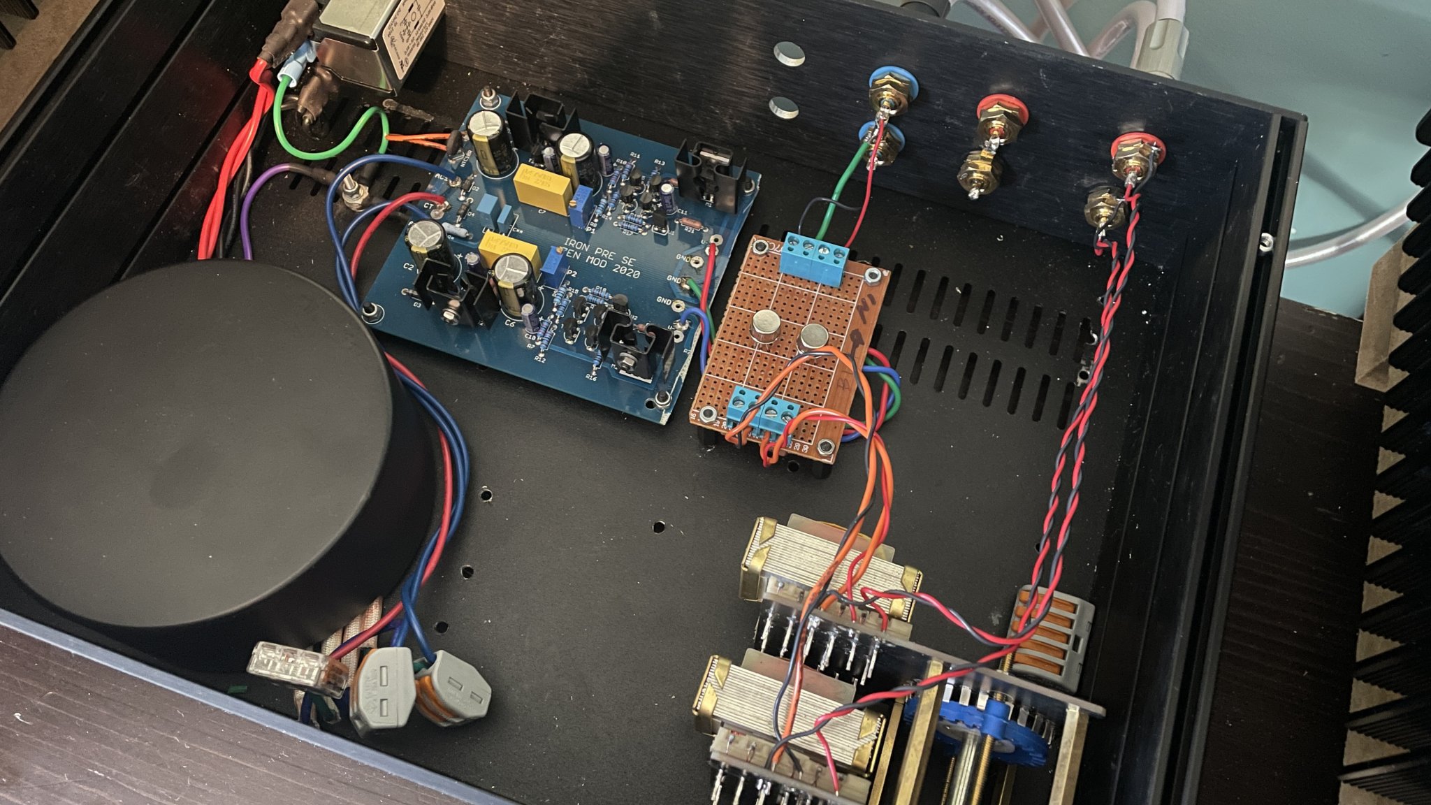

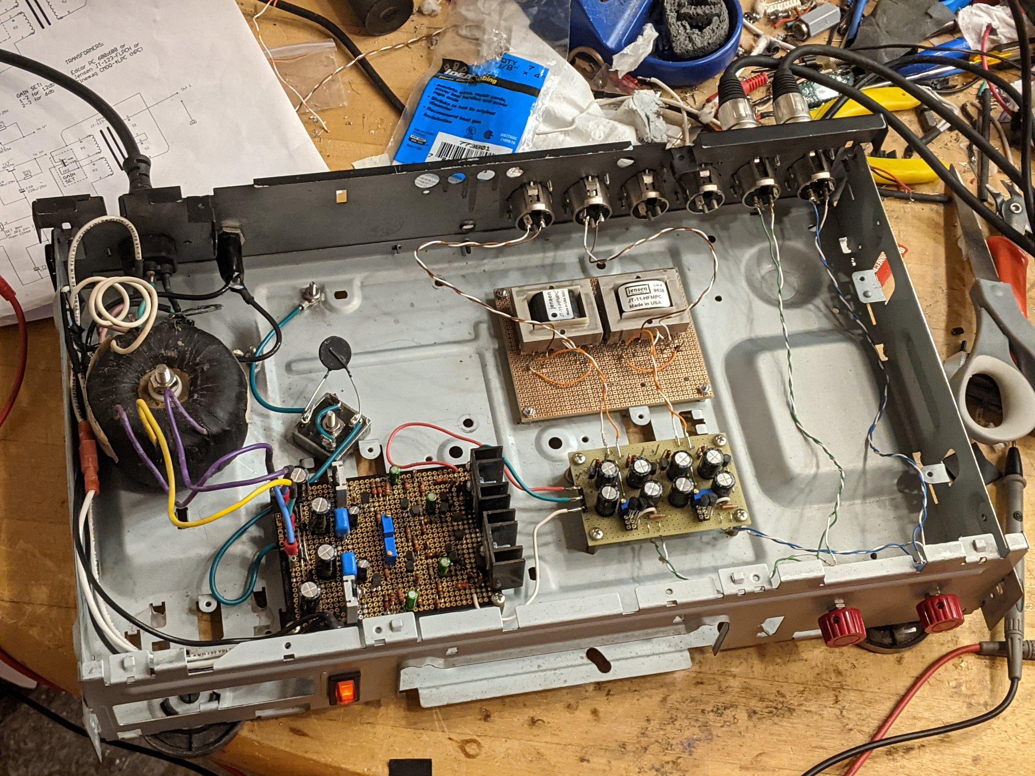

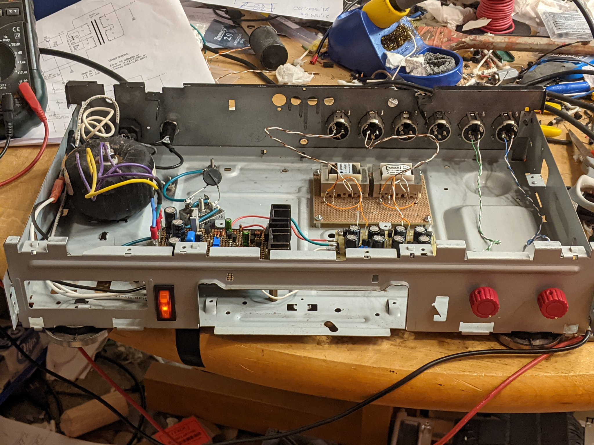

Here are some photos of my first experiment. I'm listening to it right now, and it sounds great! Connected to my diy M2s and B&W CDM2 bookshelf speakers.
I continued with the "garbage and leftovers" theme, and did almost everything using parts salvaged from old projects and spares left over when other things were finished. Nice to use up some of these up. The case is an old CD player (I think) that I started making into a pumpkin preamp years ago when I lived in Brazil; the XLRs were fitted back then. Project was abandoned long ago and the case has been kicking around ever since. Volume pots are quite nice little NOS clarostats (I think) I got from ebay some time back, but nothing special and not going to stay in a "final" version. (I really like the vintage red knobs, though...)
The main buffer board is also p2p, but the bottom isn't quite as pretty as the PSU one. Jfets are from my (very small) stash of original toshibas, and I was lucky to get very close idss matches. I put them in little sockets, so that if I don't want to keep them in this then there's no potential damage from unsoldering them.
As I think I said earlier, my plan is to substitute different transformers if and when I can find interesting things to try out, following ZMs comments on telephone repeaters and similar, back up near the top of the thread. I also want to measure some stuff with REW.
A couple of questions. How much do you need to be concerned about the DC offset? I realise the point is not to get DC across the transformers (just as you don't want it across tweeters in a DC coupled power amp). But once you get it down to 1mV or less then is there any reason to fight to get it better? Seems to me that the heat being put into a transformer with a 250R primary (which is about what these are) is tiny; only V2/R = (0.001)^2/250 = 4 x 10^(-9) watts. On the other hand those wires in the transformer are really small also. I couldn't find any max value on the datasheet for this, but perhaps I don't know what to look for.
As a related question, how accurate are DMMs in measuring values below 1mV?
Nigel

1mV figure is OK
DMM is precise there, though depends of quality of same
if it's POS, better toss it through window ...... lousy DMM is worse than none
if it's not POS, good

simple logic
signal xformers were and are used in all sorts of circuits (DC coupled) , from dawn of electronic era
in many cases, TempCo (DC offset in time/temperature domain) of used circuits was much worse than you have with your buffer
so , even if I'm setting mine under 1mV, you're good with 1mV, if you can't bring it lower
that's all matter of preventing DC flux in core, Rdc of winding there being just factor
so, just chill and ....... chill

Thanks. Makes sense. In the end I got mine down lower; somewhere around 0.1mV. The rails are showing +/-15.00 V, so all seems in order. Sounds good, too!

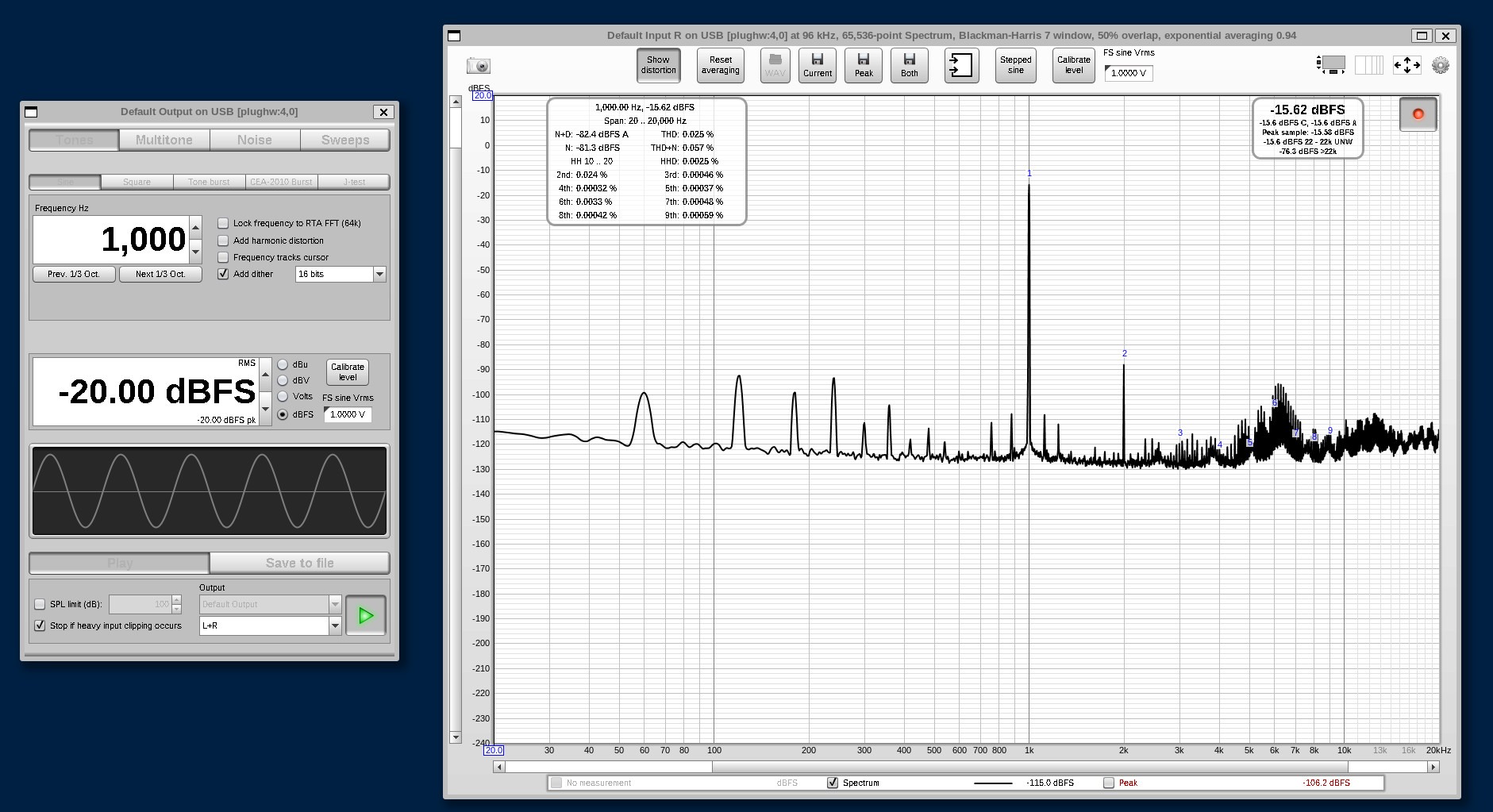

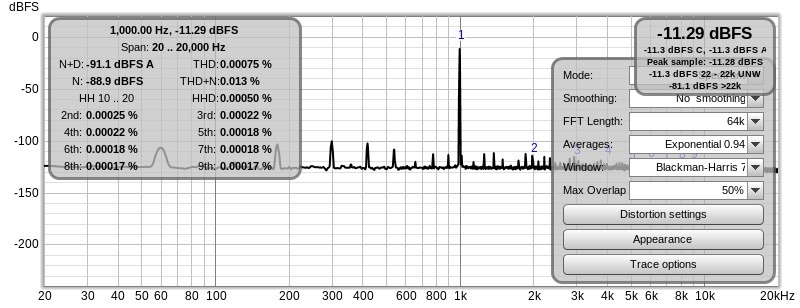

I played around a bit in REW to measure my garbage-can Iron Pre and compare with he BA-3 I made recently. I don't pretend to have a very good idea of what I'm doing in REW, but I found it interesting to compare the two. (I could have saved the files better, perhaps, but I didn't realize how bad they looked until I had the Iron Pre back playing music, and I'm not inclined to turn it off...)
I used a 47k load resistor. For both of them I set the preamp at maximum volume and controlled the volume on the Focusrite that provided the 1kHz signal. (And produced the data, of course.) The idea was to eliminate the quality of the volume pots from the comparison, hence the choice of -11.3 dB, since that was the quietest I could get the BA3 at full volume.
As I reported elsewhere, the PSU in the BA3 is pretty simple, and really wasn't intended to stay in there. Probably the source of most of the extra noise, rather than the preamp board, I'd guess. Interesting that all the even multiples of 60Hz turn up on the BA-3, but not on the Iron Pre. And of course, the H2 and H3 levels are much higher on the BA3, but that's widely discussed elsewhere. I had previously fiddled around with P3 using REW, so I haven't tried to get the absolutely best THD; I just tweaked the H2/H3 balance a bit.
One minor frustration is that the transformer on the Iron Pre is humming a little; I mean a mechanical hum when power is on, not a hum in the speakers. It isn't a big deal since it isn't audible when playing music, but it is something I should sort out if/when this goes into a better chassis.

Joined 2008
The "weed" as you put, between 1k and the harmonics, may be due to my inexperience with REW. I'm working on it.

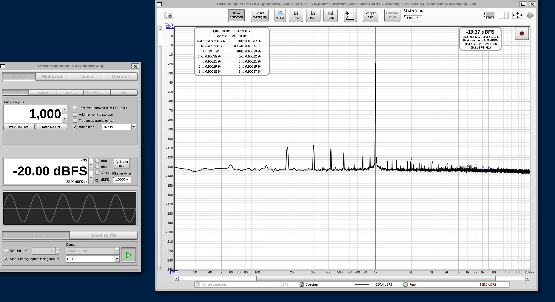

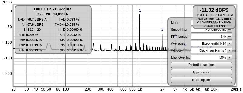

You're definitely right about the poor quality of the attachments (sorry 'bout that), so I've repeated the exercise. Here are screenshots, showing the relevant info. The BA3 preamp clearly has worse performance, certainly due to having a much simpler PSU. It was never intended for actual use, I just threw it together to see what would happen. Turned out to sound better than I expected. (And much better than it measures, IMHO.) I don't know what's going on with the hash around 6k - 7k. It's not audible in use.
I ran the same thing on the Iron Pre twice, changing the settings to either have the same input, or the same 0.707V on the output, due to different gain. I wasn't sure which was the fairer comparison, although in the end I don't think it matters much. The peaks at 180Hz, 300Hz... may be a result of my ignorance and misuse (malpractice?) in REW. But even with those limitations you can see how the BA3 has the H2 thing happening, and that the Iron Pre does not.
Next step is to find out whether the PSU in the Iron Pre is producing more junk than it should, or whether I'm doing something wrong in REW.

Joined 2008
just persevere with REW, reason is most likely there
I can't help, practically never had it installed
what you're getting with simple loop measurement - soundcard out directly to soundcard input?
Yes, although it's a Focusrite Solo, so it's supposed to be quite good for this sort of thing. xrk971 has threads discussing this stuff, and I've been trying to follow those.
