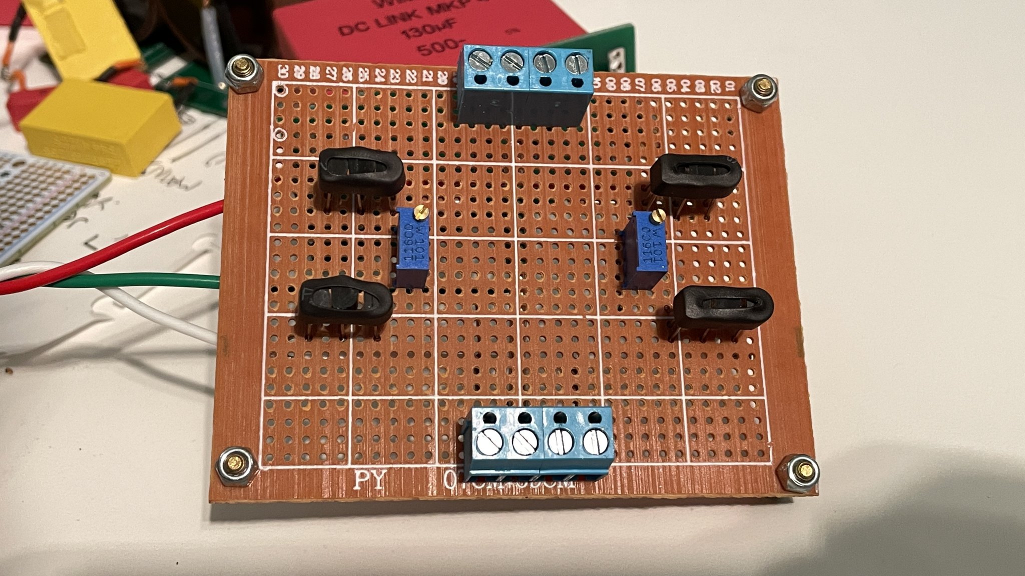

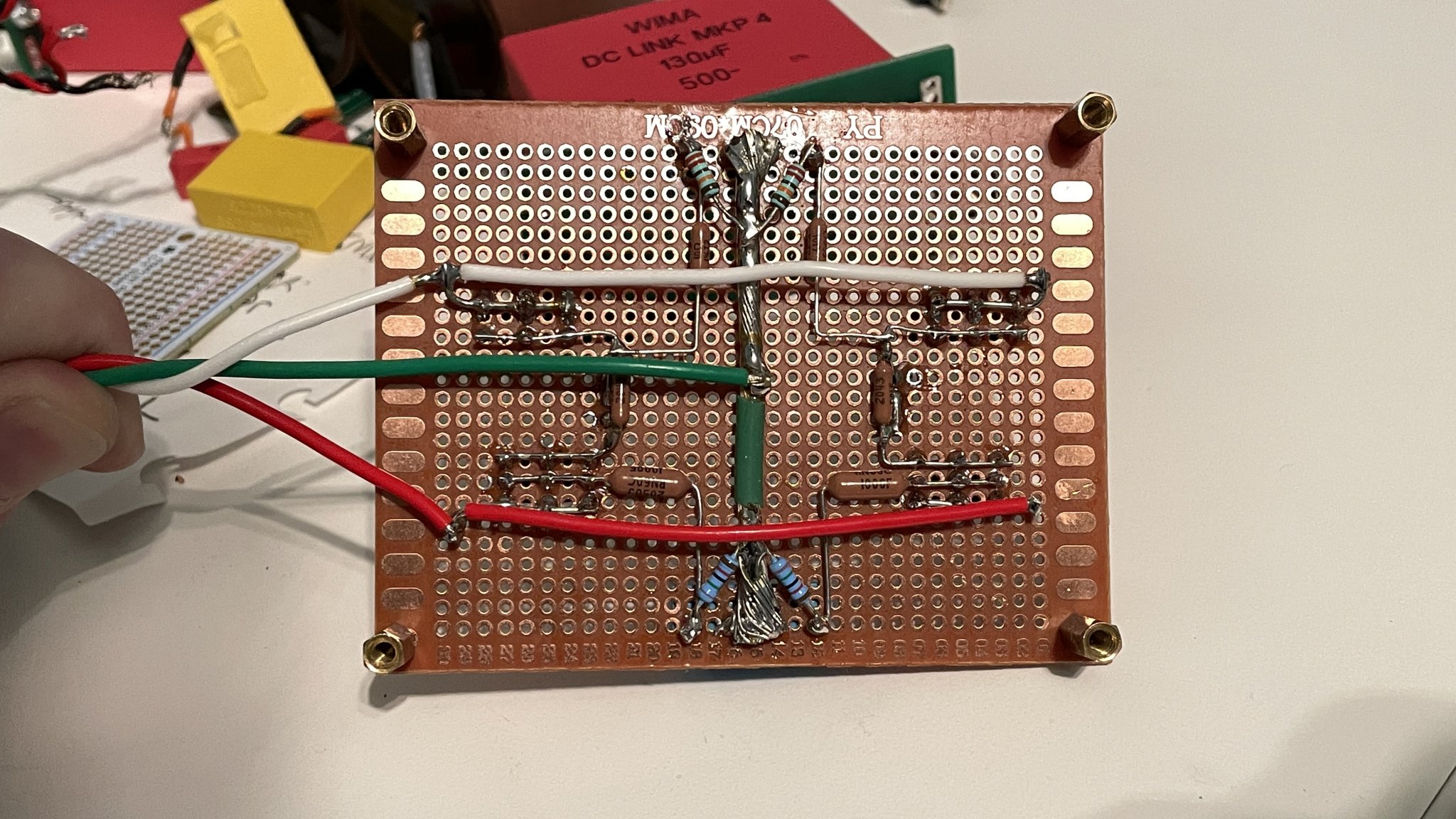

Finishing up a perfboard version of your Pumpkin-style buffer tonight. Hope to post success pics tmrw 🤞

Sounds great! Iq is just a touch below 20ma and using those 15v rails. Hope to measure some tmrw, but it sounds quiet and ‘sure-footed.’ That could easily be confirmation bias and the notion of using 3x the jfets, but I’m ok with that 🙂

you cheated ....... somehow I meant that you're going with 2SK2145Sounds great! Iq is just a touch below 20ma and using those 15v rails. Hope to measure some tmrw, but it sounds quiet and ‘sure-footed.’ That could easily be confirmation bias and the notion of using 3x the jfets, but I’m ok with that 🙂

this was for fun - 2145 version is next up, when parts arrive. 🙂you cheated ....... somehow I meant that you're going with 2SK2145![]()
