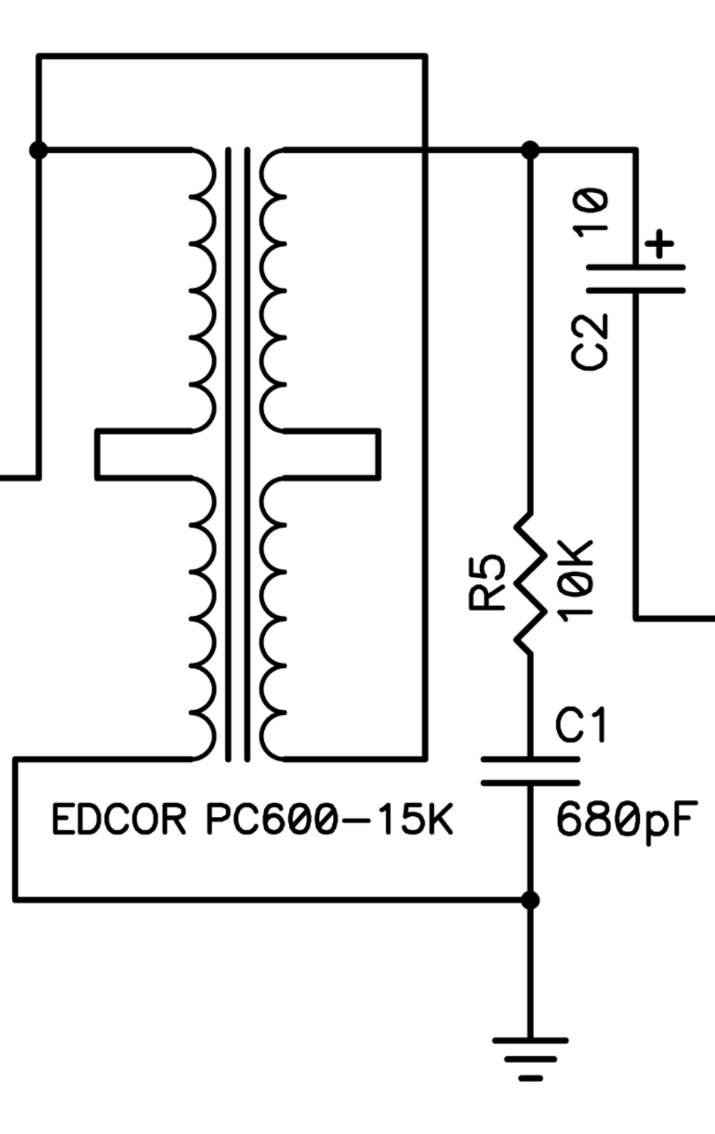

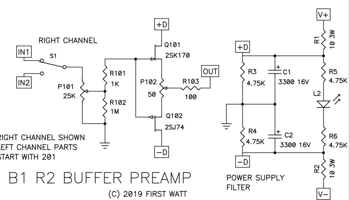

Ok ZM, I've got a pair of chassis mount 600:15K's arriving in a couple days. Thinking I'll try them after the AVC, perhaps putting them on switch. Attached is the M2 implementation. I believe the low-pass (10K>640pf) addresses some HF behavior intrinsic to the Edcor, so I should keep it. And I believe the 10uf cap is serving the M2 OS, and I can toss it.
That sound right to you?
RC - really depends of load afterwards, so you can freely try without
if you have zingywiggly showing device ( scope) you can play with little squares (having as shunt/load resistor same value as intended power amp Rin)
for a good measure , you can toss 100K as shunt on output and forgetabouta all zingywiggly headache
ps. be prepared for at least cultural shock, if not ruining of all HiEnd myths and fairy tales ..... what can illogically/uncommonly used 8$ piece do for your sound

same 3 xformers mentioned as central Note in any of my recent autoformer gain amps
anyway, to spare wakootalian of difficulties, here it is:
you're good for 6db or 12db that way, by your choice
exactly as shown in Iron Pre schematics

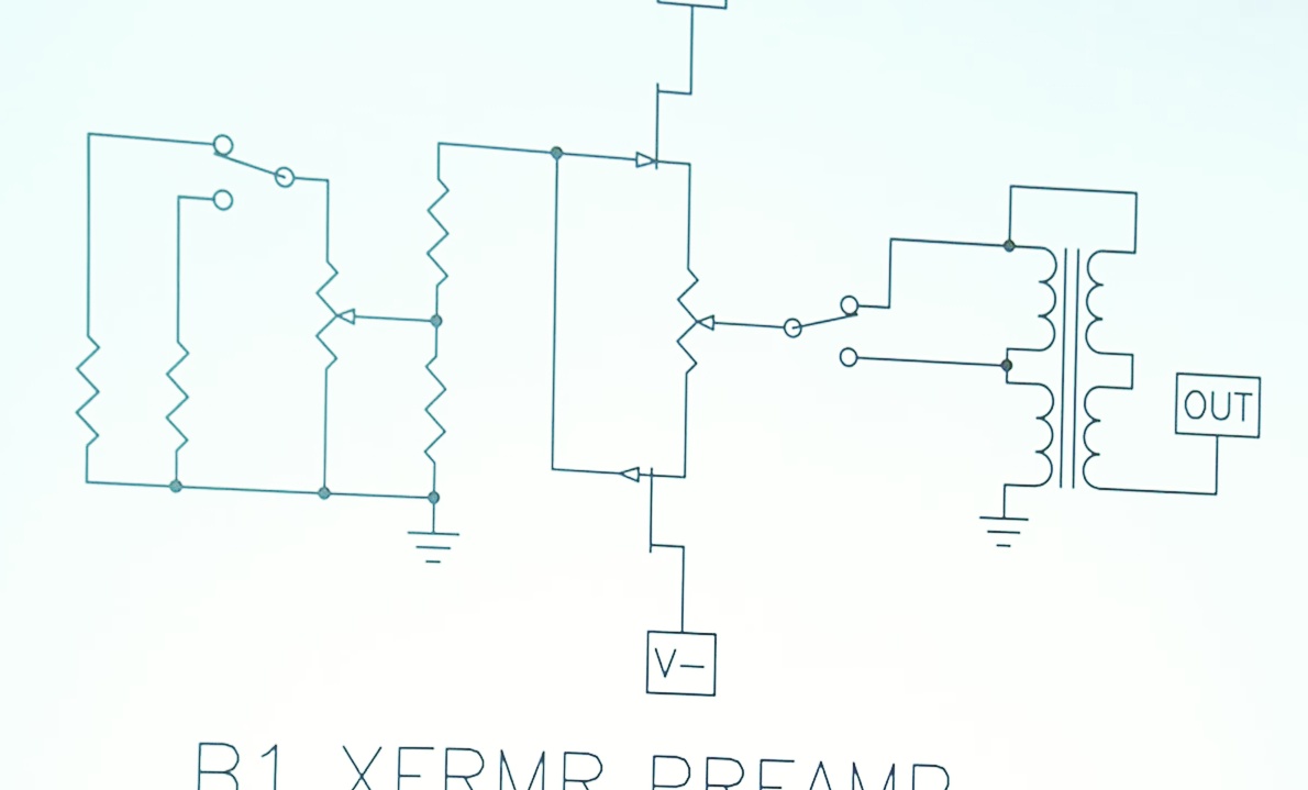

do not forget to zero R103 (in B1 schm you posted two posts above)
XFORMER
Edcor PC600:600 or
Jensen JT-123-FLPCH or
Cinemag CMOQ-4LPC or
Cinemag CMOQ-4HPC

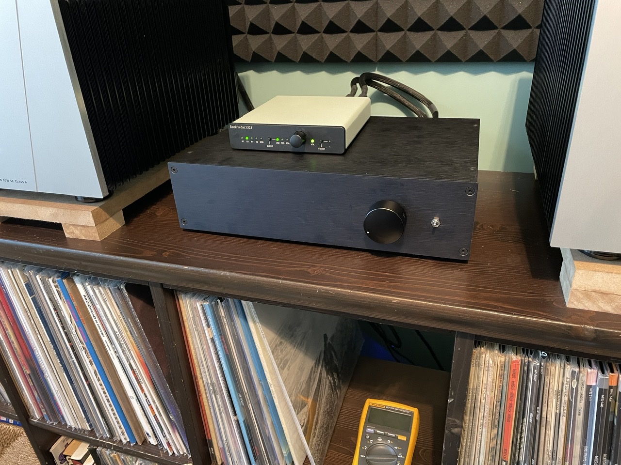

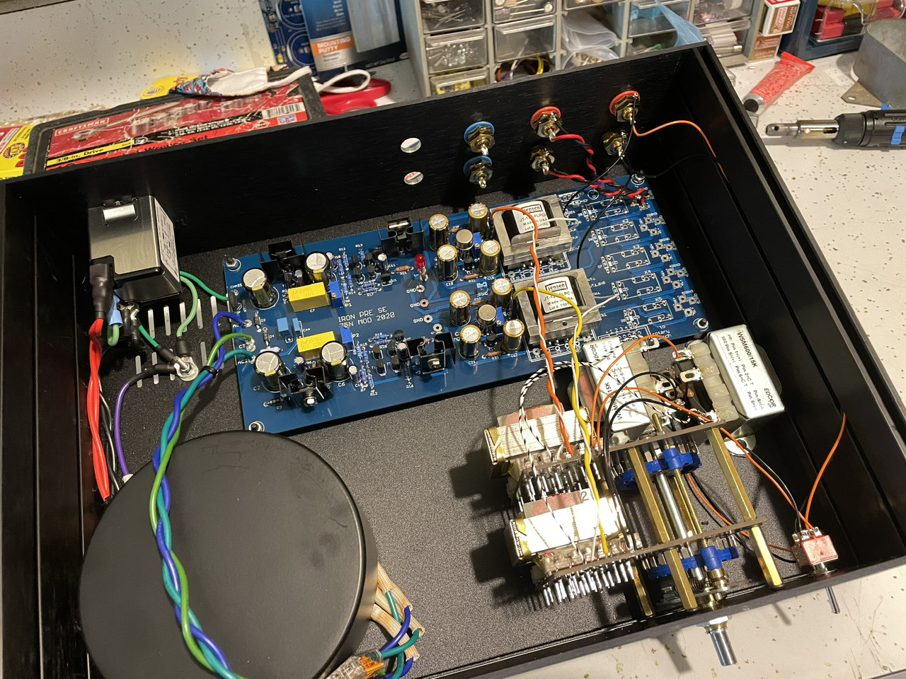

Once again I listened to ZM, and once again it has paid off. I picked up a pair of 600:15K edcors to put after the AVC in my Iron Pre. Works like a charm, and sounds fantastic!! Still need to permanently mount, but so far so good. The cherry on top is that I put them on a switch, so passive/no gain is down, and big iron gain (Edcor) is up.
I’m pretty sure I’ll never need another preamp. Thanks again ZM!!
