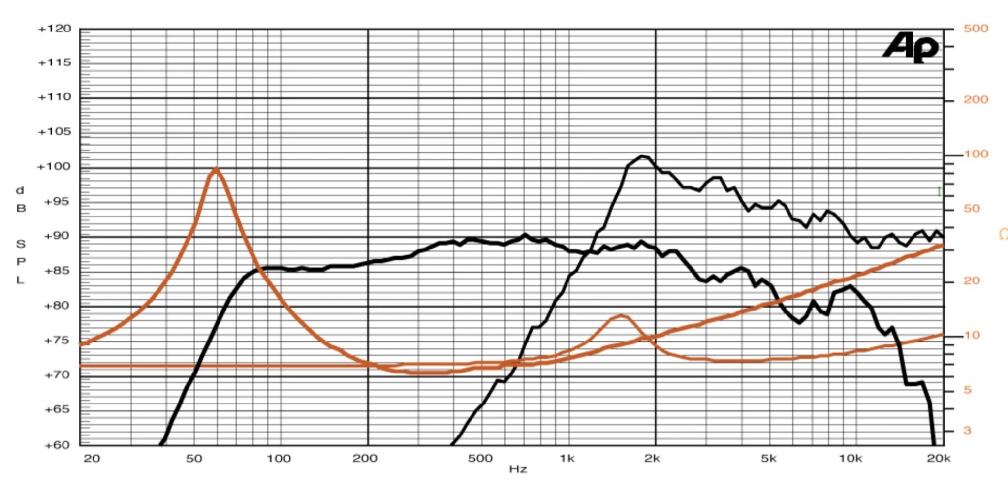

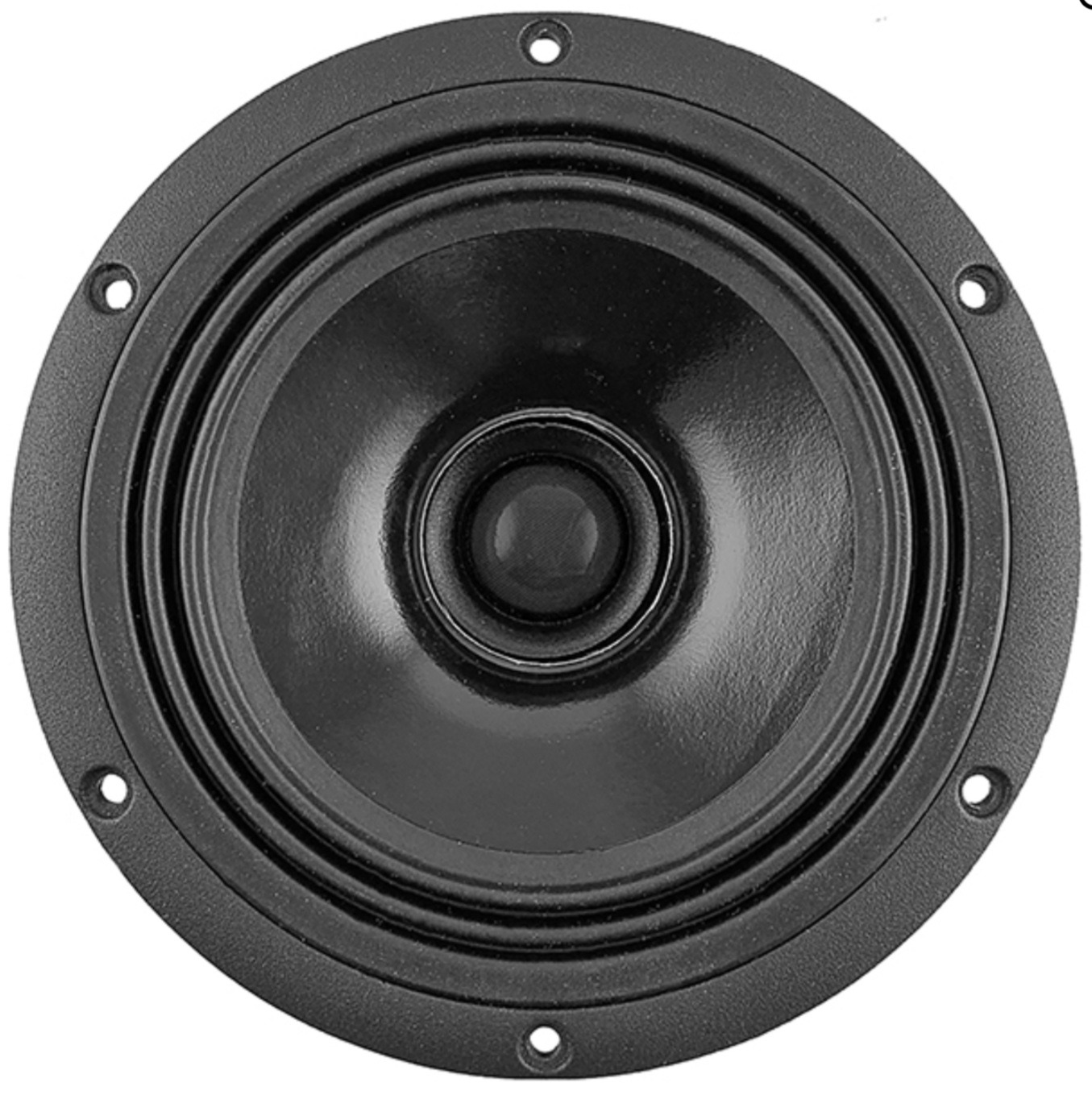

There's the Sica 5.5C1.5CP 5" coax and its very good. Take a look at the graph...
I built some small nearfields with these. Likely the best small hifi coax currently available.
