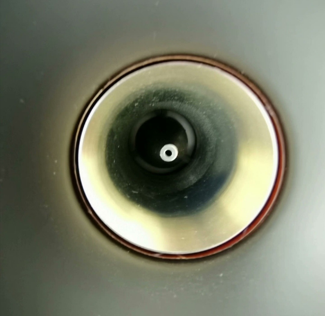

TS-D65F
This sounds sweeter on the sound board than any audition I have ever done in a shop. Car audio or Hi-fi. Cannot fault any part of any track and since the owner is a friend, I have spent a lot of time going through many tracks. I bought a pair that I have sine used in my car after only auditioning with 70s and 80s dub. Recently, have spent a few hours trying all sorts of track. I'll take them out of the car and AB against the Pheonix Golds if I decide to order them tonight

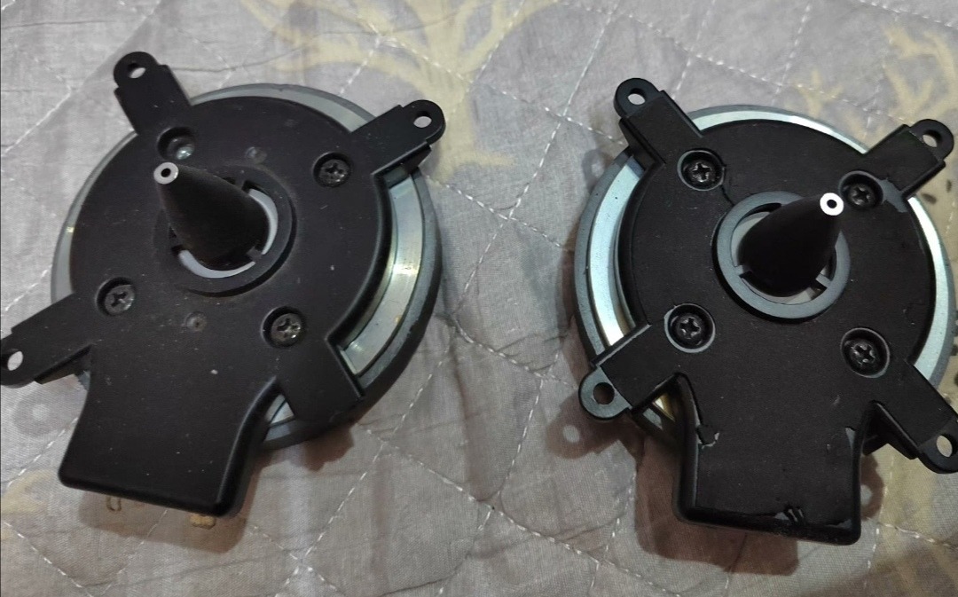

Lol, I put the drivers in the car just because of the stem thingy, thinking why aren't the $1k hi-fi drivers using a stem. Thank you @Patrick Bateman for setting the record straight on this feature
Bi-amping would mean that my amp modules inside the sub wouldn't be enough channels. I need two more for the tweeters. I have to take out the driver and see if the stock xover can be easily bypassed

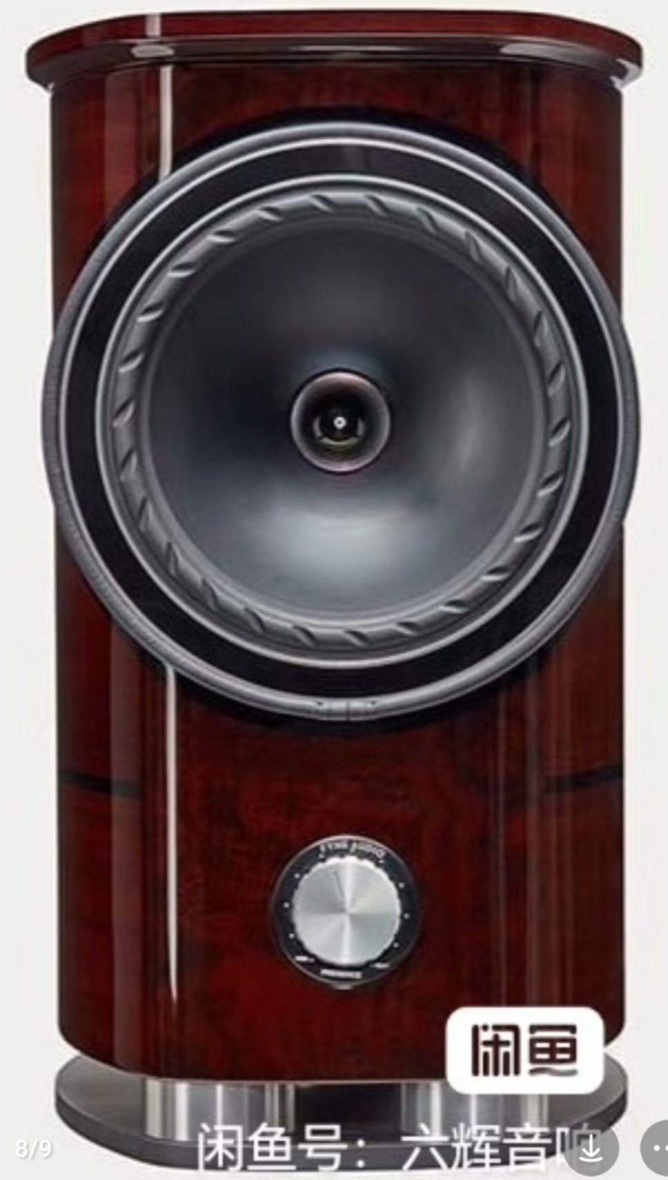

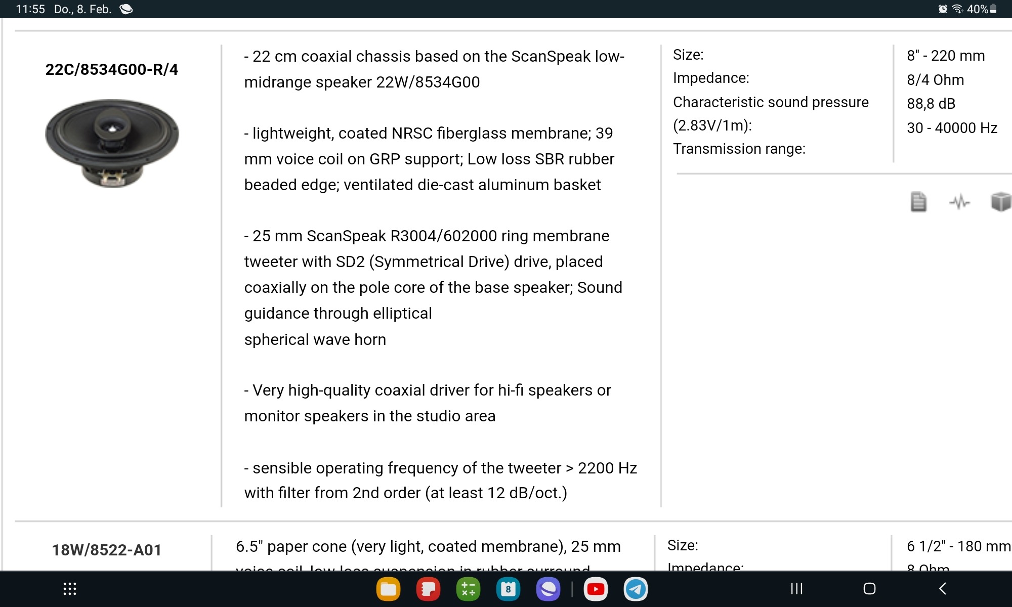

Fascinating thread. Well I'm just getting my toes wet with a set of Tannoy Precision 8 coax+woof ($270 scrounged from three places) and the 19mm Mg-dome compression tweeters from Fyne F1-5 ($70 due to a broken leg).
The P8 coax spec'ed 5ohm and 1.8khz 2nd-order LP, 1st-order HP; from a picture I quickly reverse-engineered & tweaked the XO and found only the coax bass a bit wanting, in my 17L TLonken (~42hz tapered MLTL). Per above recommendation, I ought to high-pass the coax and use the matching woofer for bass. Will try.
My plan for the odd-looking Fyne F1-5 compression needle-stalk is to fashion a tulip waveguide just from pictures (not likely to spend $5K to impress a mold!). Big gap indeed.

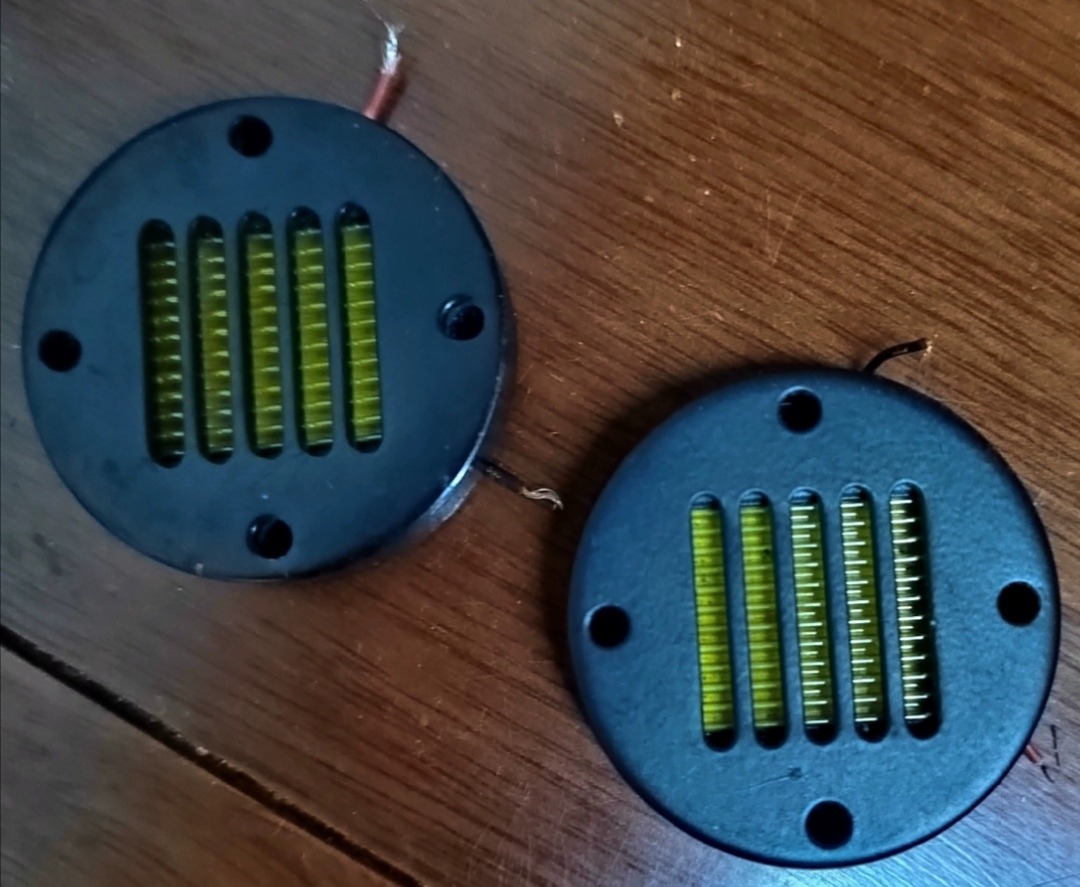

I wonder if the differing radiation patterns of using a planar tweeter or mid tweeter would be worth the effort. Or what about a 15” woofer with a small egg shape baffle in the middle supporting a 2” dome mid and a 19mm dome tweeter?

I might do these as 3-way active speakers, with the sub drivers in the same cab as built in stands, i.e. if the stock xover can be bypassed. The pioneer drivers sound sweet enough to warrant a lot of effort. Maybe I shouldn't drive this thread off-topic with my build
