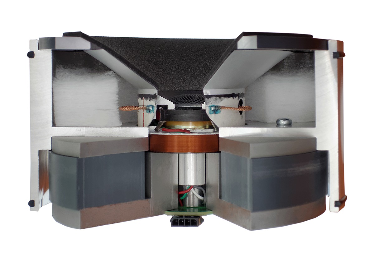

I posted this drawing in a previous post:
This is a real driver I am working on. It has hidden suspension for both the dome and the cone. The waveguide is extended by around 40mm by an additional trim ring. The dome is FEA optimized with a reinforcement and seems to perform really well. I am planning to BEM-simulate it as well. The goal is to get the 32mm dome to extend pretty low, and the midrange paper cone to extend very high while at the same time fit the dome dispersion really well. The domes dispersion is further improved by its extension outside the coil, making it load the waveguide better. The two share a very powerful radial motor so efficiency is likely to be very high.
I feel that I have adressed the important issues with this design, but maybe I have overlooked something?
The midrange design is based on my article in this issue of AudioXpress:
It's jumping out to me, what you may have missed

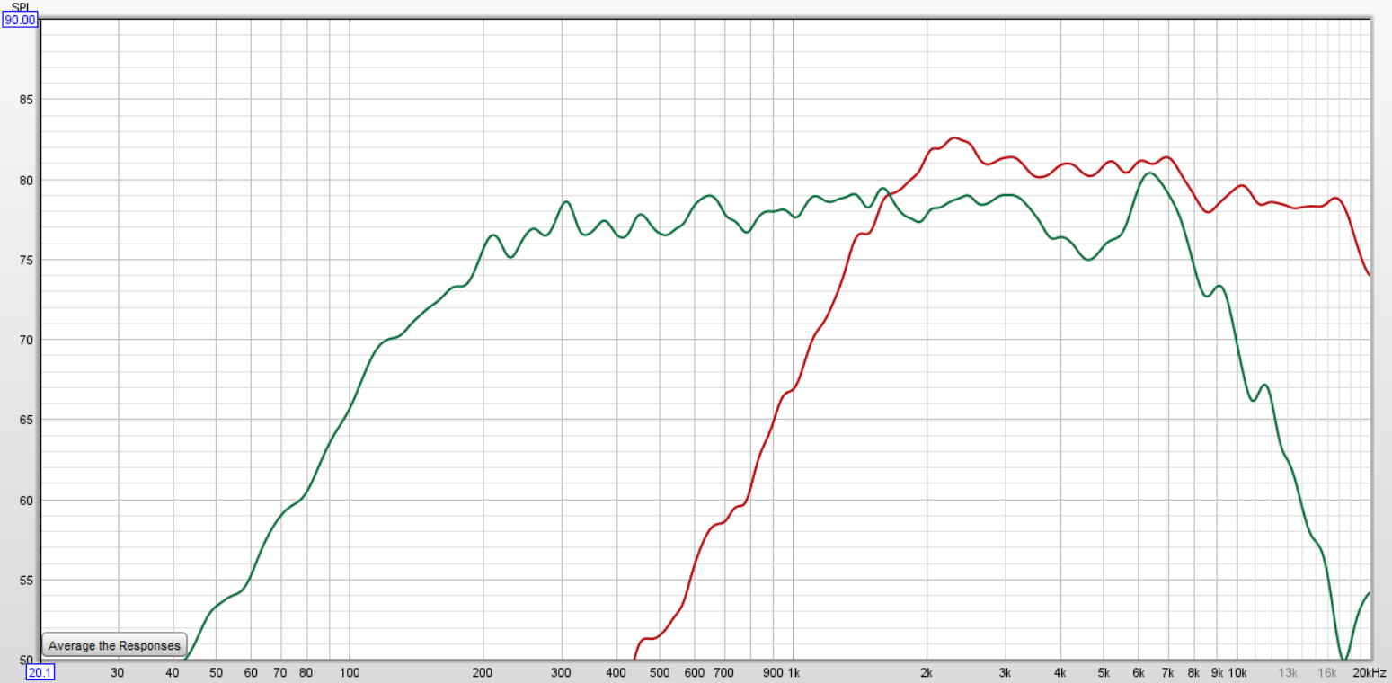

...what is the point of expensive coaxials with ragged response?...​
...OK many woofers in this life are not so smooth on top.These tweeters though are ragged, some with huge response holes, and dying above 10k or even less. I'm sure folks are using these and saying they sound lovely blah blah...but who would ever buy loose tweeters measuring like this?!?
What am I missing?
What am I missing?
You are missing that people are sitting in the far field for listening and there on and off axis sound summ together. And - these drivers behave off axis!
What you on axis are strong chancellations like reflections from the surround or some corners in the design. Off axis these are not present.

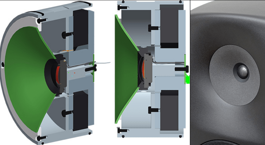

There are only 2 companies at the moment who perfected the Coax design - KEF with their newer drivers and Genelec with the One's. Both not available for DIY.
As I really like Coax speakers I did some experiments and listened to some DIY Coax systems - they are not made for on axis near field monitoring, you hear the problems in this situation. But in the room, 2-3m distance it works well.
It still bugs me that no manufacturer has figured it out to do a coax similar to KEF ...
First of all: this must be about the 3e or so thread on coaxials.
And then -big sigh- how hard can it be for manufacturers to do it right for once?
I am completely with IamJF here: I said more or less the same thing in one of the other coax threads.

I've come across a lot of those while searching for coaxial drivers before. I don't know why they bother. Sure, you still get the advantage of nearly co-incident acoustic centres, but that doesn't seem like a worthwhile trade.
Aside from the much more expensive pro coaxials using compression drivers, there are a few of the type with dome tweeters that measure much better. For instance the Omnes Audio CX 3.1, which I measured as per the attachment. Aside from the nasty resonance from the cone at 6.5kHz, the response is fairly regular.
