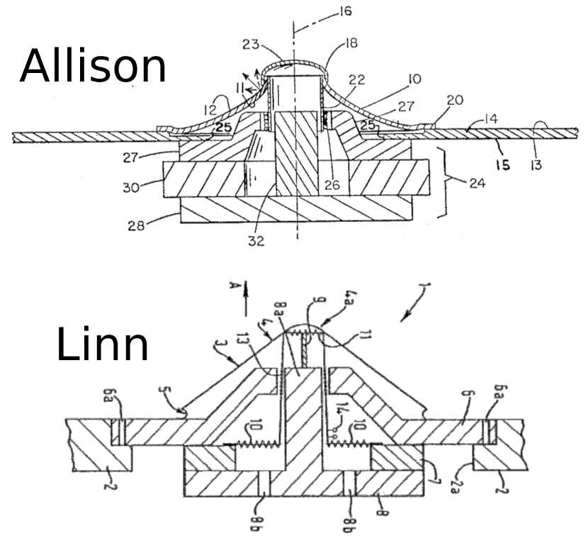

FWIW, there are a few large VC midbass drivers which could support a decent HF driver right on top of the pole piece. It would allow for a very close time alignment and optimizing the junction between cone and HF edges. The gap here is what causes alot of issues, especially if there's a substantial air pocket trapped there.
In the case of larger pro audio drivers, there are plenty of 12s and 15s with 2.5" - 3" VCs. This would allow for placement of a high sensitivity 35mm neo HF dome. The Seas T35C002 comes to mind. It would fit in a 3" VC pole piece cavity and could be crossed fairly low.

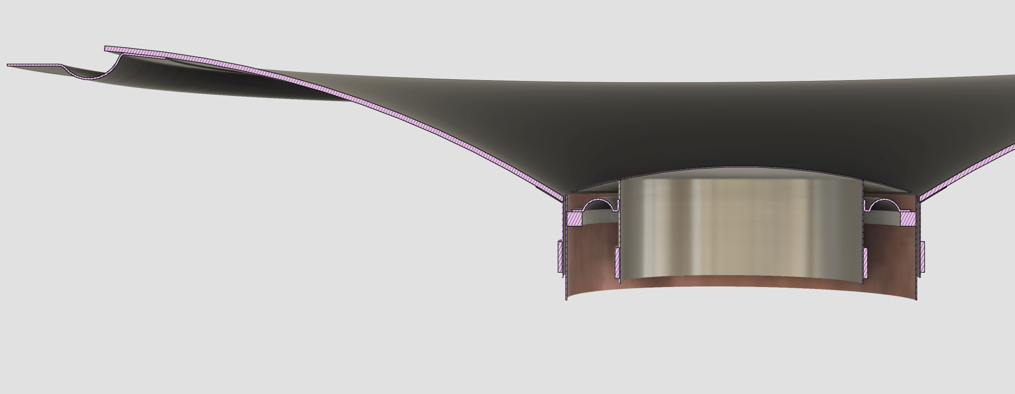

@Snickers-is I agree. There are however ways around this using a smaller surround at the HF.
I remove dust caps on drivers all thr time. I usually use phase plugs for this, but even Audax did ok with their HM100Z0 mid, which had a flat, exposed pole piece instead of a dust cap. Removing that air space under the DC fixes some resonance issue as well. Dustcaps themselves cause lots of issues.
On the design I previously showed, the tweeter surround is behind the dome, so the edge of the dome is very close to the mid diaphragm.

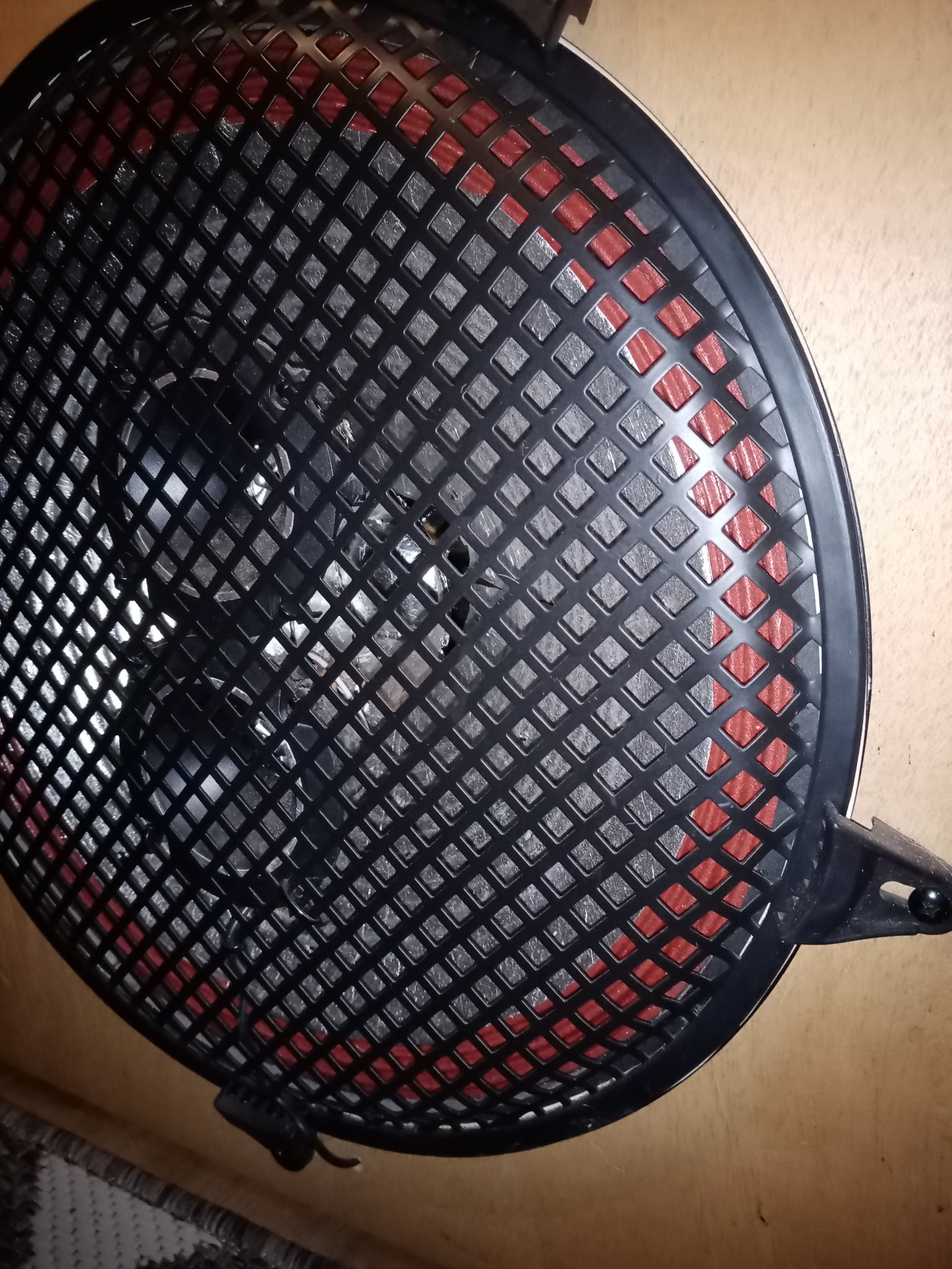

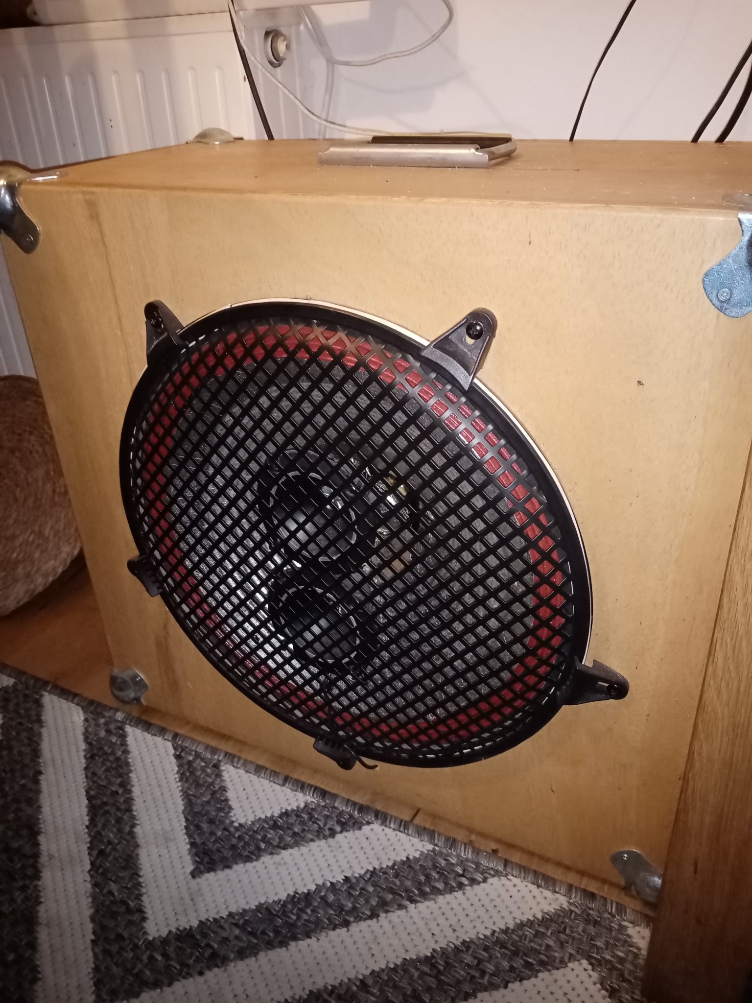

You can mount a tweeter before the driver. Doing so it was clearly audible that time coherence is better than being "far away" (=classically above the driver).
Frequency response could be flatter than in rear mounted coaxial. (but not with the shown box, never measured it).
Here a fullrange driver I built with two piezo tweeters put before the cone.
Tweeters and driver paper cone with diy aluminium foil on it.
