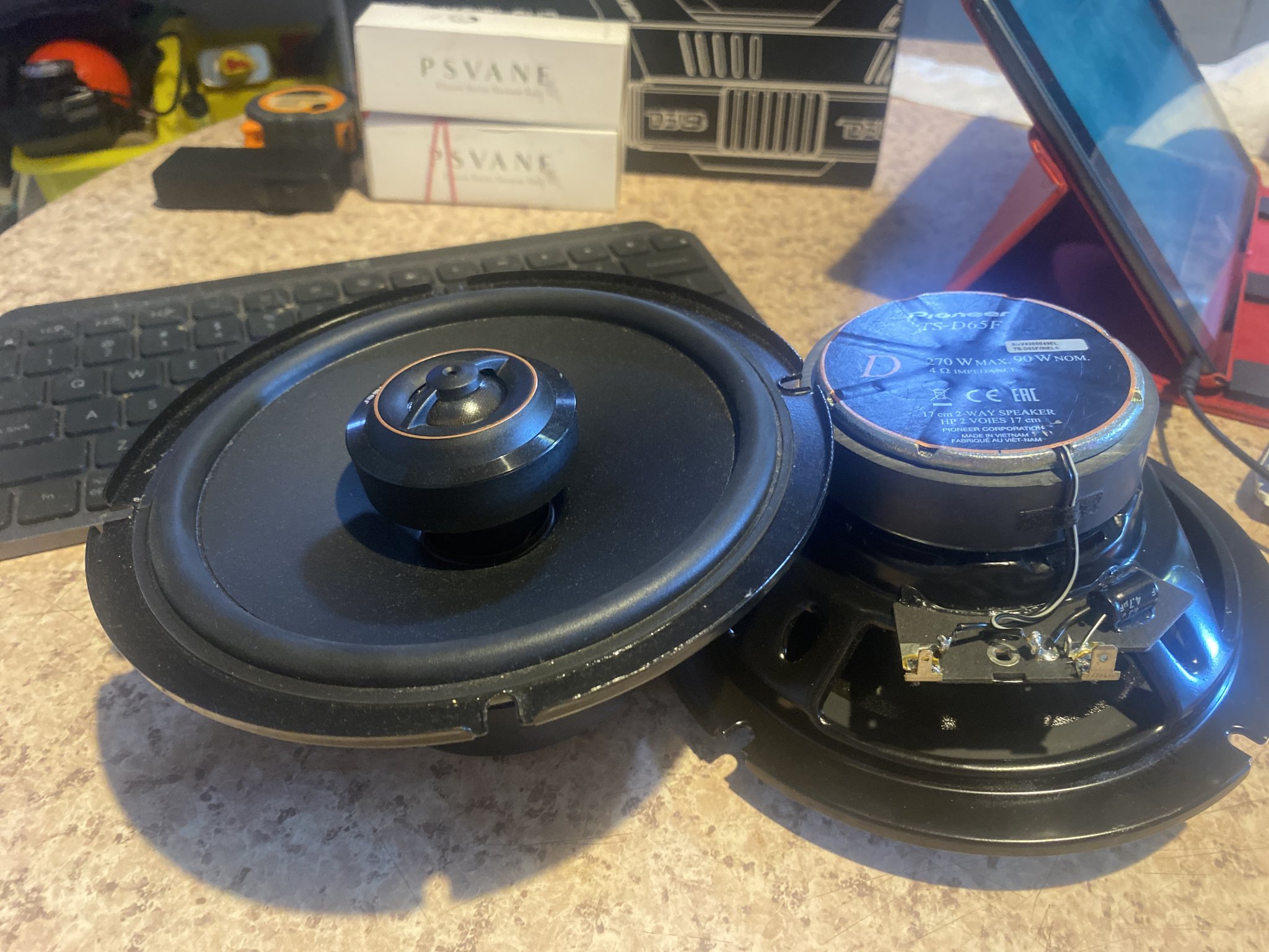

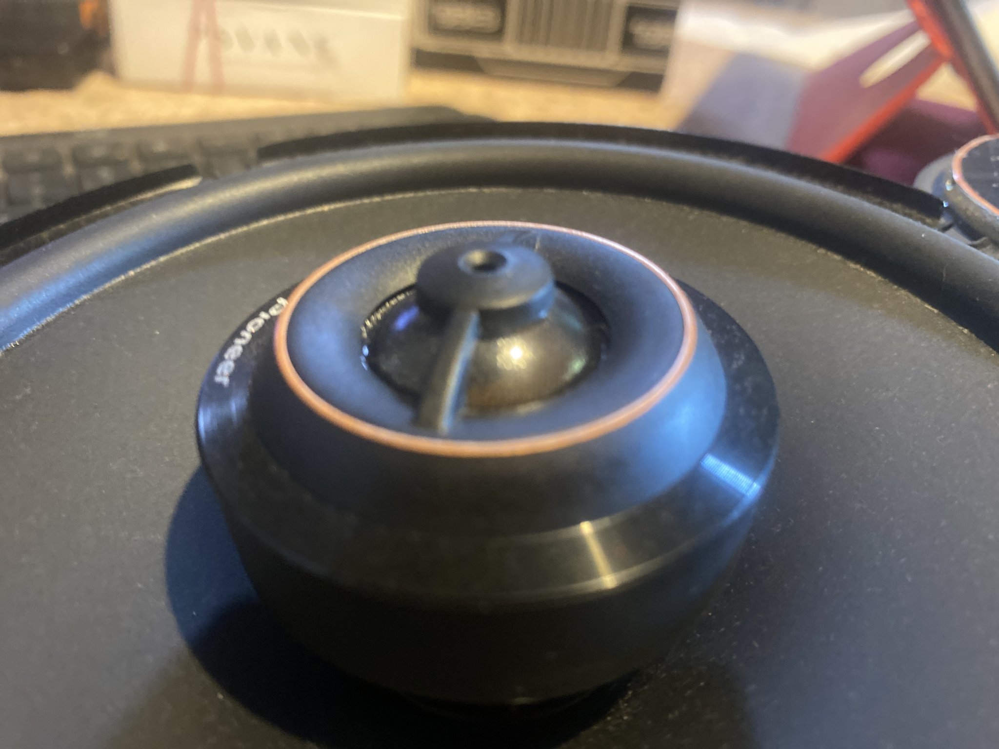

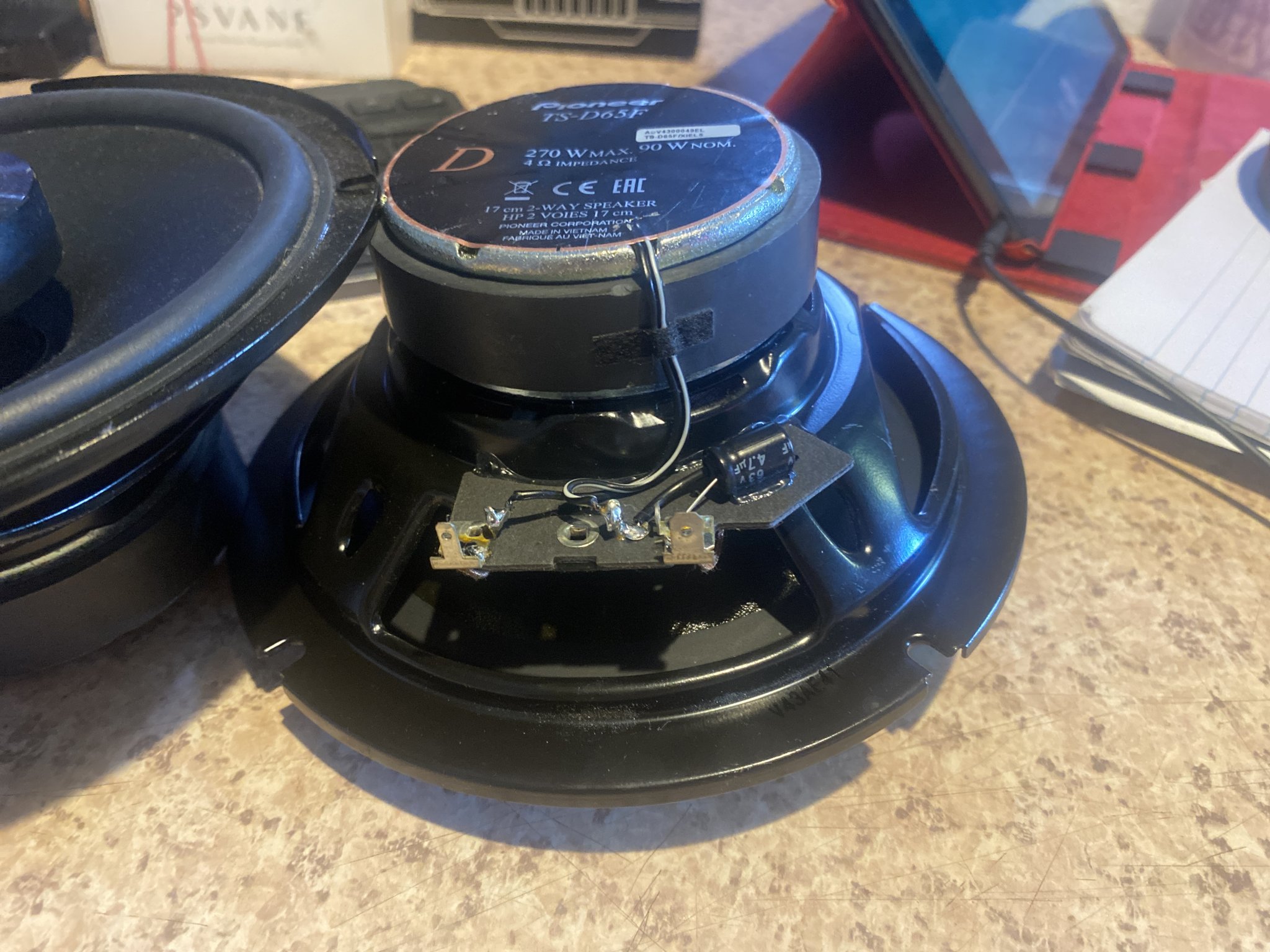

Cleaned up the Pioneers. Check out how they have the cone shape, stem and tweeter. It sticks out forward of the roll surround. The terminal strip is very accessible, and the capacitor can be removed for biamping for electronic time alignment. I'll use that option
@perrymarshall Thats quite the achievement you made with that OB design. I'm pretty certain it took you a great deal of time and patience to get the performance of these to the level they're at now. If it didn't necessitate so much DSP, I'd be all over that setup. Im just not in the position to dedicate that much energy to getting something of that nature to the point I could leave it alone and be happy with it. I just prefer analog filters and most of these pro coax drivers can't be made to perform that well with the exclusive use of analog, passive xovers.

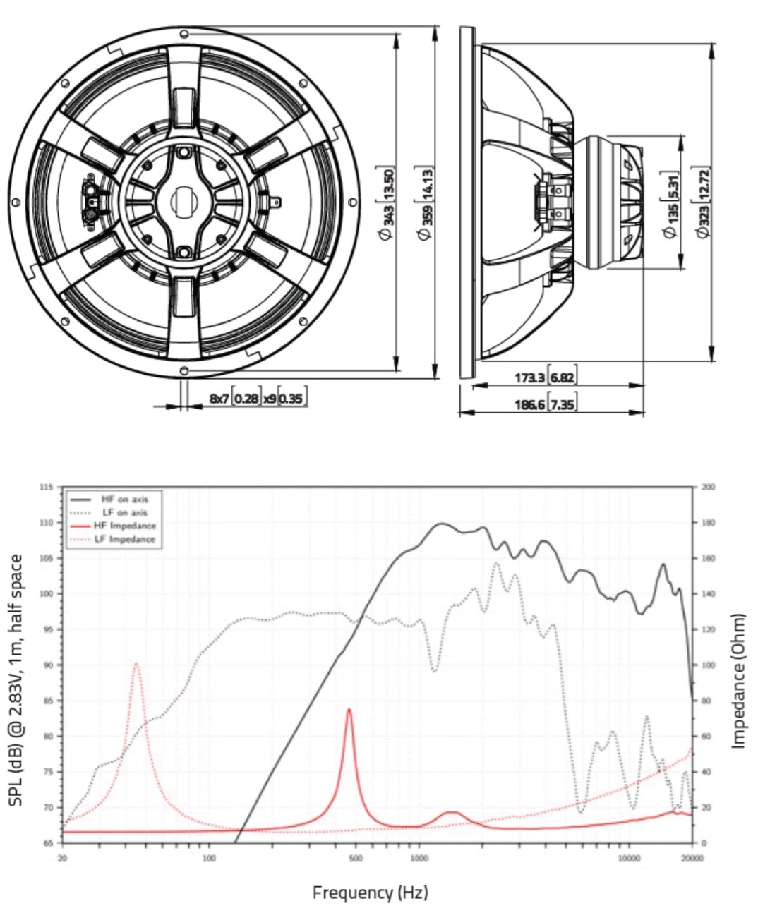

Another driver I found the other day that looks like a good candidate ("not ragged") is the 13.5" Lavoce CAN143.00T.

@perrymarshall You'd have to cross the LF pretty low to make that one work. The sharp dip just above 1k makes that one difficult IMO.

The HF section can be crossed as low as 800 (based on its impedance curve) so even a traditional passive crossover looks promising for this.@perrymarshall You'd have to cross the LF pretty low to make that one work. The sharp dip just above 1k makes that one difficult IMO.
