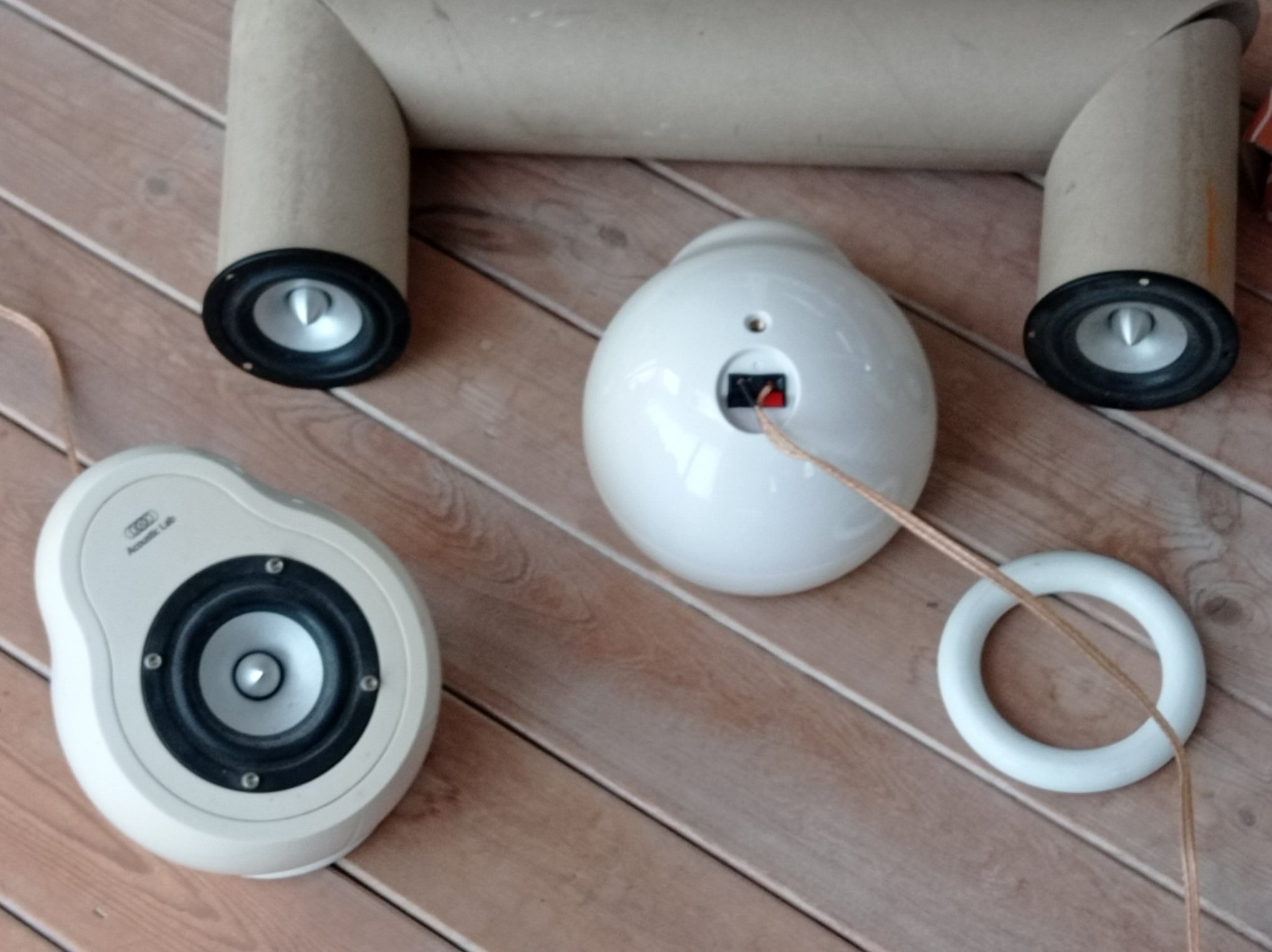

But coming back to this, taking long looks at the pic that I post of the Pioneers with the stem and the coincident type drivers in the OP
Should I take note that the sound of from the woofer comes from the apex at the pole rather than the whole surface of the woofer cone including the leading edges and surround? Is this what makes the Pioneer's physical alignment incorrect over the correct ones in the high-end drivers and the Phoenix Gold?
@randy Top of picture is what I will fix on top of speedometer in my car. Crossed to Door speakers as "sub"woofers.

That is @#$#@@$% awesome! I can't believe that never occurred to me. I am sure there are drivers in that bunch of all sorts of FR units that I got in to eval for my tube portable. Please dont mind if I fit something like that to my car. Genius!
