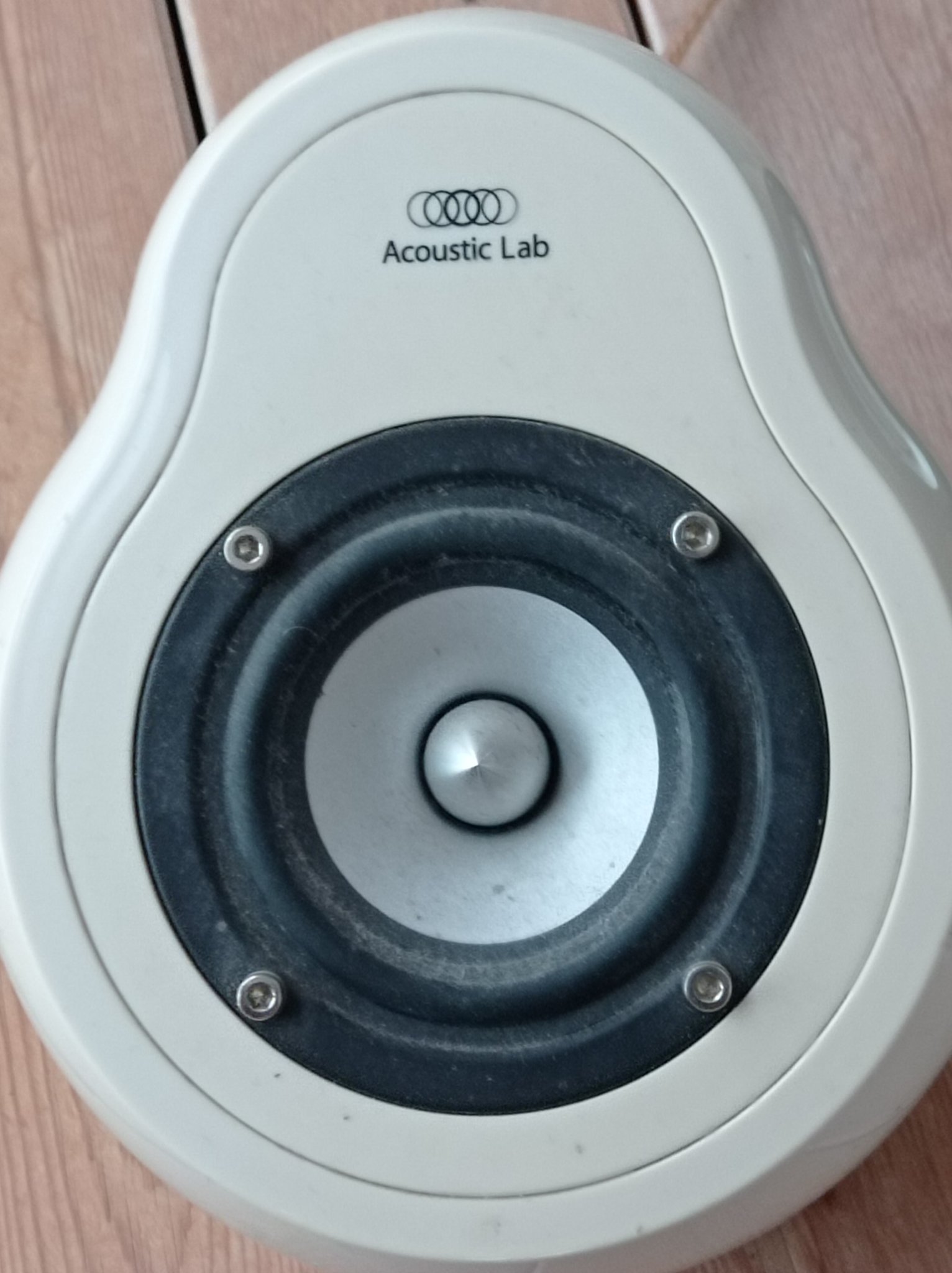

@Randy Bassinga I dont know if one of my experiences explains a bit.
I have this speaker I showed you
They are old and were praised as the best computer monitors you could get at that time when such were mostly crap. They cost 4-500 dollars with a lm38xx based amp included, which was Hi-End prizing then I got them for 70 dollars cause a court seized the OEMs whole stock for selling them as illegal "copies" They do sound awesome. They are not neutral, but colors all music a bit to sound better than what's recorded. I found out that their drivers were Tang Band W3-871SC. Got two of those and made holes right under my sidewindows in my car. I was very happy about the sound, but one day my friend with "golden ears" heard them and complained about the highs. I protested but the he just put his flat palm at the right angle directing top end to my ears. -Dramatic improvement!! The problem was that that with this placement we were listening off-axis. Could have made a flange to angle them I guess, but I've shown you in other thread my attempt of a solution for Sweet Sweet Stereo Music at the wheel 😄 Cheers!
That looks a lot like the unit in the Logitech THX systems like mine. Here is the thing, Logitech fits them from the back of the baffle and the baffle forms a shallow waveguide type unit around the driver
I just tried the palm and ear trick. It does make a lil difference in lifting the highs, but I do have very sticking out elephant ears. The stereo speakers are 1m apart and about 1.2m in front of my position
Phase plugs yes. They also stop reflections from one side of the membrane to the other. Those reflections cause peaks in frequency response sometimes quite nasty.
