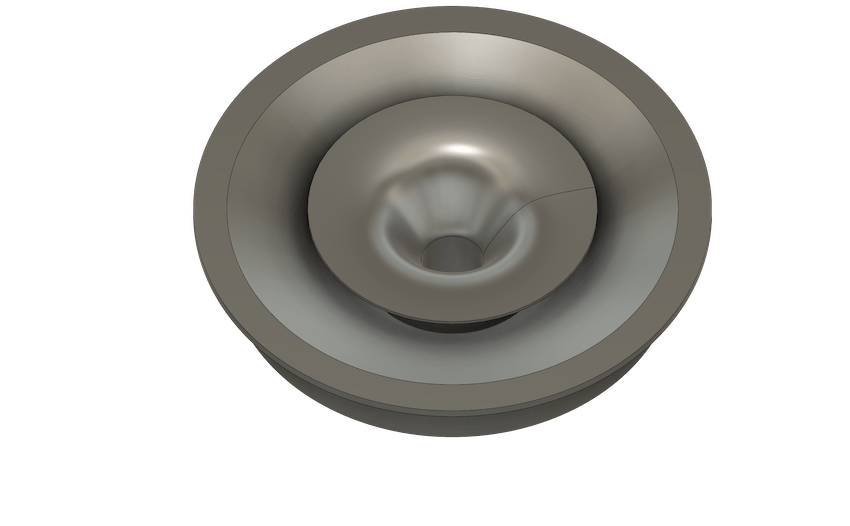

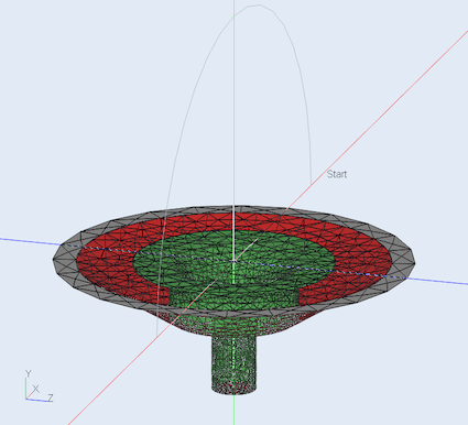

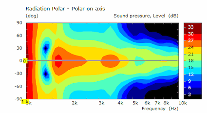

As I evaluated the Beyma 12cxa400-coax driver for a omni-directional project in the German DIY-hifi-forum, some simulation results on the topic.
Simulations have been made seperately for the bass-midrange driver and HF-driver/horn combinations to see, how they effect each other, i.e. (i) how does placement of the horn o fromt of the conus-membrane effect its frequency response and radiation pattern and (ii) what happens to the HF frequency response and radiation pattern when working in front of the conus membrane.
Simulations have been done in an infinite baffle - so no impact of a baffle or enclosure at that point.
The 12cxa400 geometry simulated:

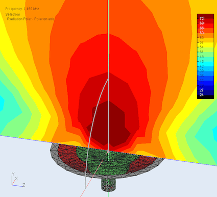

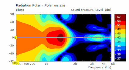

The respective directivity plot on axis (to the top):

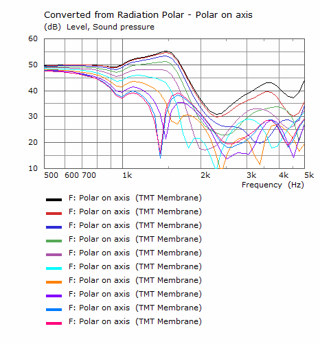

And frequency responses from 0° to 90°, 10°-steps:
This pretty much fits to the measurements of the Beyma published by Vance Dickason here, i.e. rising FR up to around 1.5kHz and a dip at around 2kHz shiting to lower frequencies with higher angles (note that measurements stop at 60° = orange line here). This dip is caused by the horn on front of the membrane. Beyma recommend crossover at 1.5kHz in their datasheet, which seem reaonable to me.

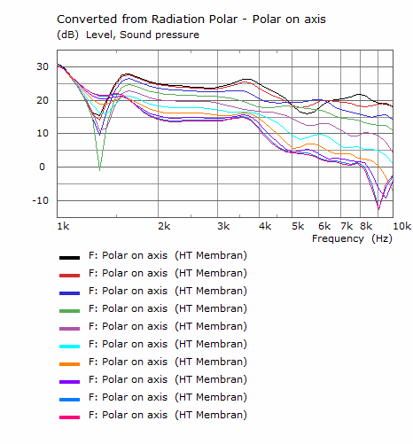

What about the HF?
DIrectivity:
Frequency resonses at 0° to 90°, 10°-steps:
Pretty much ok >1.5kHz. The dip just below 1.5kHz is caused by the round termination of the horn-mouth not mounted in a baffle (see Patricks comment to place tweeters in bridges in front of the woofer, i.e. add a small tweeter baffle).
Obviously Beyma hit the sweet spot keeping effects of HF-Horn placement in front of the woofer-midrange just over 1.5kHz and the HF-dip caused by the horn-termination just below 1.5kHz enabling crossover at 1.5kHz with minor effect of both issues on the overall charactersitics of this coax.

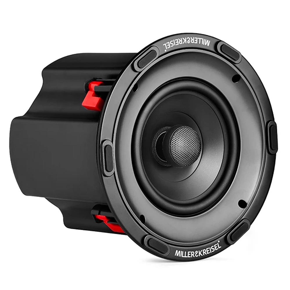

Any views on these type of designs. I've not been able to locate response charts but they sound good. I was thinking of replacing the back cans with wooden boxes in order to decrease the depth to between 4" and 6", the former depth size would be great. They are mainly designed for heights in a home theatre but I think they would work well for mains and surrounds too. Any input, suggestions and help will be appreciated.
I had started a thread on this here but found this thread after that.
https://www.diyaudio.com/community/...ack-can-to-wooden-box-with-less-depth.417045/
