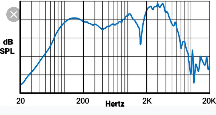

One of the topics that comes to mind in your basic question here is this: are all of those dips in response due to minimum phase driver properties, or are there internal reflections that are causing it? I'm used to EQing all drivers in my setup, and the entire setup is horn-loaded, so non-flat amplitude response (SPL) isn't a big deal (but ragged response is a big deal--if it can't be smoothed easily with DSP).
One of the most eye-opening experiences that I can remember was when another person that I know was building his own bass bin, and he asked the resident expert (a lead engineer for a large U.S. loudspeaker manufacturer) about a certain woofer that looked good in its specifications, but had a very uneven on-axis amplitude response (and if you've noticed--driver manufacturers don't post their phase response to understand what their driver's full transfer function response looks like).
What the engineer said next caused me to completely change my paradigm on driver manufacturers: he mentioned that the dip in response could likely be a cancellation of the backwave of the cone with its own spider(...!...).
Now, what manufacturer would put out a driver that cancels its own output, and can't really be EQed back to flat response? (You'd be surprised in this case--but I will decline reveal just who it was.)
So one of the things that I'd recommend looking at is a plot of the driver's output on-axis (at least, and off-axis, too if you can do it) of its group delay, specifically its excess group delay. Any non-flat, non smooth areas of this curve will tell you that those are regions of internal reflections that cannot be fixed.
So if you see ragged response in a coaxial driver (especially at the prices they command), first think about whether or not those dips in response are caused by hardware that's providing internal reflections that cause either complete cancellations, partial cancellations, cone modes to be kicked into gear, or just higher order modes (in horn-loaded HF portions of the driver). Those make the driver DOA for hi-fi applications.

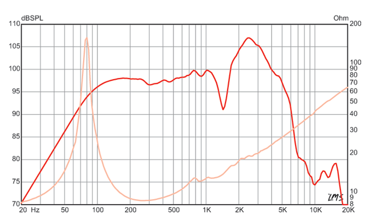

It'a actually a very common thing, and no, it can not be EQ'd back.
Most modern woofer cones are thick and made out of a relatively "loose/"spongy" paste, which overdamps any radially moving wave, meaning voice coil (he mentioned "spider" 🙄) to edge and back.
Edges are also soft which again minimizes "bounce back".
But modern guitar speaker cones are still made the old way: thin stiff cones, steam dried under high pressure in metallic dies, hard undamped edges, so much so that "undoped" is a feature, go figure, and they much show that strong backwave out of phase cancellation.
In 12" speakers, always around 1500 Hz or so.
It is a transversal wave, think shaking a taut string or wire, or waves on a lake after you throw a pebble.
Out of phase cancellation is so strong and perfect as to beat any EQ attempt.
Here's a typical guitar speaker curve, all of them show that same strong and narrow ~1500Hz notch.
Doping lowers it because it lowers reflection.
Different brands, very different speakers, and yet .....
So your Engineer comment was right, that particular woofer must have been built similar to these.

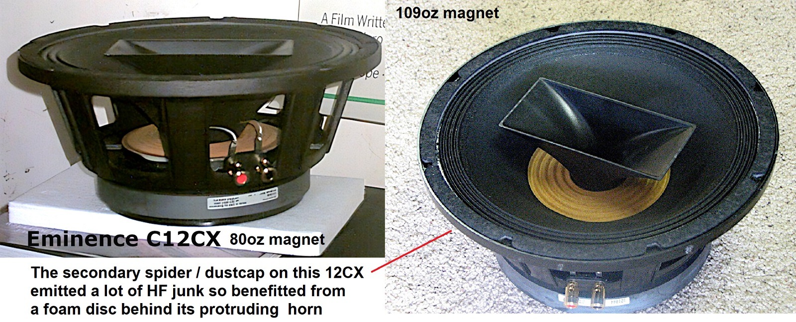

I still love the things - my lone 604B/E and various cast frame Eminence CX in 12" and 15" sizes. Another problem
I saw with my Eminence was that they had a spider dustcap which acted as a crude tweeter so a felt or foam disc
laying basically against that spider took out a lot of garbage. The cast frame Eminence coax were produced with 54-109oz ferrite magnet slugs. Some had no protruding horn - many had a rectangular horn very much like the little front horn in the ancient E-V CDP ("Compound Diffraction Projector". I got one to snap into better focus with an LCLC allpass on the woofer - but could have been something else going on.

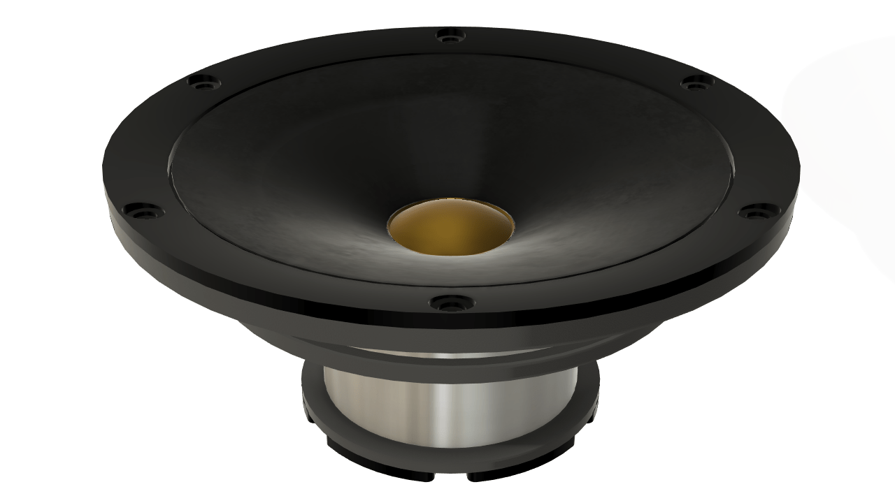

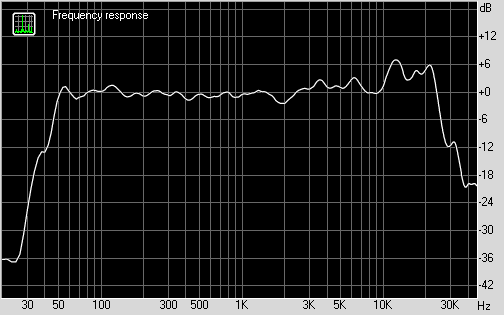

I think there are several things to consider here. A coaxial driver has some benefits that other configurations can not match, but it also comes with a set of challenges, at least if maximum fidelity is what we are after. But to dive a bit into the problem highlighted here, there are some things that could also be improved.
Two very obvious aspects about the integration of a tweeter in a coax is the interface between the tweeter dome and the midrange cone, and between the midrange cone and the cabinet. Interestingly, the OP contains links to two drivers from the same manufacturer. Most of the parts on the two tweeters are very similar to each other. One is a soft dome and the other is some kind of an aluminium/magnesium alloy dome. But if we look closely, the black plastic ring that is glued on top of the outer edge of the dome surround, one is tall (C16) and the other one (C18) is not as tall. The C18 also has a narrow inverted surround while the C16 has a fat positive roll surround.
If we take a close look at the frequency response of both, we will see that both have some rough edges, but especially the C18 cleans up really well once you listen slightly off axis. If you can disregard the on axis response, it is really not rugged at all. The C16 does not clean up as well, and it is likely partly to the higher plastic ring, and the fat suspension. I expect to see the effects of the plastic ring at higher frequencies (6-7kHz and up) and the surround closer to 2-2,5kHz.
At the same time we know of more things that can be issues in a driver like this. Firstly, a hard cone with high speed of sound tends to flatten the wavefront coming out of the driver, reducing dispersion at high frequencies leading to more beaming. A dome made from a similar material will do the oposite, the wavefront will propagate faster to the middle, while a softer, therefore slower dome, will flatten the response. Flattening the response is really not a great idea for any waveguide or coaxial mounted tweeter as they tend not to integrate as well with the waveguide. In general metal domes do have mor air and details as the high end dispersion is more similar to the low end dispersion when mounted in a waveguide. Therefore, a metal dome will allways be the better option in a coaxial driver, unless it is broken or badly designed, or badly integrated (aka sounds "metallic"). To mimic the dispersion pattern while crossing over to the midrange, the mid cone should be of a softer material, like paper. This will slow down the propagation to the edge of the cone, making the wave front more spherical.
Secondly, for maximum sound quality, a coaxial driver should never be made to play any kind of bass. If it moves past maybe 0,5mm, it should be so loud that distortion is becoming hard to hear. Typically, a 6,5 inch coaxial should not be used below say 250Hz without significant asistance. This also paves way for some different strategies when it comes to suspension.
Because making the interfacing between the cones and the surrounding parts is important. When manufacturers do the common thing, taking a woofer, and adding a tweeter to it, then nothing was really made to work well as a coaxial driver to begin with. If we look at the dispersion of the midrange at the cross over point, it depends on the size, shape, material and the position of the voice coil. The voice coil is normally centered, but often larger than ideal. A 39mm voice coil is common with a 26mm dome. This leaves a significant gap that does not produce sound. The angle and profile of the cone really determines how effective it is as a waveguide, but also its own natural dispersion.
As a rule of thumb, to match the dispersion of the dome and the cone, you will need a waveguide that is slightly larger than the cone it is set to match, and there are two reasons for this. One is that the cone shape will beam a bit more, leading to it having less dispersion than the dome using it as a waveguide. The second part is that there is a relationship between the penetration of the cone that makes space for the tweeter, and how far up i frequency the midrange cone will perform well. Looking at coaxials we rarely see any significant overlap like we typically see on midranges and domes in general.
The last thing I would like to point out is that you do not often see a coaxial driver where the midrange cone is actually both optimized as a cone for a midrange driver, and as a waveguide for the tweeter at the same time. The coaxials are typically what we see as a combination of a generic mini tweeter put in the middle of a woofer. And if the woofer is changed to be a midrange, we only rarely see any changes to the surround and cone profile.

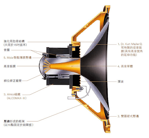

Even if this thread seem to be mostly about direct radiating dome -based coaxials, I wold like to show this cut drawing of the Tannoy Westminster coaxial:
Notice how the interfacing between the compression driver and the cone angle is virtually perfect. And the reinforced cone edge prevents the surround from protruding past the cone edge. They have even combined that with a reinforcement edge of the cone due to the light weight paper cone and the square horn preventing bell modes from forming. I love the attention to detail here.
Tannoy
I can't imagine this speaker having a ragged response, what are they doing different?
They are using some kind of compression driver, which is very different than using an exposed dome in terms of integration in a coaxial driver. However, it does have traces of the things we see on other coaxials.
Here we can see a dip around 2k, which may coincide with the woofer suspension. However, it could also be within the working range of the woofer, and also be caused by the surround, but as a resonance. The deviations we see from around 6k are probably some integration issues. I was not able to find off axis measurements, but I guess they are pretty fine.
