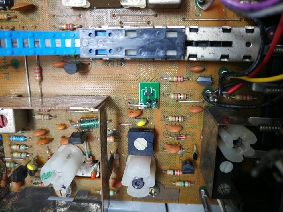

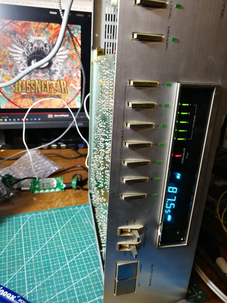

FINALLY got around to replacing the faulty Varactor in a Pioneer TX-710L tuner (I think it's officially a 710-2). The replacement part avialable was electrically equivalent but in SMD so I used an adapter board.
Doesn't look too out of place IMO.
It needs an alignment but, seems to work okay and no silliness so far... I'll test it for quite a bit longer before I call it a day, however, having been fooled before by this stubborn thing IMG_20200822_212654.jpgIMG_20200822_221436.jpgIMG_20200822_210945.jpg

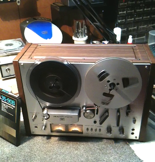

Just finished up an overhaul of my Akai GX-4000D tape deck.
She plays just fine, runs like a champ, good solid built machine.
Can't tell any difference with my ears OR my o'scope between source or tape.
This was likely the most popular model that Akai ever made.

That is a great repair, I'm curious to know how did you diagnose that the Varactor was the problem? The obvious seems that it didn't change between stations, but would like to know the symptoms it experienced.
My son’s Sennheiser HD407 headphones (for about the third time).
They’re only something like £30 new but why throw them out when the cable rips off the driver as you snag it on something? Plus it’s a few minutes fun and satisfaction for me.
When getting in to resolder wires, I found the ear foam disintegrated - he will never know that he now has the best audiophile quality green Scotchbrite scouring pad inside those plush ear covers!
It would intermittently make an awful noise and the frequency would jump around.
Then it would behave itself for a while again.
Ultimately, it was a process of elimination and there was almost nothing else left, safe to say I had less hair at the end than when I started... Thread here:

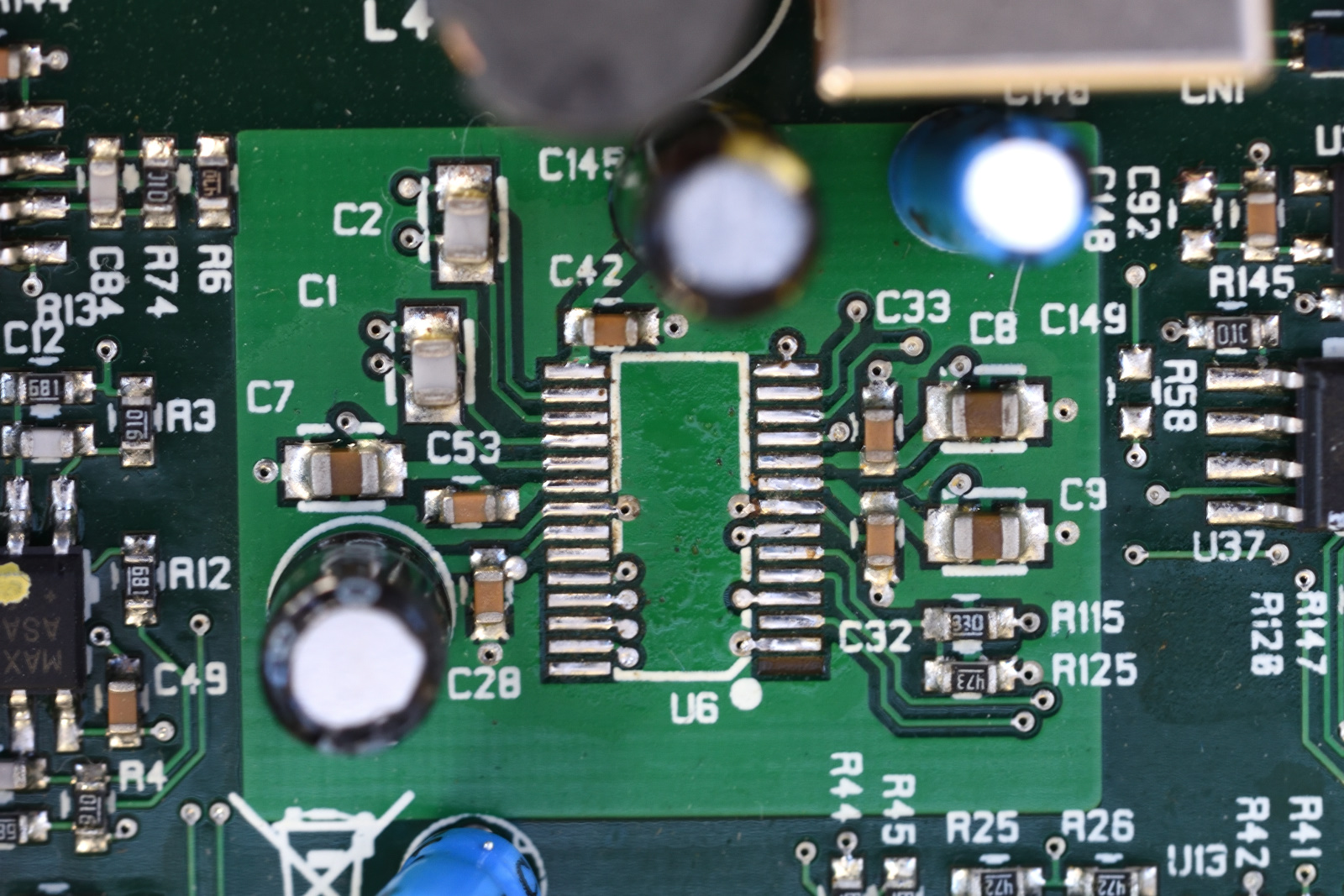

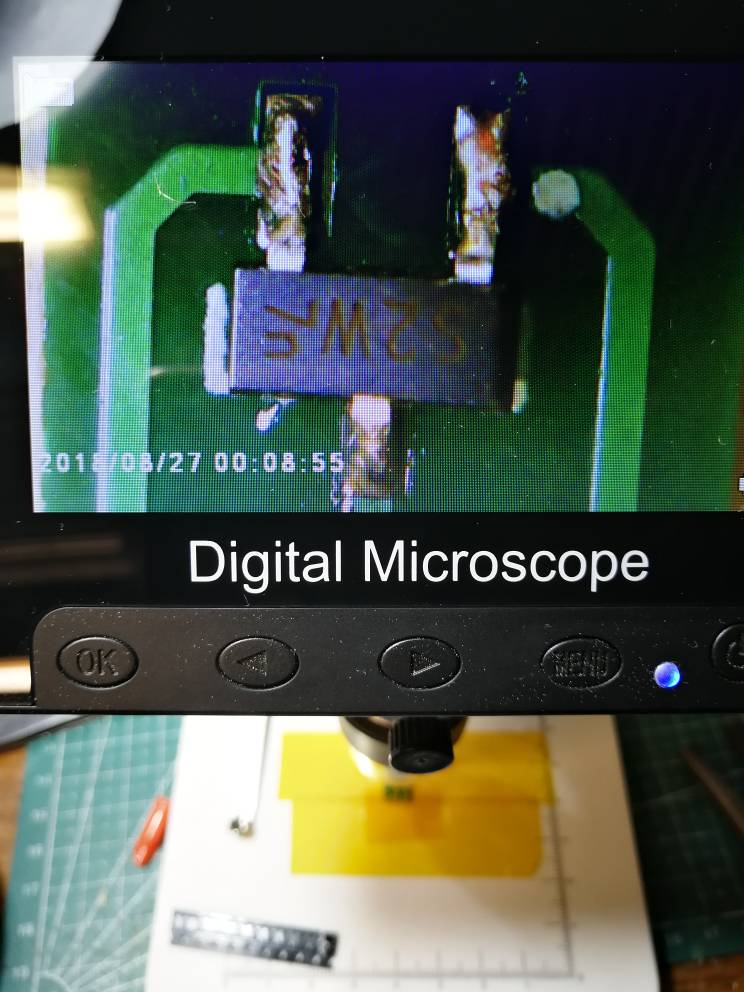

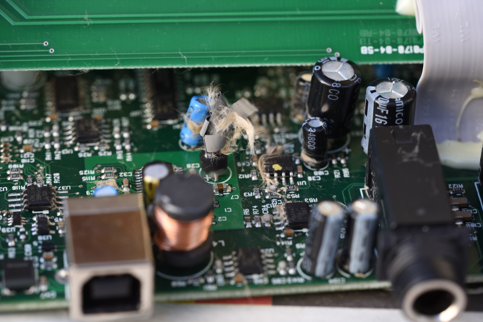

My Focusrite 2i2 1st gen.
It stopped working after I accidentally shorted the phantom power when working on the phantom powered electret circuit I have been playing with. It was still recognized by the computer but there was no output or input.
voltages seemed a bit low (should be 5V and 3.3V) but was around 4.6V and 3V. Thought it may be a power supply problem. found that the analogue circuitry and the cmos switches were working fine but inputing a 1Khz sine wave from another sound card and tracing the signal with the scope. signal got to the ADC and stopped.
I emailed focusrite (they have lifetime support) to ask about possible issues with the power-supply, and told them what I had done (shorted phantom power) and the troubleshooting I'd. They said "sounds like the codec, do you think you would be able to replace it if we send you one?" Note that this is a sound card that I bought about 7 years ago! I have to say I am completely blown away by this level of customer service.
I tentatively said yes, having never desoldered any soic SMD chips before, and they shipped me a new cirrus logic chip.
I ended up buying a hot air station for $139.00 figuring I'd use it in the future as I will be doing some smd stuff. I first tried desoldering on an old motherboard, with the soldering iron, and managed to damage the board in the process, which is what made me decide to get the hot air station.

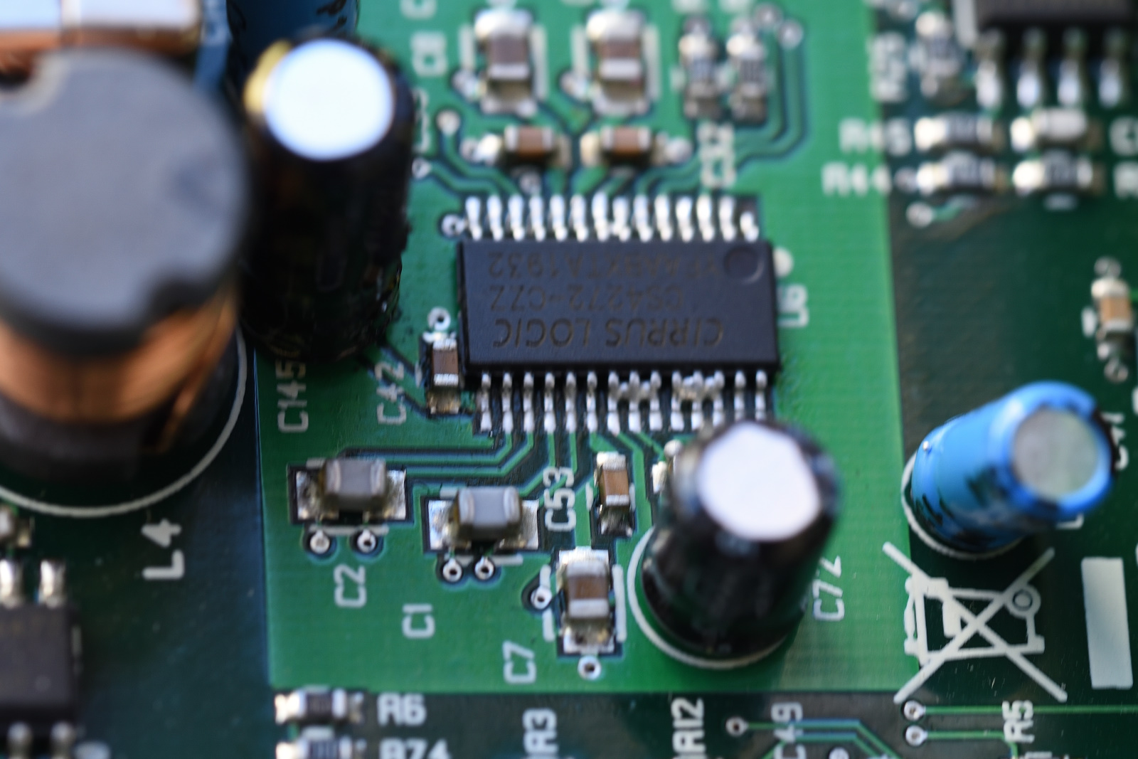

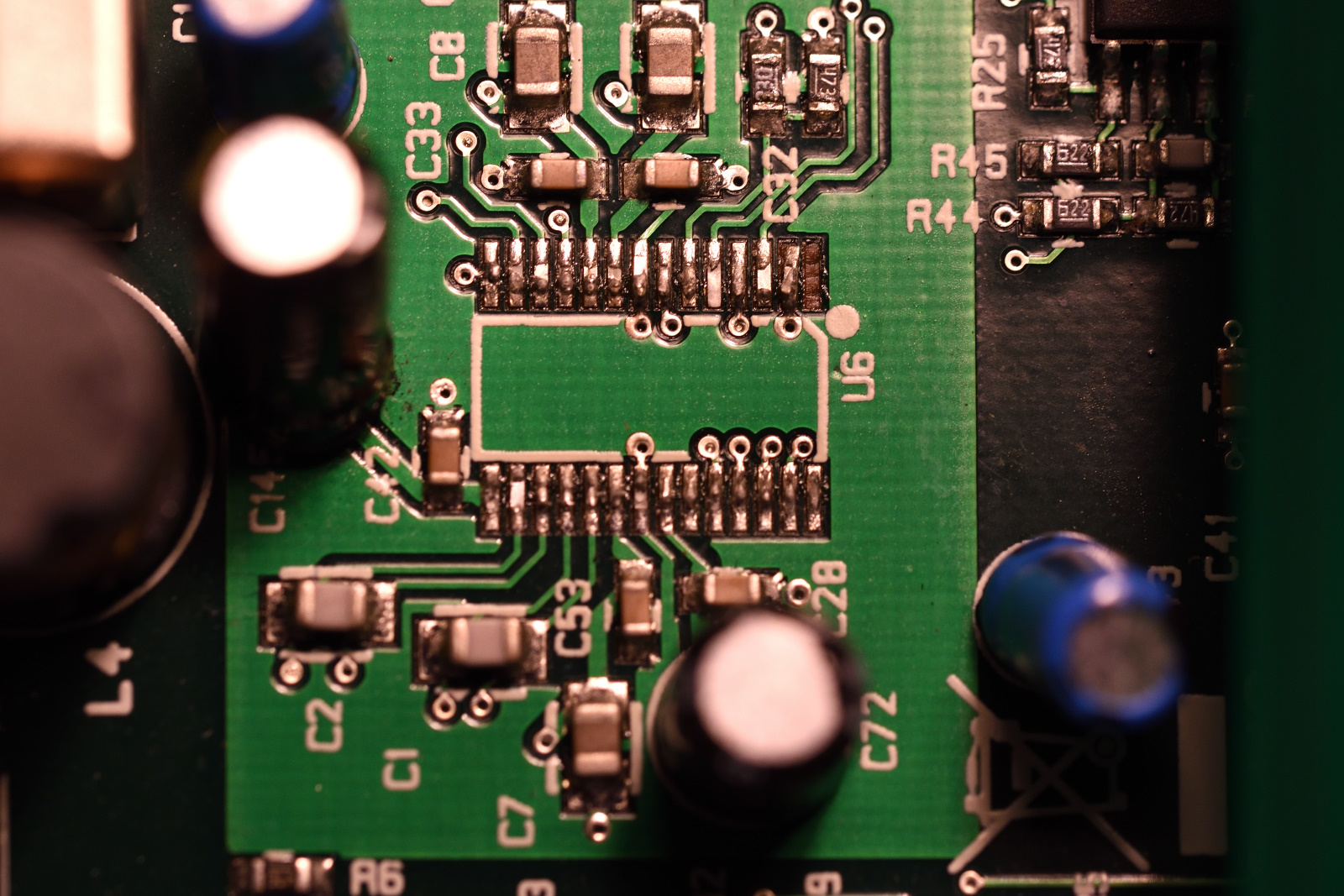

I desoldered the chip last weekend, 1st pic (did manage to lift one pad, but it was a no connect thankfully)
Today I cleaned up the pads with some flux and my normal 3mm sodering iron tip 2nd pic.
Then I carefully put a tiny amount of solder paste on the pads, placed the chip and heated with the hot air gun.
Well it went ok except for the solder bridges 3rd pic.
So trying to blow hot air on those heated up the nearby electrolitic which went bang 4th pic. It also lifted another no connect pad which was under one of the pins with the solder bridge.
In the end I got rid of the solder bridges with some desoldering braid, but I had a problem in that I didn't know what value the cap was. So I looked up the datasheet and the example circuit had a 47uF. I had a 47uF 50v (way higher voltage than needed) nichicon muse cap so I replaced it with that.
Plugged it in and it works again! 🙂 It may even have a lower noise floor and distortion than it did before the repair. Not 100% sure on that, but I don't remember getting under 140db on the noise floor before.
So all in all I'm pretty pleased as this was my first SMD repair.

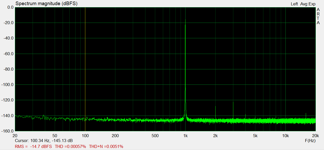

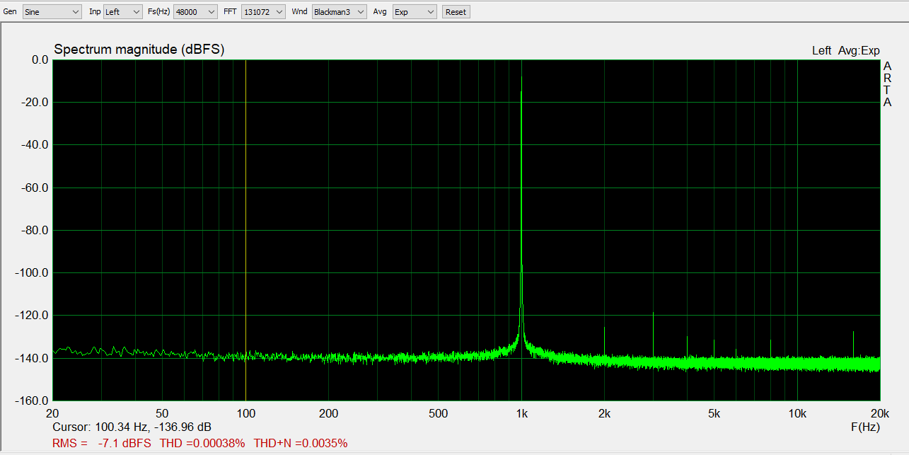

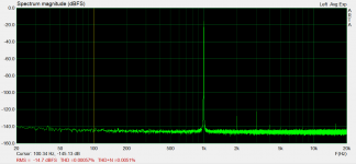

edit: added loopback test. First one is with ARTA calibrated and -7db out, and input level adjusted to give as close to -7db as I could get. -7db seems about the sweet spot for lowest distortion.
last image is with the input level dropped approx 8db which gives a bit better noise floor.
