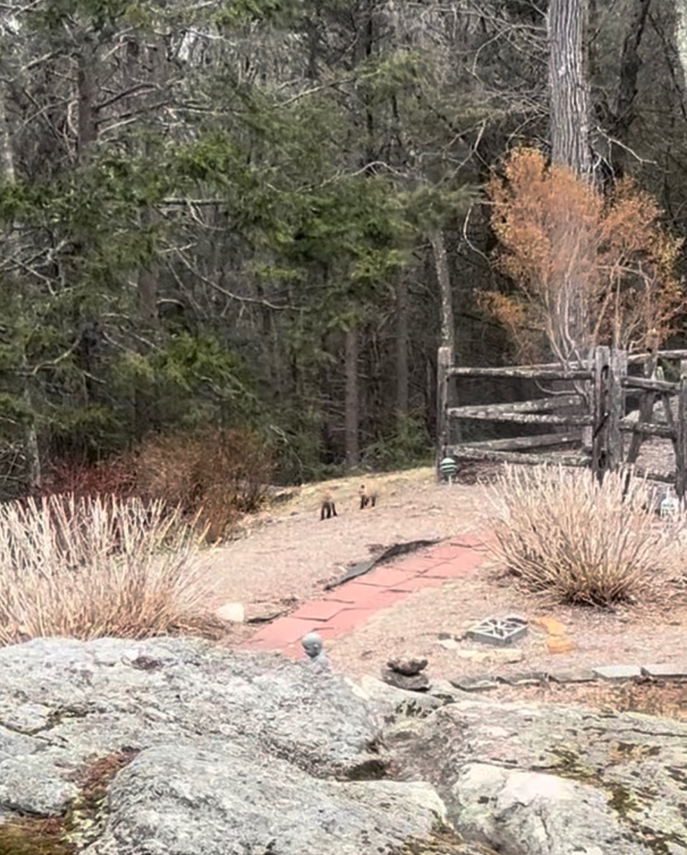

We have the Fatastic Mr. Fox who has taken up residence in a den on the edge of our property with the missus these past two years.
They had a brood of 4 pups both years that come out in the Spring and play by our pool and learn to hunt mice.
Still, they don’t put a dent in the mouse population.
There are several hawks in the neighborhood as well. Always hunting the mice and chipmunks.

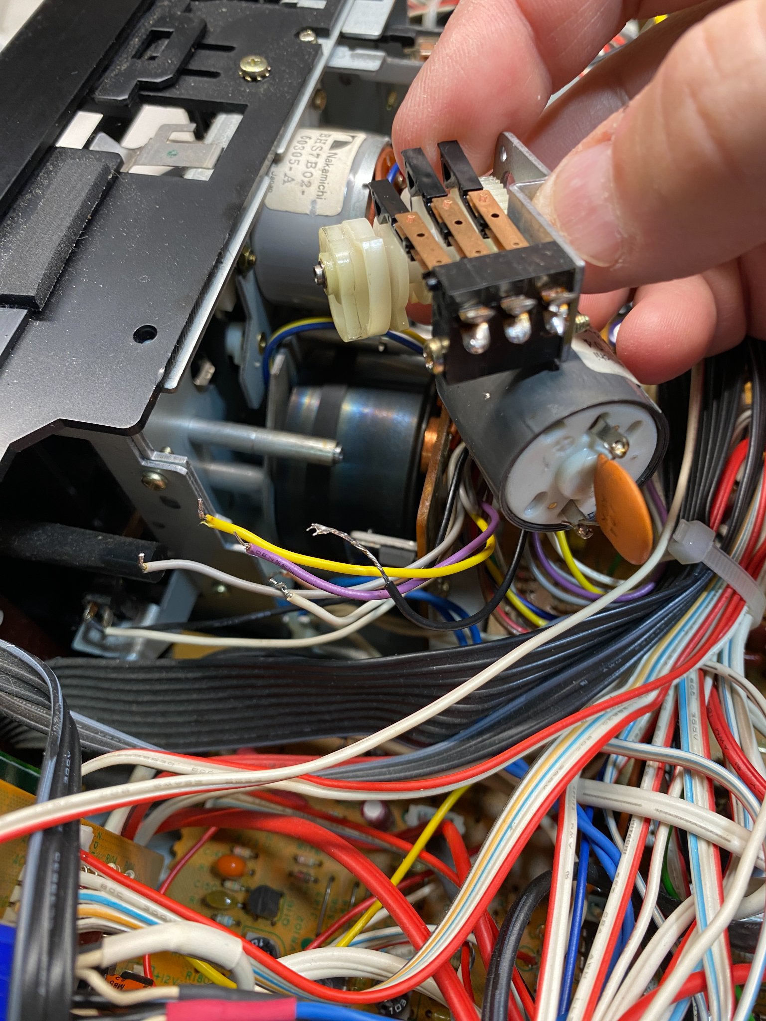

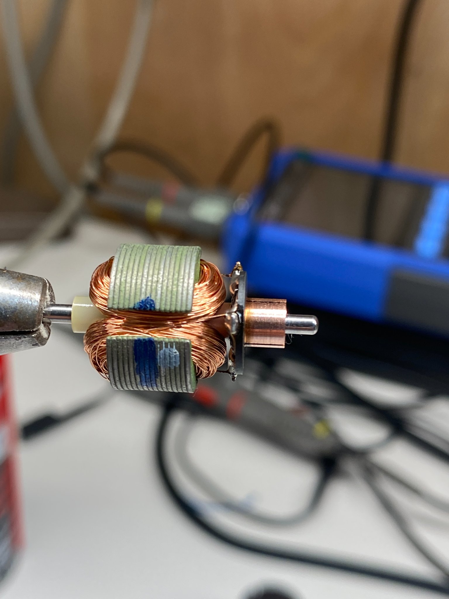

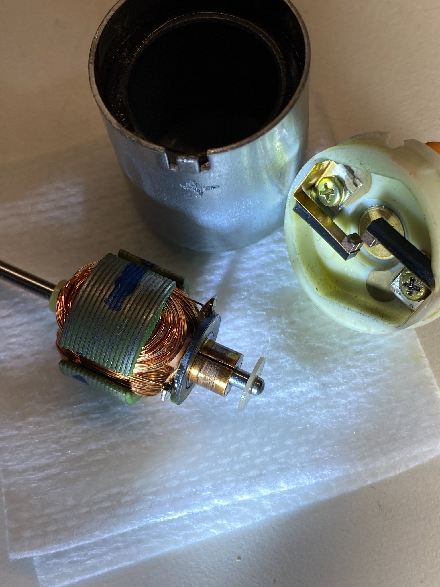

Brought a Nakamichi BX-300 discrete 3 head cassette deck back from the grave for a neighborhood guy. Rebuilt the control motor to get the transport to function. Cleaned heads and capstans, refreshed pinch rollers and idler tire. Per service manual I set play and record head's height and azimuth, set speed, VU meter levels, output levels and bias levels, etc. Nice performing deck. My first time working on a Nakamichi.

PB head height is set with a test tape. If you do have the Nakamichi jigs you could be close. If you don't, who knows? The tape path setup is exacting to get right, easy to "make go". Everything else is referenced from the playback head alignment and calibration.
Yup, I have a BX-300 also. Fantastic sounding machine. Those cam motors are a real pain, frequent failure club.
