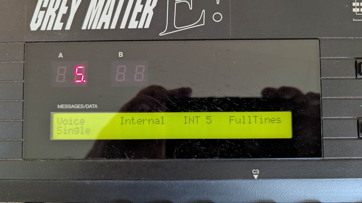

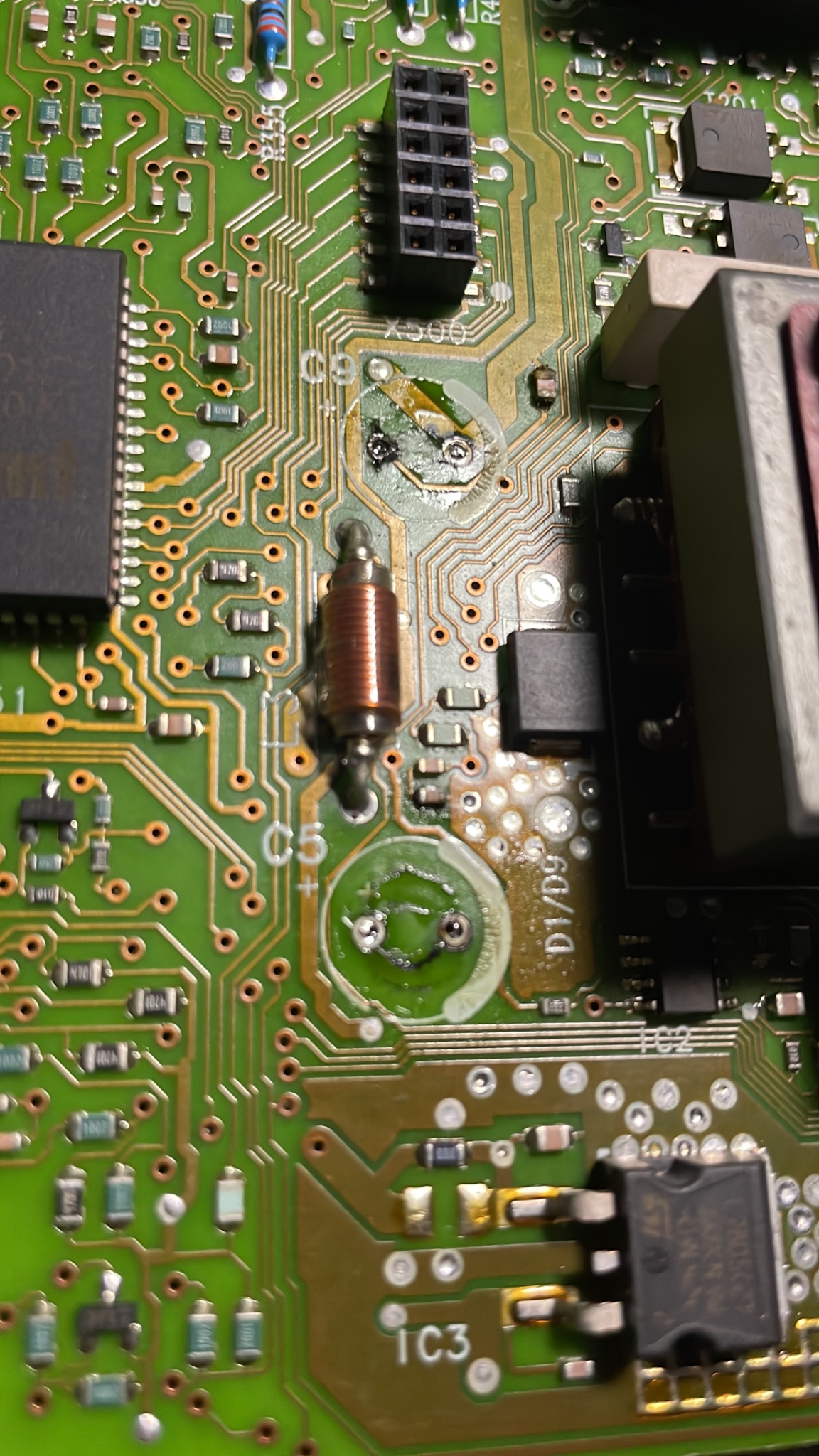

A nice guy offered to fix my good looking but dead Yamaha DX7ii. I tried to help but whatever we did gave no result. With Gray Matter installed the synth received MIDI-streams but to sound. With it removed and a EPROM with the original s/w it made noises but no MIDI ...
The issue was me mounting the replacement battery in a fashion it was shorted when the lid came on.
Gray Matter surgically removed, new EPROM battery fix and ...

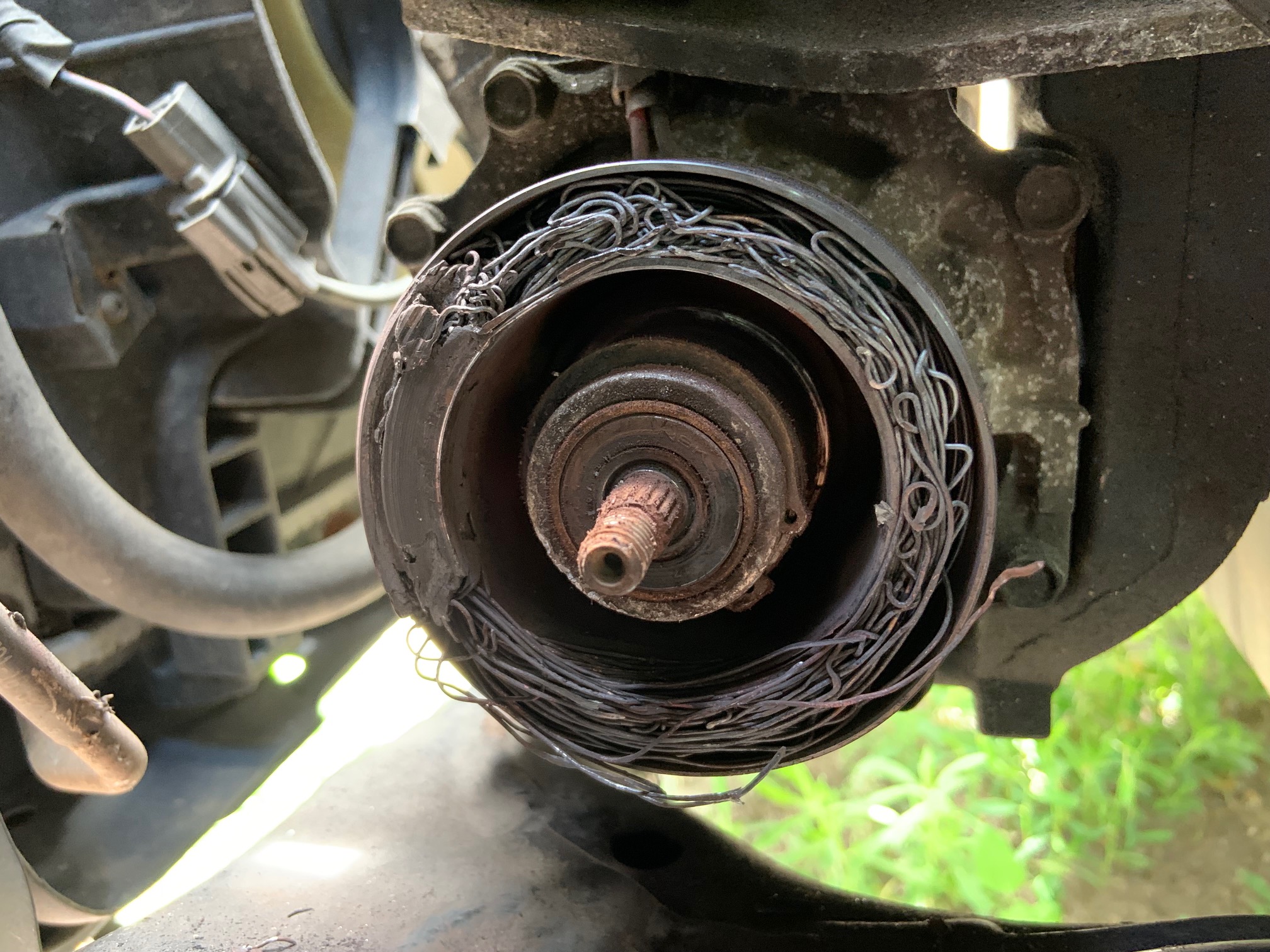

I have not really won the battle yet. This is a picture of an air conditioning clutch on my oldest kids car. Was the one car out of four we have that had working AC. Just had to post the lovely photo after I pulled the pulley out.
My youngest kid drove it from Denver to Arizona and had the alternator light go on about 600 miles away. Initial diagnosis over the phone was there was no alternator belt. He wound up stuck in some small town on a holiday weekend so I jumped in the car with an alternator and a spare belt. Turns out the compressor clutch froze and the belt went bye bye. Had to get a belt that would bypass the compressor though the closest was another 60 miles away. Got the car working and the kid was able to complete his mission.
The bearing race is still stuck on the compressor and may take some gentle drilling/grinding to get off.
I think it may be a good idea to buy another compressor, and get it replaced by a technician with gas recovery system, the existing one may be worn out or damaged for the mechanism to be frozen this way.
A frozen sealed bearing means it is at least 5 years old, there is rust on the splines as well.
My car has a double pulley, one is for A/c, the other for water pump and alternator.
Long back, different car, A/c belt broke, was able to get home at night after removing broken belt bits.
If you have access to CO2 gas, or nitrogen, spary to freeze the metal, it will shrink ever so slightly and come off easily. Better if you have a puller.
Then check the compressor, you may lose the gas, expensive, so suggested technician.

I find it admirable in this day that someone goes to the length that you did to make it work for the time being. We live in an age where some people will drive on a flat tire to the point that they ruin the rim, to a tire shop so that a professional can do the rest. We have all seen it.
The clutch was $35 on amazon. I had the hope that I could just replace the clutch and not mess with recovery and a charge. Maybe the new compressor option was better though.

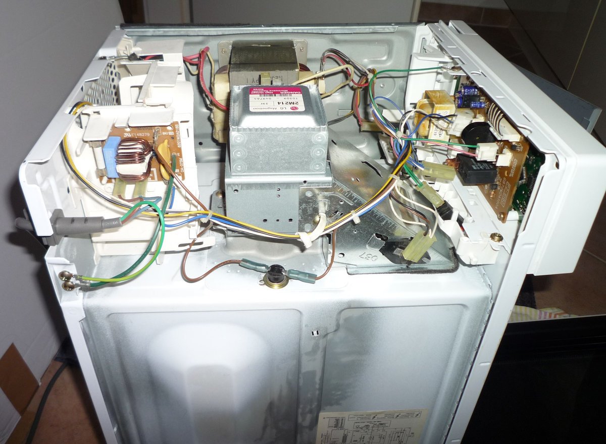

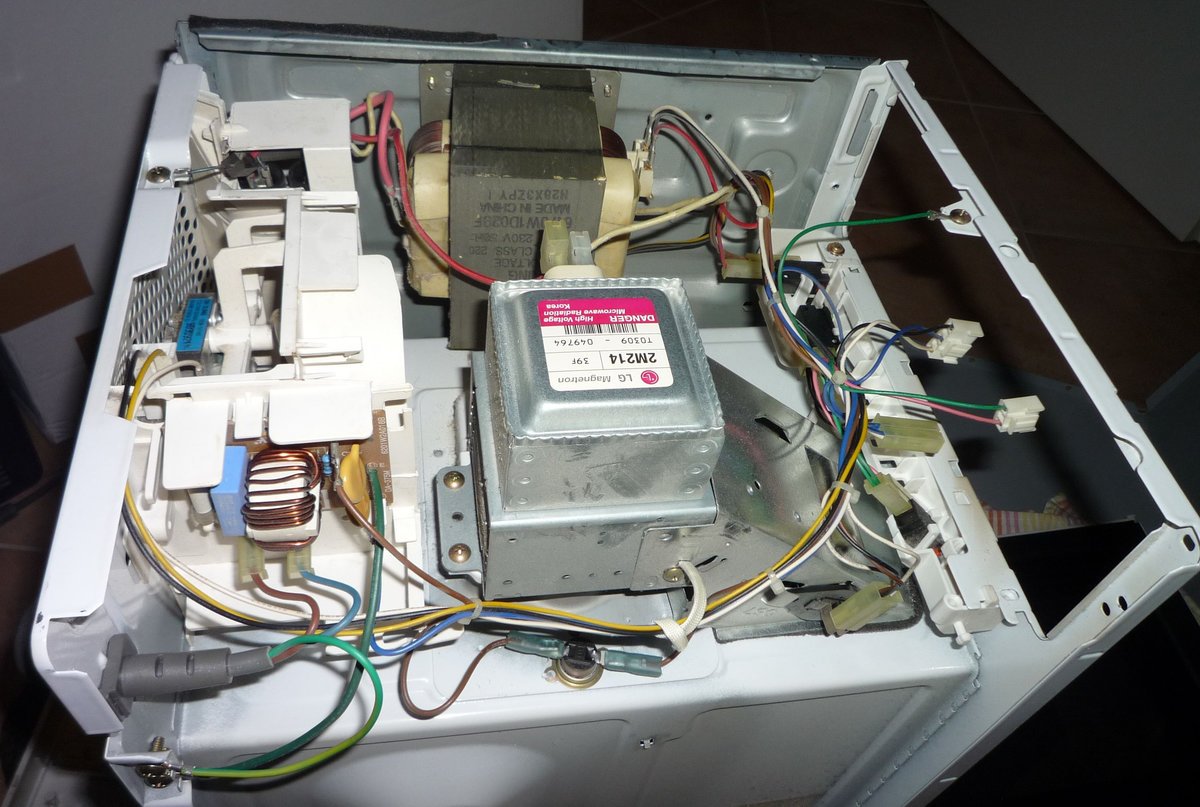

Gave son a old GE microwave to take to his apartment at university. Worked for 6 mos, then he reports suddenly "no heat". Brought back here. Had a look, HV diode checks good, cap checks good, magnetron shows virtually short circuit conductivity between the two connector pins, open circuit from those pins to chassis. I no longer have equipment (TV CRT anode probe) to measure 5kV...
Sounds like it's pulling power and putting it into something when run, giving the usual humm when the controller energizes the magnetron, a moment after starting up. Just like the identical unit we use daily. No burn, no smoke, no odor anywhere inside - fan spins, clean inside. I havent measured the AC current draw, which I could at least do - safely.
I could just shot-gun the magnetron, for ~$50 - and hope. I wish I could understand the failure mechanism root cause first. When I was a kid I remember my father shot-gunned the CRT of our 1st GE color television, when it ultimately turned out to be a bad HV diode.
There's a thermal switch; paperwork says it's to shutdown if there's a fire in the chamber. There's a humidity sensor.
Any ideas of how to diagnose further? A YT video mentions that the two pin connector on the magnetron is actually a feedthrough capacitor, but I measure open circuit on my Fluke DMM on those pins to ground.
The two pin connector on the maggie is the filament (and - HV cathode connection). I'm not sure what magnetron is in the microwave, but if it's something like a 2M137 (a typical 1.2kW microwave oven maggie), the filament is rated 4.4 V @ 14 A, so it would be on the order of 0.3 Ω, so the near dead short resistance there checks out.
Tough to troubleshoot further without measurements, but it's likely either a bad maggie, or the voltage doubler cap. The cap could possibly be shorting at the higher voltage it encounters in operation (any possibility of putting it on a megger to check dielectric resistance?), but I'd be more inclined to suspect the maggie. It likely goes without saying to be EXTREMELY careful working on microwaves, as the high voltage WILL end you if you screw up.
Given the cost of new microwave ovens, unless it's a really good oven (helped a friend years ago with a really nice stainless steel chambered one he had), it might make more sense to just buy a new one.

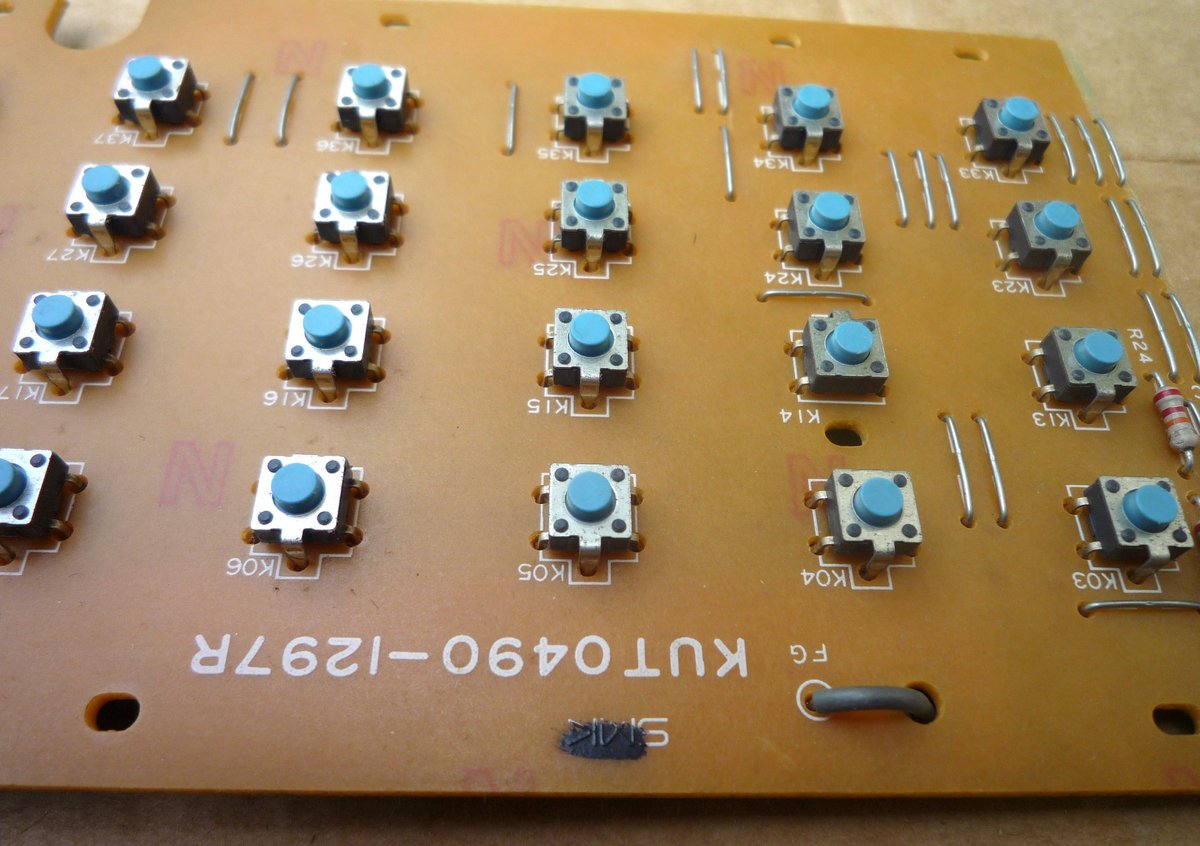

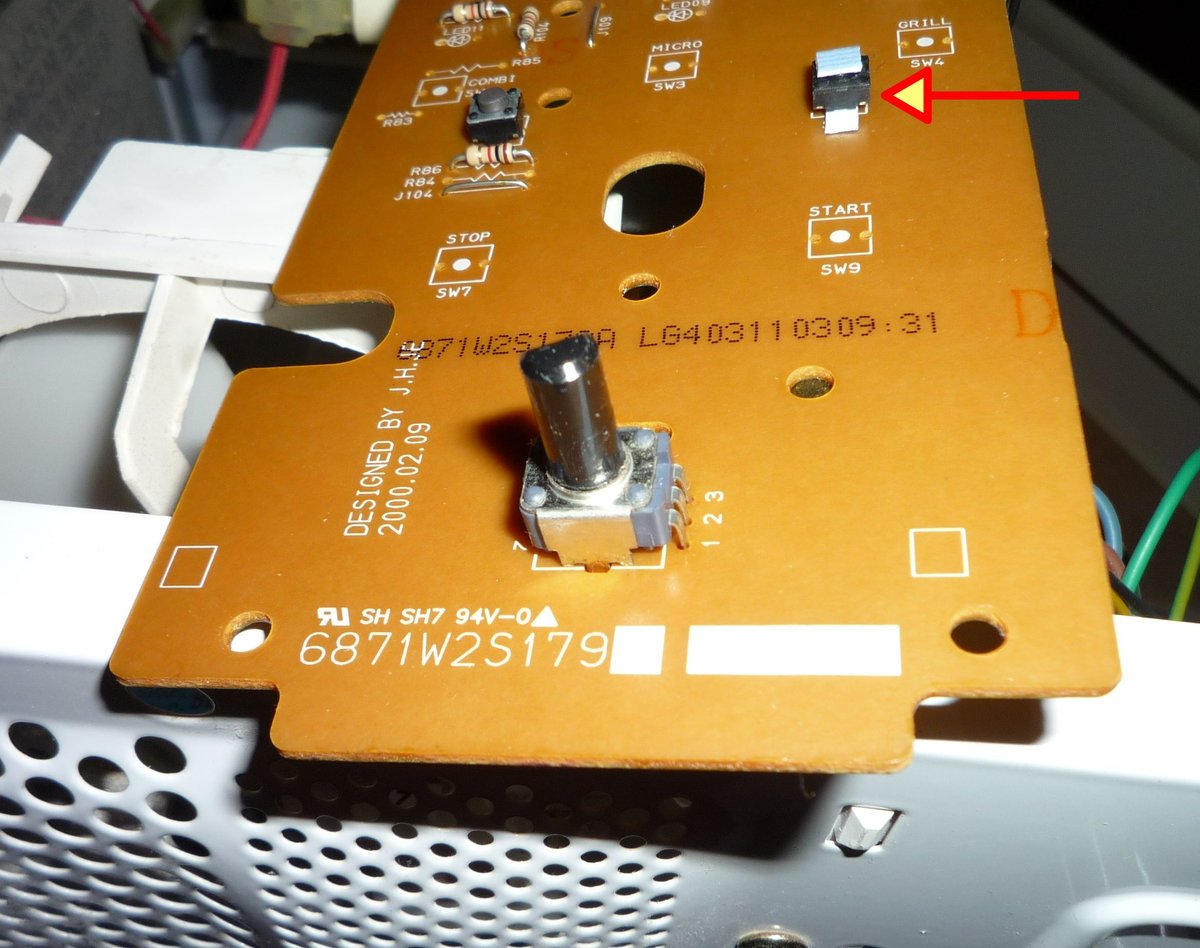

My precious ~25 year old BOSCH microwave (an ebay purchase in like new condition for <1/10 retail price at that time including shipping..):
16kg, inside out built like a tank, still looks like new altough it gets used every day several times, nice clean (no) "design", can be operated without reading a 250 page manual...even wife can, anything with more than 2 - 3 knobs or controls is way too complicated for her...🙂.
Did not turn on anymore. Took me more than an hour to figure out how to disassemble and gain access to the PCB that carries the operating controls on the front. When I got there (thankfully) seemed like only a tiny momentary push-button was worn out.
Looked up old parts bins. Found an old donor PCB with lots of similar buttons on it. Turned out the bodies of those as well the button itself where a tiny bit less tall. Shoved and glued some plastic sheet underneath the miniature switch and also something on top of it. Removed the old, desoldered and soldered in the "new" switch. Reassembled. Works again like a charm.
Cost: zero. Probably good for another 25+ years (will likely survive me, unless I make it to 90+...).
