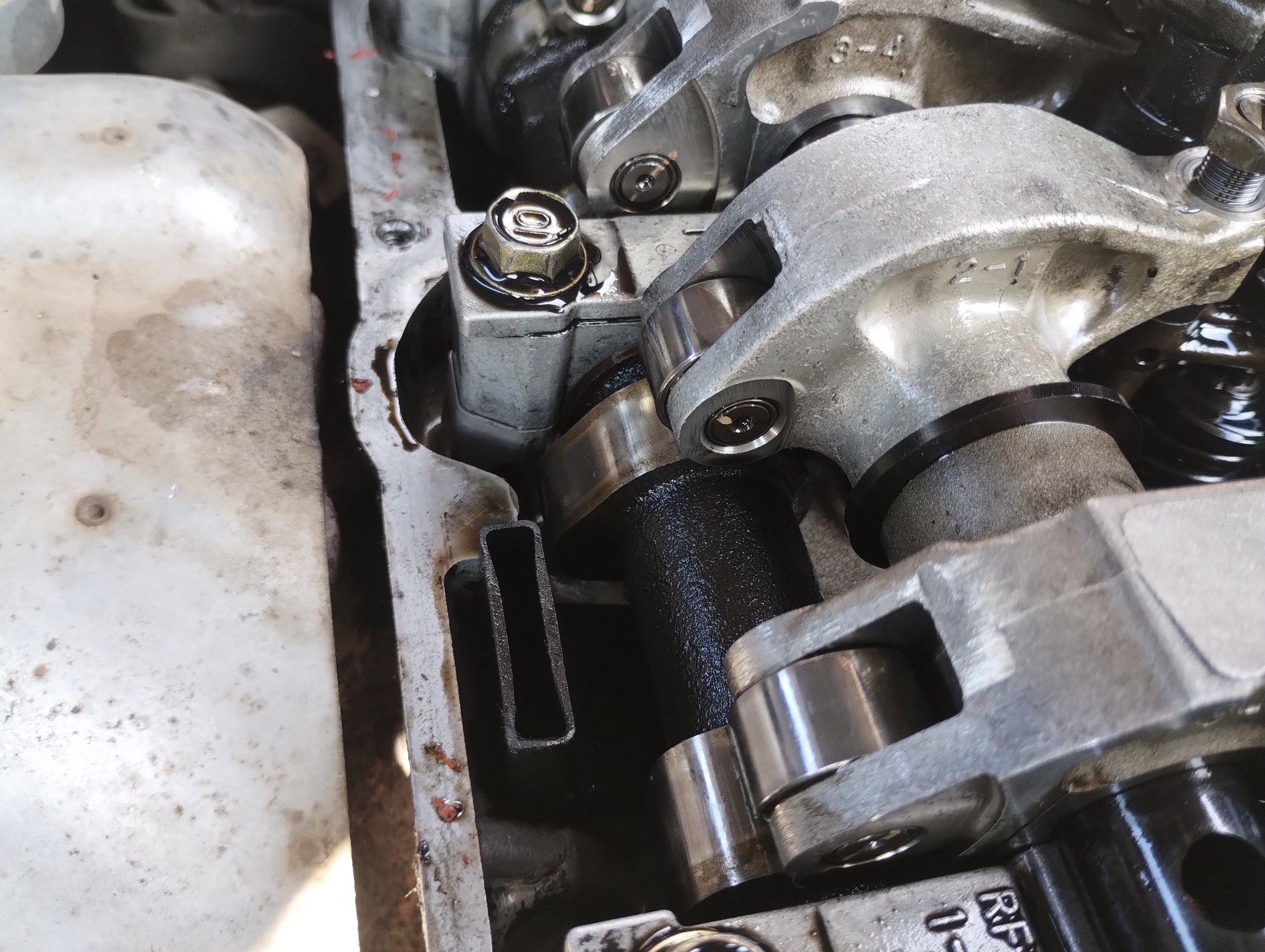

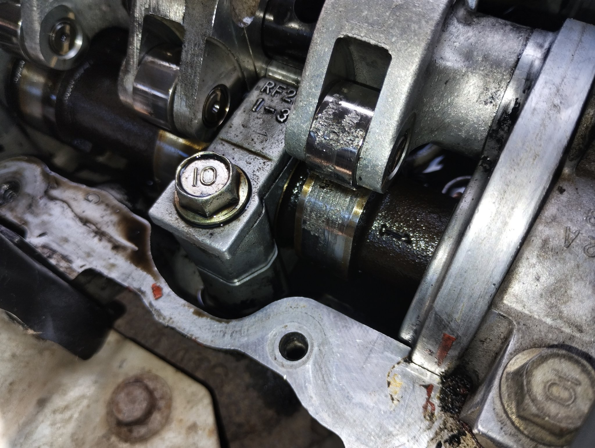

My everyday car (Mazda 626, 2000cc, turbodiesel, 400 000 km) gave rhythmic, strange engine-sound. I disassembled the cylinder head. One camshaft-pin and one rocker arm lifter were seriously pitted (see picture). All of another surface were perfect. I've change the rocker arm and the camshaft. The engine sound is fine again.

Maybe that Mazda engine always needs to be filled with engine oil to the max? It seems to have seized due to insufficient lubrication. I drove an Alfa Romeo Mito 2 cilinder a while ago that was known for the same. When the oil level in these is not in the vicinity of maximum level they lack enough lubrication (in corners) and start to have engine damage causing them to consume engine oil.
Reactions: neodymium
Thanks for your opinions! The oil level was at max. But the rocker arm with roller can survive the poor lubrication, because there isn't essential friction (opposite as flat tappet cam follower it is). I suspect the hardening problem or metal particle pollution.
The rollers tolerate the low viscosity (for a minimal lower consumtion) and low ZDDP content (low SAPS due to DPF lifetime) engine oils. When I was young, the engines ran with SAE 40-50 warm side viscosity class oil, with a lot of ZDDP, sometimes (a bit later) with molybdenum (MoDTC). The camshaft and flat tappet follower ran forever without worn out...
Yeah, metallurgy can catch out engine makers. I remember Mitsubishi had problems with their piston rings wearing prematurely and for a few years you'd see quite a few Mitsubishis blowing smoke. Hyundai seemed to inherit the issue as they used Mitsubishi derived engines for a while, and they too used to smoke more than you'd expect.

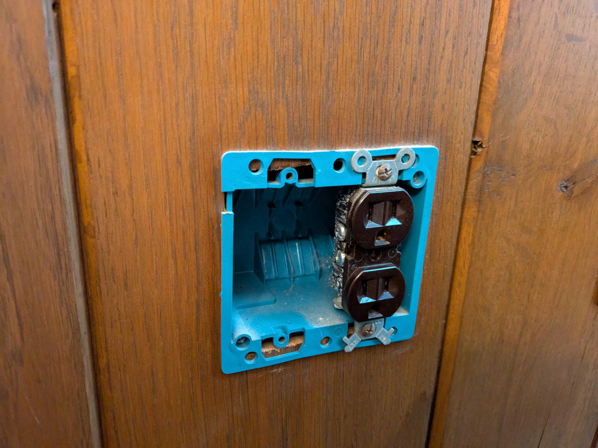

We got our house patio door and front door replaced a couple of years ago with no thought to the existing alarm wiring that was present (entry sensors).
Don't use the alarm too often so never thought about it much. Then couldn't set the alarm one day...
Had to fish some wires and source new switches.
Would not want to fish wires for a living!
It gets better after a few hundred and way better after a few thousand. I've apparently hit my limit though because it's become increasingly tedious and I'd be happy if I never had to fish another wire.
