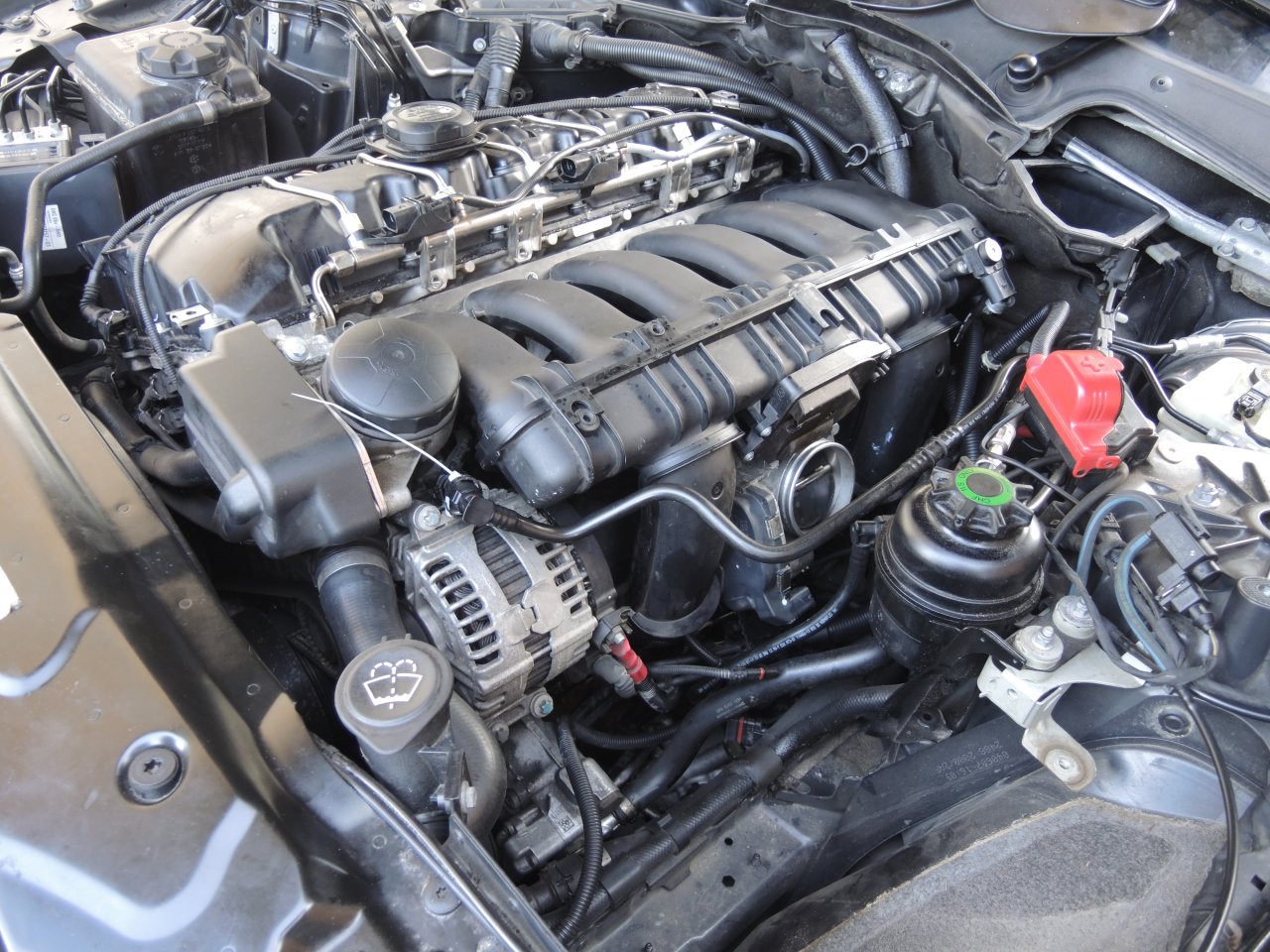

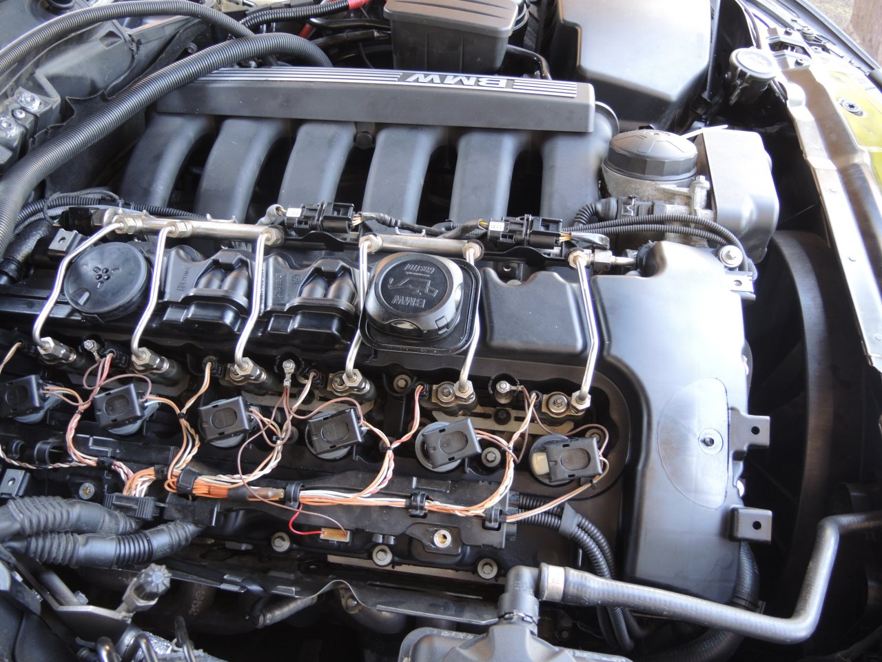

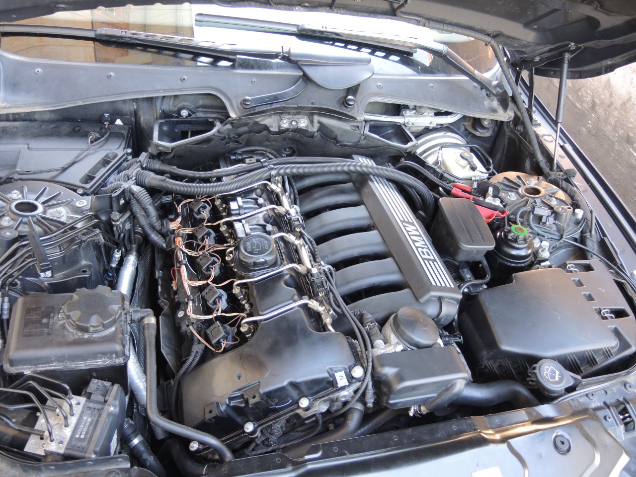

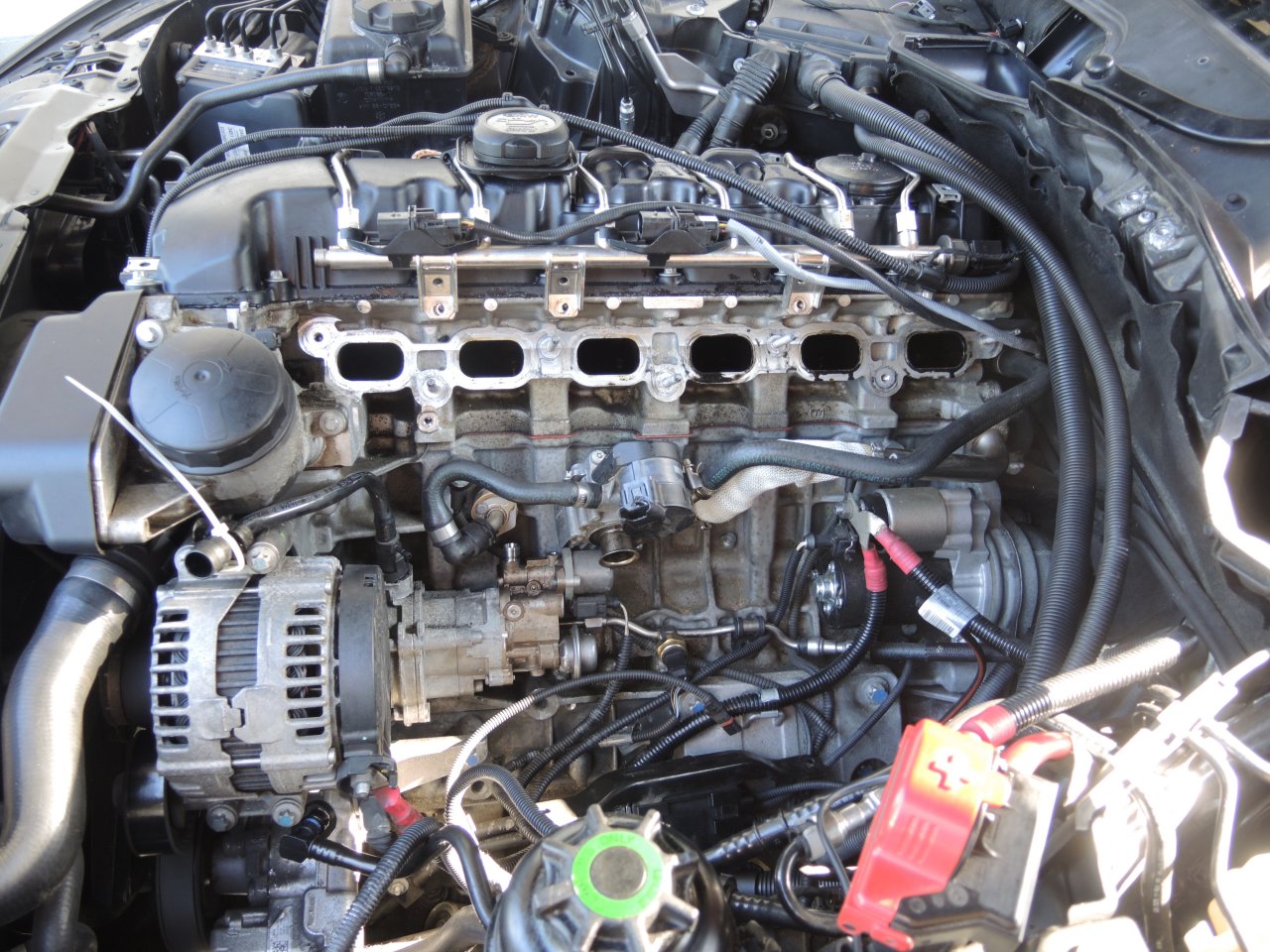

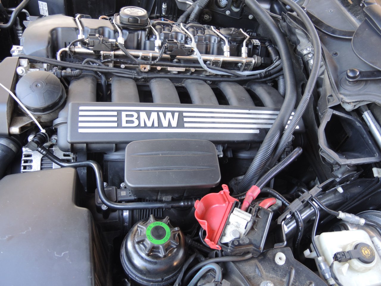

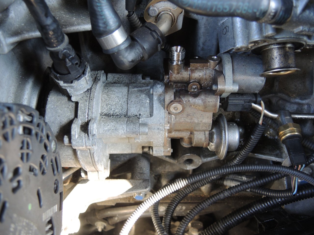

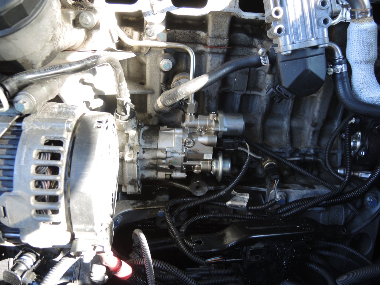

BMW 530XI N53B30
So a s I promised, this afternoon when I returned from Business, it was around 3PM I took care of my Bimmer...
As I just had a few Days before replaced the Valve cover, and also Spark Plugs, Ignition Coils and a few other things, the top cover wasn't back on the engine which saved me some 15 Minutes time to take out the Plastic Shielding.
It's quite some work to remove the Air Intake Bridge, and including throttle and also all the cables and what comes with it.. but it's possible to do if you are alone working under 2 hours..
Exchanging the HPFP needs some special tools to remove the screws, also to tighten them as well.
So, I have replaced and tested the HPFP already but because of many little things I found, which can be made right now, like exchanging small Rubber Tube Pipes which should be exchanged, so the engine is not finish yet..
As I said I have tested the Pump and Pressure is OK. is exactly there where I like to have it..around 100BAR without running the Engine.
Check out the pics, you will be able to see the old and New pump as well as what actually was broken on the old one, I think Tomorrwo afternoon I can drive that BMW 530XI again..
Enjoy Week end..

Only 100 BAR? The VW TDI can reach 2000 BAR! I guess you need the extra pressure to atomize diesel.

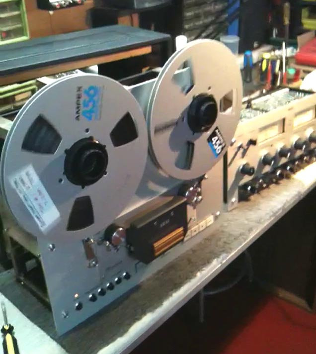

I finished up overhauling the Akai Pro 1000 RTR....
Some idiot was into it, and must have adored using a screwdriver which was attached to his non-fuctioning brain.
At least a dozen critical pots were completely off - making my job 10 times harder.
Plus, there was missing linkage on the tension arms assembly.
And those Akai brand "never oil" motors all needed fresh oil after 40+ years.
Thank god the idiot didn't disturb the head block adjustments!

This is a Gasoline, and there 250 Bar are a lot.
You see, if the engine is completed it will go up to 250Bar.. but the 100 I measured was only to check out if the HPFP works. No intake Bridge, no Throttle not even Lambda were connected.. just pure Pump pressure for a few seconds.. So I know that the Pump has been mounted correctly..

Reel to Reel still the best if it comes to TAPES..
Good Job..
