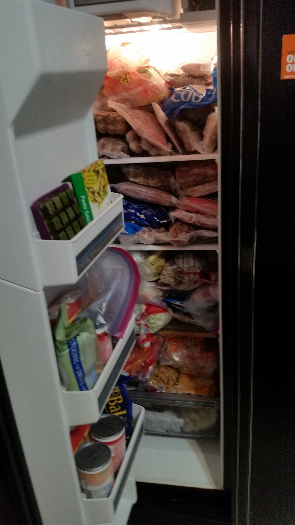

I just finished three hours of taking all food out of the freezer section of my refrigerator and putting it in Ice Chests.
Then I removed all shelves, and the back plate covering the evap coils.
I then poured warm water over the ice covering everything until I had it cleared while laying towels on the floor to collect the run-off. After melting the ice, I cleared the drain tube to the collection pan, flushed it with bleach and then water.
Then I used compressed air to clear the condenser coils of lint, sprayed everything with Greased Lightning, flushed it and dried up the mess.
I used a shop vac to suck up the dust bunnies.
Finally I put all the shelves back in place after washing them, and turned it back on.
After a 15 minute wait I restocked all the shelves from the ice chests.
Then I cleaned up the resulting mess and pushed the refrigerator back into place.

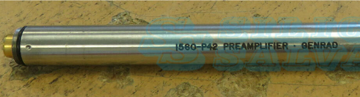

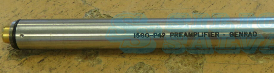

A friend pointed out that someone was selling GenRad (General Radio) microphone "1/2 inch preamps" (the body part that a condenser mic capsule screws onto, giving it ultra high impedance buffering and 200V polarization supply) for $25, shipped. I had recently got a nice Bruel and Kjaer capsule and was watching for a B&K type preamp for it. But these are a lot cheaper and easier to use than B&K's preamp-bodies, also has a 10x (+20dB) gain position and the 200V supply is builtin. Worth a gamble for $25 I thought --
But these come without their unobtainium cable or cable connector. But no biggie, I opened up the case and soldered cable wires (an old USB cable) directly to the pins, 3d printed some cable clamp parts, and... found that the preamp was dead! Shorted (B-C) transistor in its amplifier circuit. Found a schematic online. I replaced the blown NPN with a 2N3904 out of the parts drawer and now it works like a charm. I also printed a nice inline 1/2" mic to standard mic stand attachment.
At the moment there are still 4 of the preamps left on the bay if anyone wants a project with a good payoff (for anyone wanting to put together an ultra high quality microphone anyway - A B&K like it would cost hundreds). No connection to me, but I bought two of them. Waiting on the second to arrive and get adapted.

Nicely done bwaslo, didn't know that B&K capsules can be used with preamps from a different brand.

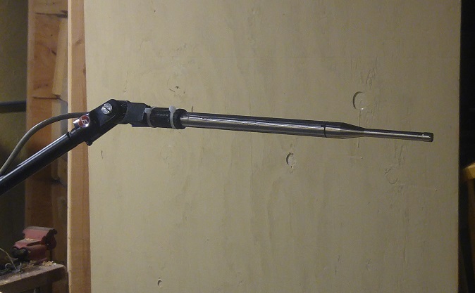

It was news to me, too. Demian Martin clued me onto it, apparently there is an overall mechanical standard for this stuff, set originally by Western Electric. As far as I can find, GenRad never made an externally polarized capsule themselves. The 200V is provided for Bruel and Kjaer capsules according to the preamp's manual.

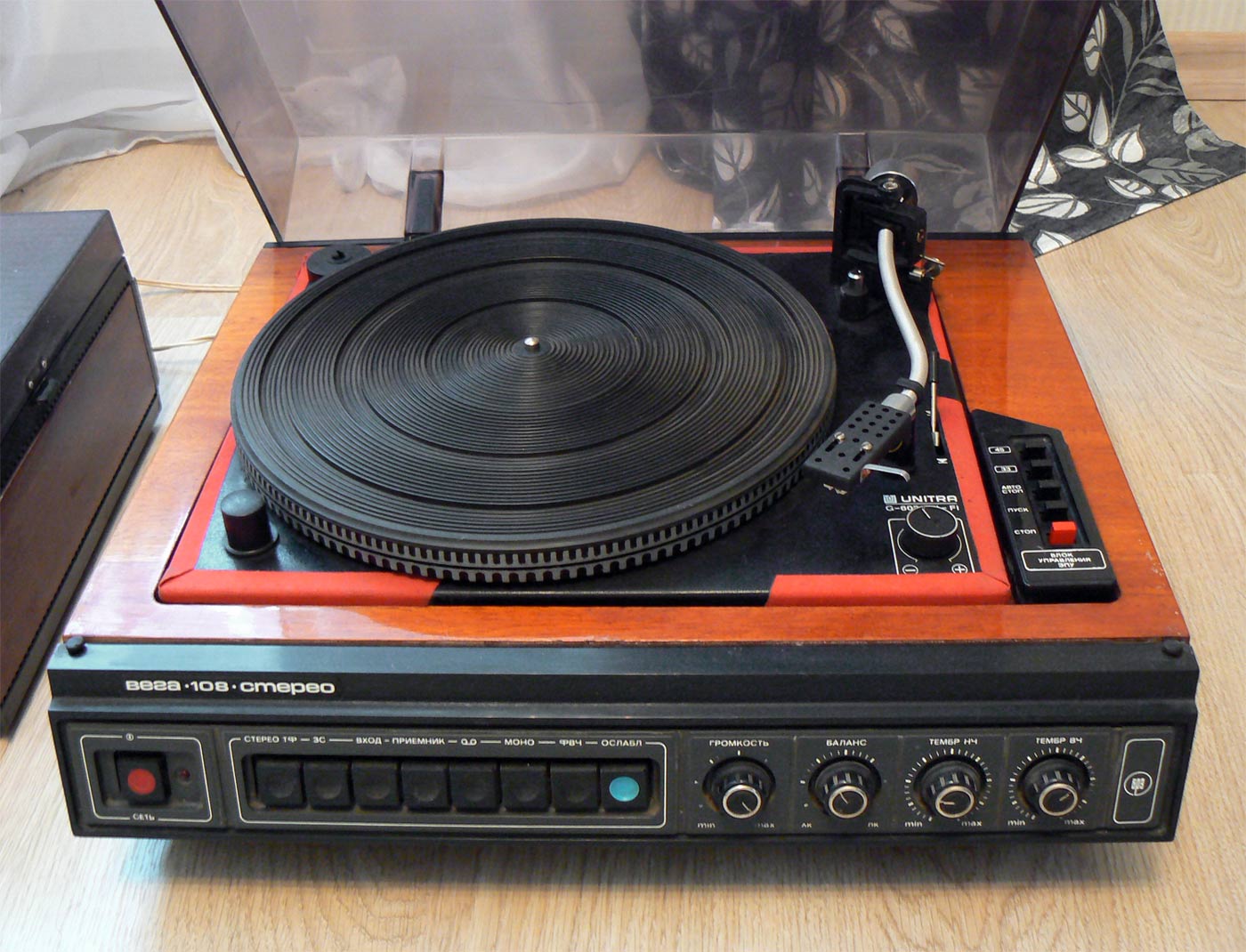

Repaired old soviet ВЕГА-108-СТЕРЕО (VEGA-108-STEREO, like in an attachment) vinyl disc player for my older colleague. Threw out 30-40 old faily paper, electrolyte and ceramic type caps, and old prone-to-fail transistors. Resistors with +10% or -10% deviation (or even more) in feedback circuits and awful PCB design make me crazy.
Now it works like a new one or possibly even better.

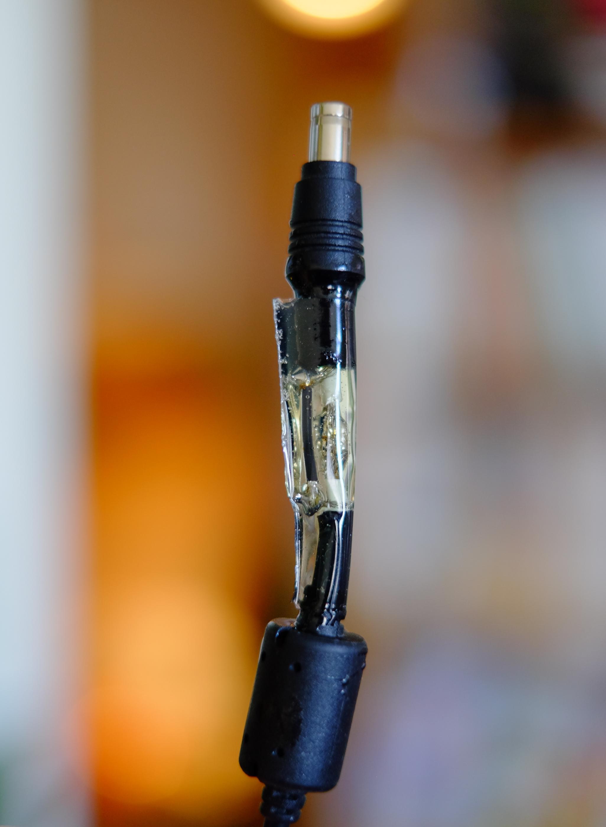

So when I was asked to put the plug back on the power cord for a twenty year old (!) Hitachi laptop it was the perfect chance to see how it worked and use the bond failure for good effect.
With the center conductors spread and run into each other and soldered and a piece of black insulated wire connecting each end of peeled back outer braid I let a mix of G2 epoxy sit for about an hour to thicken up and then poured it onto the joint which was lying on a rectangular piece of mylar cut from an anti static parts bag. Lifting the mylar ends up and around around to meet each other and clamped pinched close to the cable until next day.
When I first started to pull the ends apart to separate the mylar the bond seemed pretty solid and I thought maybe it wasn't going to let go but once I hit some critical pull force it suddenly popped off nice and clean. Very useful for odd shapes that need infill or encapsulation.

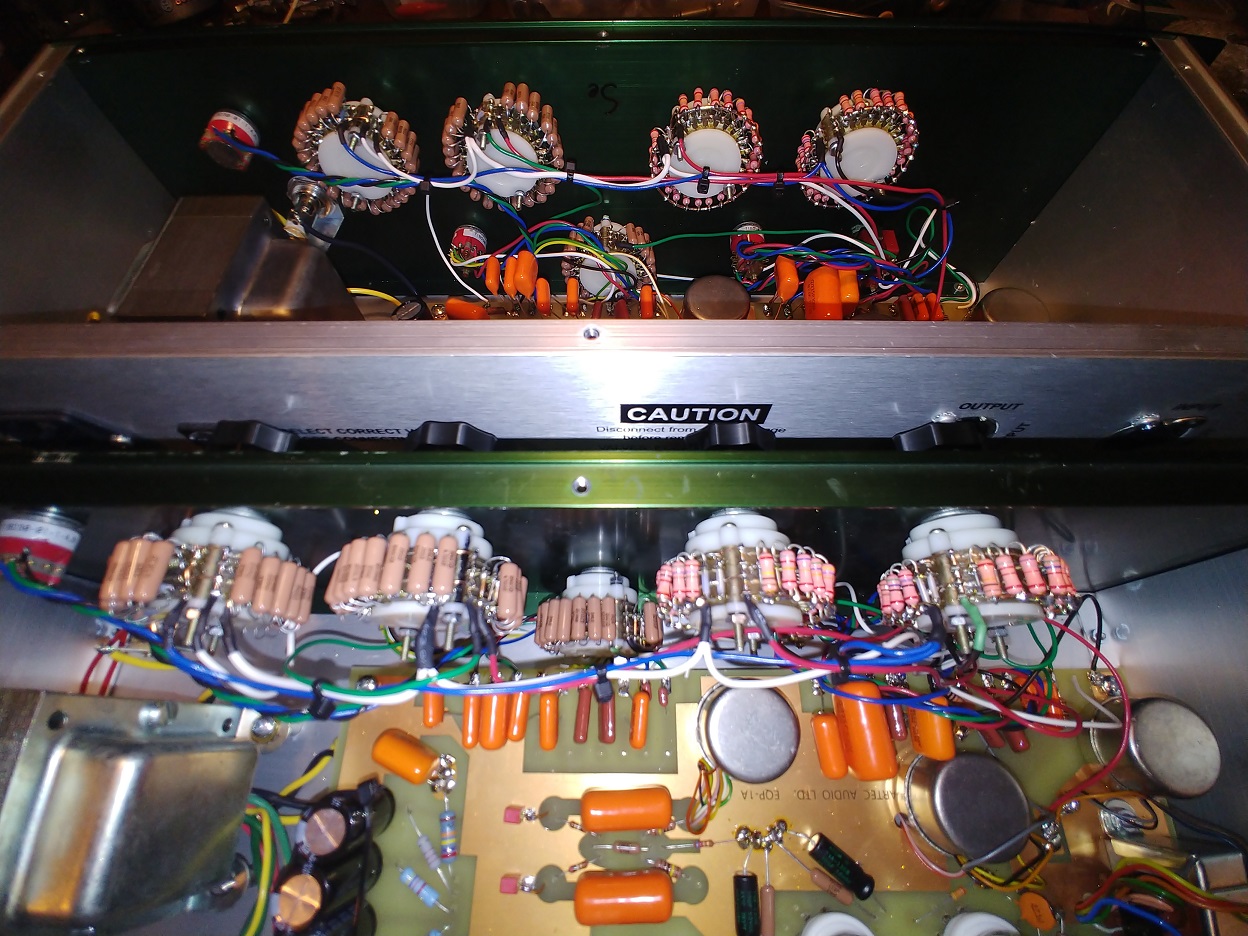

1 pair of Pultec EQP-1A valve / passive LC Equalizer copies, conversion from EQ
cut / boost potentiometers to 23 pos rotary switches. 5 in each module, 10
total. 220 resistors. I used a combination of XL spreadsheet and actual
measuring the existing Pot to work out the 22 resistor values for Log Pots
replacements.
The EQ's were also oscillating around 40kHz. Fixed that with revised compensation scheme. Re-tubed.
