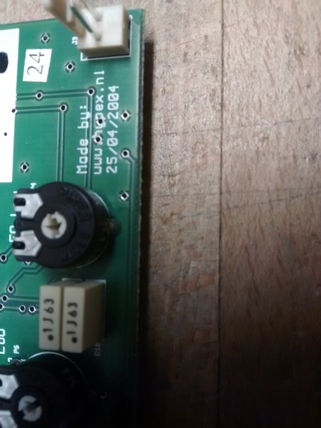

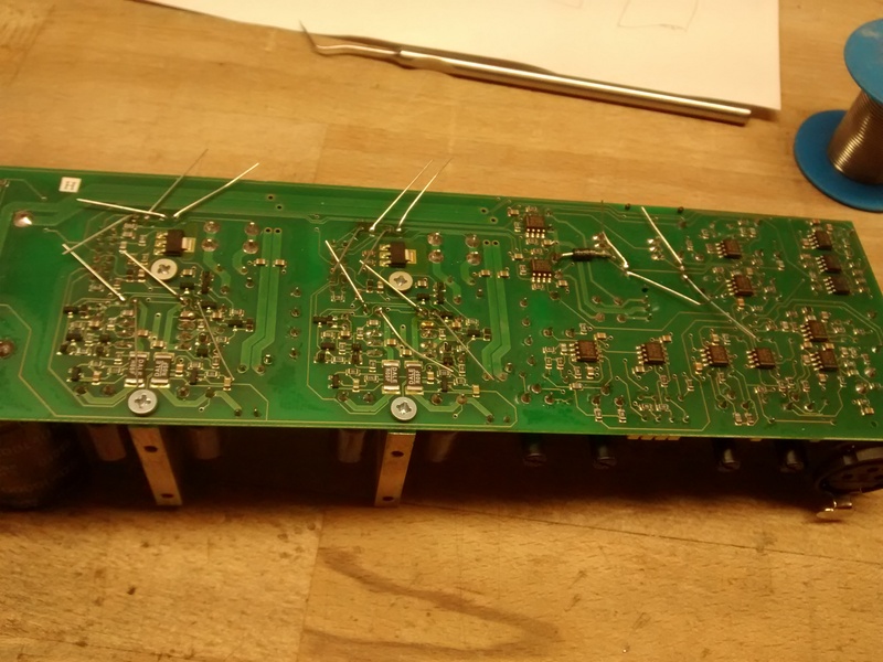

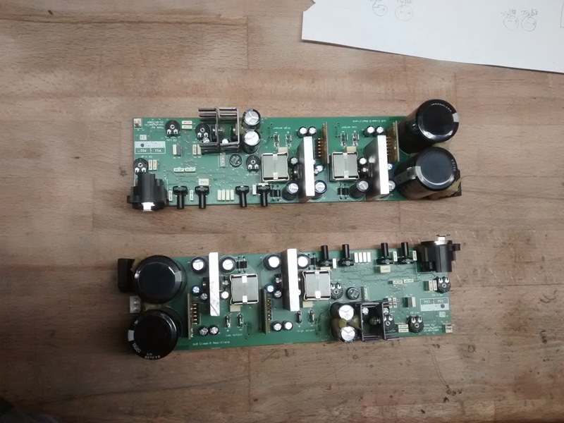

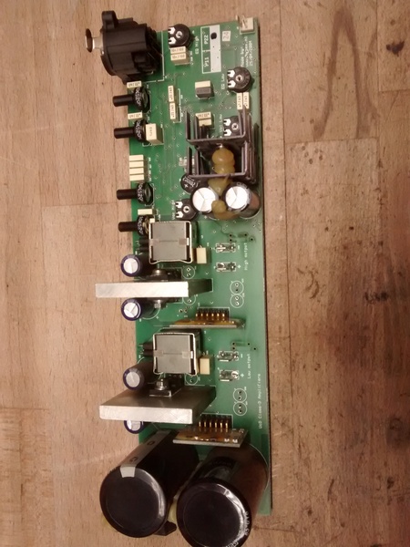

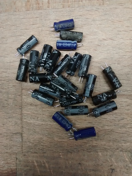

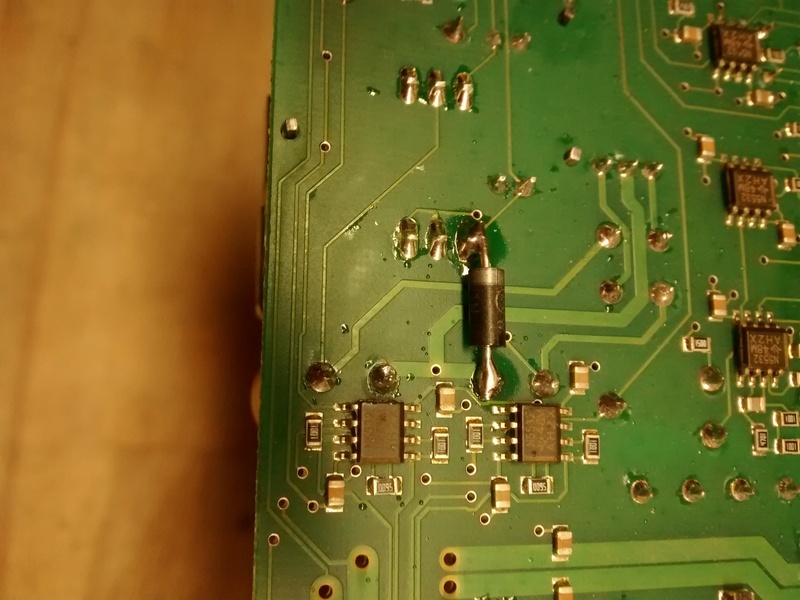

Today I had two hypex plate amps on the bench that are part of some ADAM monitors. The customer complained about different sound between both. As the "reference" was unknown I had to investigate both. Measuring supply voltage the pos op-amp rail showed -0.7V instead of +15V. This is a strong indication of 7815 latchup I experienced with ST 78M15 and 78L15. Indeed I found ST 78M15 on these boards. Adding a Schottky diode antiparallel to the output did the trick. But the function test still showed big differences between both. Tracing the audio signal path the pre-amp section seemed to be ok from input jack to the coupling caps of the UcD-power stages. Behind the coupling cap signal dropped significantly. So I removed these black sleeved 22uF/50V caps and measured them. Not a single one showed more than 5nF, these caps were as dry as the Sahara. After replacing 2x2 coupling caps on both modules things looked fixed. Having another look on the modules I discovered more of these infamous caps in the power area between the heat-couplers. Desoldered them all - and all these black 22u/50V were dead! The blue 100uF/16V showed about 70% of their capacitance - not too bad in a module aged 16 yrs. As the bigger caps did not show problems I replaced all these thin caps by new 105C variants and everything is fine now. Drying out over the years seems to be a matter specially of thin electrolytics exposed to higher ambient temperatures. Considering these caps and the al-cheapo trimpots made from Piher my impression is that the penny pinchers at hypex did a decent job.
6_replacing_spares_failed_parts_IMG_20200611_104323874.jpg212.4 KB · Views: 85
2_replacing_hypex_name_plate_IMG_20200611_102021191.jpg108.1 KB · Views: 230

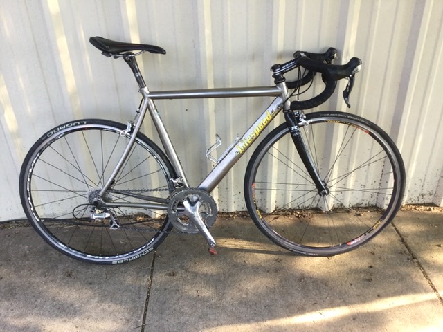

Wowza. Impressive! 🙂...73 miles this AM.
Coincidentally, the longest distance I've ever cycled in one day was 37 miles ...just reverse the order of the two digits in your ride to get my longest. And that was many years ago, when I was much fitter than I am now.
