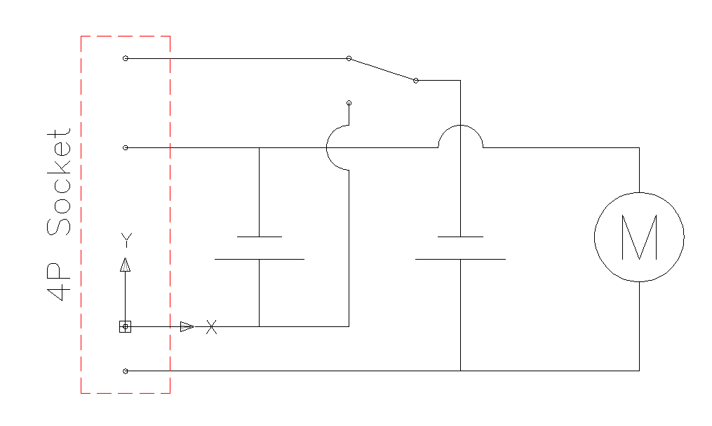

Not yet repaired but it is next in line.
Remington hair clippers.
2 x AAA NiMH cells inside which are end of life.
Trickle Charging system - not the best idea for NiMH cells.
Also, trickle charging works best if battery is run flat - hardly an option when part way though trimming your barnet.
Option 1 - replace the cells and leave as is.
Option 2 - fit 4-pole plug (TRRS) as scheme & use external smart charger which I already have: Making up a charging lead consisting of a TRRS plug & 2 dummy cells to slot into charger.
Smart charger charges cells individually (not in series). The switch shown would be the existing clippers power switch.
What d'ya reckon? Would a short charging lead upset the voltage sensing of the smart charger?

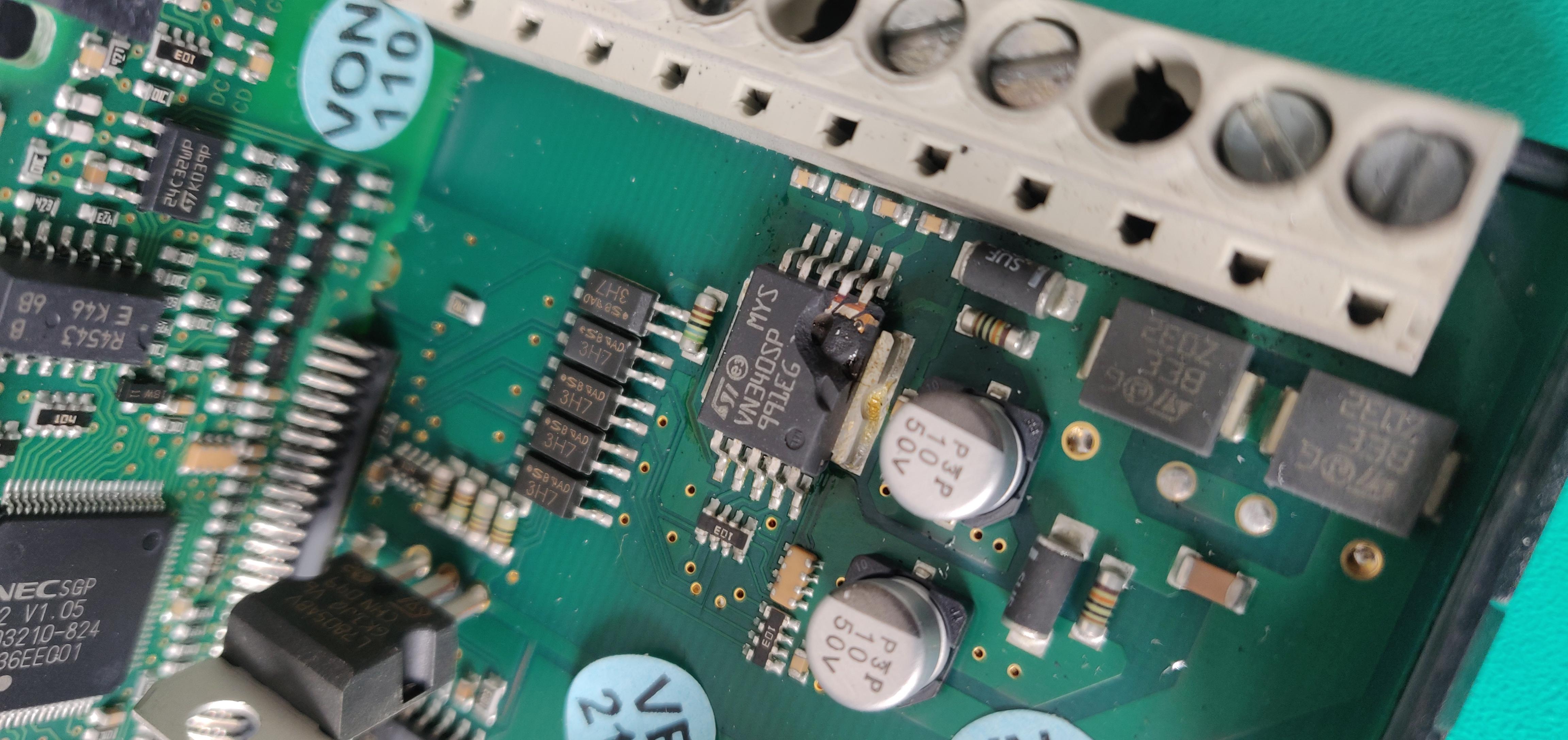

My brand new HiFiBerry amp wouldnt power the pi, as it's supposed to...
Struggled with it. 19V PSU, to 16V PSU... Separate power source for the amp and pi...
Finally took a good look with the headset magnifiers. C29, the 0.1 bootstrap cap was busted - this thing is about the size of a grain of pepper from my grinder. Fortunately it went across pins 1 and 8 of a reasonably sized IC and I was able to solder a leaded part (remember those?) across the pins.
HiFiBerry amp now powers the pi, with 19.3V in from a Liteon switcher brick.

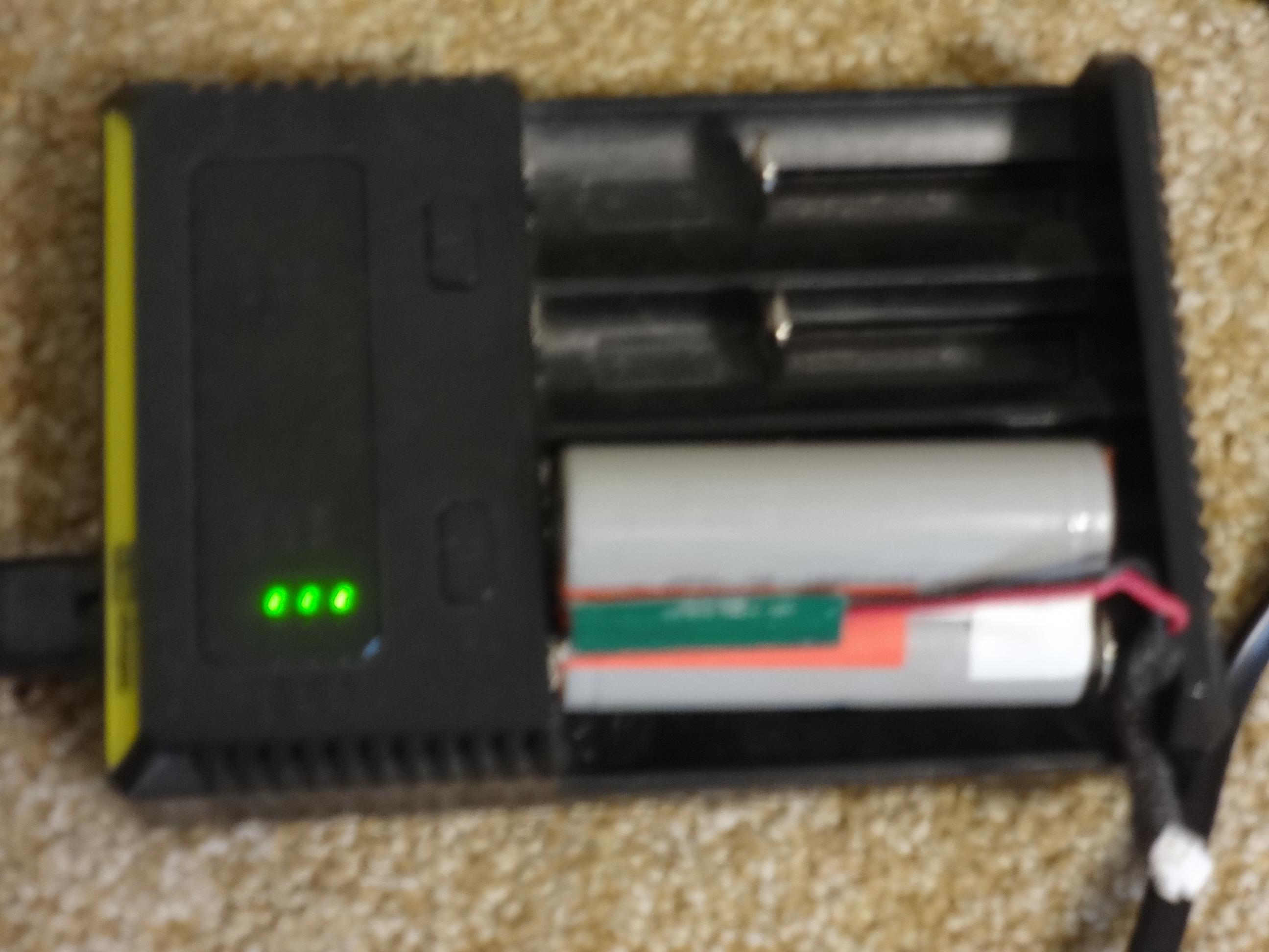

Took a swag at my Anker BT speaker. Had the proverbial "fast blink" on the charging light. Took a look at a YT video of someone successfully taking one of these apart - pretty straight forward. Dug out the batteries, a pair of 18650s. Busted open the plastic, stripped off the ends, one measures 4.23V, the other 3.47. Stuck the lower one in my lion charger while still in the pack and brought it up to 4.17. We'll see.

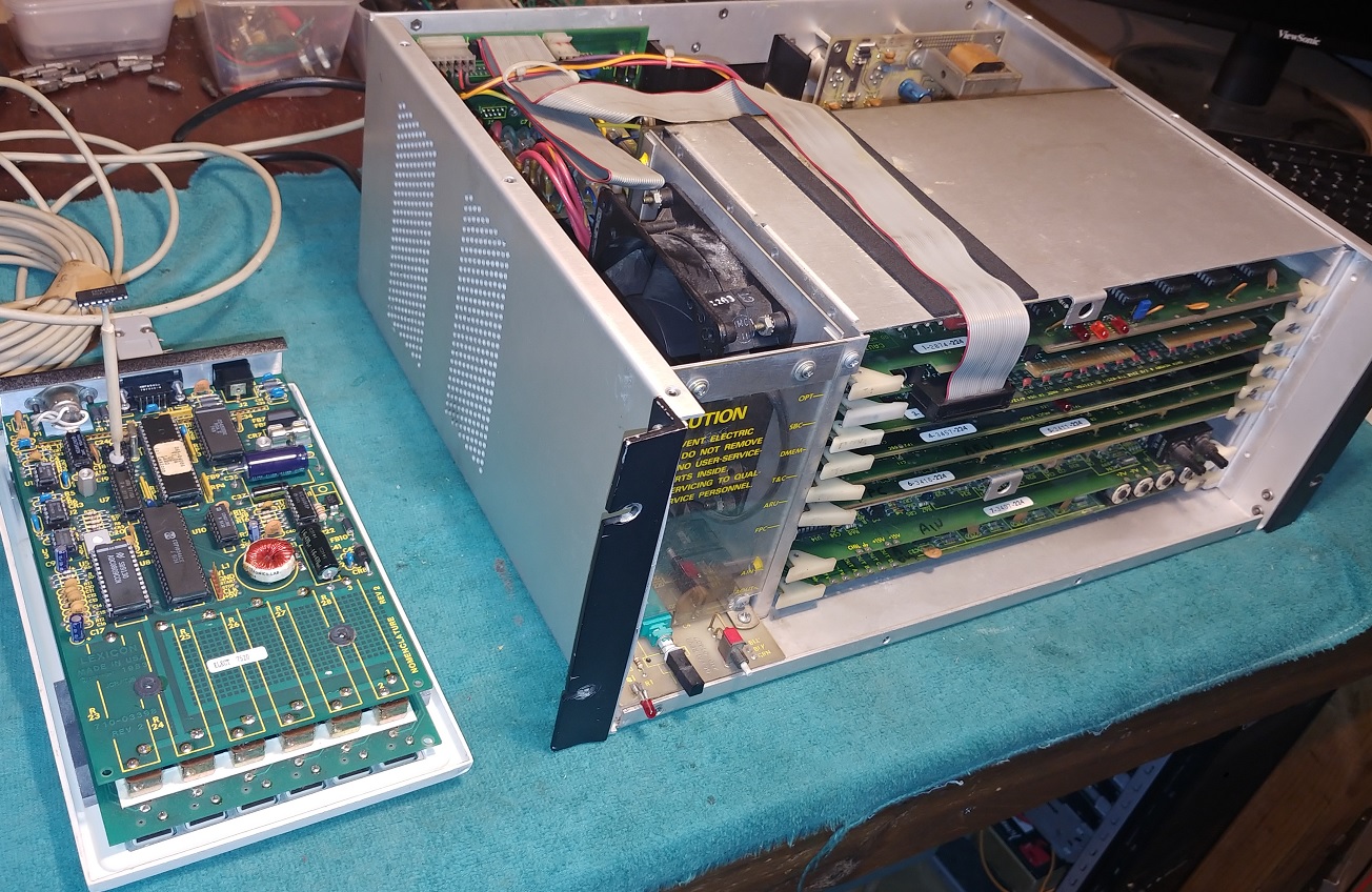

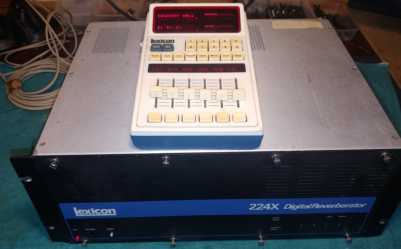

The Godfather of digital Reverb effects, Lexicon 224X + LARC (Remote Control).
Kept getting "mainframe link failed" error message. Could have been virtually
anything. Tracked it down to a faulty 4049 Hex Inverter / Buffer in the LARC
(Remote).
